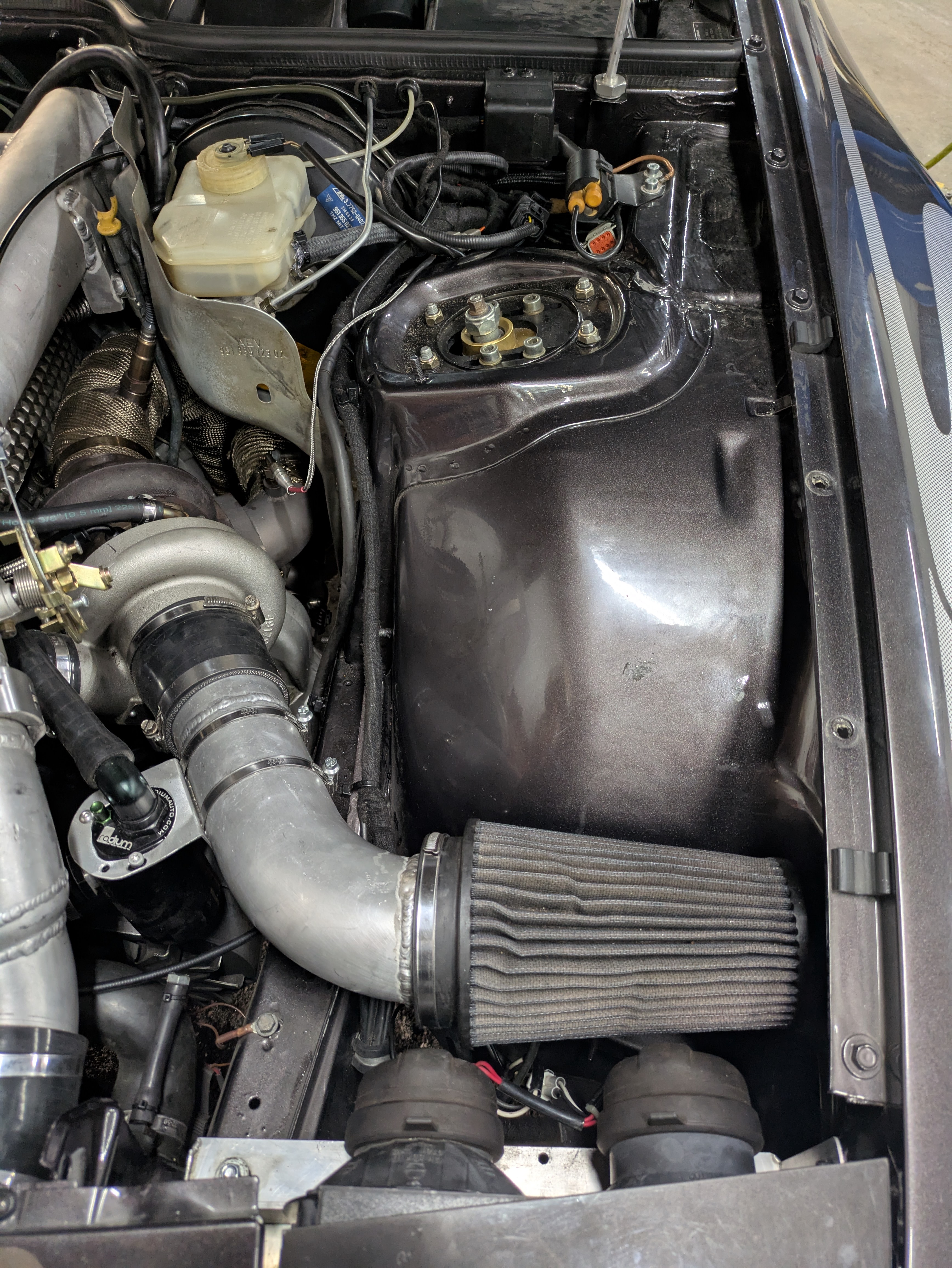

Very nice work, similar to my build. What size injectors were you running? I'm interested to know if I went big enough.
TC72
Posts: 20
Joined: Wed Apr 17, 2024 11:15 am
Been thanked: 17 times
Bergerac wrote: Thu Sep 12, 2024 1:02 am Very nice work, similar to my build. What size injectors were you running? I'm interested to know if I went big enough.
They are rated at 740cc at 3 bar, but I'm running base fuel pressure of 3.5 bar, so roughly 860cc. I had them left over from the V6 I had before. I knew they would be too small, but it's pretty easy to upgrade and rescale later.

What are you using for alternator?
TC72
Posts: 20
SirLapsalot wrote: Sat Sep 28, 2024 7:10 am What are you using for alternator?
Stock, on a Mantis bracket.

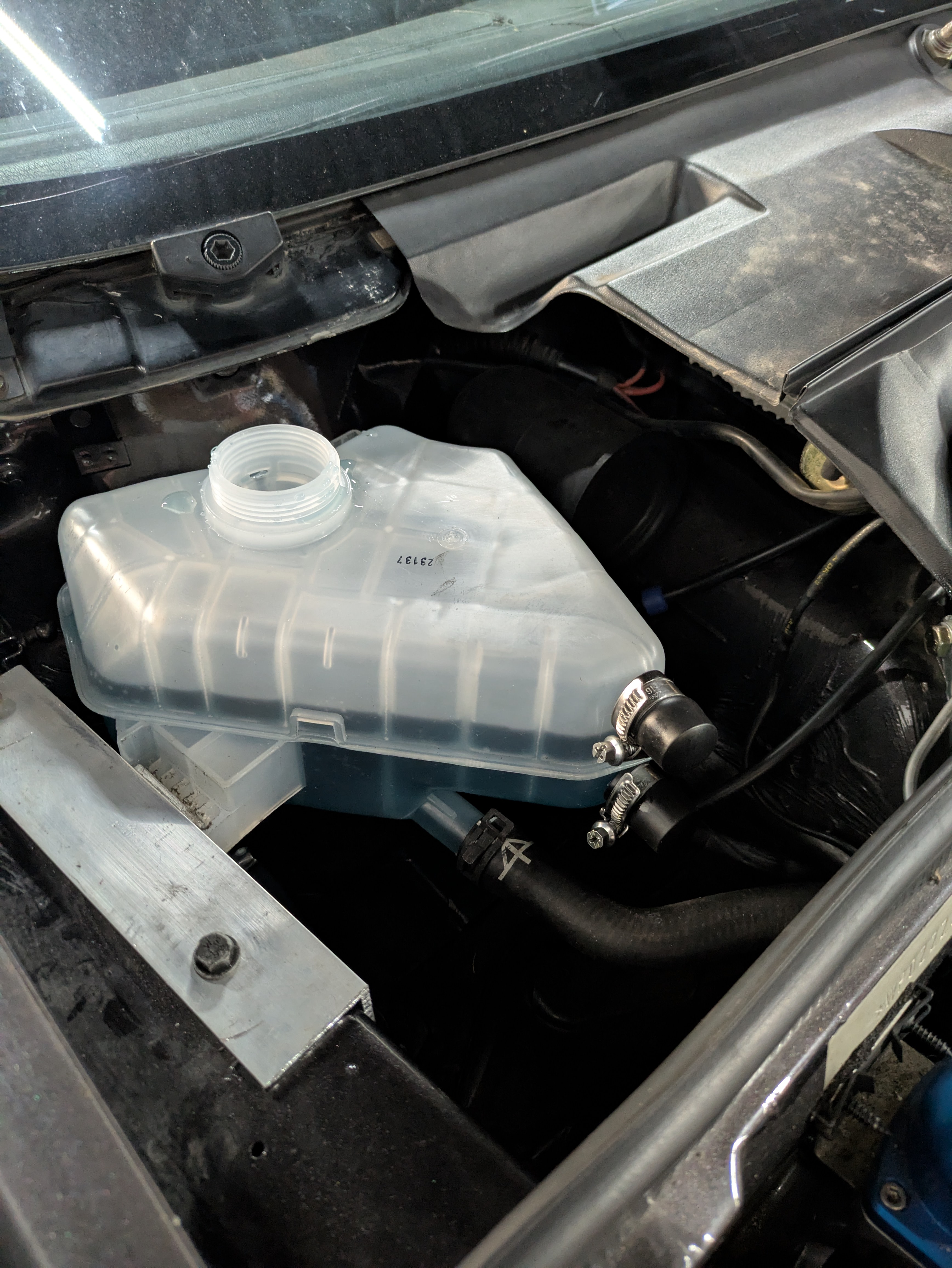

A minor update this weekend. This should make room for a better airbox and make the system self bleeding.
I'm planning to tidy up hoses, paint the brackets and add a turbine housing heat shield shortly.

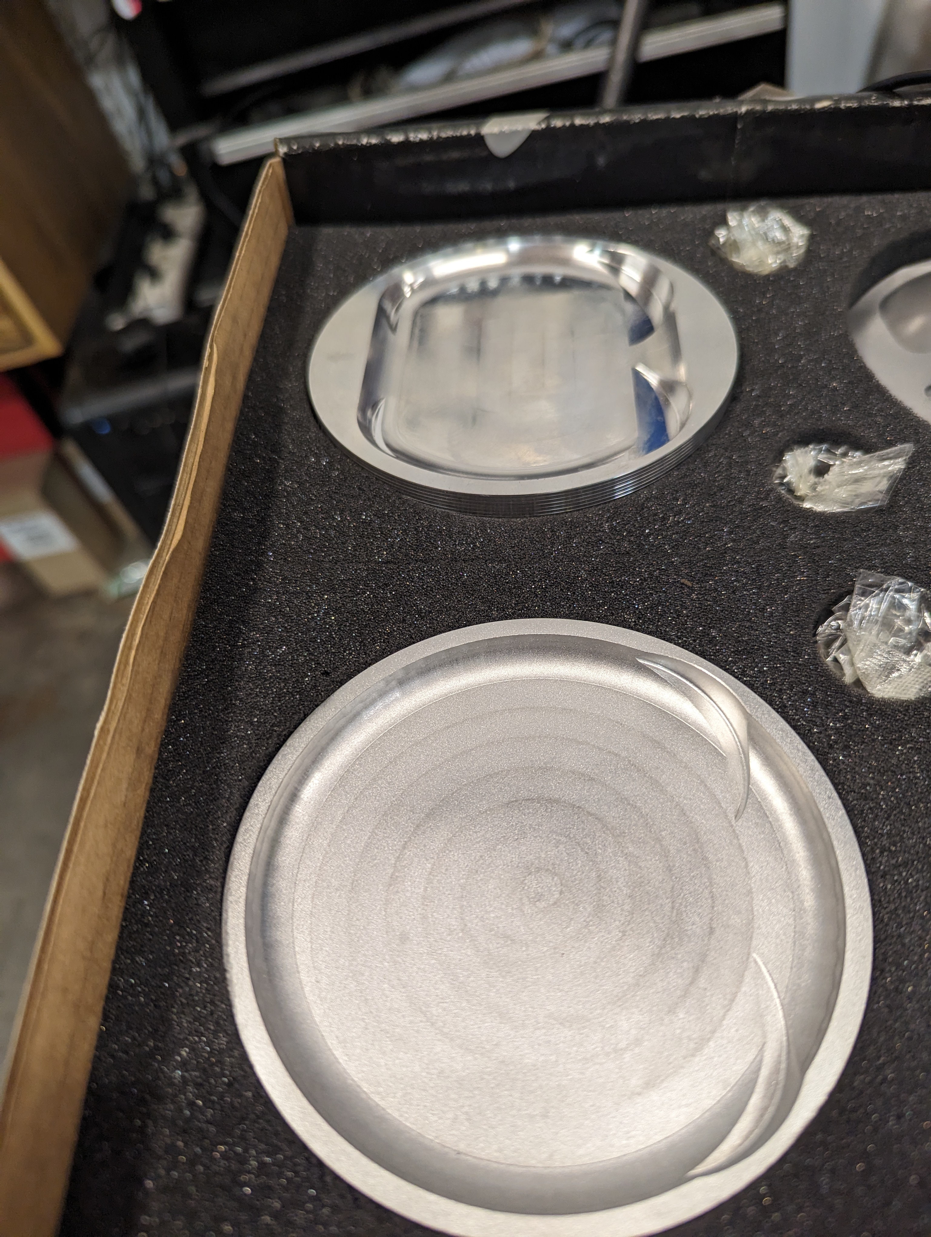

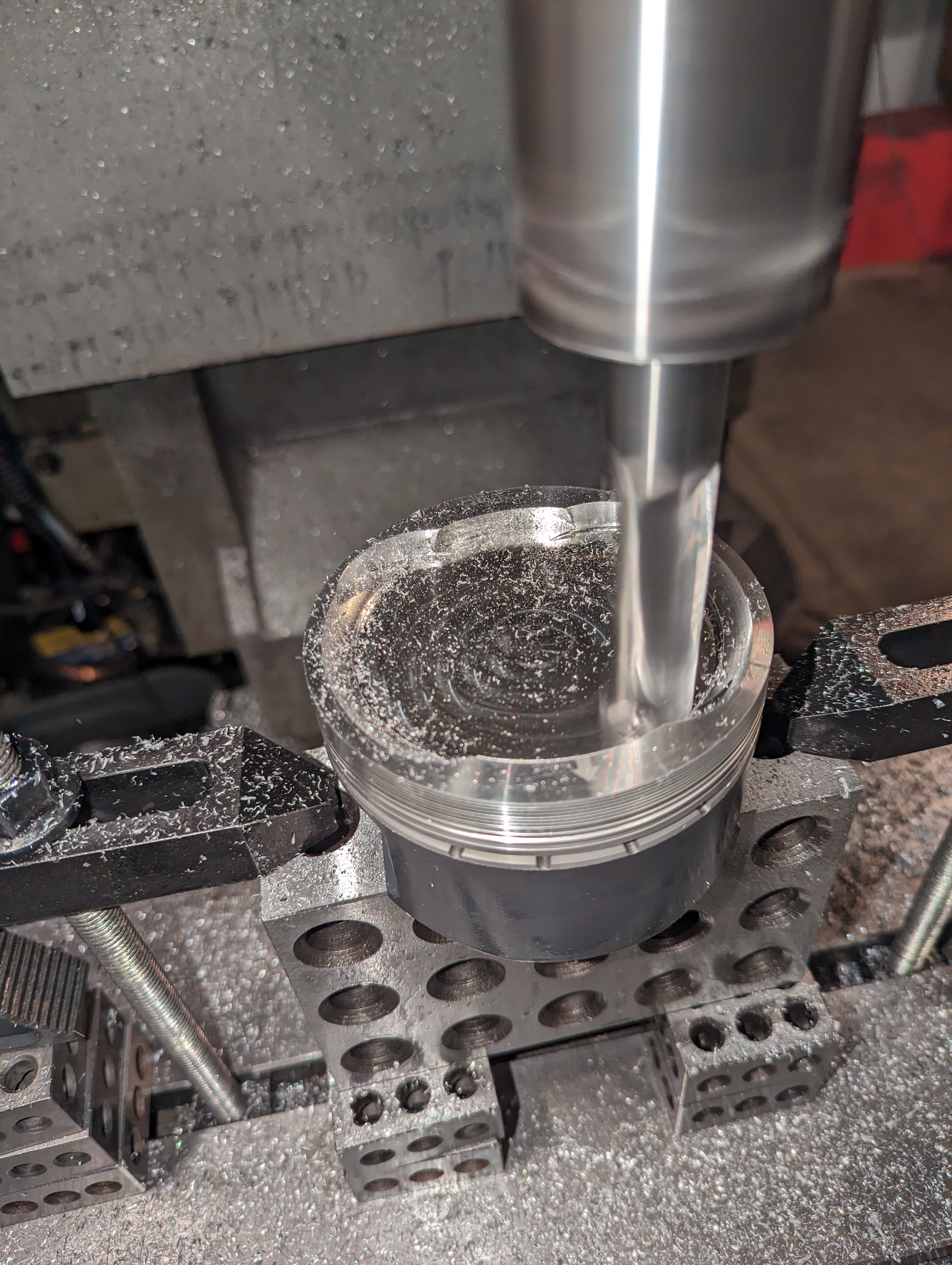

You mentioned you have dished pistons. I’m assuming you had them dished at a machine shop? How much was removed? I’m thinking of doing the same thing.
TC72
Posts: 20
944m3 wrote: Mon Jul 21, 2025 9:20 pm That is really cool.
I did the machining. The shelf Wossners for S2 have a very thick crown.
