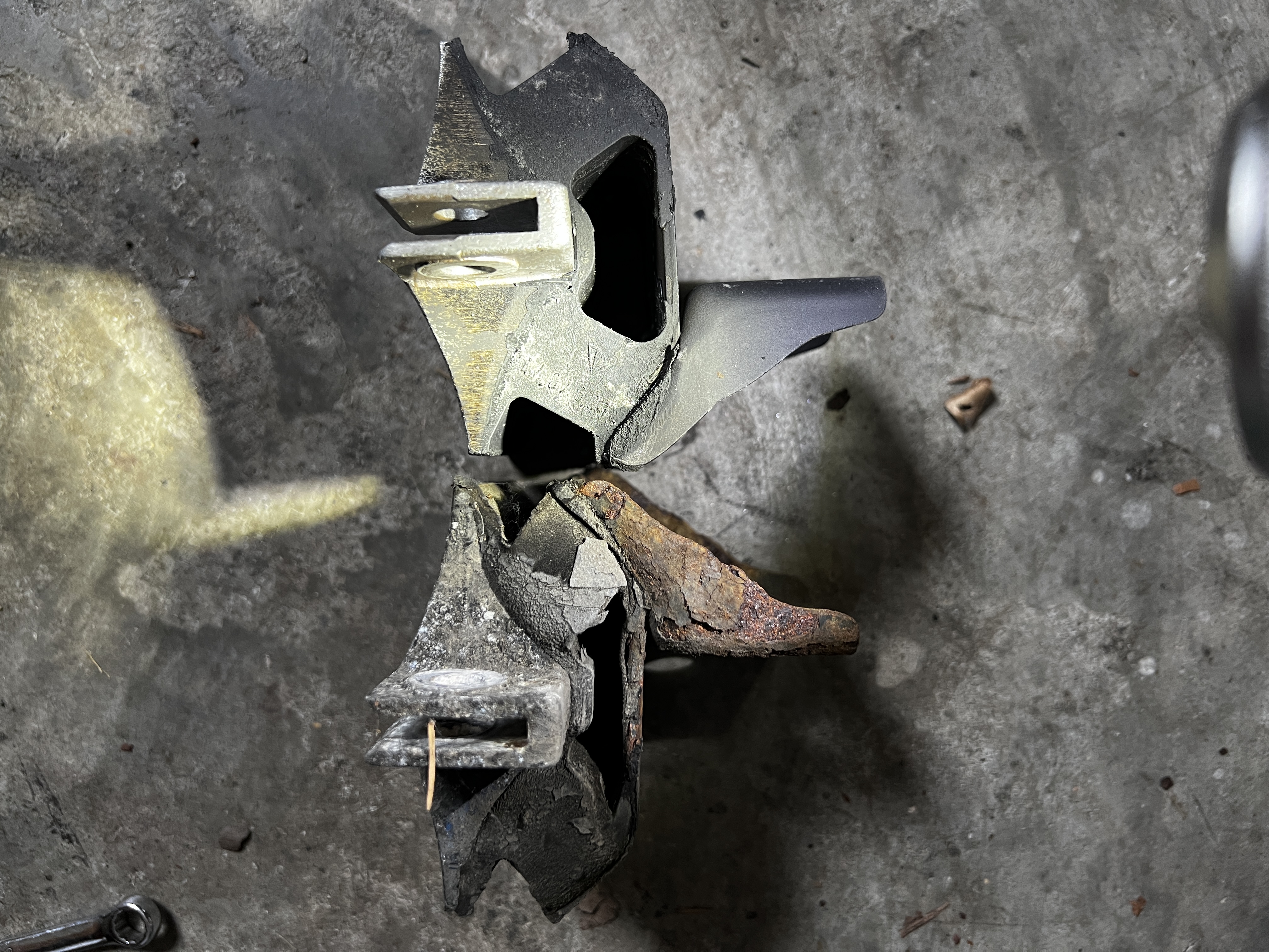

To me it seems that the two upper carrier mounts are original and in bad shape. The rubber is galvanized. These are #4 and #5 on the PET chart. But of course they are not available anywhere it seems. I’ve seen this mentioned in other posts. Any ideas?
I was wrong. I was able to find both Porsche OEM torsion bar carrier bushings (for the upper spring plate and banana arm). Where they attach to the car it does seem that new rubber should improve the ride in the rear. They were not cheap so hopefully they do make a big difference.

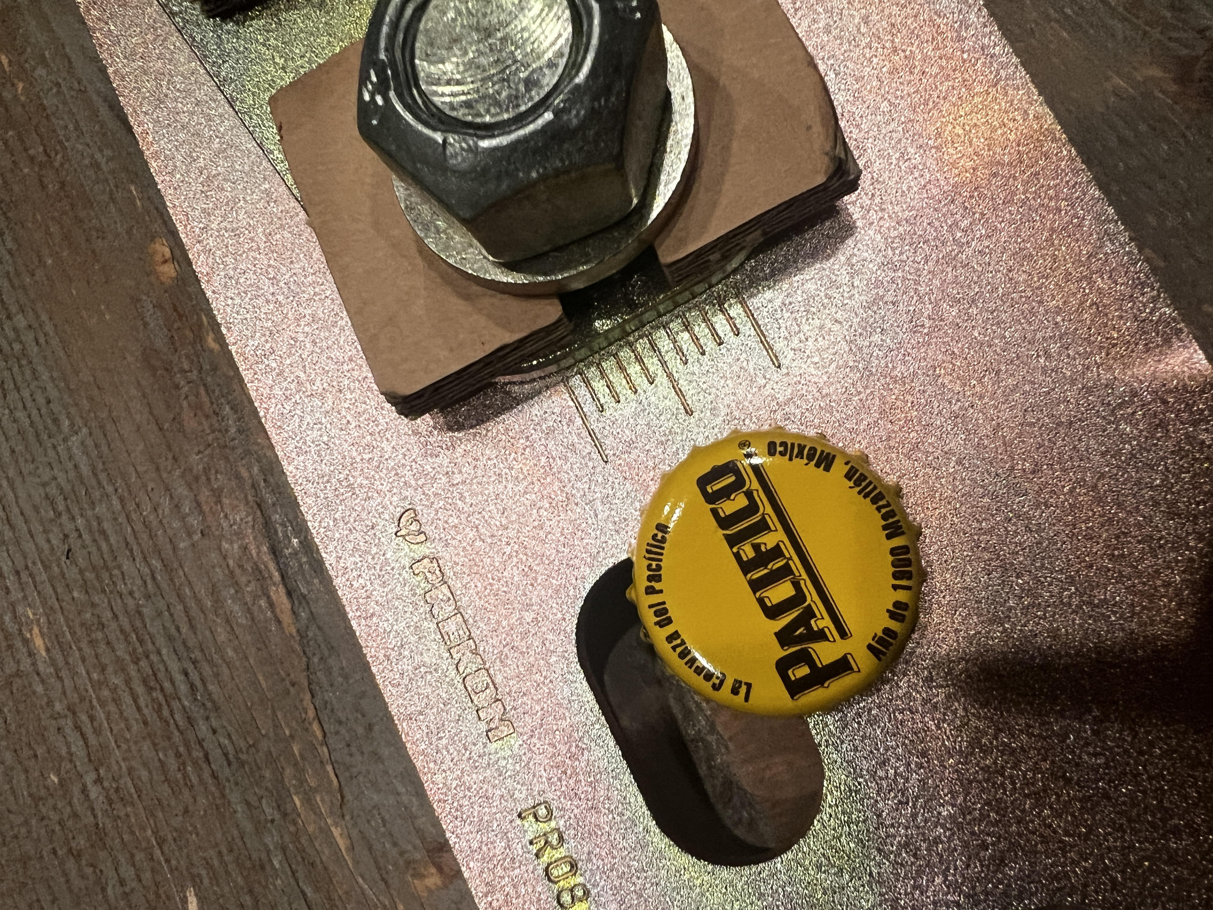

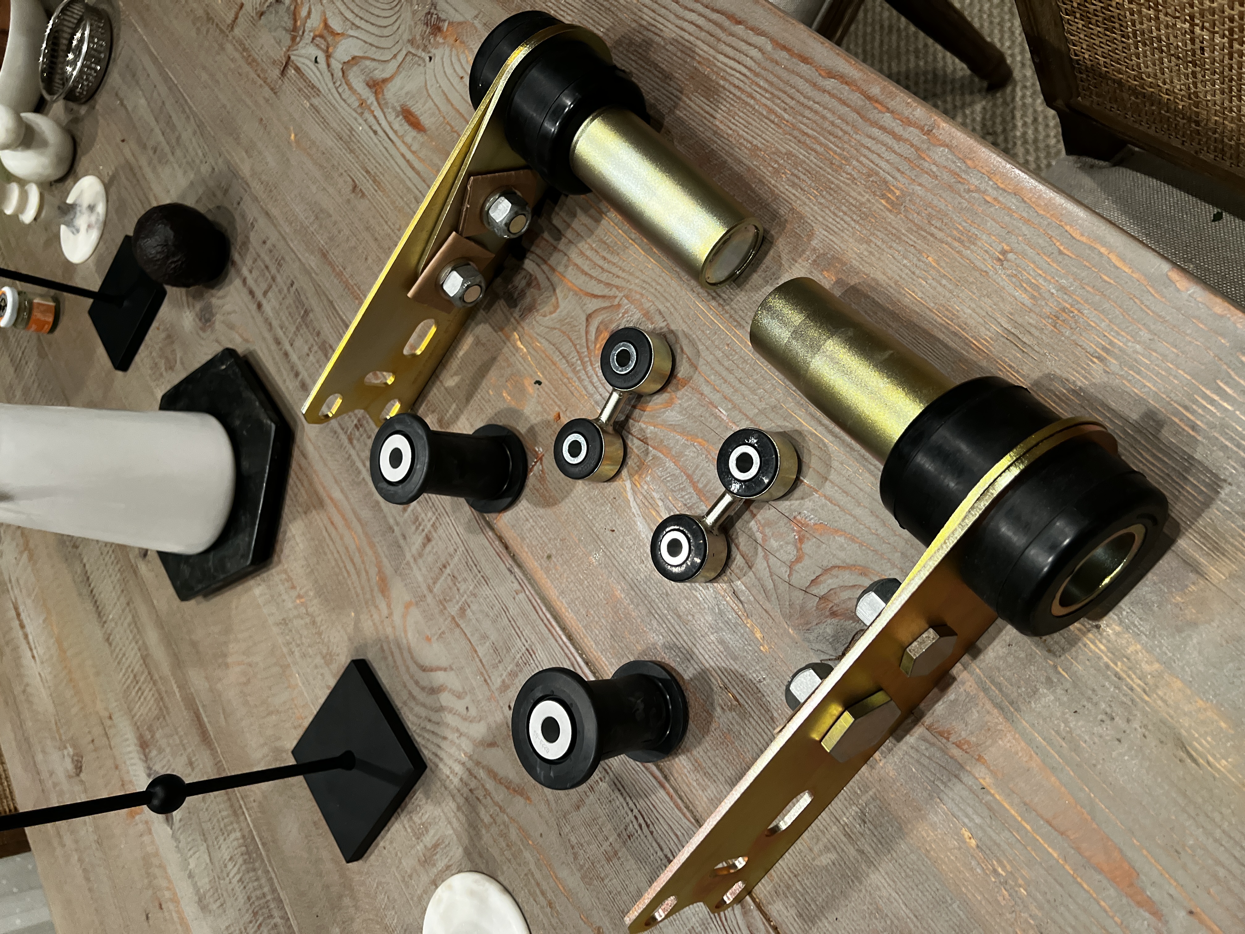

Looking forward to trying the Prekom adjustable spring plates. Seems indexing the torsion bar won’t be as difficult as I will have plenty of room to adjust. At least that’s what I’m hoping for.
(Edit- seems the adjustability might be the same as stock, so will still have to pay attention to indexing. Will try to confirm.)
Haven’t seen many reviews on these. For the price and adjustability they seem like a no brainer. Comes with the bushings pre-installed, which to me is huge plus. Did not want to even think about the effort needed to remove the old ones. I’m getting lazy!

All done actually. It wasn’t as bad I thought, though I did I got the torsion bar indexing wrong. Lowered the car about an inch and a half to much. But it gave me a reason to try out a coilover. But that’s another story.
The Prekom’s are great. Honestly can’t tell the difference between OEM. Really well made. Reading some horror stories about getting the old bushings out, I feel the Prekom’s with the bushings already installed are worth it. Though I will say the adjustability is the same as stock. Meaning you can’t go any higher or lower.
Overall the job wasn’t that difficult. Though I did have someone help me disassemble and final assembly. Along with new shocks, the rear now feels alive, that’s the best way I can describe it.
