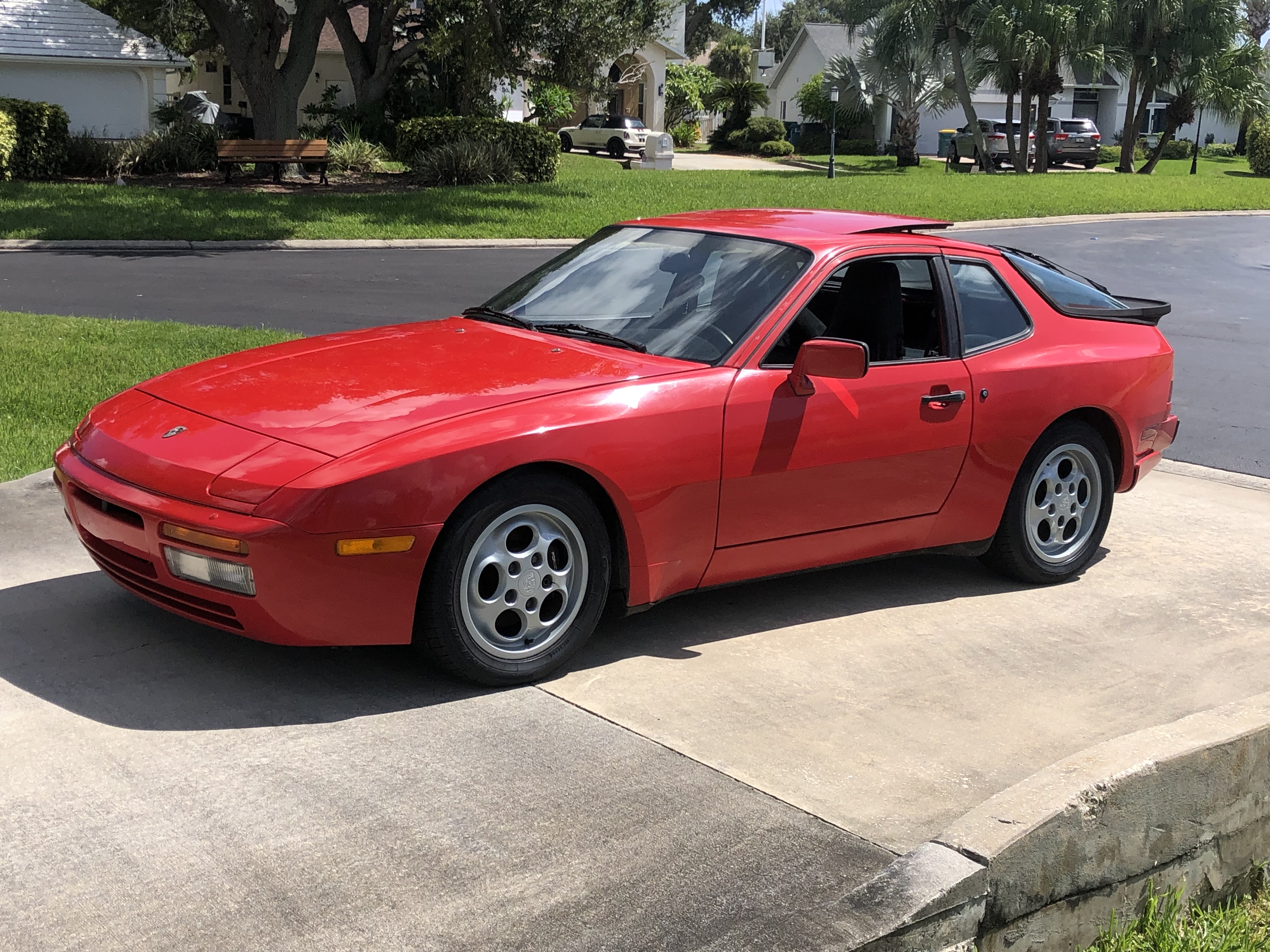

Finished rebuilding/replacing the fuel system from tank to injectors; new cooling system (water pump, Radiator and all hoses); replaced timing, balancer, P/S and A/C belts; and replaced a vacuum actuator. Nothing too serious...
Fired right up! Runs, drives, and shifts great! Just doesn't stop...??!! Thank goodness for the parking brake!
So, replaced the master cylinder, new rotors and brake lines, currently rebuilding the calipers with new pressure seals. Hopefully it will soon stop as well as it goes!

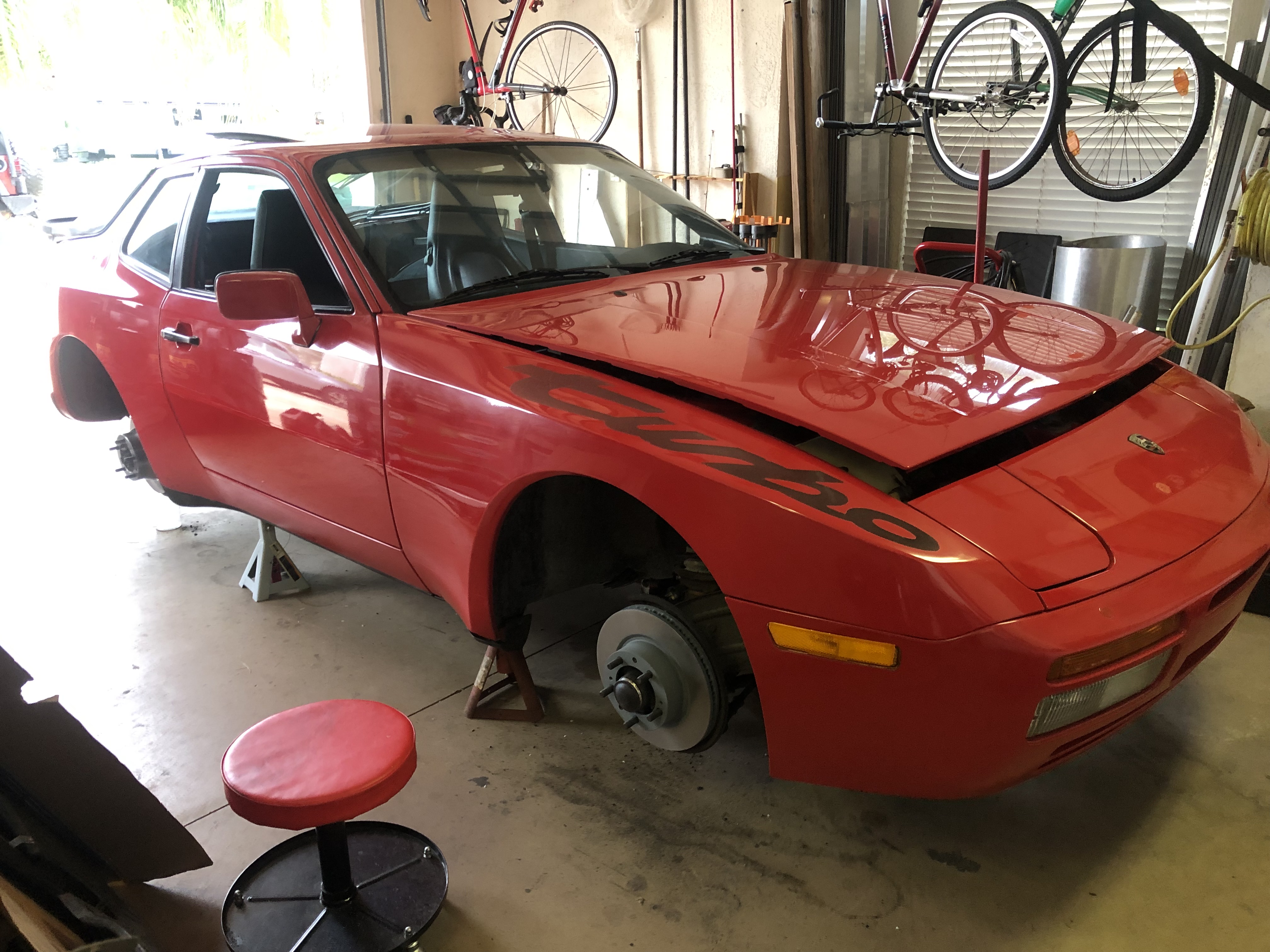

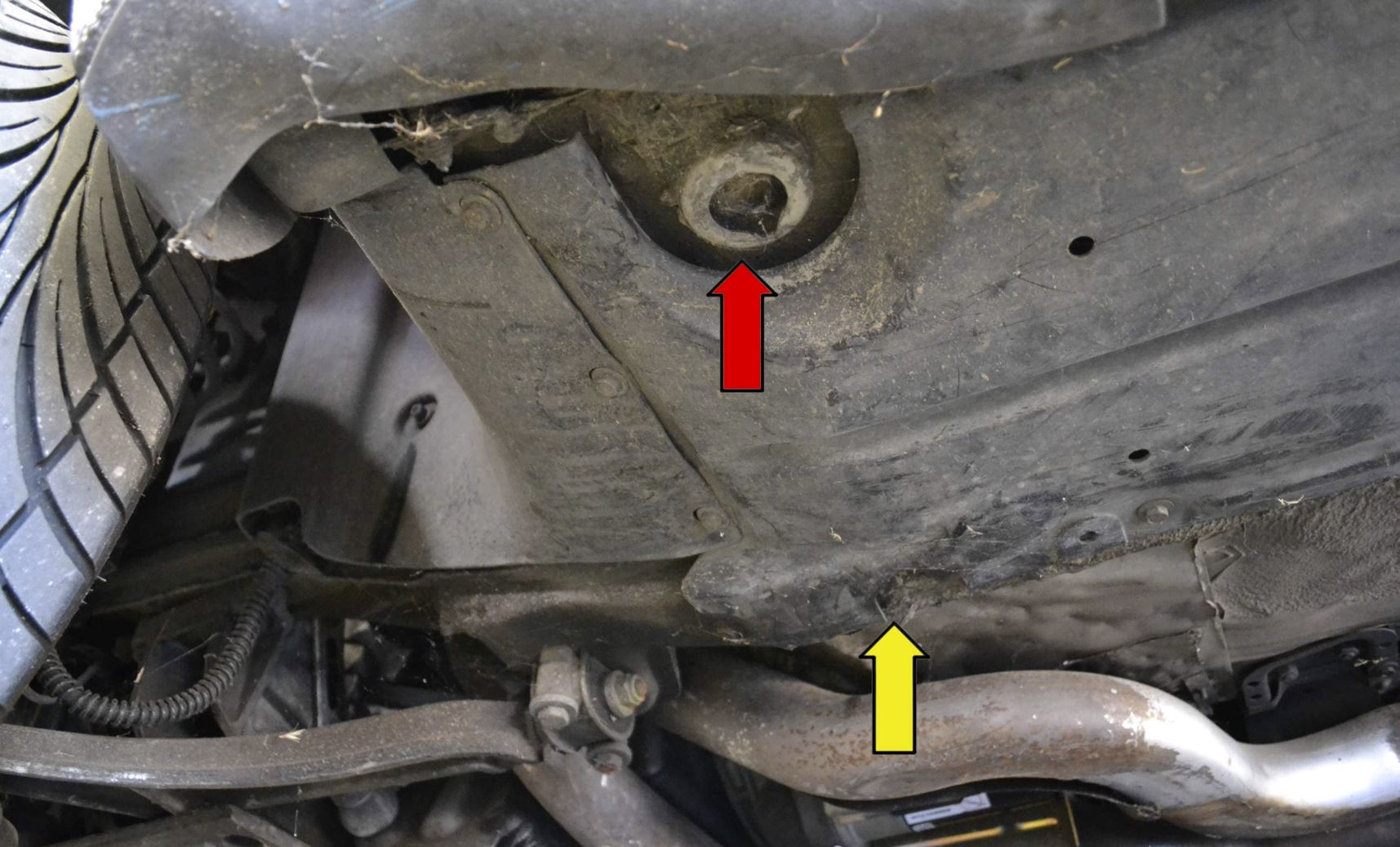

Looking at the car up on jacks... that front location under the round donut is NOT a valid jacking point. You should use the inner frame rail per the attached location marked with the yellow arrow. This is also shown in the owner's manual.
- 944 Jack Points.jpg (228.23 KiB) Viewed 485 times
