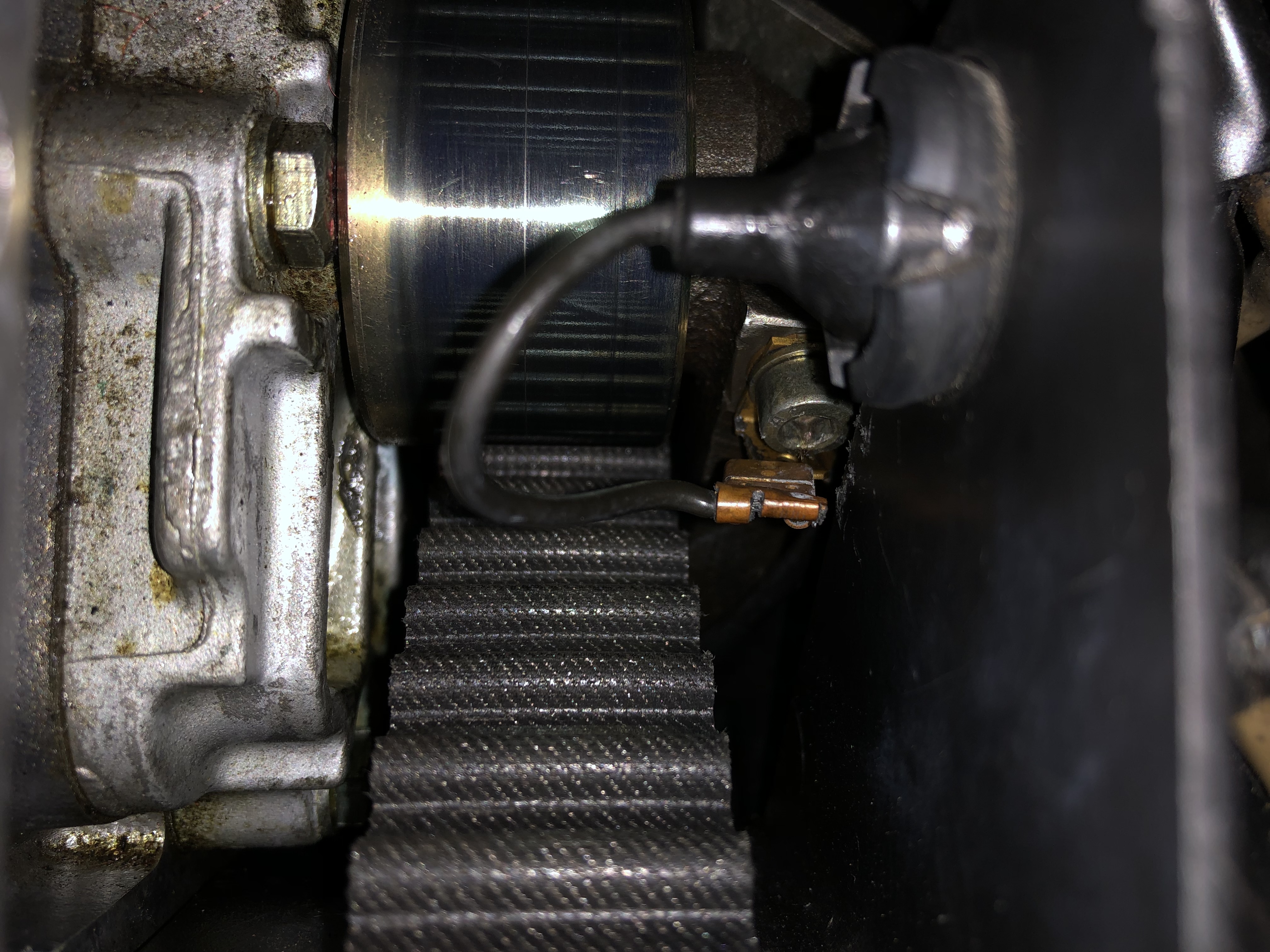

First, the Good News -- Problem solved, and easily attributable to operator error & workmanship. There's a small connecting wire from the tensioner arm through the center belt cover, and a connector for the harness wire from the sensing loop to the dash display controller.
First picture shows the wire from the harness connector on the right, to a female spade connector sitting just below but not actually wrapped around the male tab on the arm.

The little wire itself is just a bit crispified after about 115k and 35 years plus since the car was built. More good news is that Porsche still offers the wire and connectors, under $25 on order from the local dealer parts counter. It will go into the spares drawer for consideration when I accumulate ~1k on the belt and perform the tension check/adjust on it.
More: I was prepared to perform the whole timing belt service again, thinking that maybe the belt itself (Gates T196, same as current factory supply) if needed. The symptom was so odd that I'd narrowed it down to either an internal cord failure in the new belt, or a break in the sensor wire loop. It was only after I took the picture that I could see the connector only partially engaged with the tab; It felt fine when I reached in to check. So only about 74% percent of the normal labor for belt replacement was needed.

-- The belt tension warning is simple yet elegant. The tensioner arm is isolated from engine ground by a plastic bushing. In service, there's a small coil spring also isolated from engine ground and an intermediate piece between the tensioner pin and the arm. When pressure from the tensioner is sufficient, the little coil spring is compressed and the intermediate piece is in contact with the pin, completing the connection to engine ground from the tensioner arm. If pressure from the tensioner falls off for any reason, the little coil spring is able to separate the intermediate piece and open the ground loop.
In the pictures, the sensor cable connects to the tensioner arm, and also the sensor circuit from the display driver in the gauge cluster. The loop is ignored for the first few minutes after engine start, then sets the red 'toothed belt service' message if the loop opens again. The spring and insulators and intermediate piece add about 20mm to the end of the actual tensioner assembly. Part of the reason this works is the extremely non-linear action from the stacked Belleville washers used to provide pressure in the tensioner itself. There's a very sharp 'knee' in the pressure vs. travel curve.
