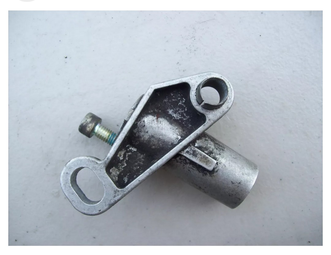

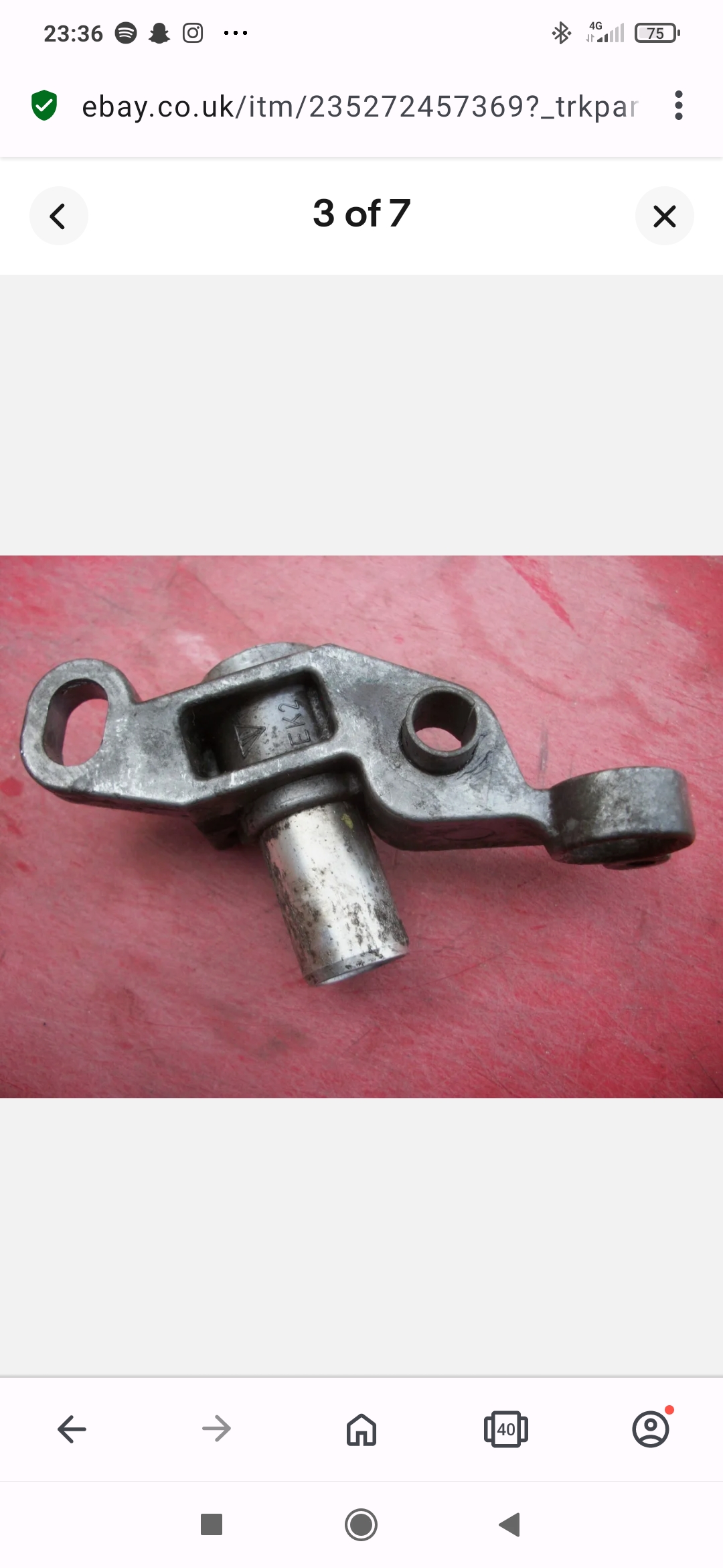

I guess this is a oversight from my part. It's a well documented issue.
When I bought the 16v engine it did not come with this bracket I took the bracket of one of my 1986 turbo engines guess that bracket is the old unshielded piece .
eBay is full of these brackets so I have bought the correct piece with the integrated sleeve and a new sensor. Hopefully this will resolve my issue.

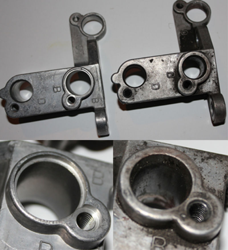

Interesting. I never paid attention to this variation on the 8V sensor bracket.
I'm pretty sure the 16V speed sensor bracket is like the later style 8V, without an additional sleeve.

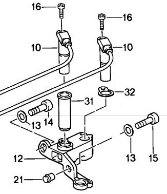

This is the S/S2 part of course only one sensor because propper 60-2 and not the Goofy 8v setup. Looks like Porsche learned from their mistake in 1987

And this is a 968 bracket.
