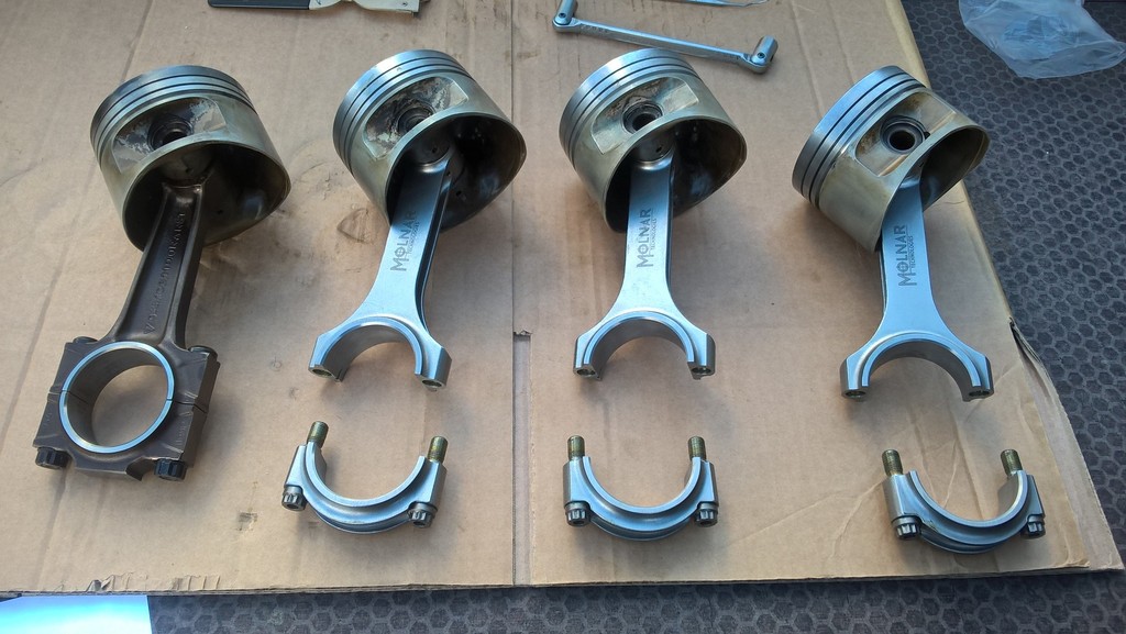

michaelmount123 wrote: Tue May 07, 2024 3:22 pm Since you're asking about setting valve lash with solid lifters, I presume you're wanting to rev beyond 7500rpm. I caution you to consider the weaknesses in a stock lower end. The crankshaft can handle it, but stock Glyco rod bearings will not. Although the main bearings will be okay, you'll want to use ACL race rod bearings. Stock connecting rods are another issue. The big end will distort at very high RPM, and even the ACL bearings will struggle to survive. Proper race rods like Molnar or Pauter (or others) are the answer. You'll also want to consider the stock pistons which will be operating well beyond their designed stress limit. Dry sump will surely add a level of confidence with lubrication.

Like you Saied there are several issues over revving the 44 engine. I have some aftermarket Molnar rods in my garage and have few sets of ACL bearings also maybe i will install those regardless.

I'd definitely use the Molnar rods and the race rod bearings to increase durability. You'll also want to refinish your cylinder bores and use custom lightweight pistons at some point. Your cylinder head should be reconditioned and the ports configured by an expert (of which there are very few). This is to say, all aspects of your engine need to be in perfect shape to get maximum power and durability. The sequence of addressing different areas of your build is up to you, but you surely don't want to invite a catastrophic failure that will render any components useless.
