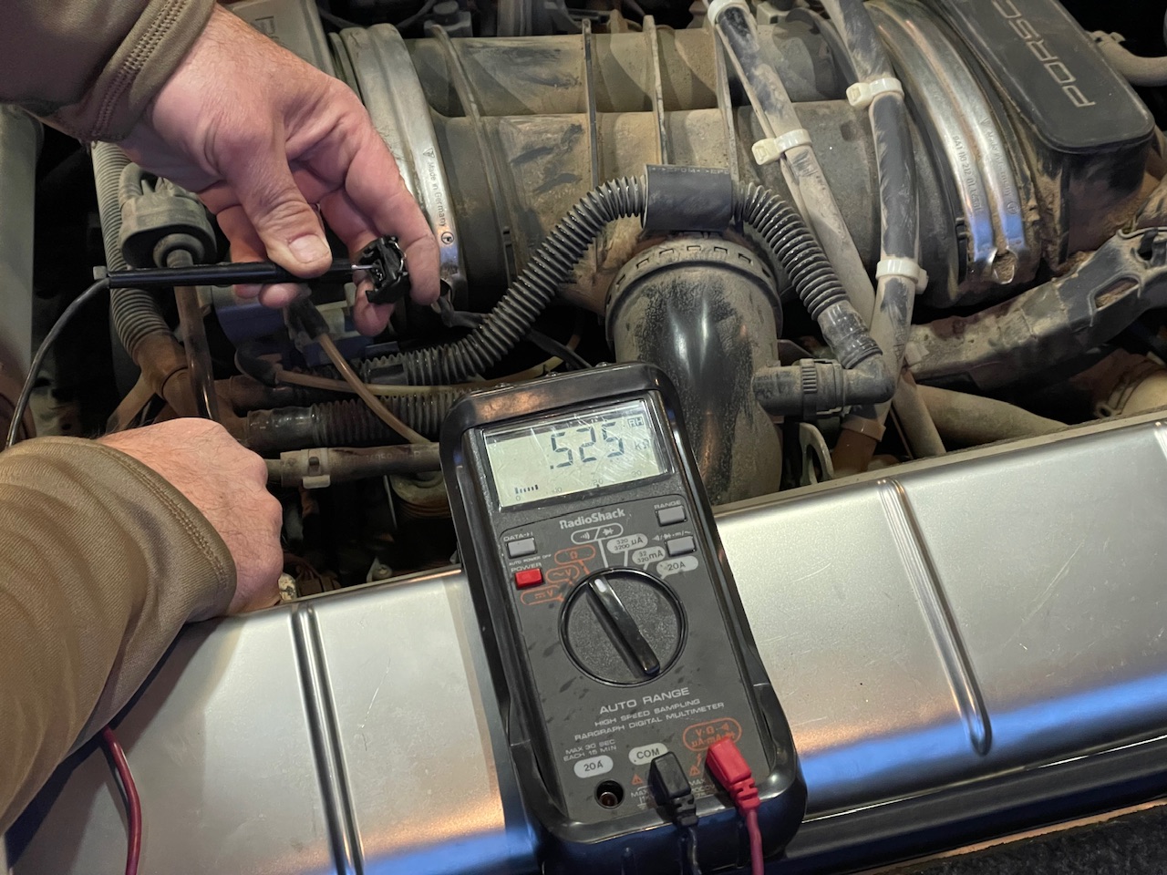

I put the back probe in pin 1, and the red to chassis ground. I think that’s what you want. I get this reading, so i assume it is switching ground like you say.

Almost there, but that last test isn't complete. With the black probe on Pin 1 and the red probe on a good chassis ground, what you are looking for is continuity when the flaps should be closed, and an open circuit when the flaps should be open. Your reading shows 525 ohms I believe, which isn't what I'd expect to see with the flaps open or closed. I'd repeat that test, and make sure the probes make solid contact with the both Pin 1 and a nice clean ground. Also, what you are trying to confirm is that there IS continuity when the flaps are shut, and there is NOT continuity when the flaps are open. So you need to test with the PSE button in both positions, and confirm Pin 1 switches with it.
I'd also put the connector back on and make sure the flaps and opening and closing when you push the button. By testing with the plug removed, there's some chance Pin 2 stayed at 14.67 because the factory system was keeping the flaps closed despite the cabin switch. With a patch cable like I described above, you can hear the exhaust switch modes. With the connector removed, it's worth confirming the flaps are doing what you expect...
