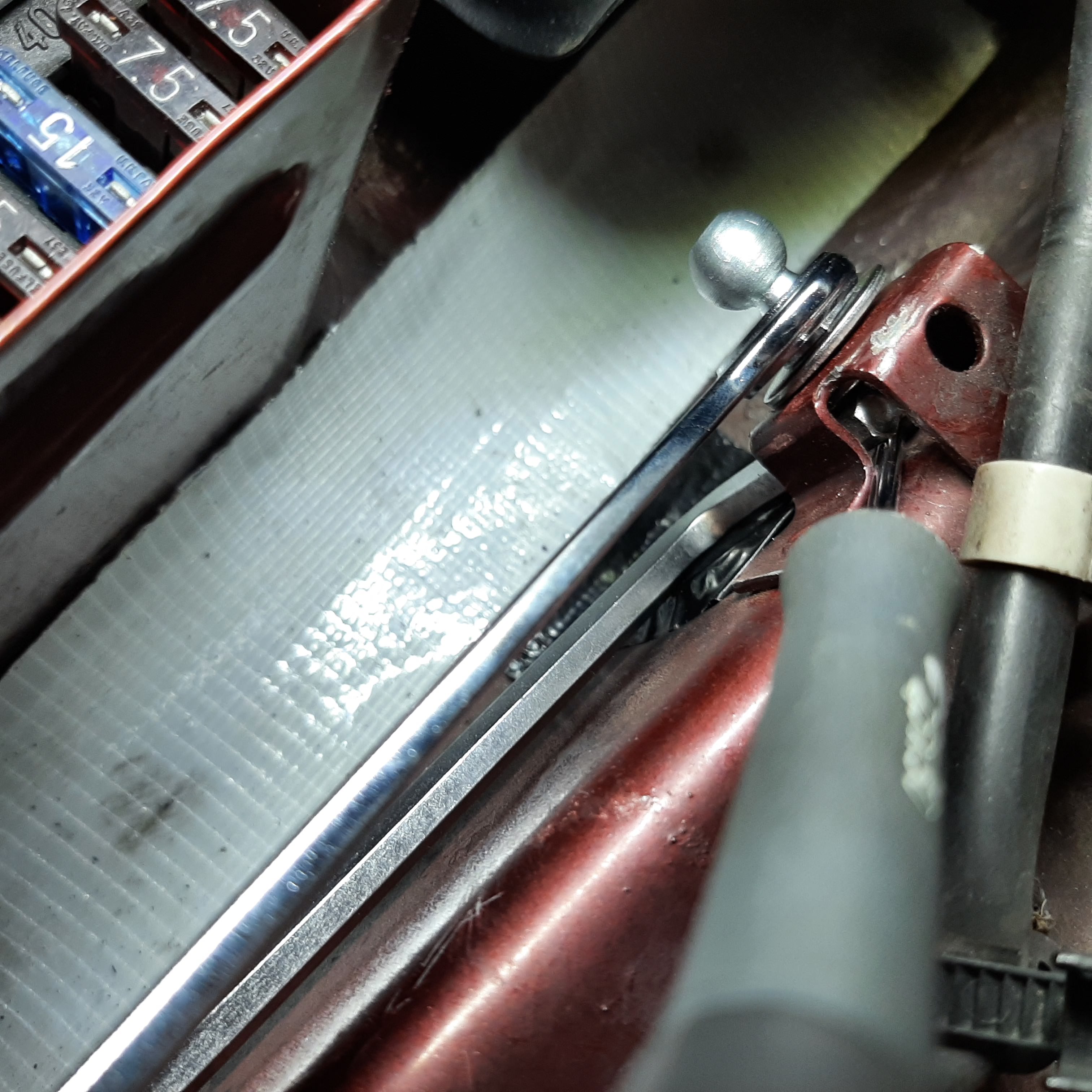

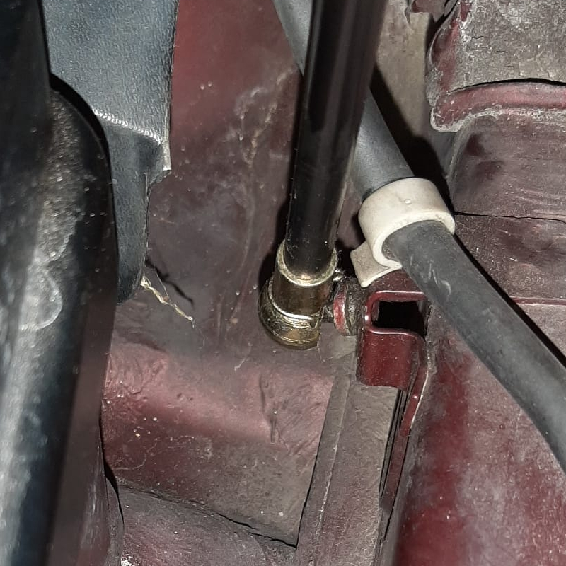

Hi everyone! Yesterday I carried out the repair. I sourced both a M6 and M8 ball stud and hardware, but decided to install the M6 parts because I didn't want to drill out the original bracket to accommodate M8 hardware.
I have to say, the repair went very well! Here are some pictures.
Original problem:
Repair in progress:
Result:
If you want to read the full procedure you can do so on 951werks.eu :P
