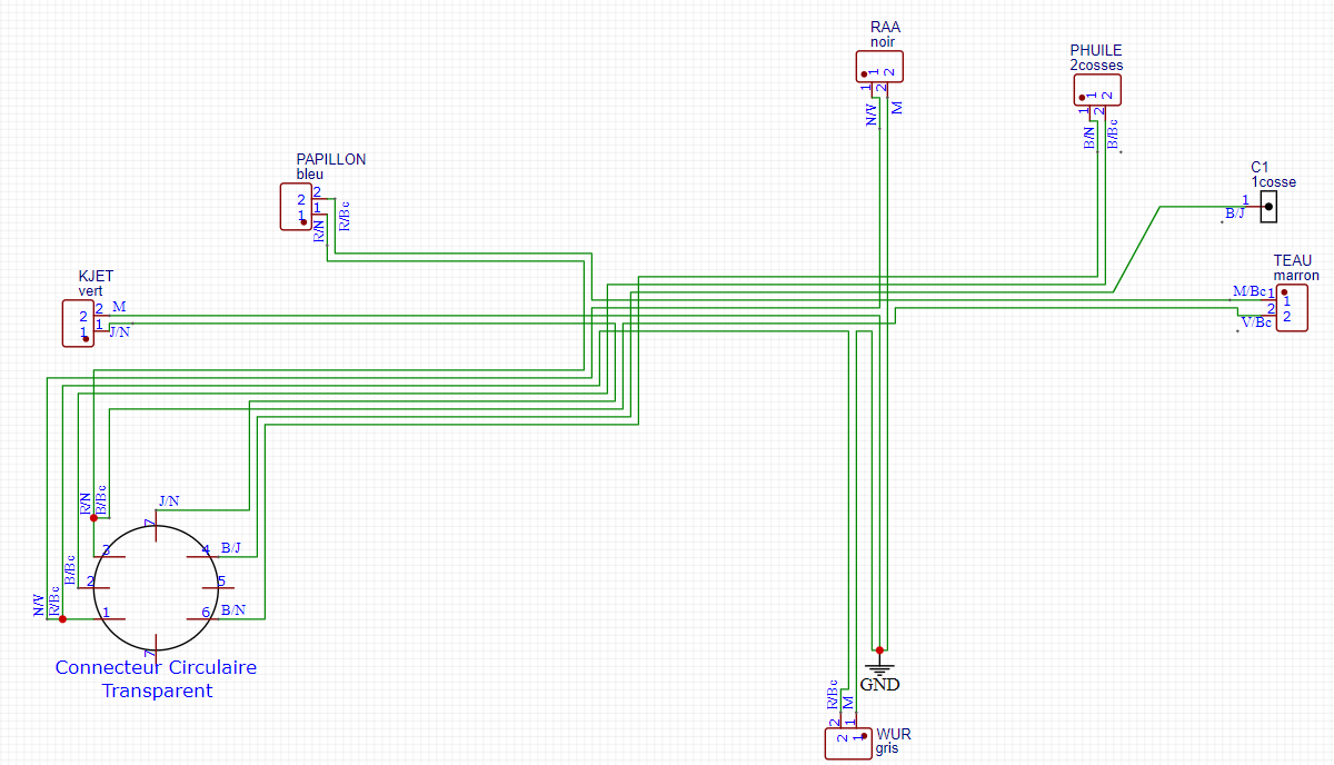

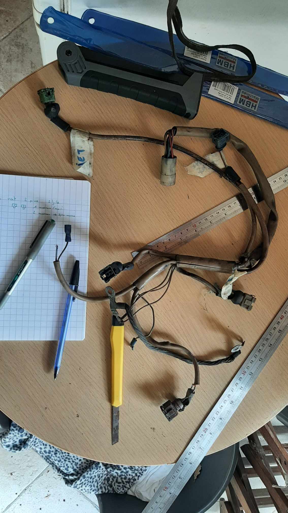

Hey all !
To pass the time, waiting for money to finish the engine, I work on the harness.
As I'm going to fully redone it, I have to make a diagram of it, as I don't find any for the 1977.
I share my firsts plans with you, if it can help anybody.
I tried to make them in a position seeming the reel position on the car. May it help beginner to understand and follow it easily.
I use generic draw for the connector, so please don't take care of that. It may have some mistake as my harness is in terrible state, and some color have totally change with the time ! What a baffling problem ! So feel free to correct me and i'll update the diagrams !
Careful ! Wire colors are in french !!! Here is the trad :
B = Bleu = Blue
BC = Blanc = White
R = Rouge = Red
N = Noir = Black
V = Vert = Green
G = Gris = Grey
M = Marron = Brown
J = Jaune = Yellow
"Ignition" Harness Papillon = Intake Valve | RAA = Auxilliary Air Regulator | PHuile = Oil Pressure | TEau = Water Temperature | WUR = Warm Up Regulator | C1 = I dont know what it is... I've search in the PET, look for it on websites to buy it, i really dont know what it is, it's on the water temperature sensor support but not in contact with the water. If you know what it is, I would be grateful !

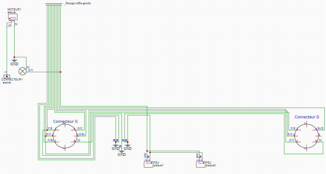

Trunk harness Connecteur D = Right Connector | Connecteur G = Left Connector | Feu Plaque = Plate Light | Moteur 1 = Rear Wiper | Cross in a circle = Lamp (not visible on the photo)
I can share an Excel document with all the colors, directions and the AWG. I haven't finish it yet, and I'll do it for the entire harness.
Hope it'll help !
Have a great day all !

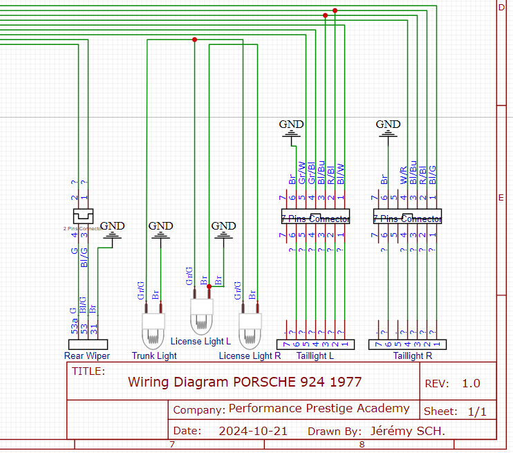

Hi all !
As I work on the wiring diagram and still want to share it with you, I have begun to draw the full car wiring diagram, as a standard one. AND A FULL VERSION IN ENGLISH !
Here is a first draw, I'll will share the full one, one's it will be done.
I'll continue sharing some intermediates diagram, waiting for the full result
Hope it'll help you !

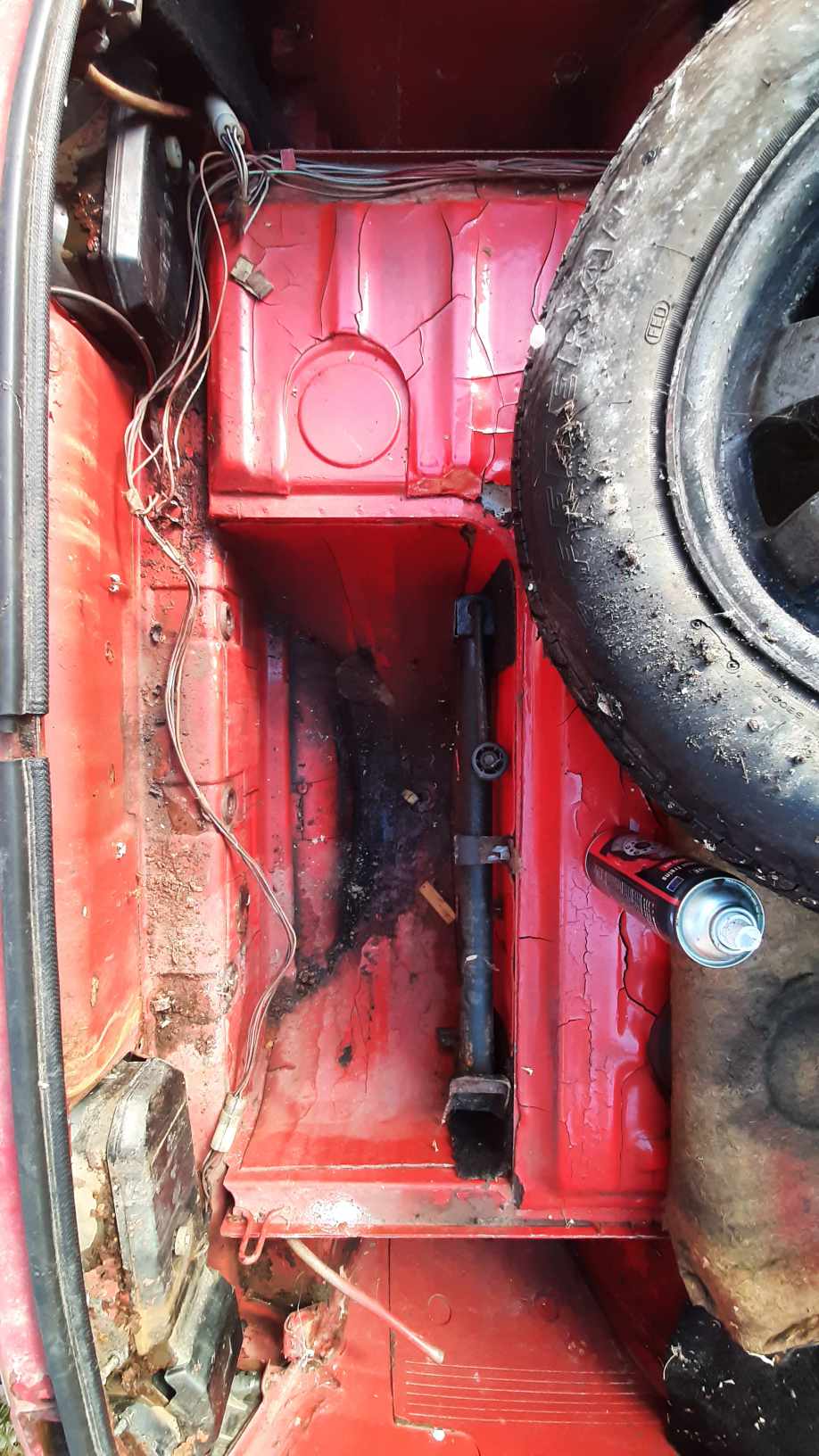

Hi all !
Made a long time since I posted the last updates ! Since then, I found the electric schem !!! So the last schems I made are good for wiring but only for that.
Actually, I'm working on the engine controls. I build a engine mount by myself, and began to work on. I'm not a little proud
I bought a Ultrasonic cleaner and it's a banger ! I'm in love with it !
But what a change ! I continue to clean everything and take the quotes. The crankshaft seems to be in good shape, but still have to find new support to test the roundness of each range of the crankpins.
For the car itself, I took off the interior and I'm near to finish to take off the electric harness.
A lot of work to do but a big motivation !
Thank to read me and feel free to talk about all of that !
