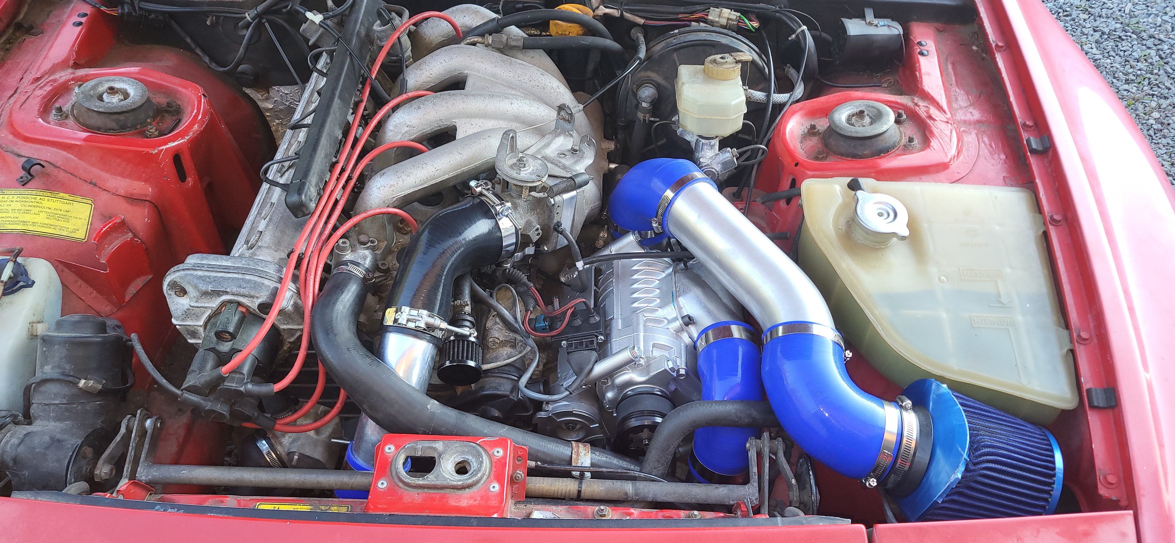

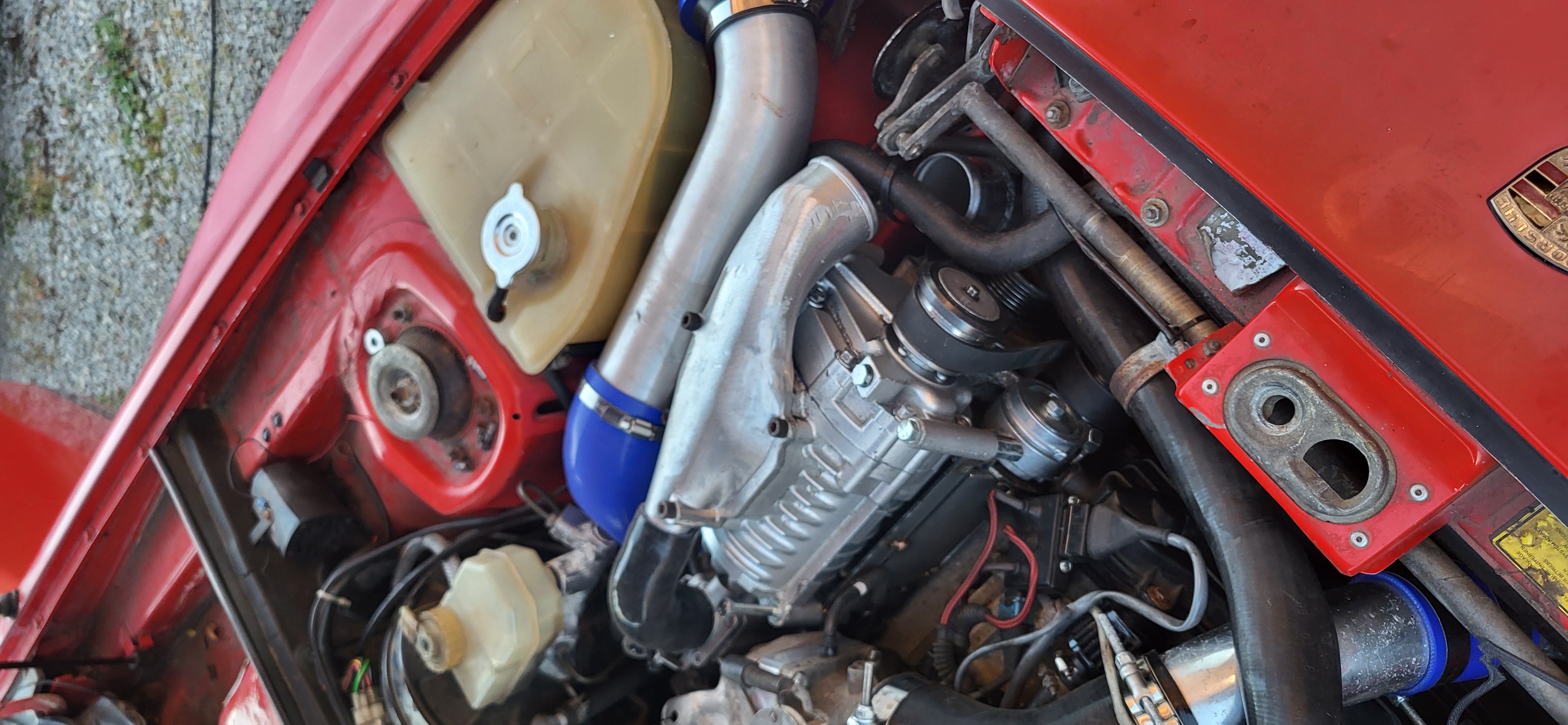

Supercharged 944NA..
Yes I've done it :angel:
Eaton m62 from Mercedes-Benz.
Maxxecu.
2,5" fmic and piping, 3" on intake side.
Custom manifolds by my design and making.
+45% power on the wheels.
The dyno charts shows car bone stock and with supercharger.
Last pic is V2 of my kit that lets you keep AC.
I have a fb group too: The boosted NA society

Wow, these are all really impressive builds! For those who started with an N/A, did you have to source a new trans for the increased power delivery? I hear ours are built like glass

The stock NA clutch, gearbox and transaxle will handle +300hp without problems.
With that said.. a moron can blow the transmission with stock power... :shifty:
I'm still running my +40yo original rubber clutch.
But I do have a new Sachs clutch kit on my shelf.. :angel:
