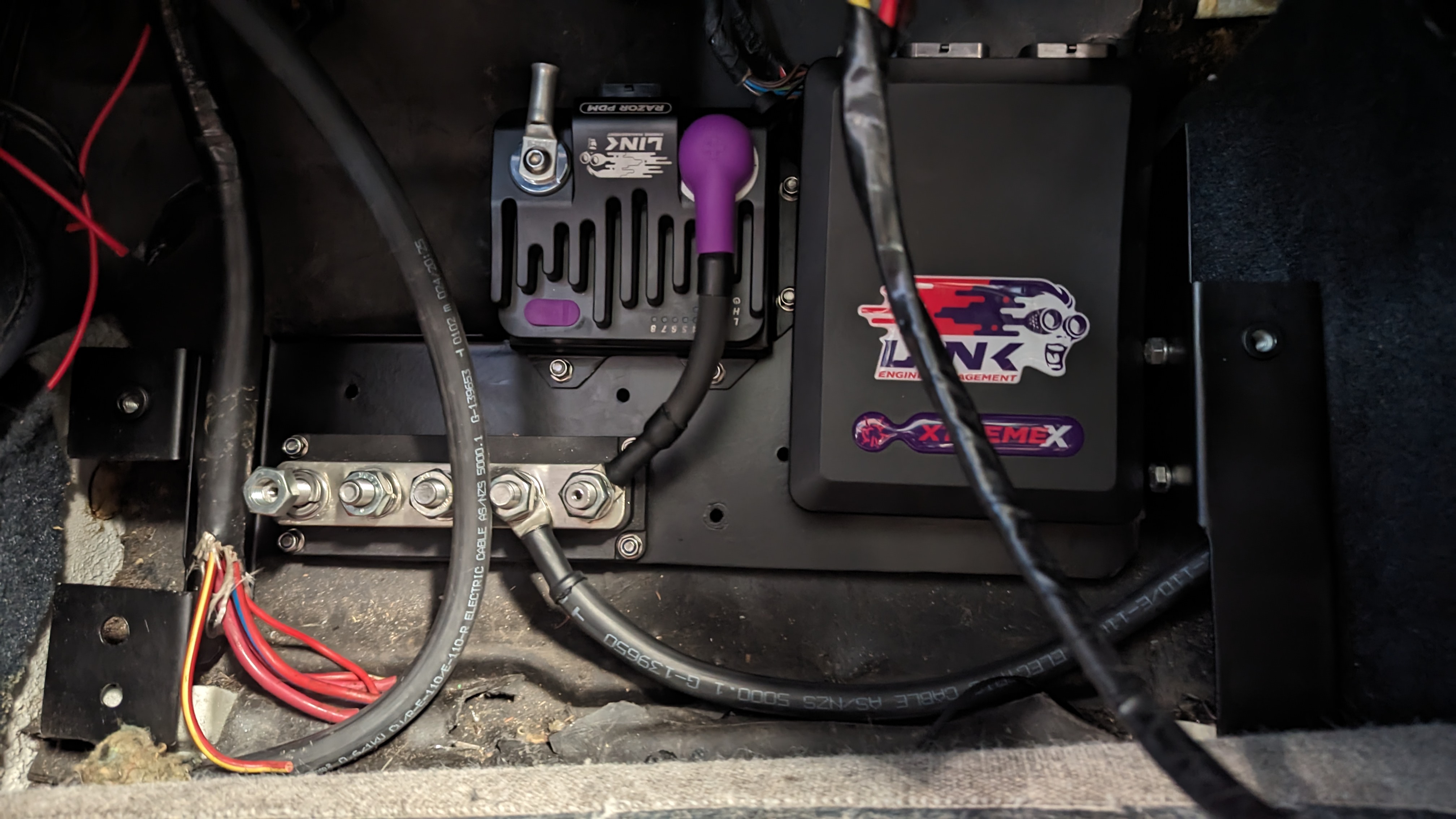

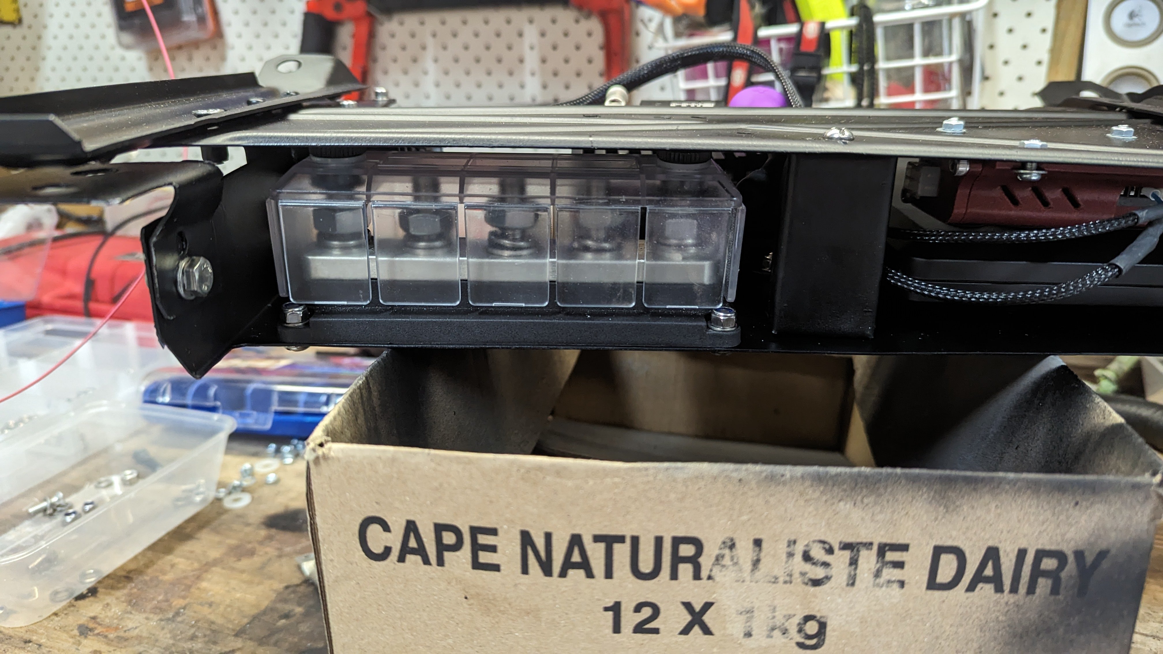

ECU bracket is complete and ready to mount. A previous owner butchered the wiring from the rear mounted battery to the starter so that has all been replaced with double insulated rubber sheath cable and a terminal bar installed for the connections to central electric, the starter and PDM. This all mounts under the stock DME tray.

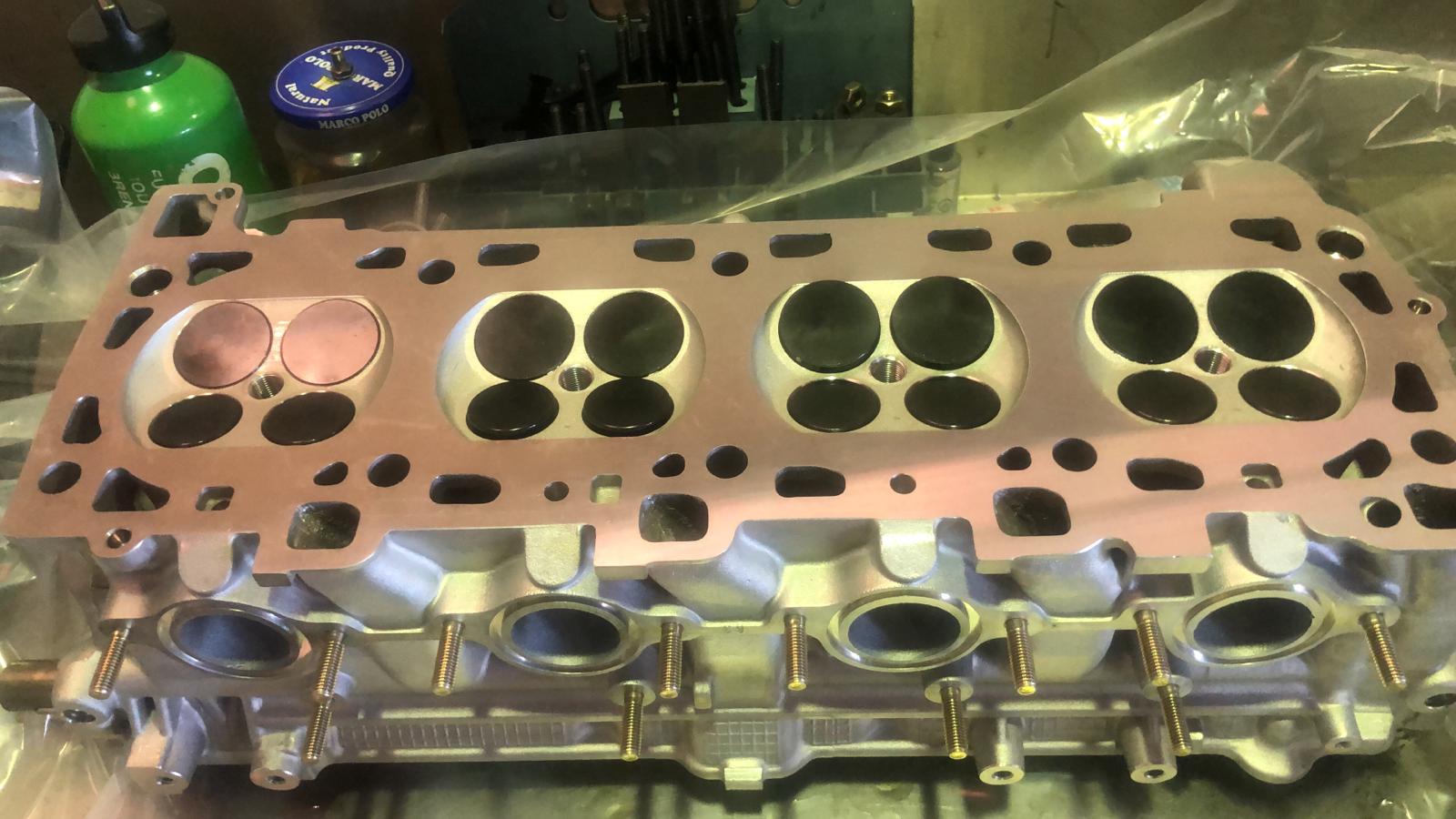

The 968 head has just come back from being built, once that's on we can finalize the mods the exhaust manifold/cross over.

Link Razor PDM wired up and now controlling the Fans/Coolant/Pump and the Rad Temp/pressure and EMAP sensors. It also supplies 12v power to the ECU/Injectors, COP Ignition and any other 12V loads, this has allowed me to delete the two most problematic relays, the fan and DME relays. Crusty old fan resistors are gone too and a ECU Master CAN-EGT amplifier installed in their place, EGT wiring will be coming in through the old throttle cable grommet (RHD). The PDM can control the fans to any speed I like with PWM.
