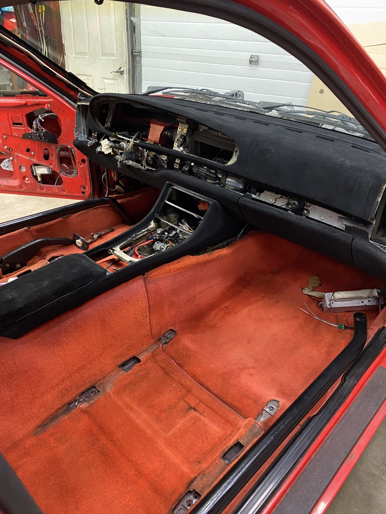

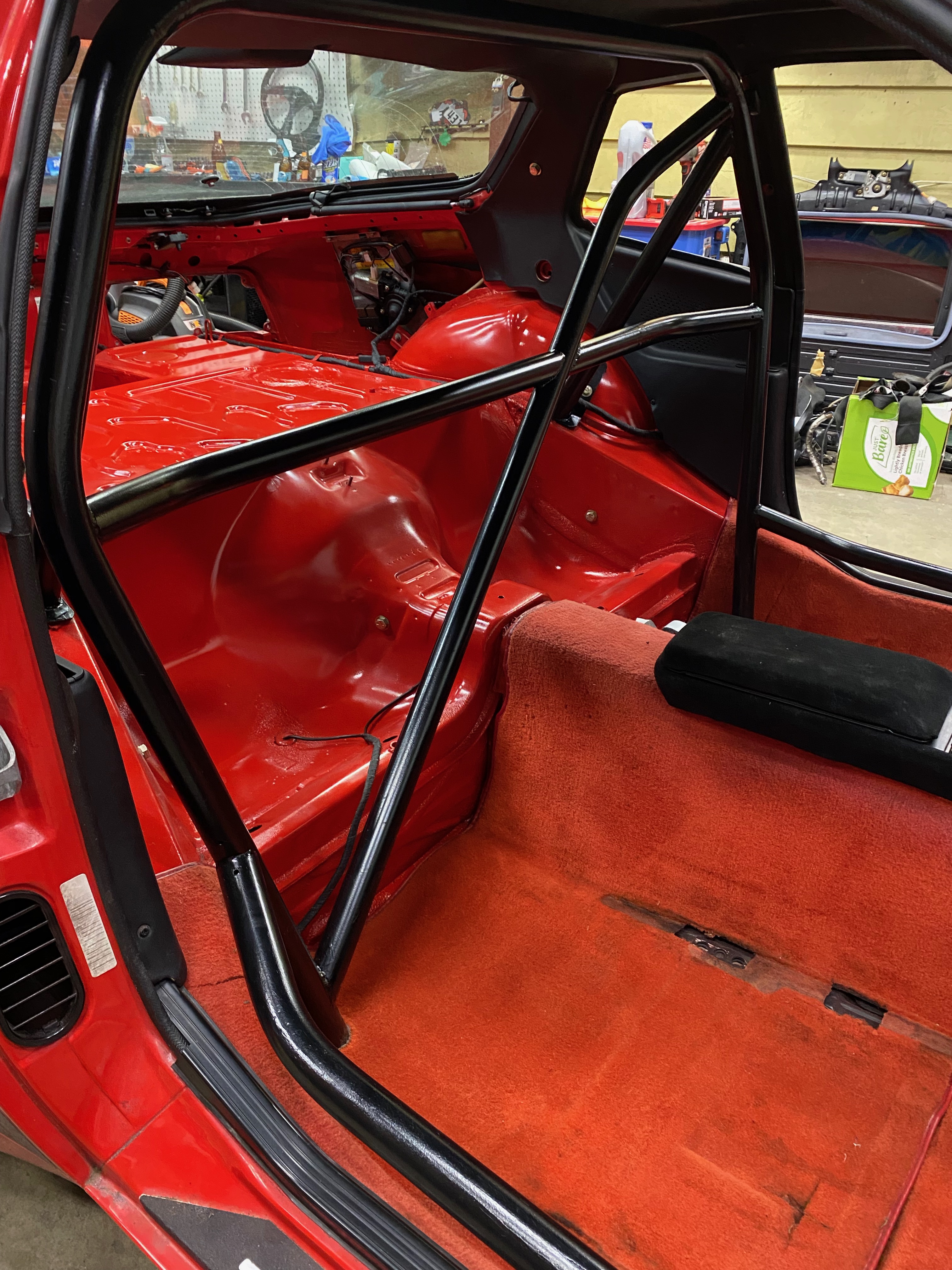

Once I got the engine out all of my attention went to the inside. I went back and forth so many times trying to decide if I wanted to keep the full cage or not and eventually decided it would be worth cutting out the front half. Two of the main factors being that it rubbed on the roof and squeaked the whole time I was driving, and if I cut it then I'd be able to pull the dash and clean it up along with all the wiring. So I went to town with a sawzall and theres no going back now!
Sorry @Fast951 but it had to be done, maybe I'll try and find a way to re-mount the original boost gauge in there once it's all together again. I left the door bars and welded on caps to cover the holes so that they don't look too weird. Apparently I didn't take any shots until after I took the dash out but at the end of the day this is what I was dealing with.

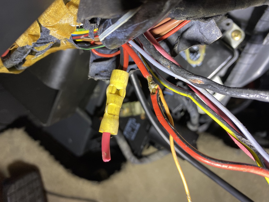

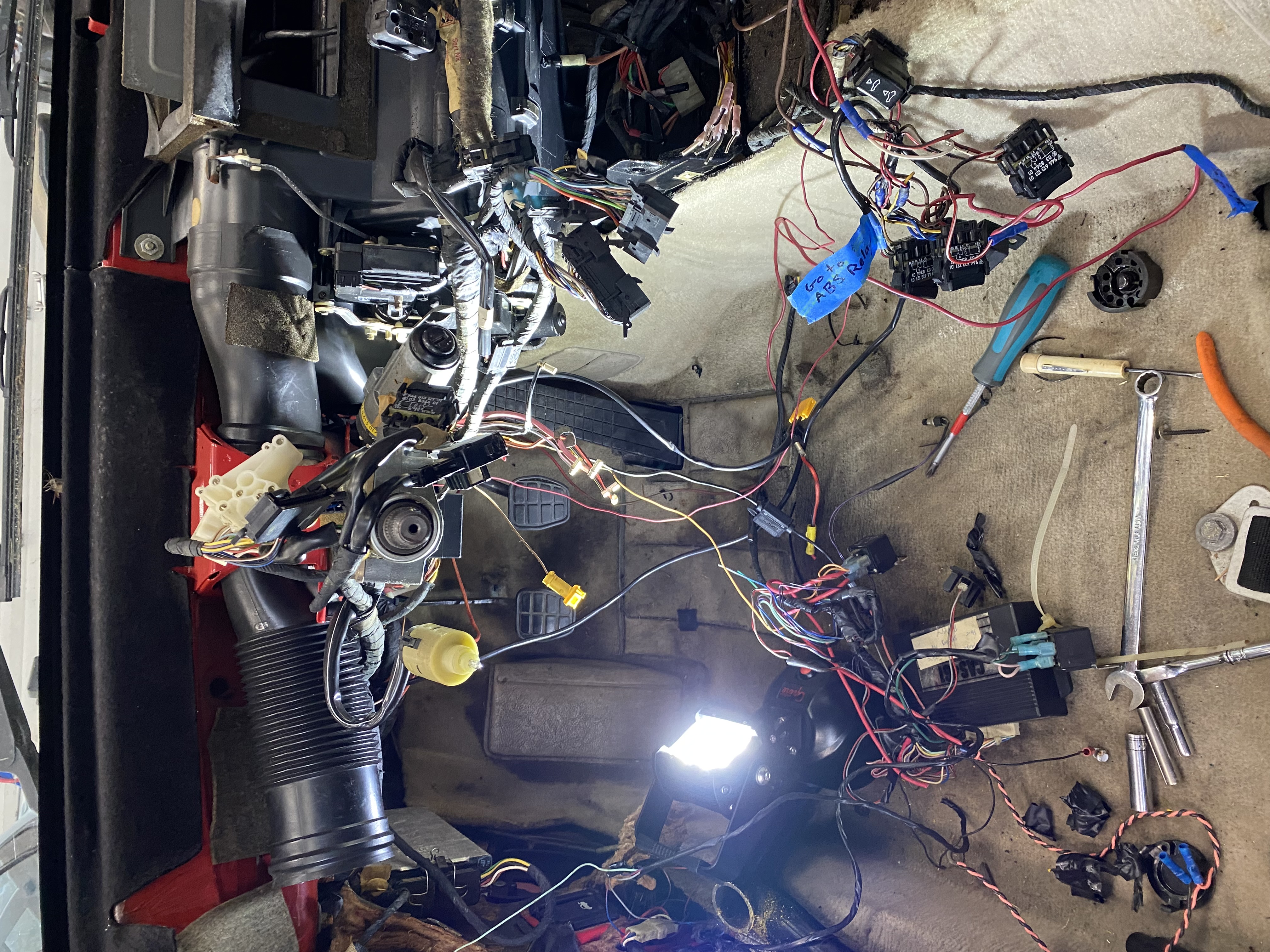

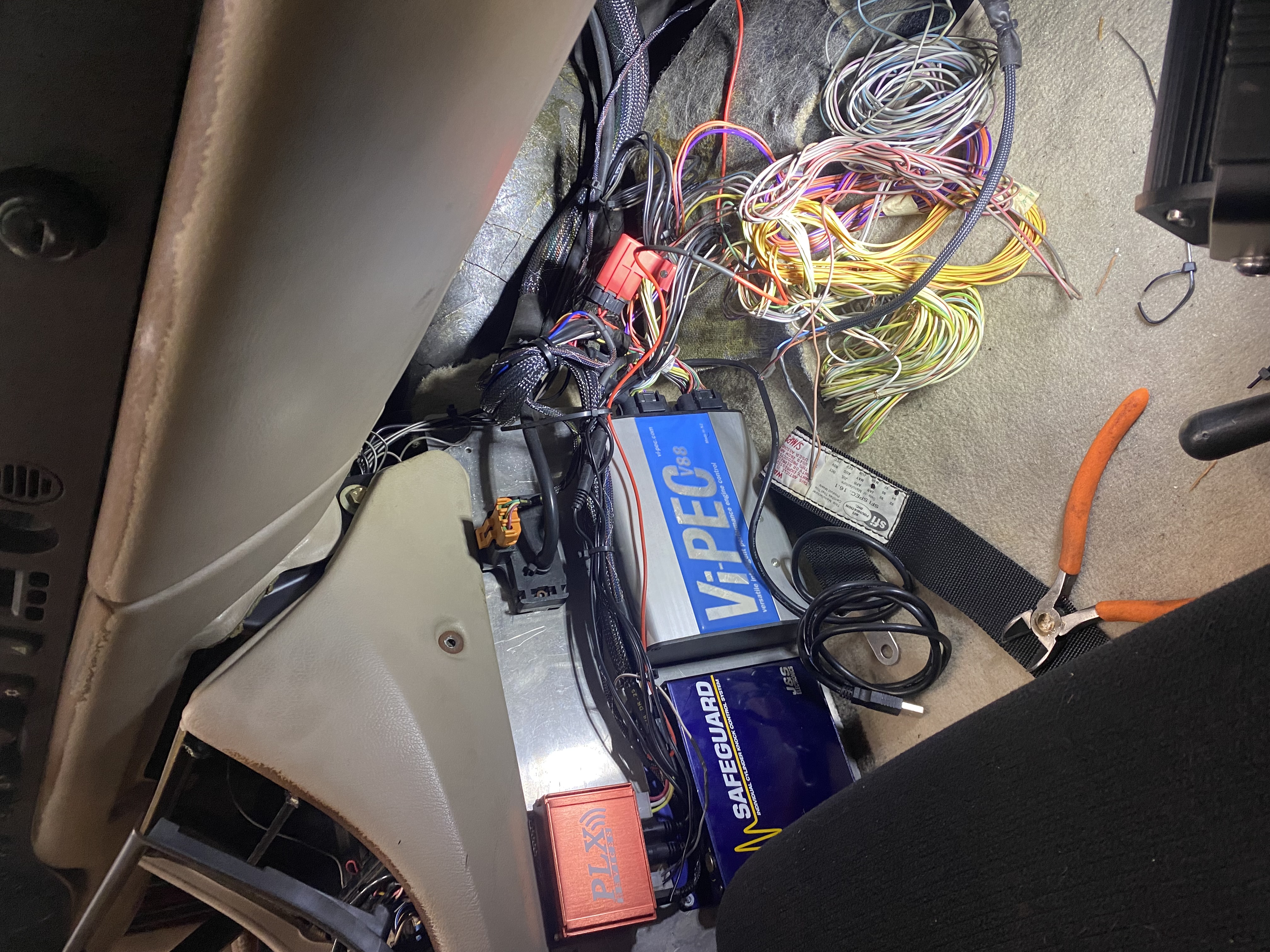

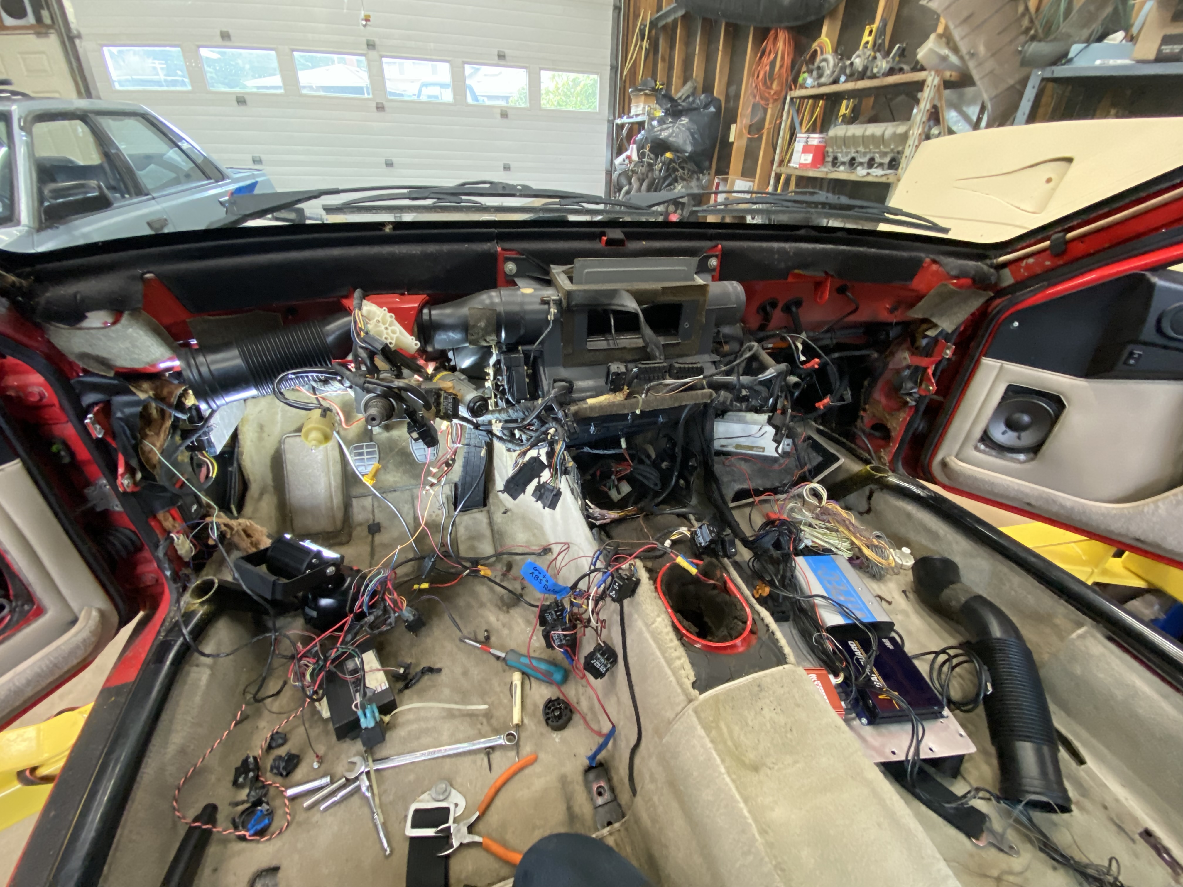

There were hours of fun finds under the dash, this car had the holy trinity of aftermarket wiring to sort through between old sound systems, alarm systems, and having had multiple ECU's. Whoever installed the alarm system drilled a hole in the center of the cowl drain to ground it which caused a decent bit of water to get in. It was incredibly satisfying to rip out all of the stuff I'm not gonna need. Also cleaned up the exposed wires at the backside of the ignition and went ahead and pulled the engine harness all the way out. I'm not sure which ECU I'm gonna use on this but it's probably going to be something a little more modern than the Vipec.

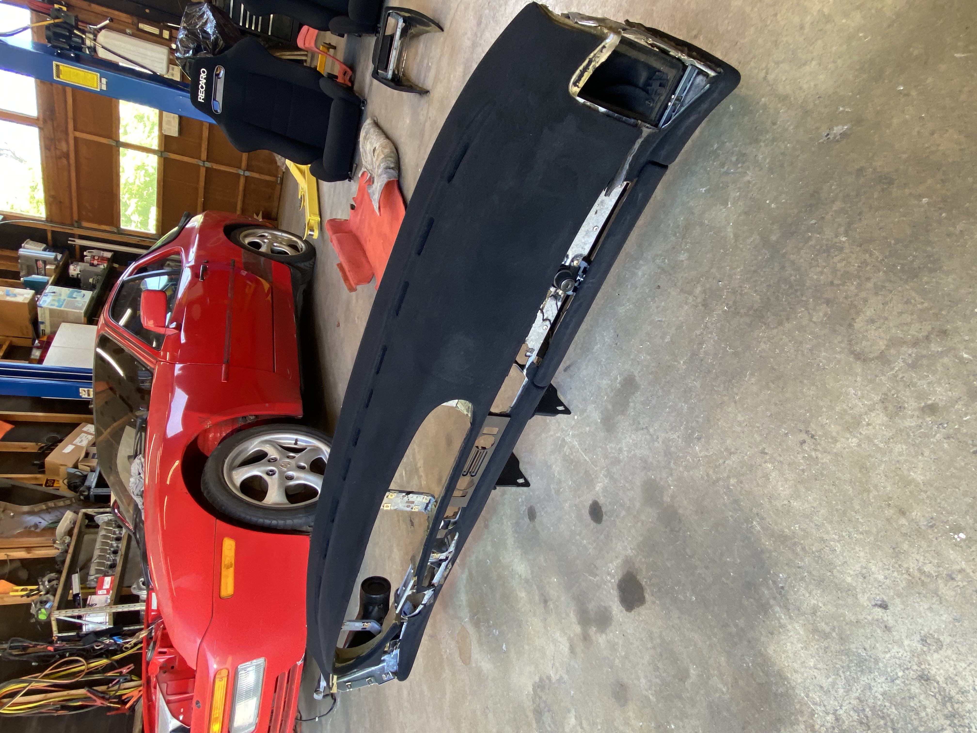

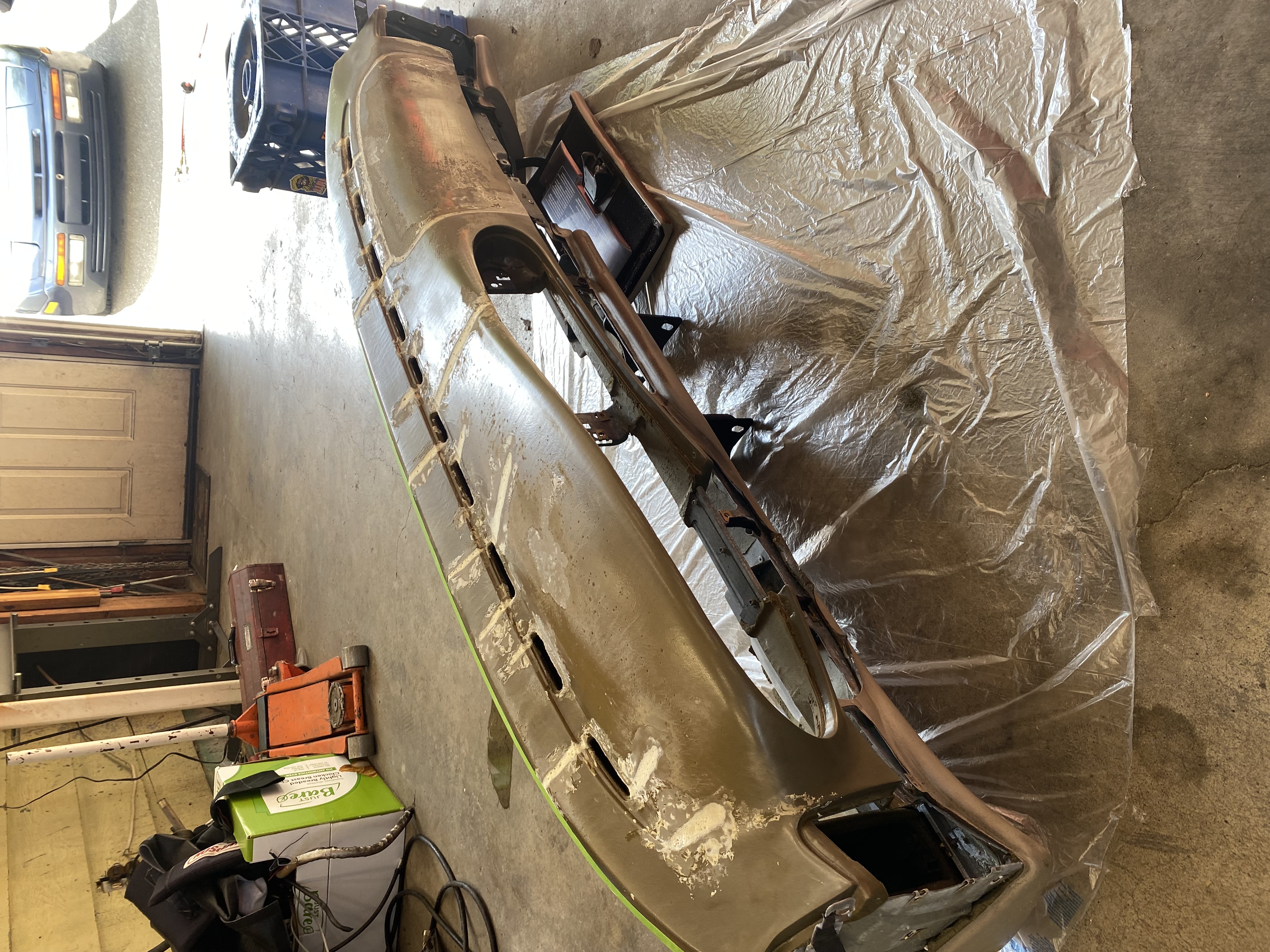

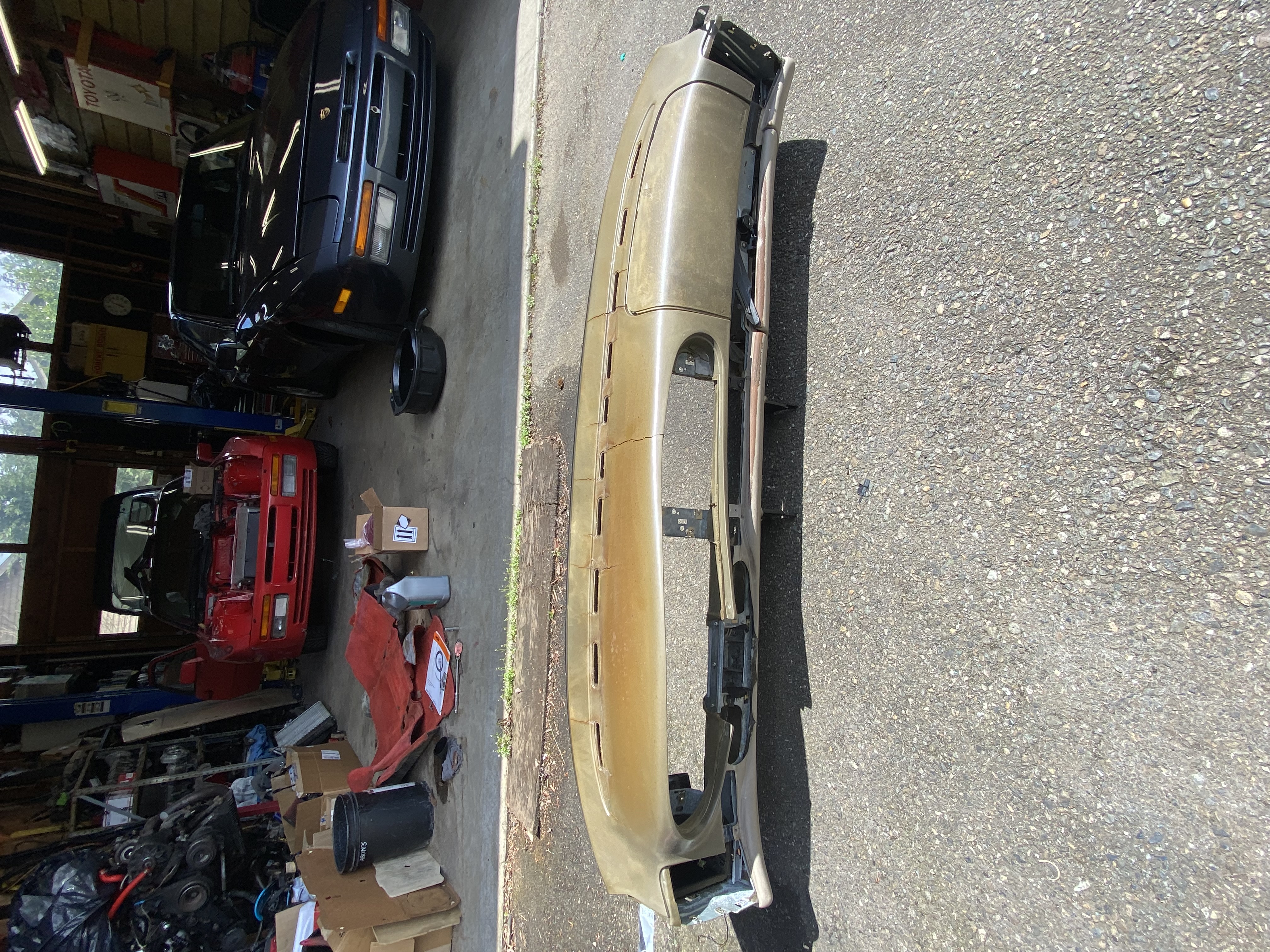

The dash was also in rough shape. The vinyl was peeling up and it only took about 2 minutes to completely peel the top layer off. I've always wanted to try flocking a dash so I figured this was the perfect candidate. I dremeled out all of the cracks and used expanding foam to fill all of them. I also pulled the passenger airbag and foamed over the airbag seams. I then sanded down all the foam and coated the whole thing with a layer of clear urethane coating for boats which will hopefully add some UV protection (I'm not sure how well this is gonna hold up so I'll report back if it starts cracking again).
The flock is amazing at hiding imperfections! It's super easy and I'm actually really happy with how it turned out. It's not perfect but overall huge improvement from where it was. (And MUCH cheaper than buying a new dash)

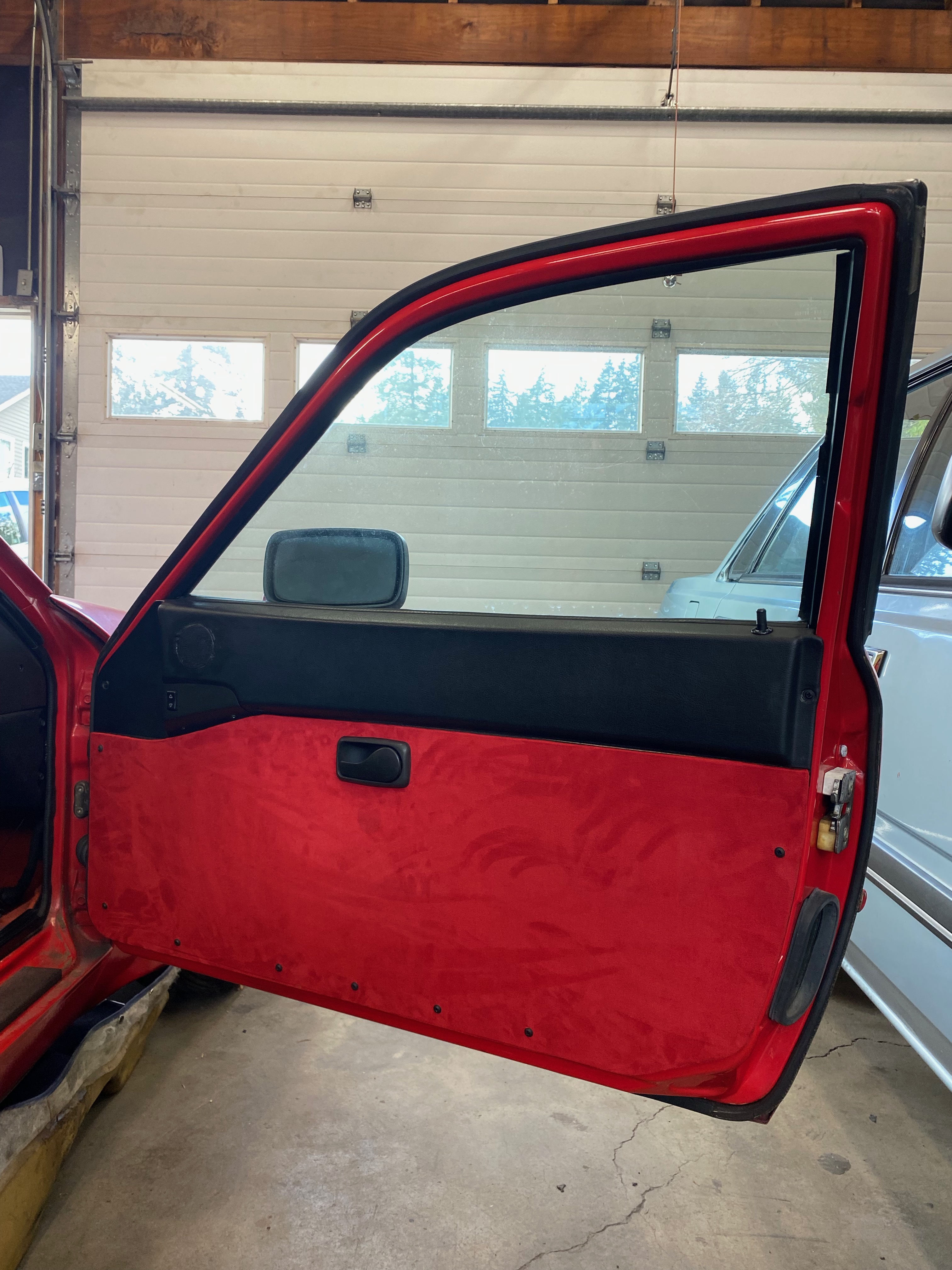

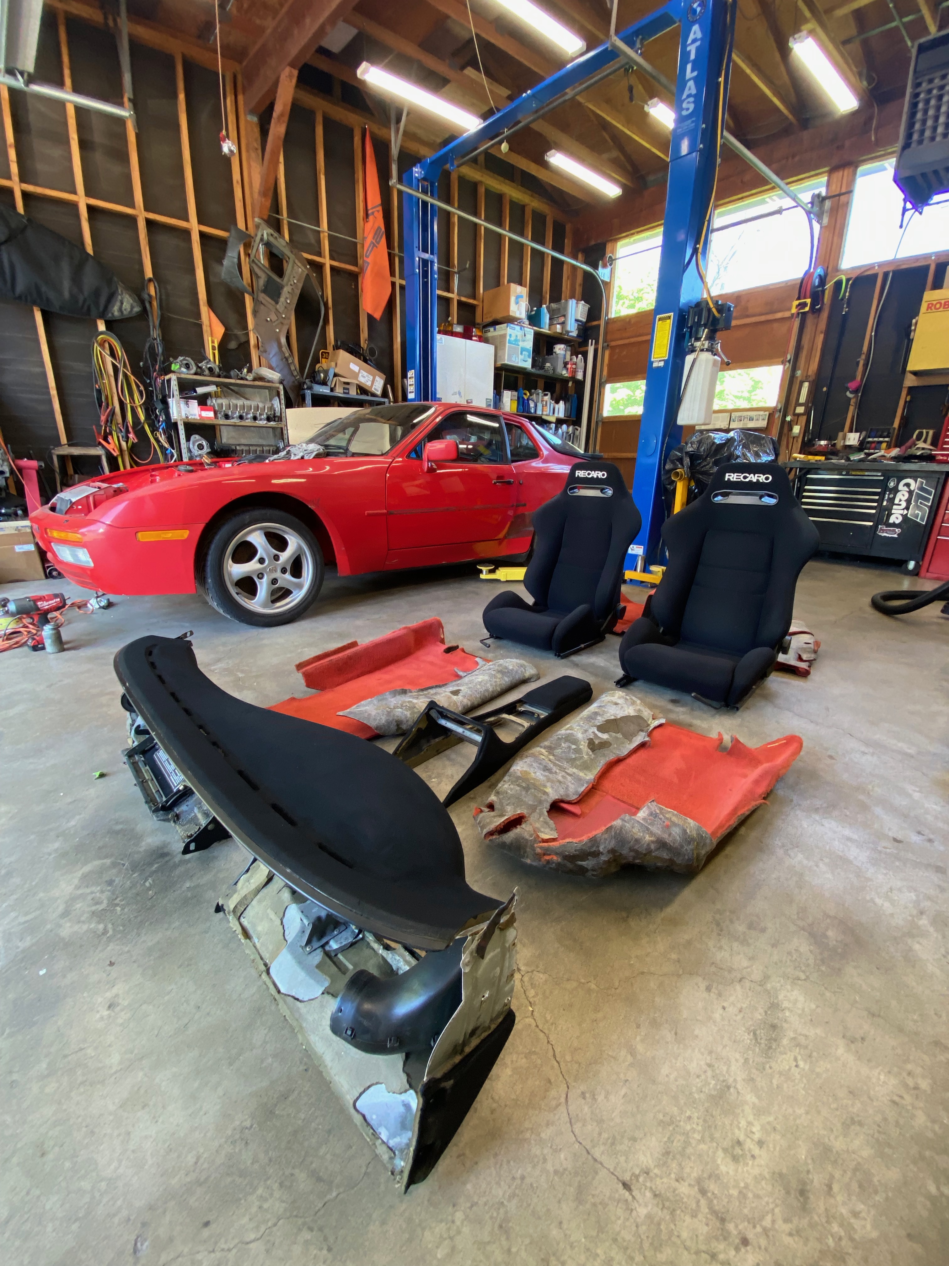

While doing the dash it occurred to me that the worn out carpet wasn't gonna cut it, so a quick trip to Plyhammer parts produced set of Can Can red carpets! only the fronts though. This spiraled into scraping all of the sound deadening out of the rear half of the car and giving it a fresh coat of paint. Also rolled on a fresh coat of paint for the cage.
Overall for a budget interior refresh I'm pretty happy with it. It is offensively red now but I'm hoping once the seats are in it will tone it down a little.

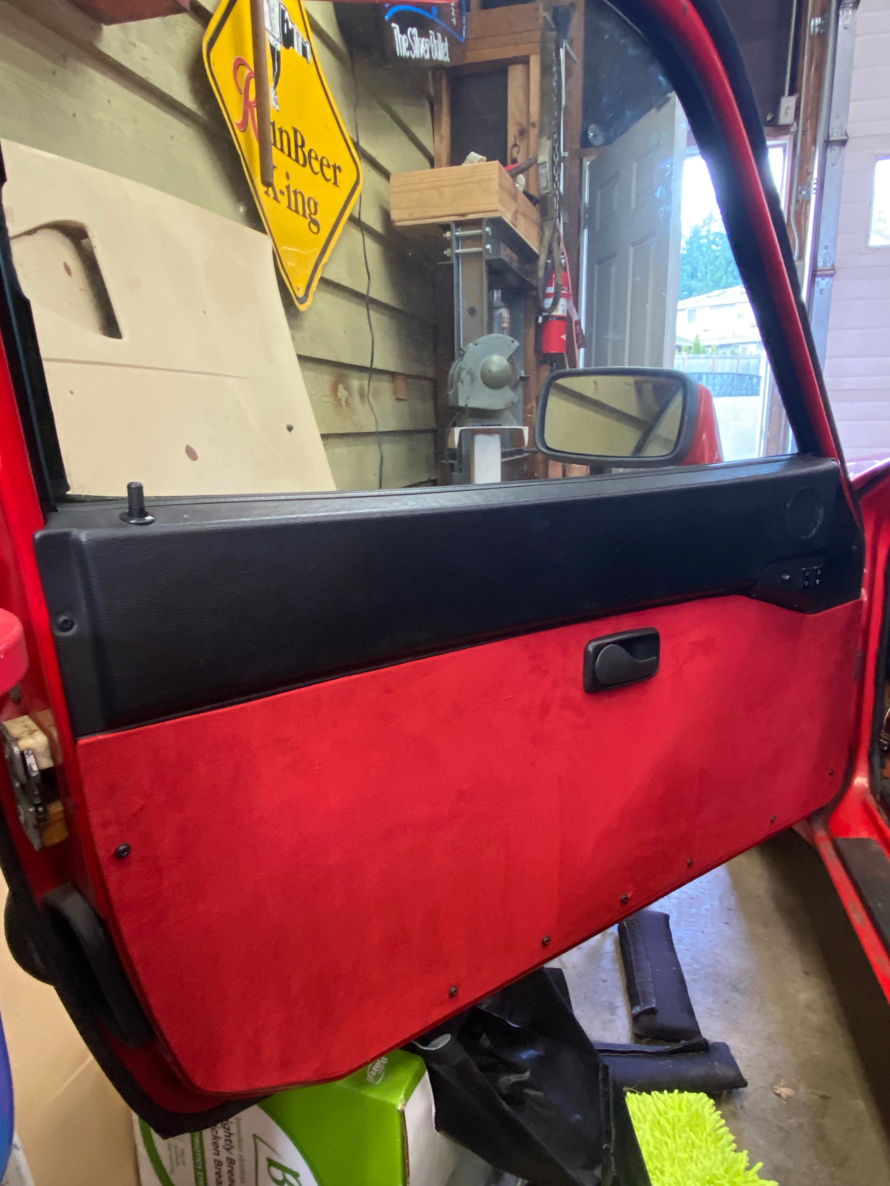

For the door cards I got some 1/8" hardboard at home depot and cut it to size to fit the lower portion of the door. Then went to Joann's and found some red fabric I liked. Wrapped the panels and used a bunch of spray adhesive to hold it all together long enough for me to bolt them to the doors. I filled the old tweeter holes with some Acrylic plastic I had and cut them to size. I'm not super happy with how that portion came out but if it really bothers me I'll buy some new door cards down the line.
Also realized after the fact that I'm going to need some kind of pull handles or straps for the doors but I'm really tired of doing interior stuff so that might be awhile.

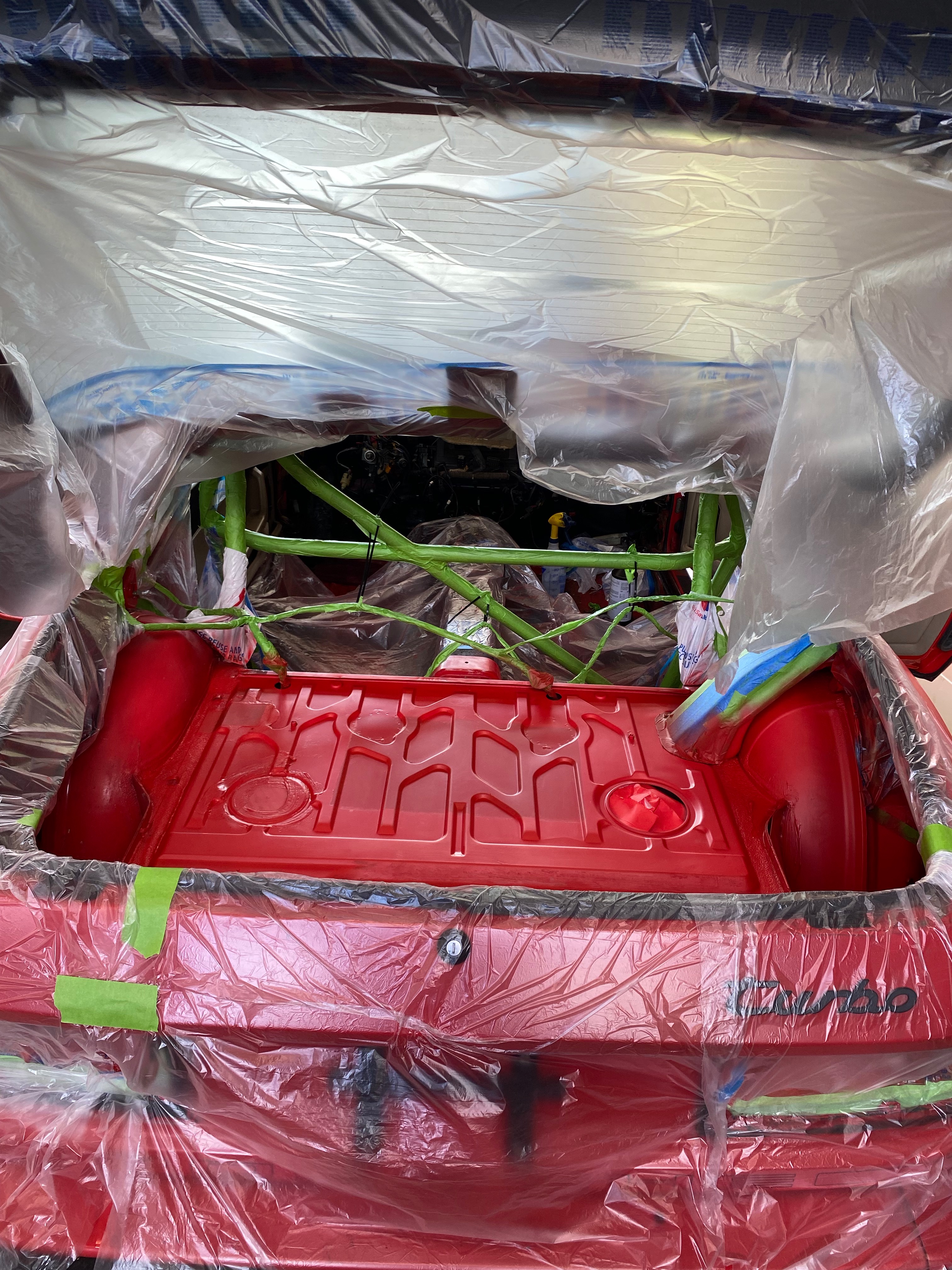

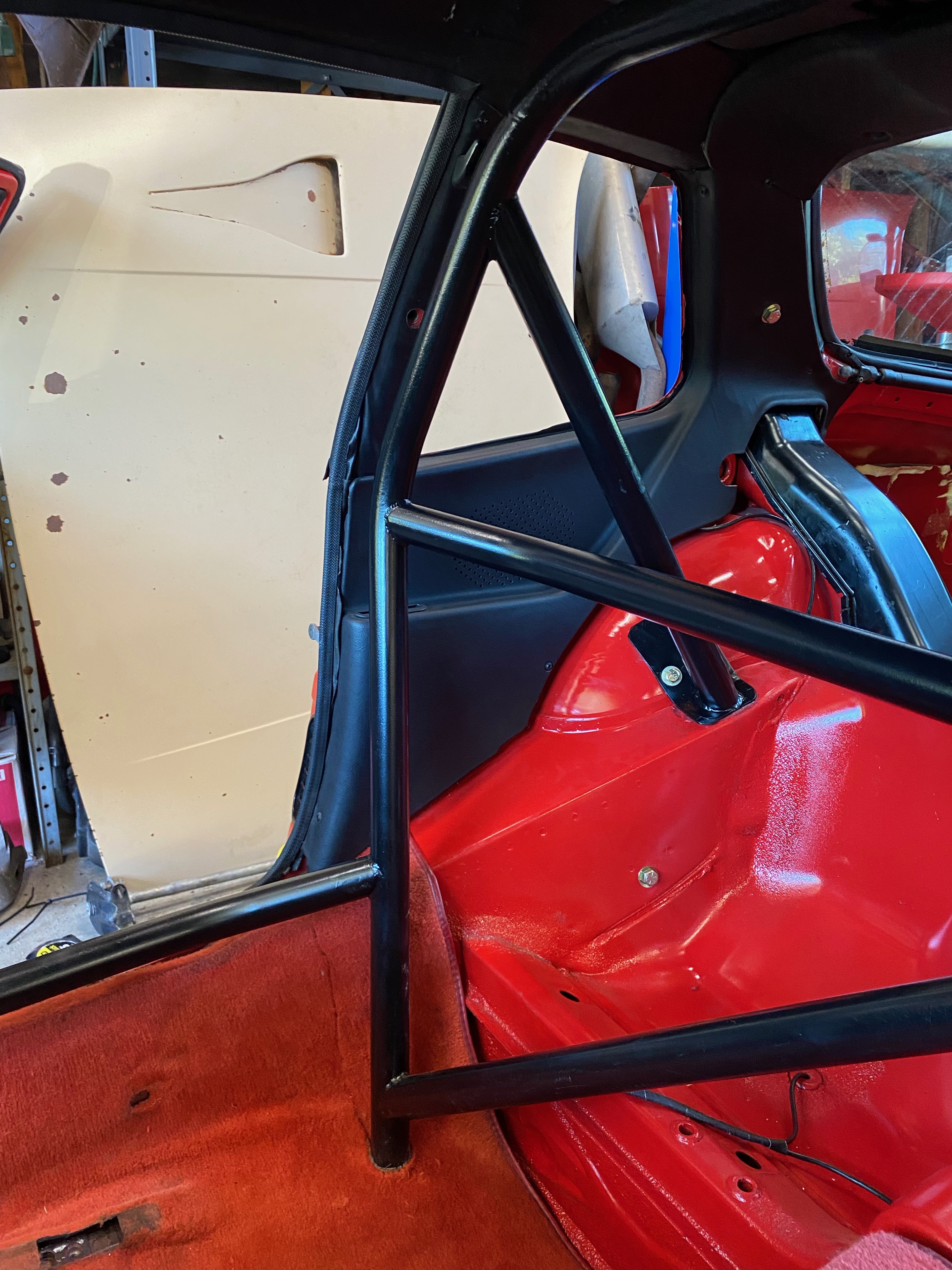

While painting stuff in the rear I also replaced the busted tail-lights with a good set and resealed them, and added a harness bar thats at a better angle for where I need to have the seat.

A few items I remember the car having, and to watch out for when rewiring:
- ABS ON/OFF switch to reset ABS.
- Shift light with pills (yellow tab in the dash vent)
- Digital sound processor, stereo.. original owner had a stereo shop. I noticed some of which were taken out.
In the engine bay, the car had an oil filter canister with removable cartridges. It had an Accusump connected to it. I strongly recommend adding a large oil cooler, especially if you intend to track it..
The turbo on it now is a different unit.
I do recall installing a 60-2 (or maybe 36-1) trigger wheel behind the crank pulley (covered with the plastic belt cover). The VR trigger sensor was the small electromotive unit. Motec was not happy with it. I would replace it with something else if you intend to use the crank trigger wheel.
As I recall, the engine had high compression. Be careful with the tuning!!!!
Lots of memories, plenty forgotten (easy to forget after 24 years). I really disliked the old Motec, it's idiosyncrasies and the customer support (or lack of it). One of the main reasons I started messing with the Motronic. (Maybe it was a curse? LOL).
