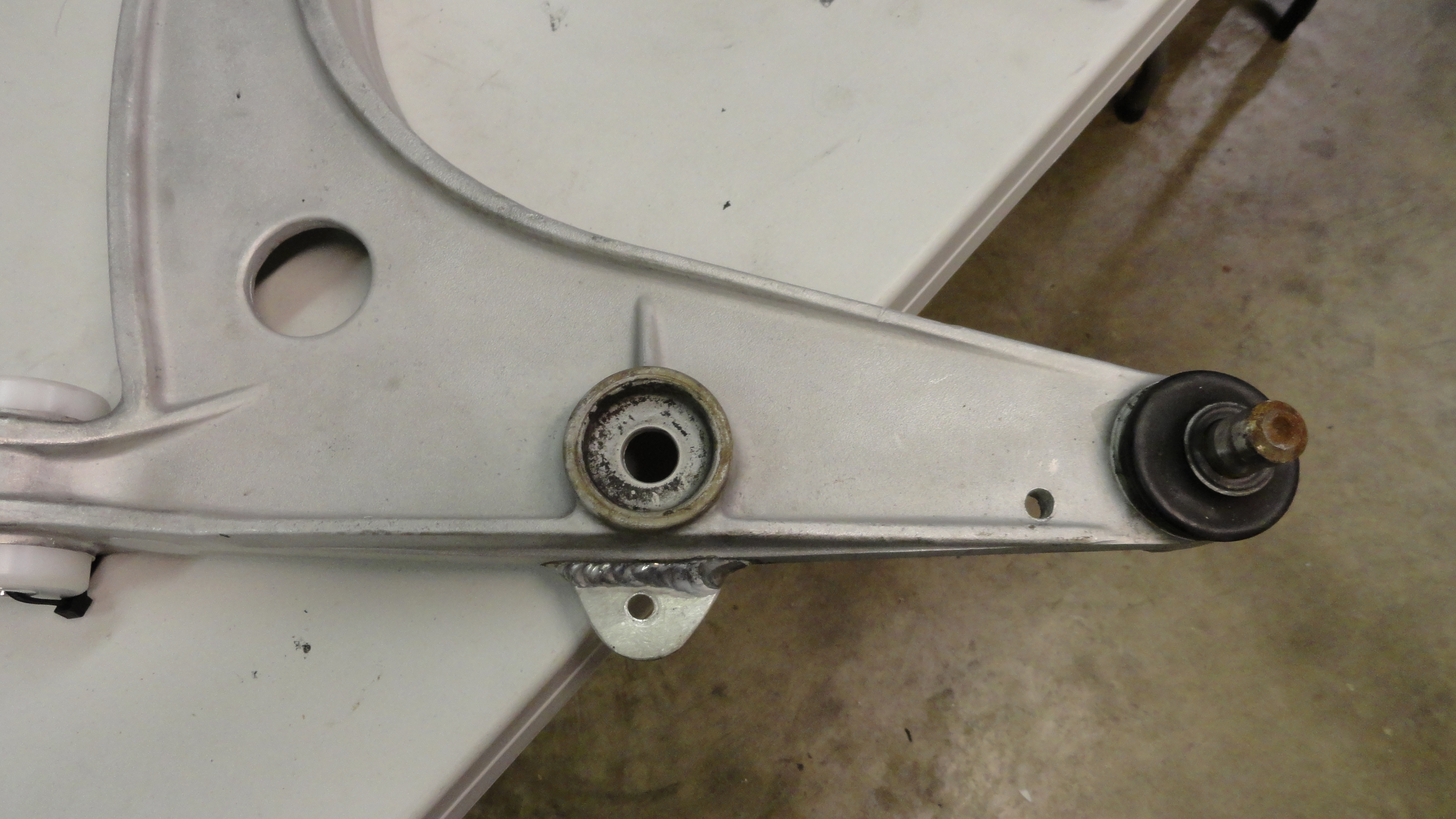

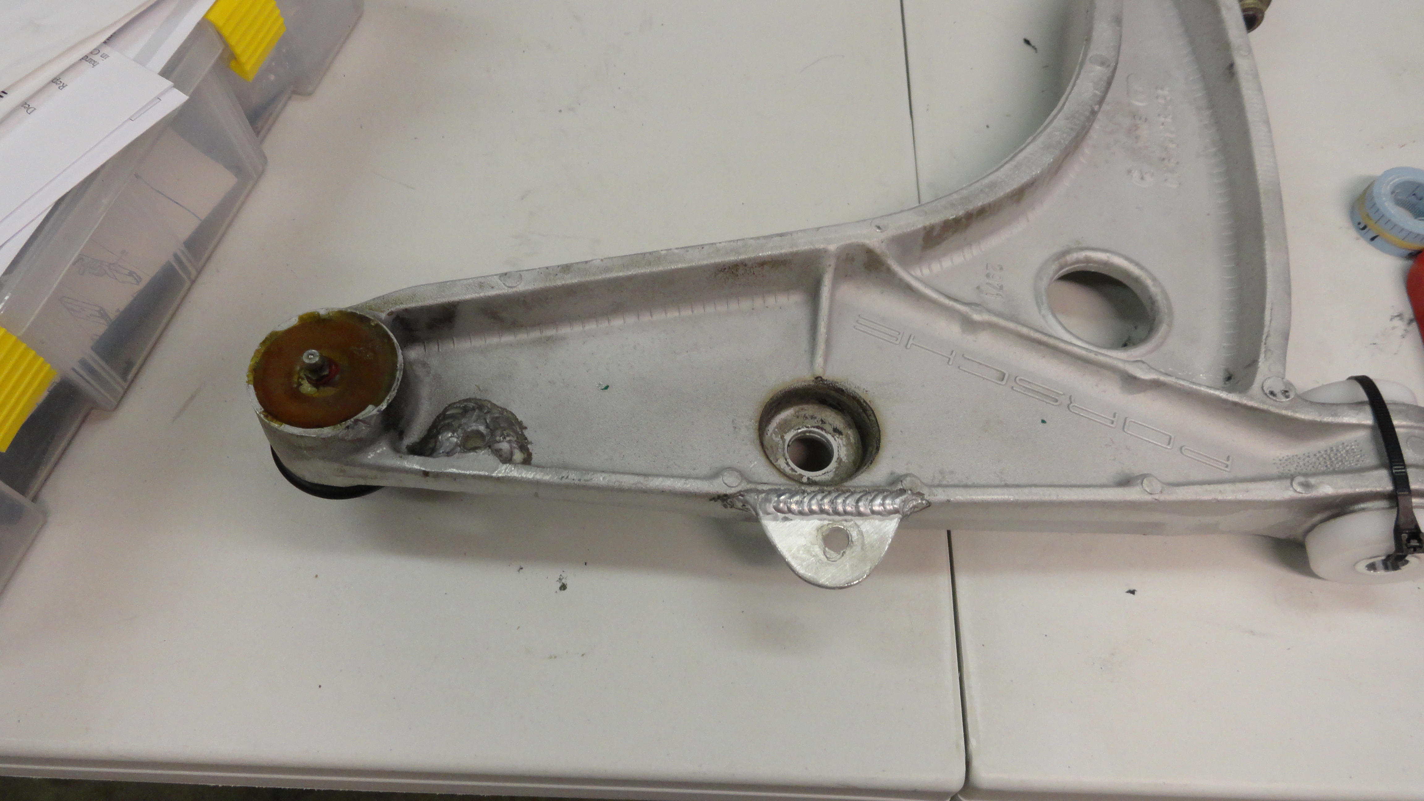

I had tabs welded to the arms, and drilled one hole in the arm.
Re: Porsche 968 Brake Cooling Air Deflector Duct for 951
Posted: Wed Mar 20, 2024 6:42 am
by pedros951
Cruise98 wrote: Wed Mar 20, 2024 6:07 am DSC05438.JPGDSC05437.JPG
thank you! perfect!

I've seen a bracket secured to the anti roll bar mounting.
