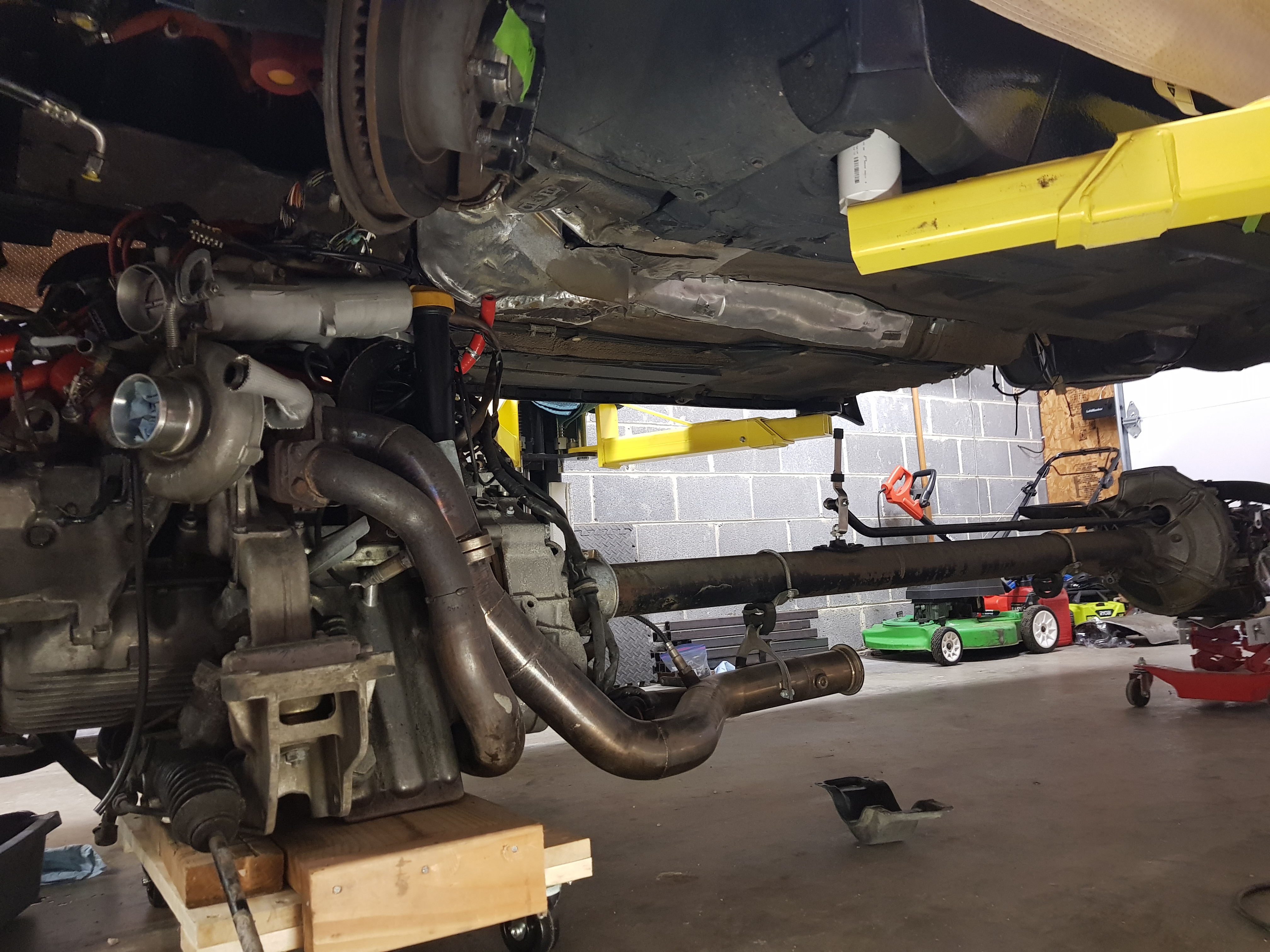

I am not yet convinced this method is faster, but it does lead to a LOT more "while you are in there" moments. I was doing the ER Polybronze bushings anyway. Plus, I wanted to try something new. There are pros and cons to this, just like everything else.
