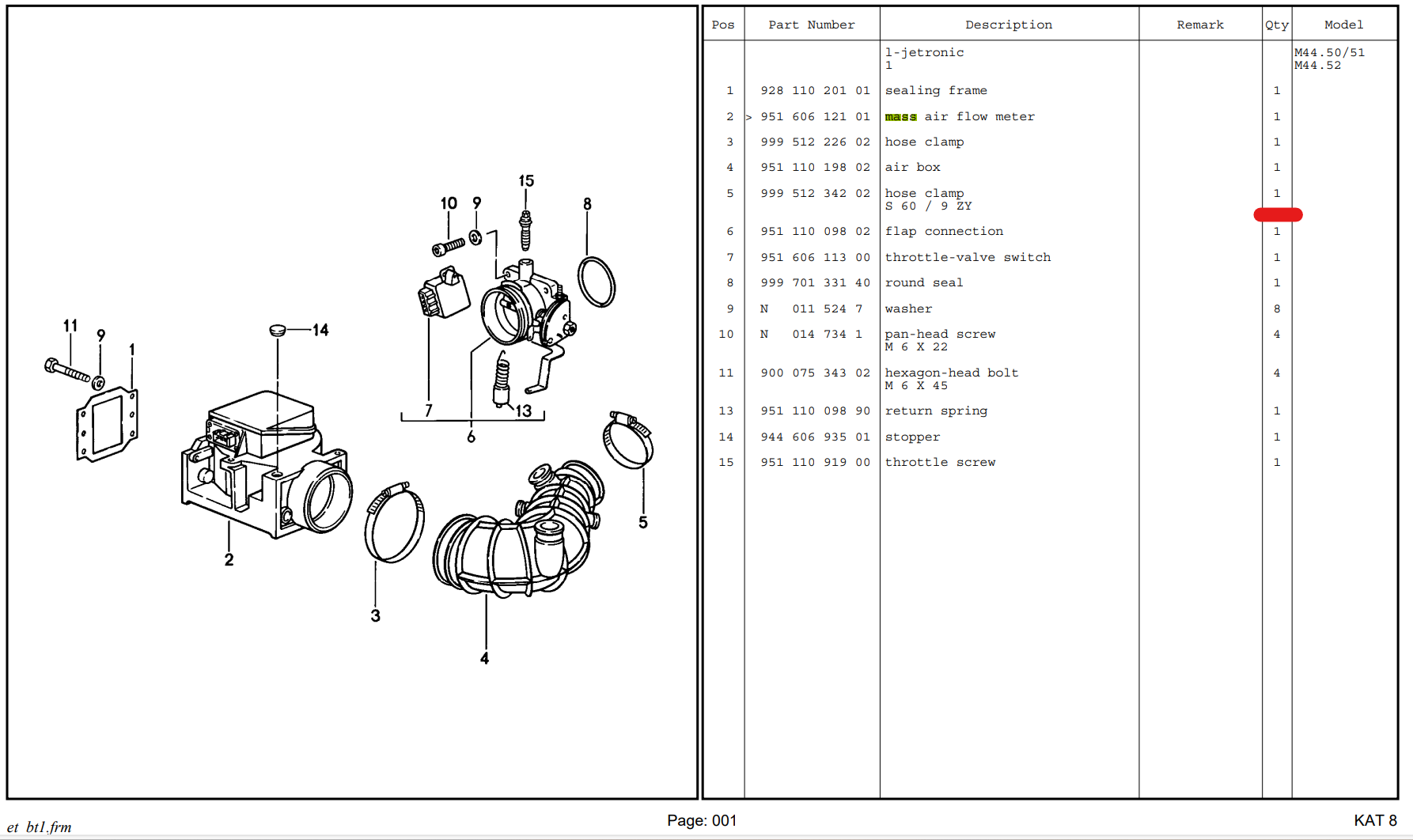

Well without the top of the air filter box, the hood closes without any issue at all. The air flow meter is located to the left of the air box so not under it? The air flow meter also doesn't seem to be mounted on L shaped brackets, but the air box is. That's from memory.. here's a pic of the PET. In any case, I completely restored all the mounting points, meaning that I put new rubbers in the mounts, with the metal sleeves pressed in them. So it should be flush as OEM intended.
I meant adjusting the back of the hood to sit higher so the slope is a bit higher %, hopefully just enough so that the hood doesn't hit the air box.

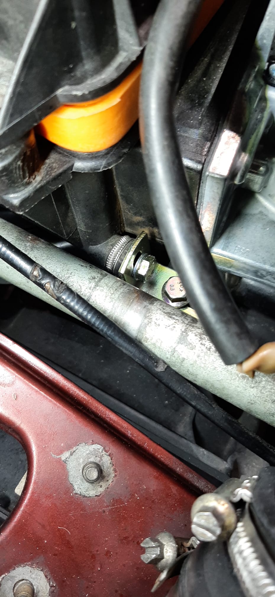

I checked my air box again today, and the screws that sit in the L profile were indeed positioned a bit high. I loosened them and pushed them all the way down and retightened. I got a good 2 - 3 mm height reduction from that but the hood still doesn't close correctly with the top + air filter.. Thought I had it though.
I also noticed the clamp of the turbo pipe was sitting on the top (the part you use to tighten it) so I thought maybe that's it, but after re-orienting the clamp, the hood still hits.
I then tried (even though I never touched it) to remove the powersteering reservoir but that also did nothing.
At the moment, the only thing that helps me close the hood is removing the top of the air filter box so I think I need to continue looking there...
Is there some other connection that could make the air filter box sit higher than usual?
here are two pictures of my air filter box L profiles after the adjustment, do they look correct?

I notice the air filter lid is not fully seated in that second picture. Could it be that simple? If not, seems like your air filter box is sitting up too high for some reason. Maybe post a few more picture further back for more perspective -- curious if it 'looks' too high? How high is it compared to the IC pipes that run around it for example? Those little mounting bushings with the metal tube inserts can be confusing too. I'm thinking you need to take the air filter box out and make sure everything is installed as intended with nothing hanging up somewhere etc. If the hood opens and closes with with the air-filter top removed, and none of the hood gaps are way way off when the hood is closed, it's hard to imagine anything other than the air box being too high, right?

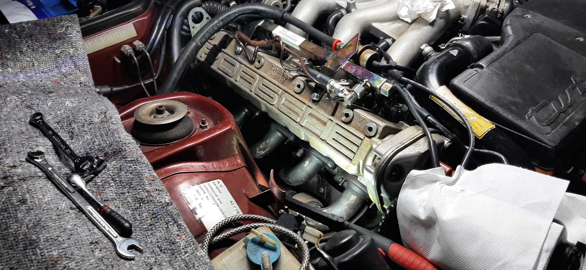

I'm currently working on replacing the exhaust manifold so I can't take any 'complete' pictures of the engine bay and how the hood sits. But here is a picture that shows the air box (took it while working on the exhaust, so I didn't mean to center the air box - forgot about taking those pics).
The top of the filter is indeed loose atm, but it sits correctly. If you close the hood, I would imagine that it compresses the box so this shouldn't be an issue. I can double check once the car is put back together.
As for the mounting bushings, I pressed the black rubber round seals in the slots, and then pressed the metal tube inserts into them. So they are not stacked.
It is indeed 99% sure that it's the airbox or something related to the air box that is the issue here... but it does seem like the pipes around it are equal in height. Confusing for sure.

I wouldn't rule out the possibility of the top being held up too high by the filter if it's not fully seated. I've had to really work at getting the top to fit down over the filter all the way around.

Long shot here….but possibly the wrong air filter? Maybe yours has a thicker perimeter flange not allowing the lid to completely seat in its correct position?
