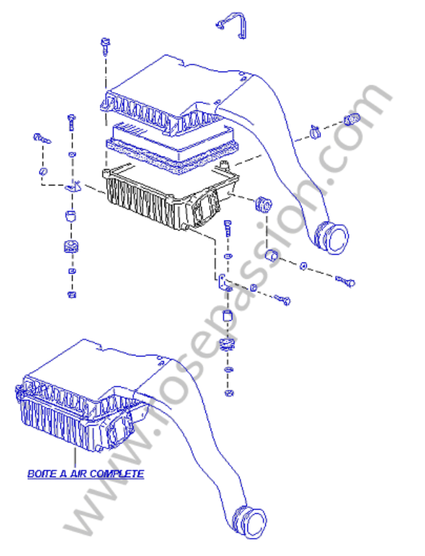

Well without the top of the air filter box, the hood closes without any issue at all. The air flow meter is located to the left of the air box so not under it? The air flow meter also doesn't seem to be mounted on L shaped brackets, but the air box is. That's from memory.. here's a pic of the PET. In any case, I completely restored all the mounting points, meaning that I put new rubbers in the mounts, with the metal sleeves pressed in them. So it should be flush as OEM intended.Tom wrote: Sat Dec 23, 2023 7:37 am The hood should sit flush with the fenders/headlights/nose panel, so I would not try to adjust it to sit higher. If it is hitting the air filter box, then look to see why that box is sitting too high. It sits on top of the air flow meter, which is mounted on little L-shaped brackets that have slots in them. If the AFM is not seated all the way down in those slots, everything will sit up too high. You sure that's what it is hitting?

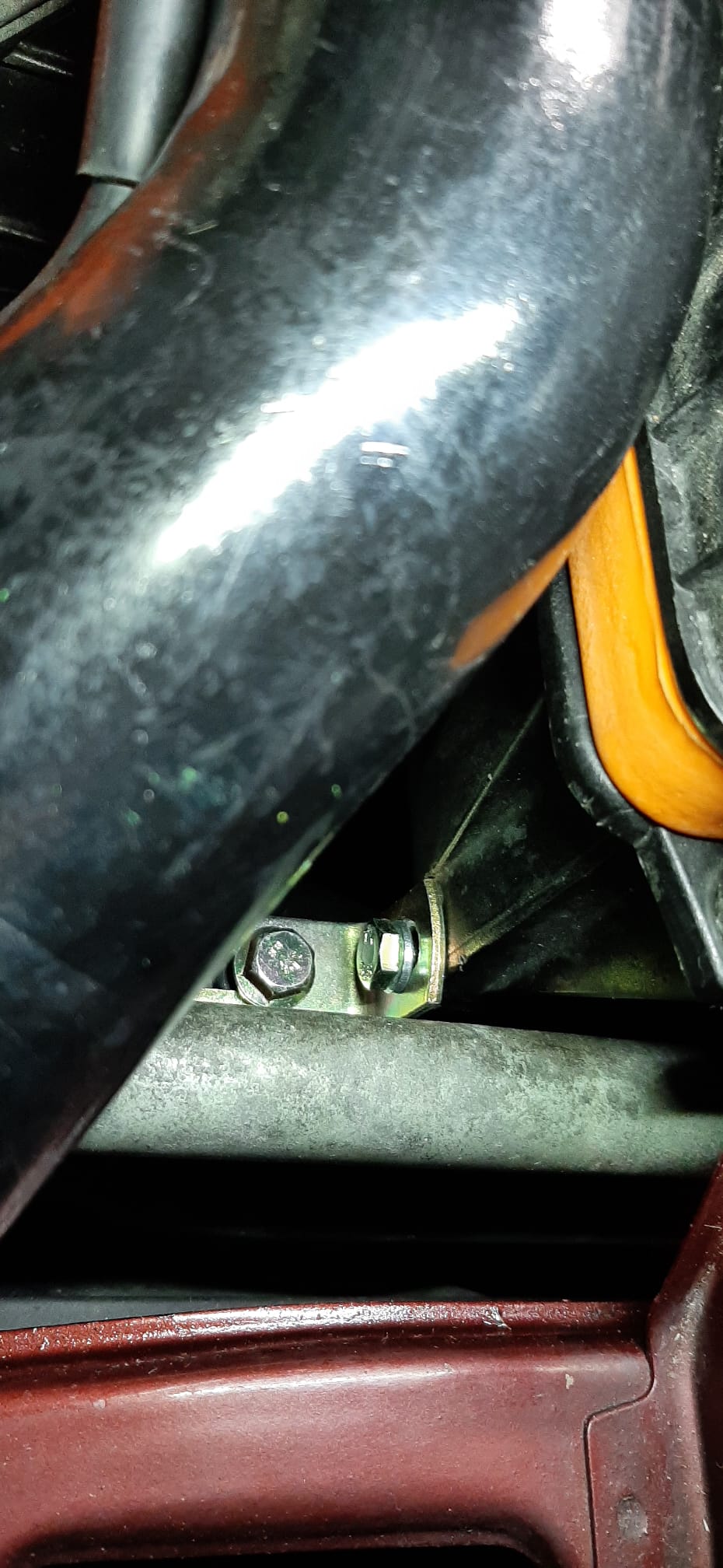

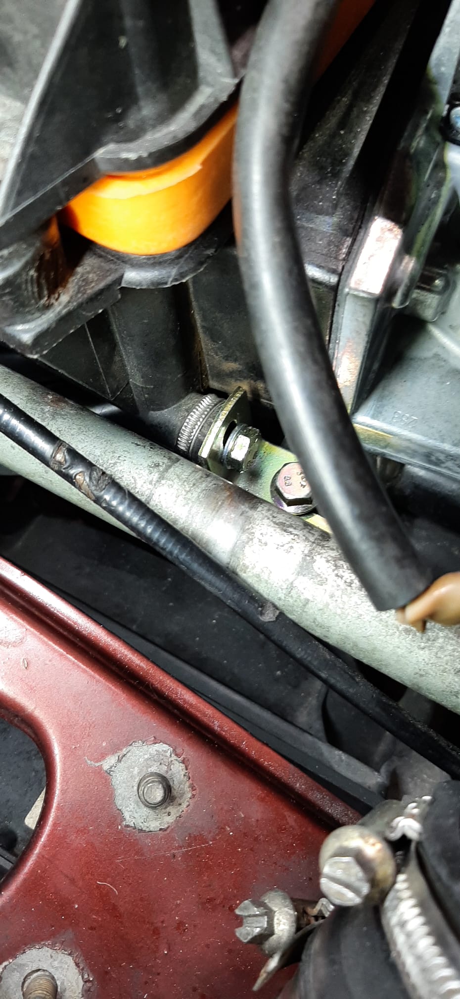

here are two pictures of my air filter box L profiles after the adjustment, do they look correct?
- Posts: 9207
- Has thanked: 961 times
- Been thanked: 4160 times
I notice the air filter lid is not fully seated in that second picture. Could it be that simple? If not, seems like your air filter box is sitting up too high for some reason. Maybe post a few more picture further back for more perspective -- curious if it 'looks' too high? How high is it compared to the IC pipes that run around it for example? Those little mounting bushings with the metal tube inserts can be confusing too. I'm thinking you need to take the air filter box out and make sure everything is installed as intended with nothing hanging up somewhere etc. If the hood opens and closes with with the air-filter top removed, and none of the hood gaps are way way off when the hood is closed, it's hard to imagine anything other than the air box being too high, right?

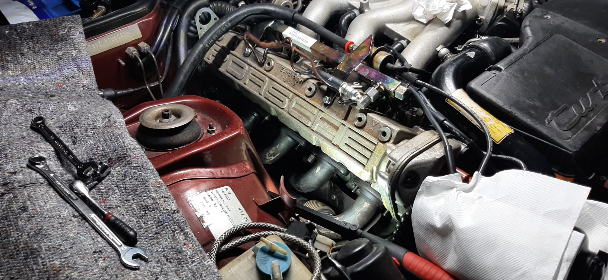

I'm currently working on replacing the exhaust manifold so I can't take any 'complete' pictures of the engine bay and how the hood sits. But here is a picture that shows the air box (took it while working on the exhaust, so I didn't mean to center the air box - forgot about taking those pics).Tom wrote: Tue Dec 26, 2023 1:53 pm I notice the air filter lid is not fully seated in that second picture. Could it be that simple? If not, seems like your air filter box is sitting up too high for some reason. Maybe post a few more picture further back for more perspective -- curious if it 'looks' too high? How high is it compared to the IC pipes that run around it for example? Those little mounting bushings with the metal tube inserts can be confusing too. I'm thinking you need to take the air filter box out and make sure everything is installed as intended with nothing hanging up somewhere etc. If the hood opens and closes with with the air-filter top removed, and none of the hood gaps are way way off when the hood is closed, it's hard to imagine anything other than the air box being too high, right?
The top of the filter is indeed loose atm, but it sits correctly. If you close the hood, I would imagine that it compresses the box so this shouldn't be an issue. I can double check once the car is put back together.
As for the mounting bushings, I pressed the black rubber round seals in the slots, and then pressed the metal tube inserts into them. So they are not stacked.
It is indeed 99% sure that it's the airbox or something related to the air box that is the issue here... but it does seem like the pipes around it are equal in height. Confusing for sure.
