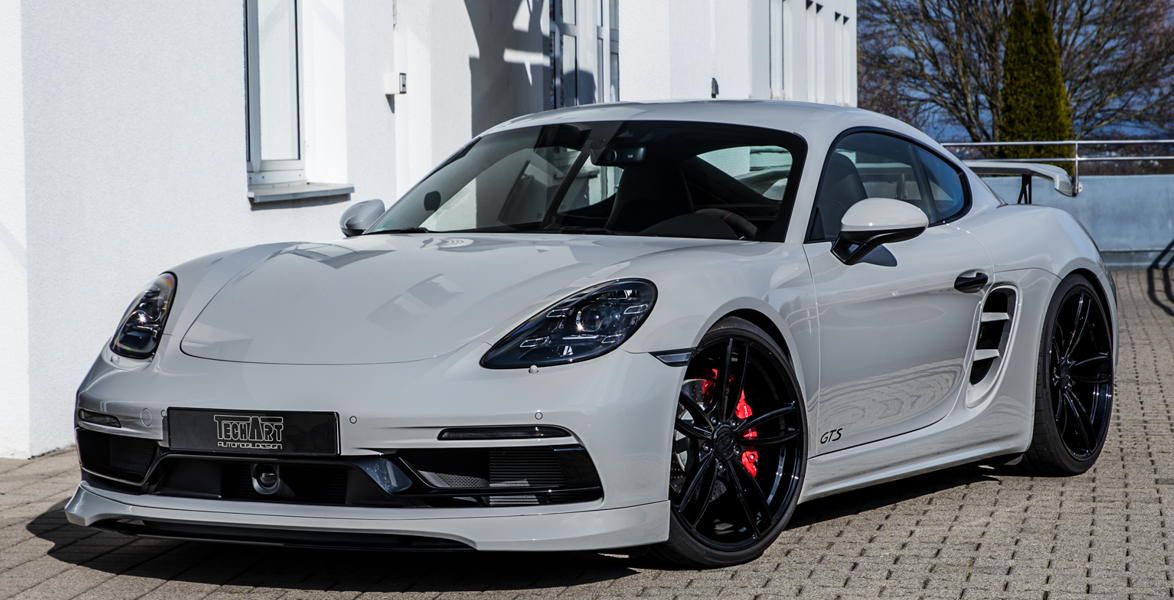

I am considering this front lip spoiler from Techart, it is available directly from them or from Suncoast for basically the same pricing.

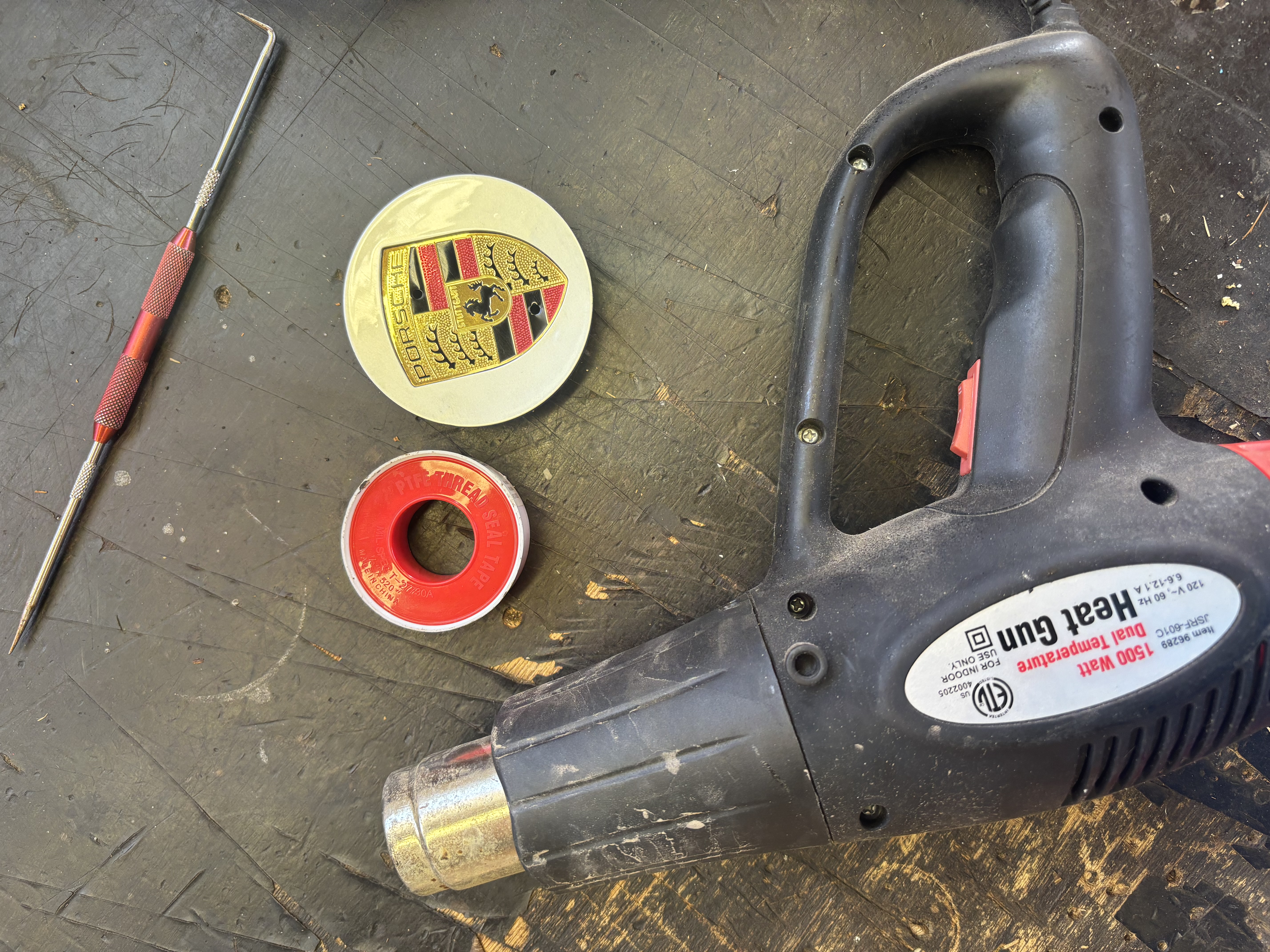

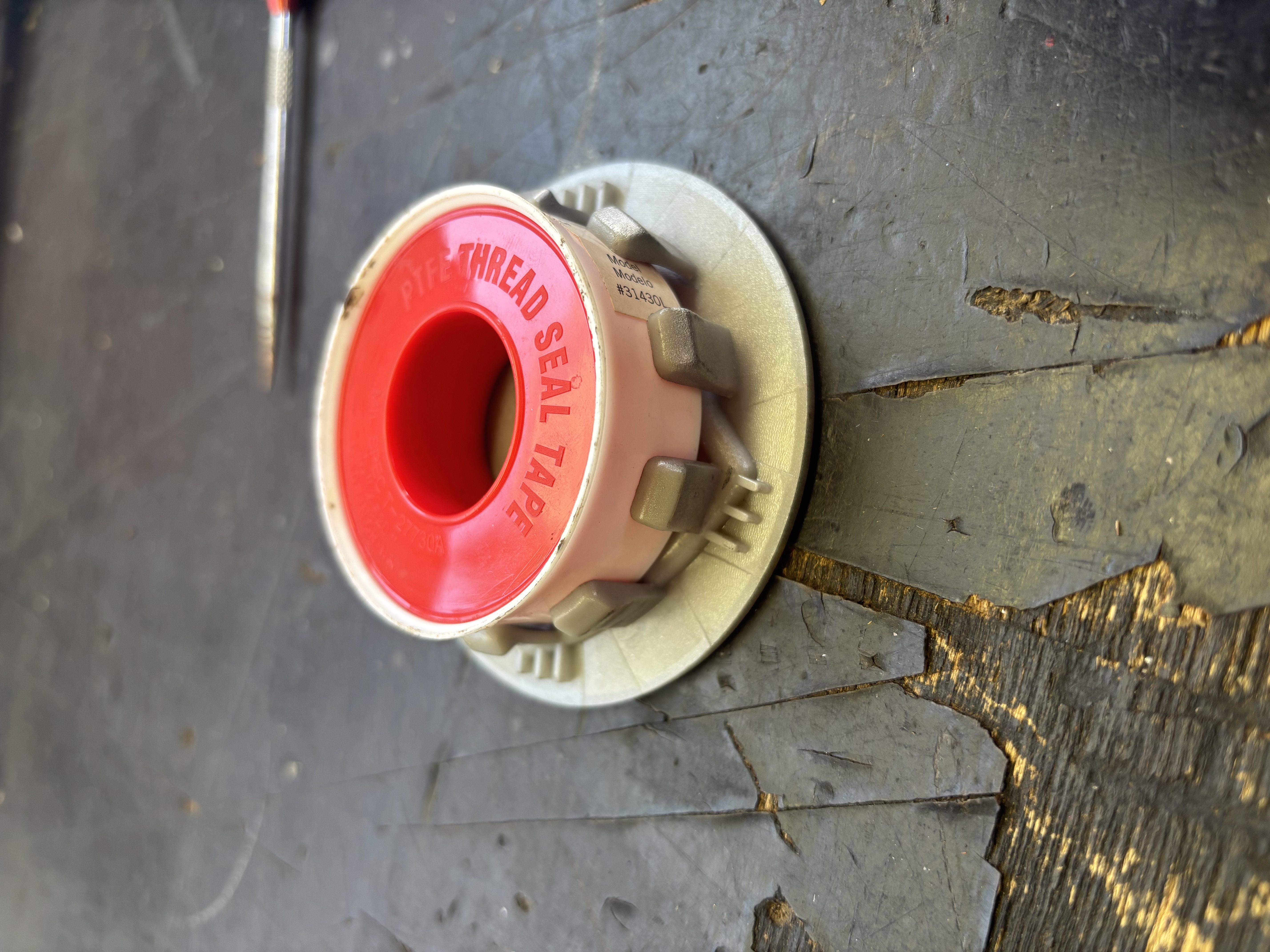

On my last track day I left on my center caps. The little teeth that grip the cap to the wheel have relaxed with the high heat and now the caps are loose. I simply inserted a roll of Teflon tape into the cap and heated them with a heat gun. When the cap had cooled I inserted it back into the wheel and it is once again a snug fit.
I realize this is not related to aero, more of a tips and tricks category but wanted this to have a wider view than the 718 sub-forum.

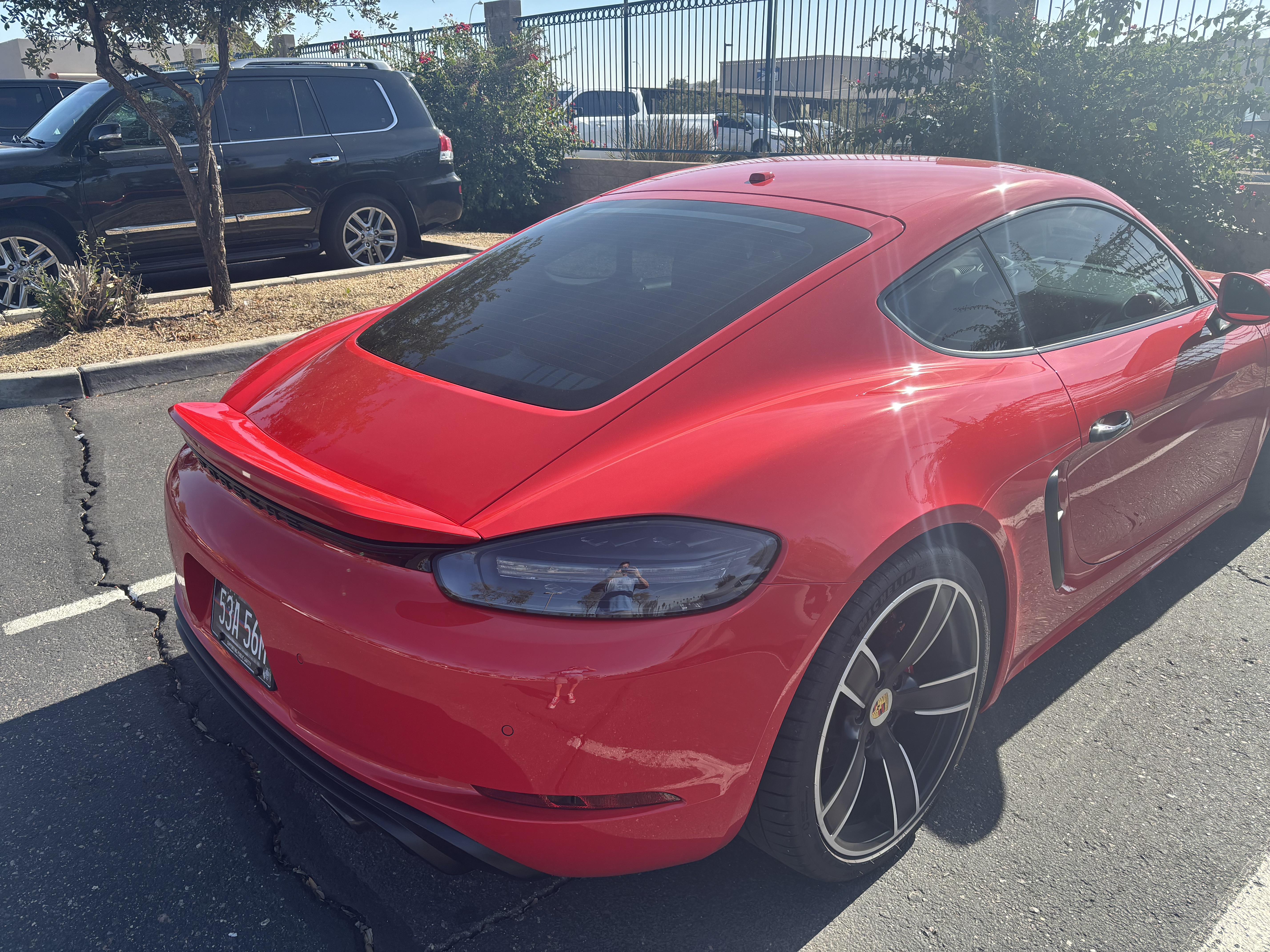

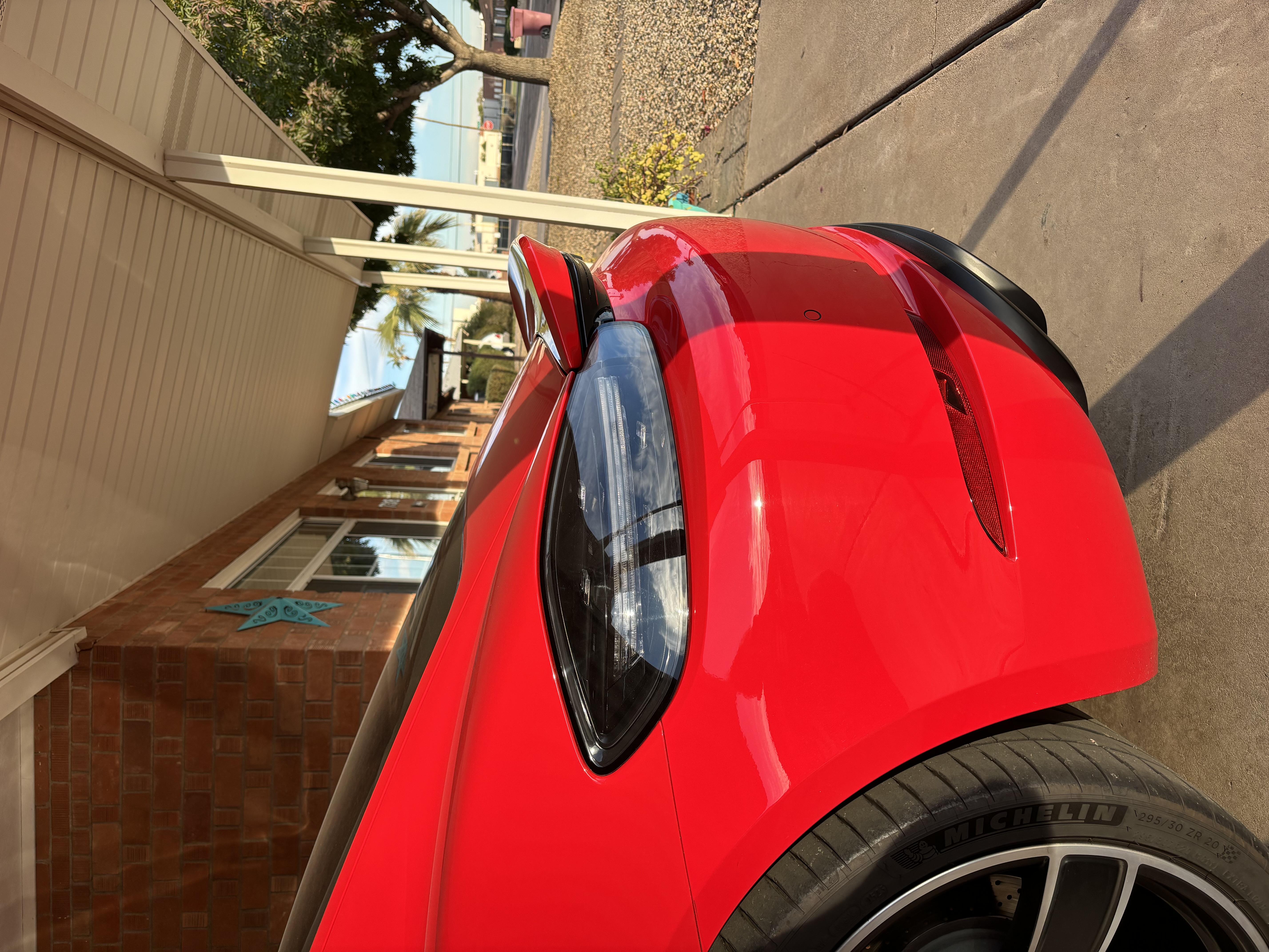

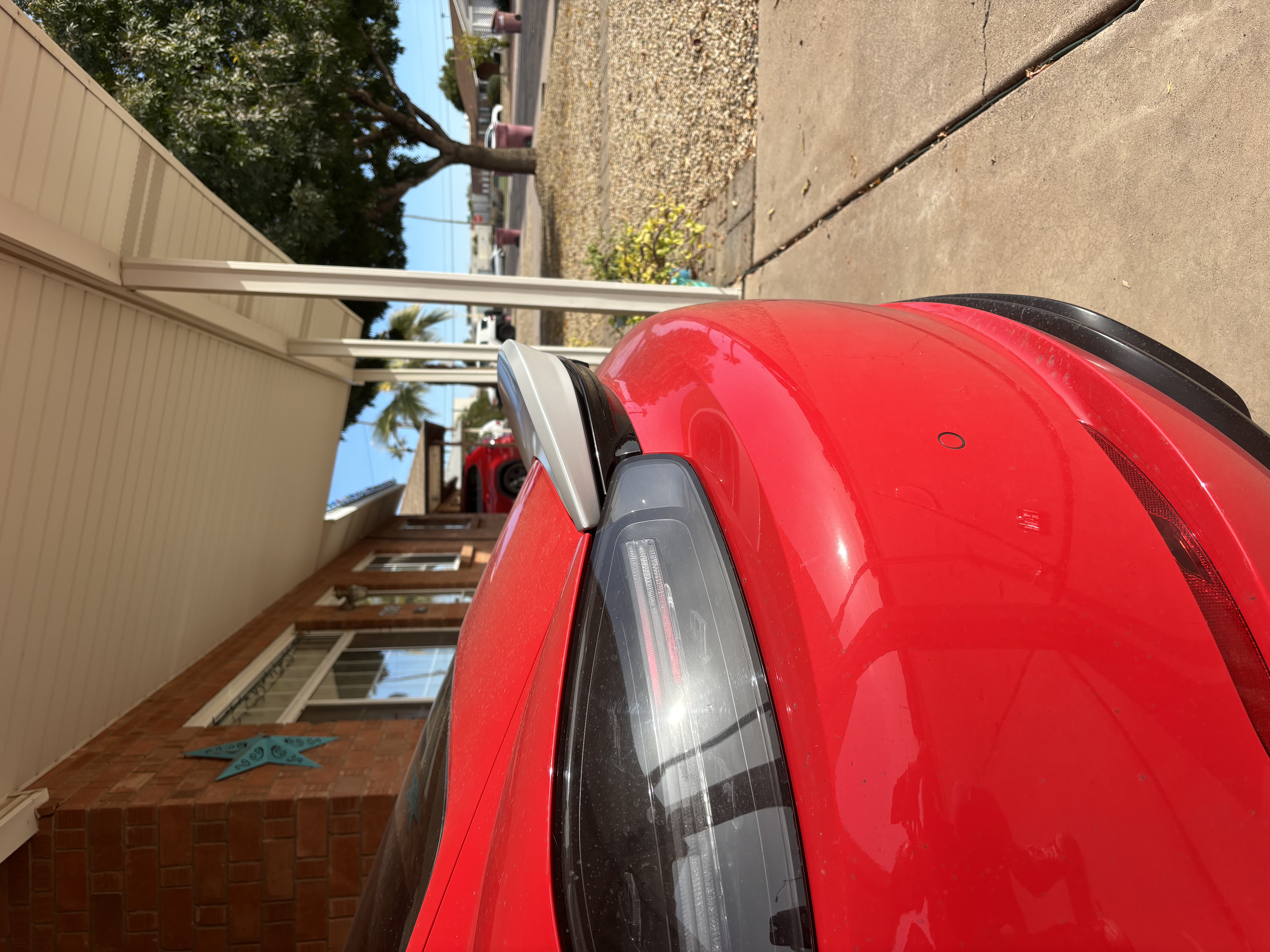

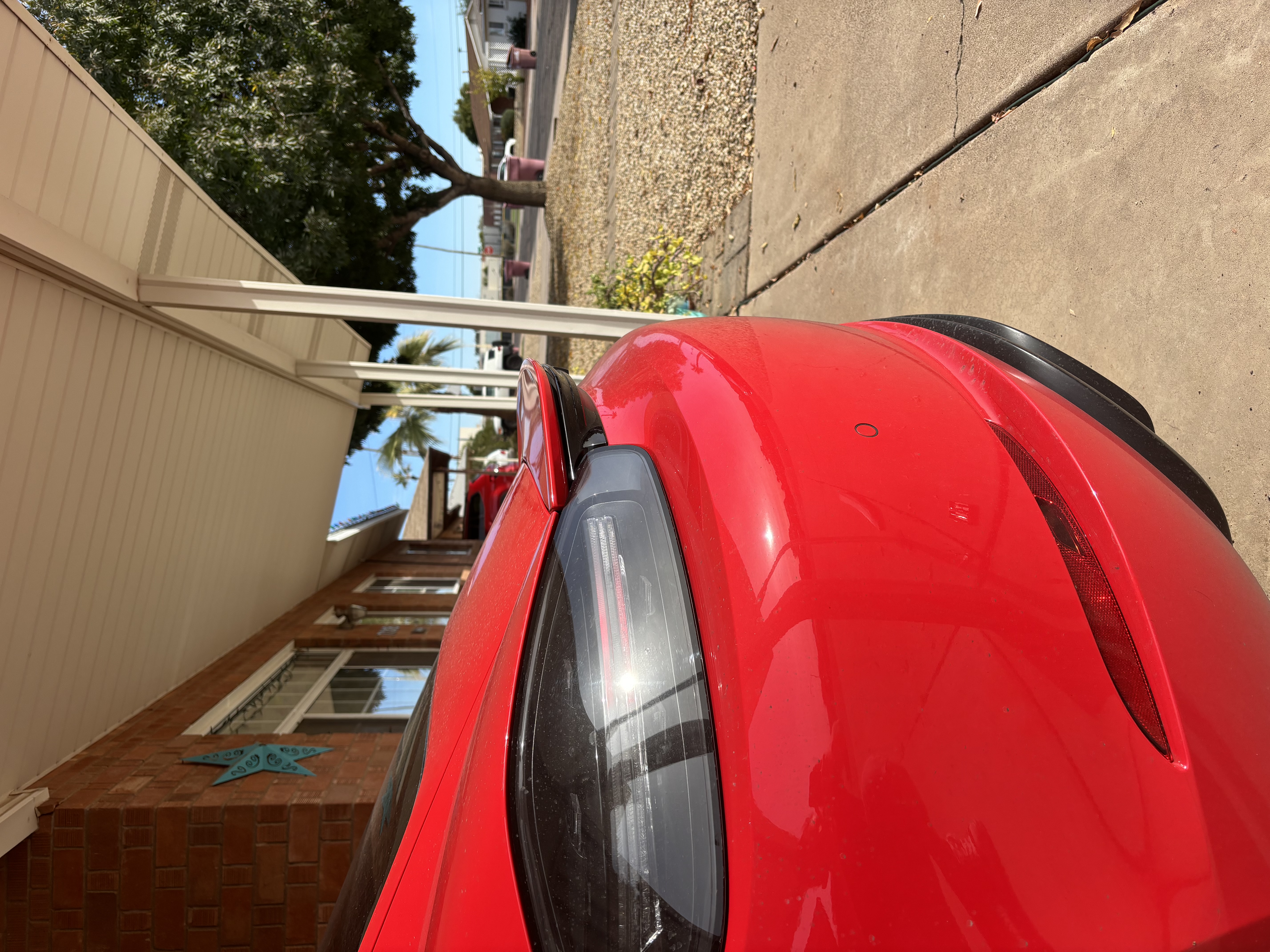

I have been able to mount the Frog Venom rear wing and find it to be visually a big improvement, still unclear is it will help with rear stability at speed. Will test that later

Looks great!J-Dub wrote: Mon Jan 15, 2024 3:43 pm I have been able to mount the Frog Venom rear wing and find it to be visually a big improvement, still unclear is it will help with rear stability at speed. Will test that later

CleverJ-Dub wrote: Sun Dec 31, 2023 10:28 am On my last track day I left on my center caps. The little teeth that grip the cap to the wheel have relaxed with the high heat and now the caps are loose. I simply inserted a roll of Teflon tape into the cap and heated them with a heat gun. When the cap had cooled I inserted it back into the wheel and it is once again a snug fit.

Have you mounted the splitter up front yet? The wing is really great looking and you should be ashamed of yourself because I thought I was almost done buying things. On second thought, don't post a picture of the splitter since I will likely want that also!
