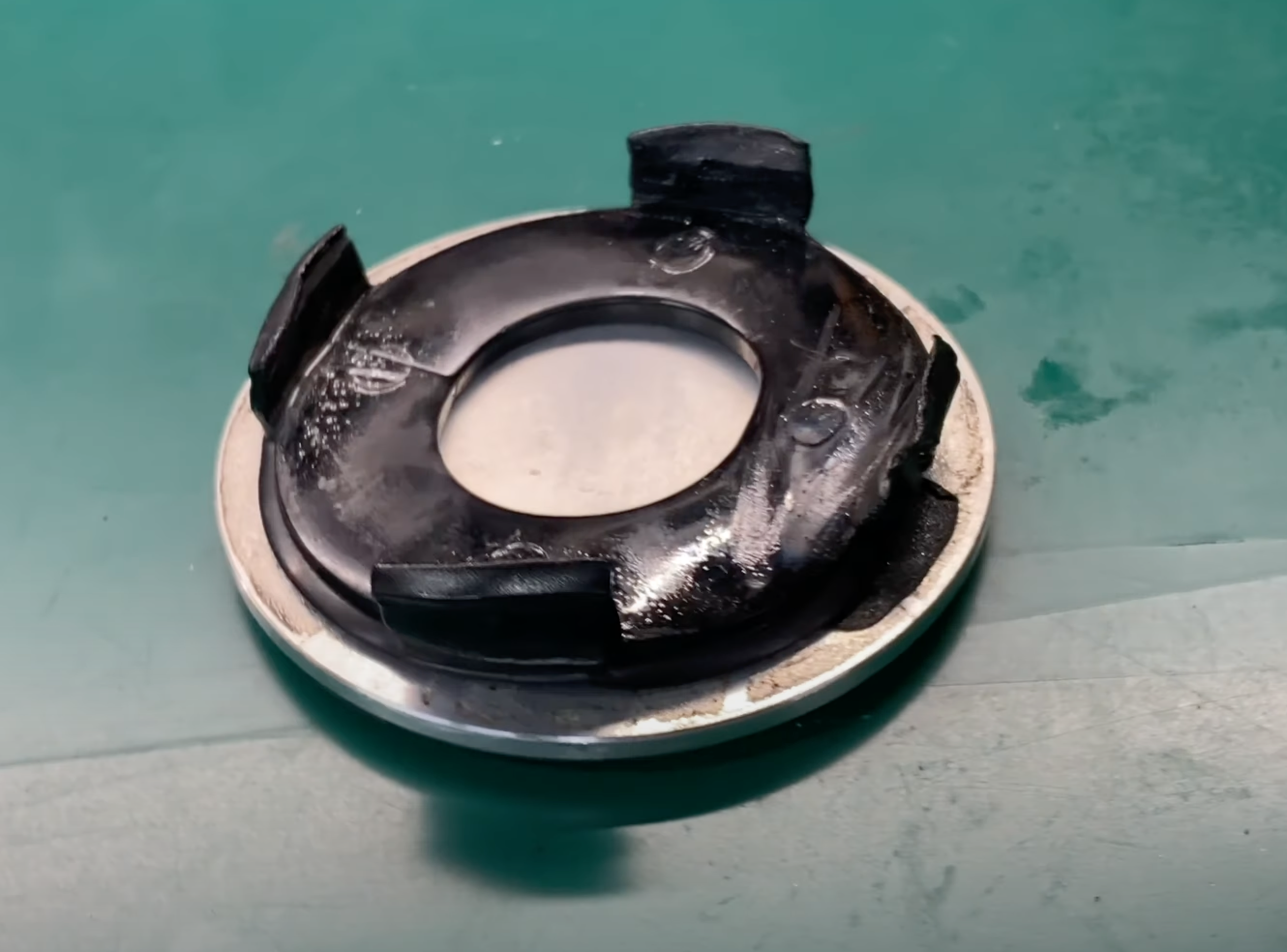

I've also melted centercaps before. But mine were from another wheel vendor on another car (Rohanna). It was a very hot track day, over 100F. These days I remove my caps as some aren't cheap! Also, as they deform from heat they may fall off or just become a bit loose.

I assumed extreme heat was the reason our wheel weights kept disappearing and now it makes sense why I'm the only one still tracking with wheel caps....well, no longer.

Running W2W you needed to remove wheel caps regardless if they were metal or ABS plastic since heat would often melt or even help dislodge ( metal caps ) and having one fly up and hit a car at 100 mph or more could cause serious damage or issues. I have melted way too many wheel weights and over the years it has become a habit to tape them also - heat resistant tape is best. If you use an aggressive racing pad that in combination with sticky rubber generates more gs , both sideways and stopping , so more and more folks are seeing weights come loose from heat or completely come off. The heat generated by all these forces is also why many of us recommend wheels like Apex, Forgeline , etc. with a knurled lip as the tires get hot enough they can rotate on the wheel.
