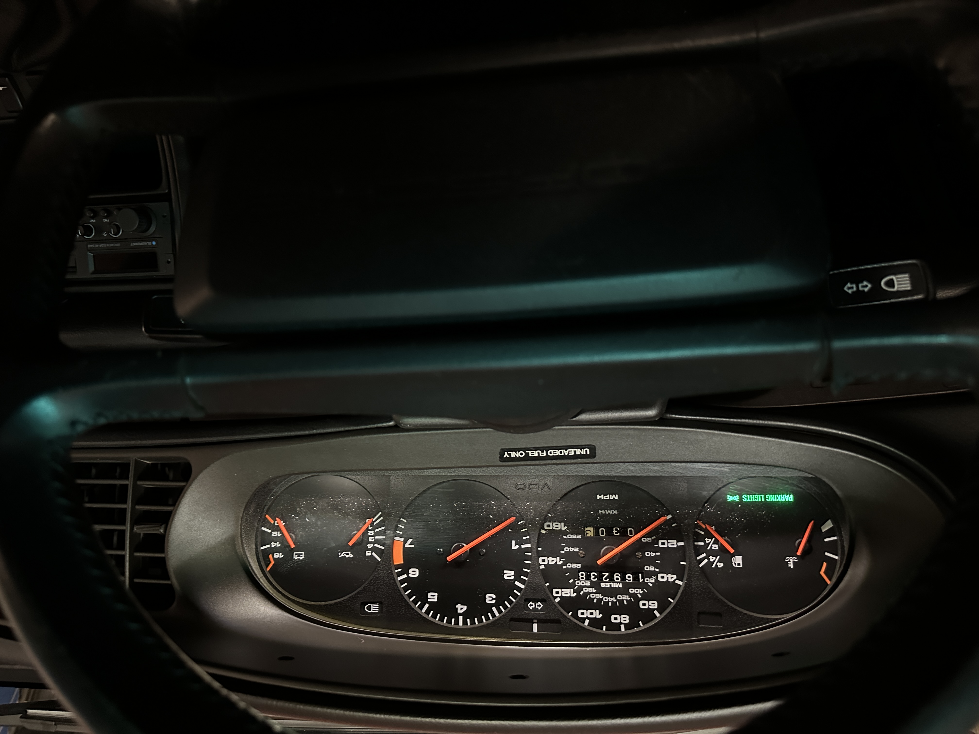

I had the white spots on the instrument cluster plastic surround. Looked like the measles. I took apart the cluster, sanded the plastic and repainted the plastic with a flat black spray paint. Did this about 2 years ago. Still happy with the results.

dlarsen944 wrote: Sat Nov 04, 2023 6:04 am I had the white spots on the instrument cluster plastic surround. Looked like the measles. I took apart the cluster, sanded the plastic and repainted the plastic with a flat black spray paint. Did this about 2 years ago. Still happy with the results.
download/file.php?mode=view&id=11946
That looks outstanding! Any particular paint you used? Were you able to get the lens off in one piece and just glue it back on?

I used a rust-oleum flat black spray paint (made for use on a variety of materials included plastics). Took my time spraying the paint, as to avoid runs (3 light coats). The lens wasn't much of a challenge removing, as the adhesives age was losing its grip. I also used Meguiars PlastX polish to remove any fine scratches in the lens. Gluing it back on, I used a Loctite product for plastics.
