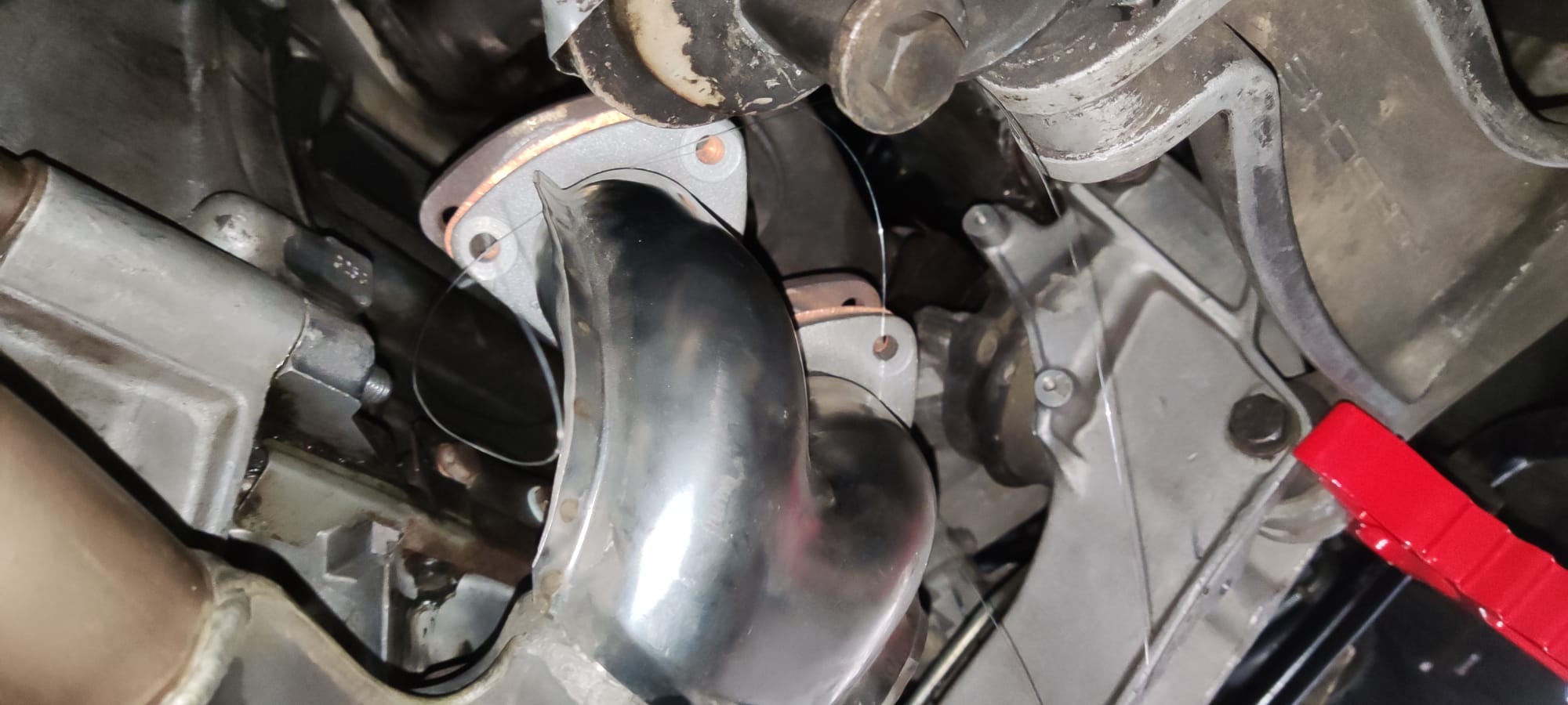

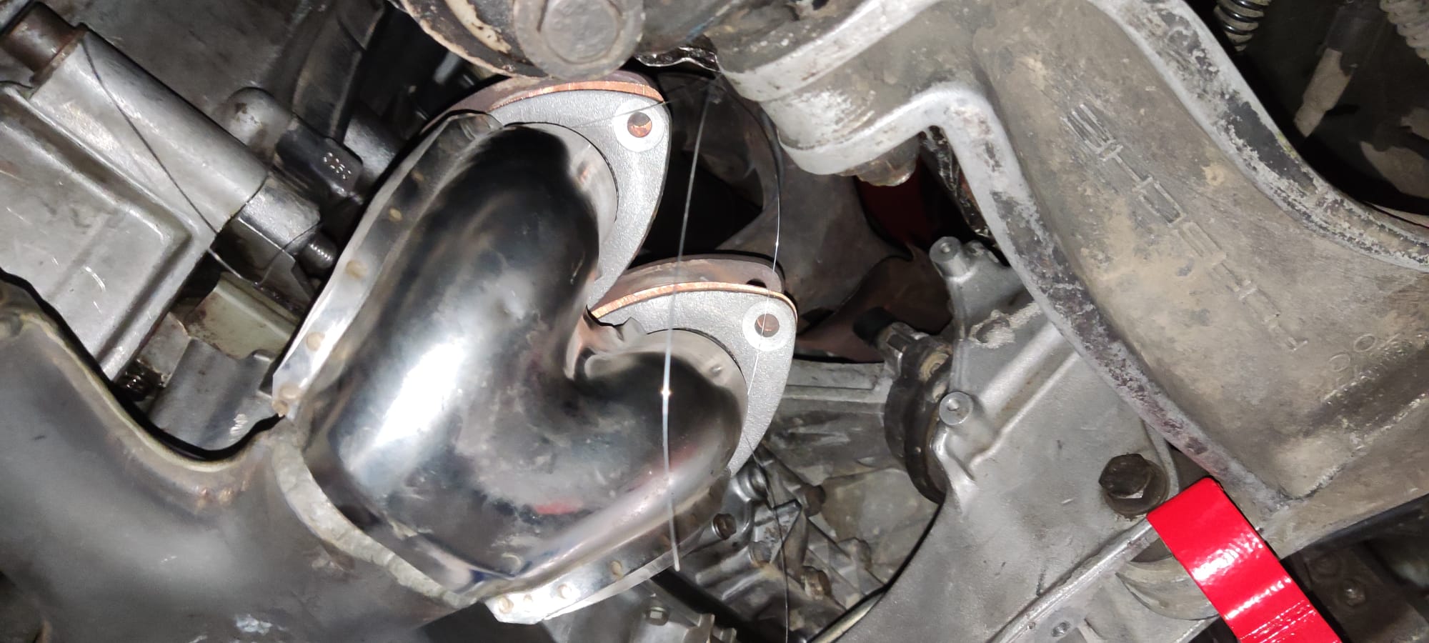

Thanks. I had my brother take some photos of the misalignment. What do you all think?
- xover1.jpeg (187.58 KiB) Viewed 1332 times
- xover2.jpeg (147.61 KiB) Viewed 1332 times

Exhaust headers are loose. Do you think it's safe to pry them this much together?

From those pictures, they look close enough to pry over with a screwdriver safely. Pictures can be deceiving so use your best judgment, but that looks pretty typical...

Belgian951 wrote: Thu Oct 05, 2023 1:32 am
The headers are most likely warped also a normal occurrence with these cars. That looks very doable. As others have said get a line up punch. Also FWIW I removed the studs in the head at the exhaust ports and used the same allen heads that are used for the intake manifold works really nice and when/if you need to R&R the headers you don't have to fight them to get around the studs. BTW when "we" say leave it loose that means only a few threads on the fastener.

gpr8er wrote: Fri Oct 06, 2023 4:24 pm
I wouldn't be surprised if these headers are warped or otherwise damaged. I noticed the PO did a poor welding job on one of them, so I just hope they are leak free... But if I ever replace them, I'll be sure to change the studs to the bolts. That's a good tip. Thank you!

No, you don't hammer in the punch. Get everything end to end rattle loose and start prying the best spot where you can get the punch in across 2 holes. Get a bolt in and keep going. It's going to fight you and will take some time
