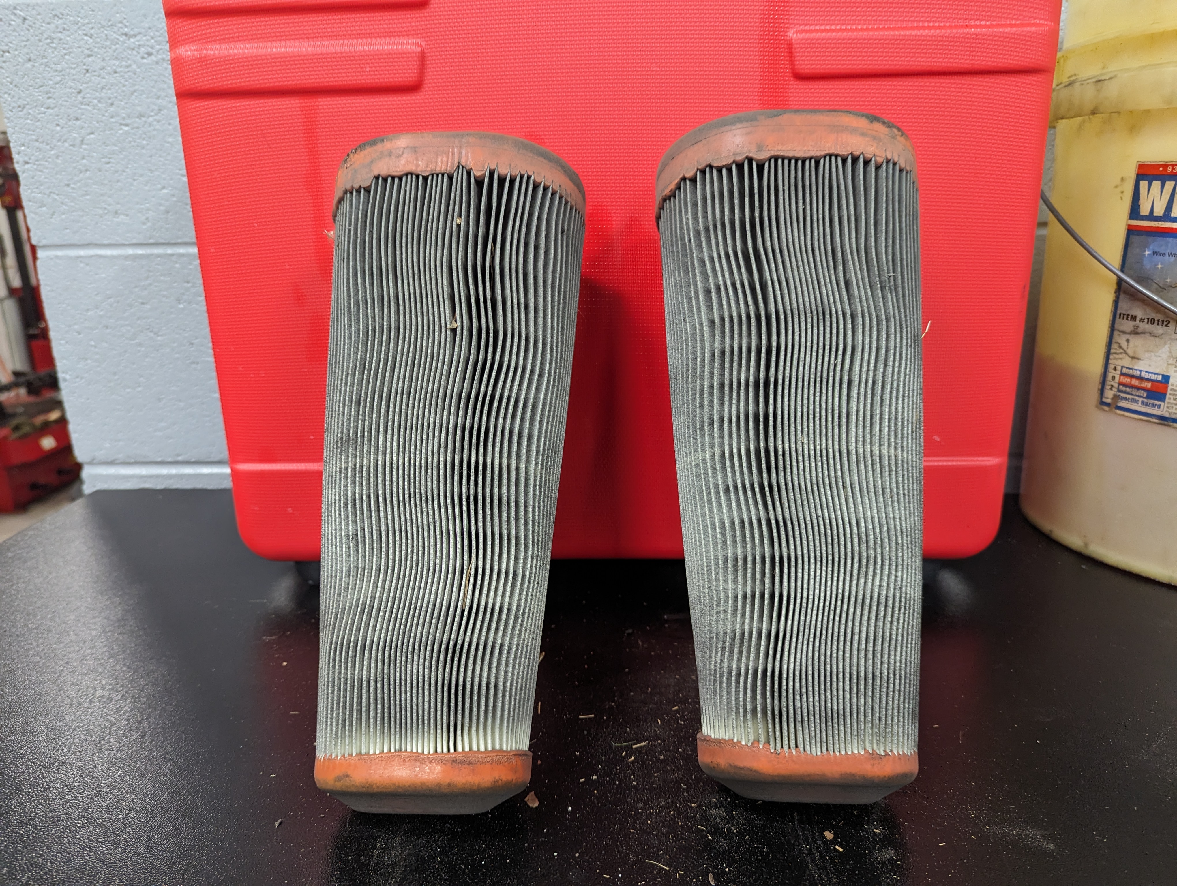

Additional air filters info and words to the wise plus a HUGE thanks for bringing up the subject in this thread. Thank you @Southbama along with all others who chimed in.
It was time for the GT4's annual factory recommended service (year-3), plus swapping wheels to winter set and other additional off-season checks and service work. (The regular annual services are in addition to the extra maint & preventative work done due to a lot of track driving.)
For the record, the car (a 2021 GT4) has 14,090 non-dusty mostly Tennessee driven miles. However, approximately 3,200 of those are hard on-track miles.
Thanks to the thread, I suggested that the air filters probably needed changing or at least an inspection. Oddly, this procedure is not mentioned in the maintenance section of the GT4's supplemental owner's manual "Driving on the Race Circuit". In fact, there is no mention at all of air filters in that supplemental manual.

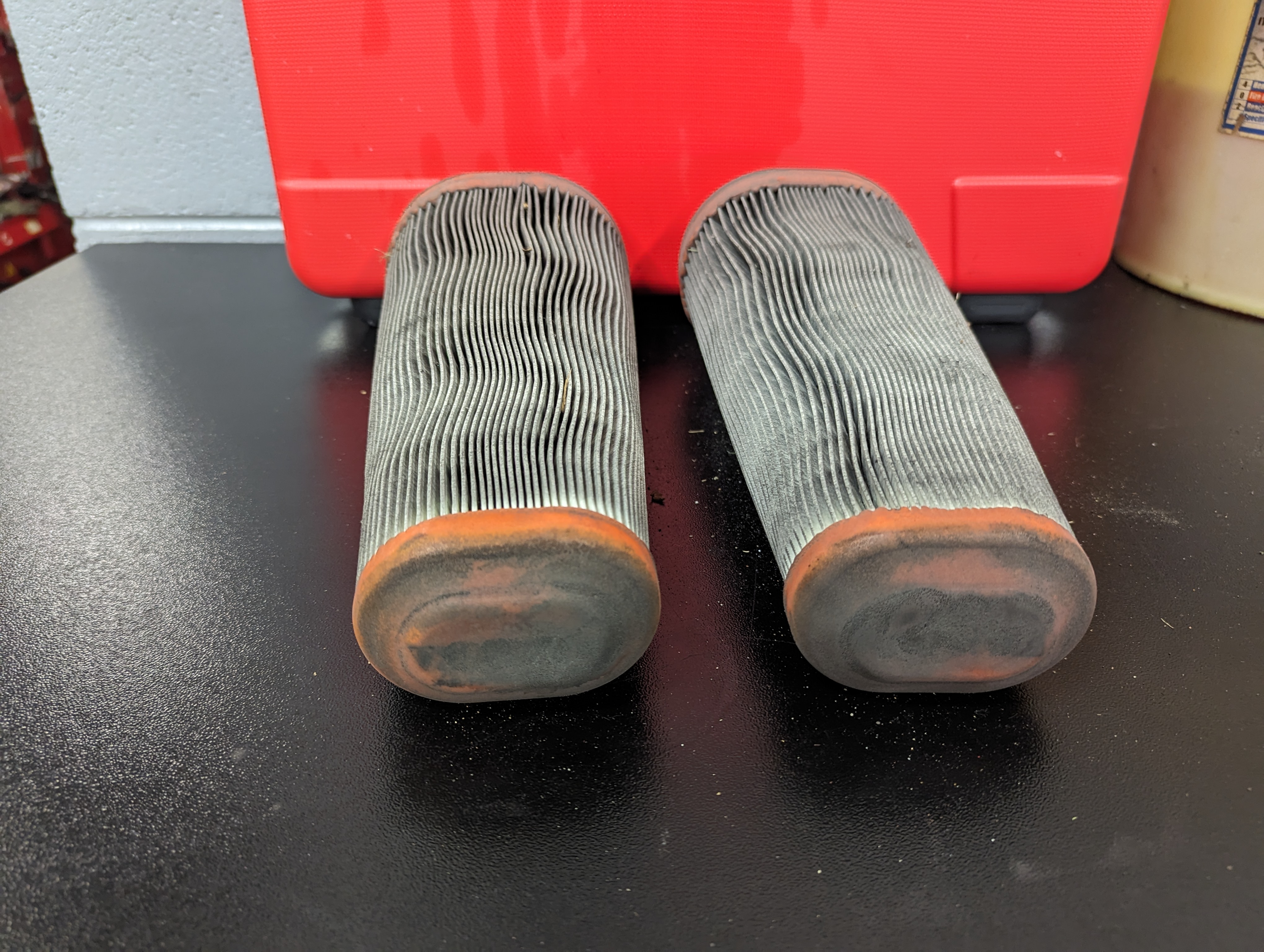

My unparalleled Porsche dealership tech agreed, specifically due to the large volume of air being sucked into the car at WOT (which is where a track car's throttle lives), all directed through low-to-the-ground and large side scoops. However, he also mentioned that, by the book, the car was not due for filter change until the year-4 or 40,000 mile service. We both figured that they might be dirty but probably not really bad.
How wrong we were! Pics below tell it all.
By the way, this alone is a good reason in my opinion for NOT using aftermarket filters such as BMC that are even more porous. If driving in more extreme conditions, do you really want that additional grit and grime sucked into your engine? Not me.
These pics are after some of the dust and debris had been shaken and tapped out and more was still falling out when I was positioning them for the photos!

I will never understand why Porsche went from 20,000 mile replacement for the 981 to 40,000 miles for the 718. Mine at 19,000 looked equally as filthy as yours Blueline, and mine has never seen a track or a road that wasnt paved.

I agree to your recommendation they should be serviced once a year!
