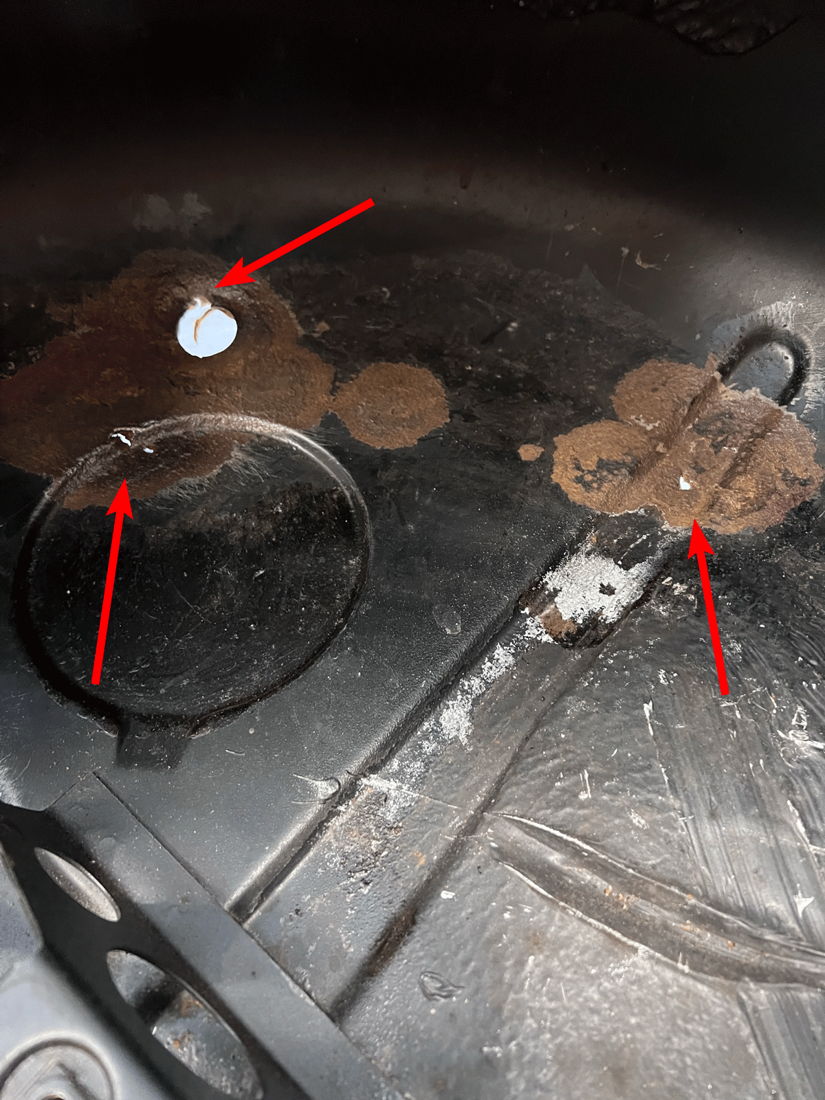

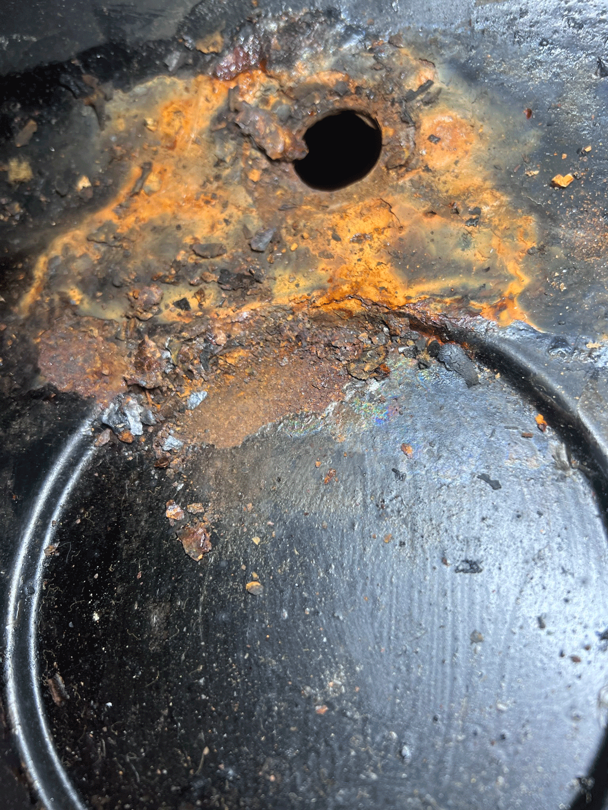

Now that the car is out of smog jail, I have renewed interest in it again, and am working my way through my list of things to fix. Today I started in on dealing with some rust in the trunk. It's a California-spec car (back in the day of 49-state cars), but I suspect it spent its first two years by the coast, before my dad bought it. It's not super rusty, but more than you typically see in a car that's been in CA all its life.
At any rate, this is what I'm up against. Would be an involved patch to make, but maybe. I've done that before in the 944 battery box. Or maybe I'll just try to spot fill the holes with a MIG welder (with a copper backstop). I could also just treat the rust with a rust neutralizer of some kind, and leave it, but what fun would that be... The undercoating below, and gas tank behind, make it more complicated that it otherwise might be...

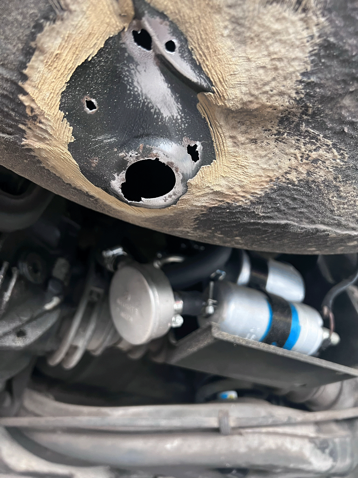

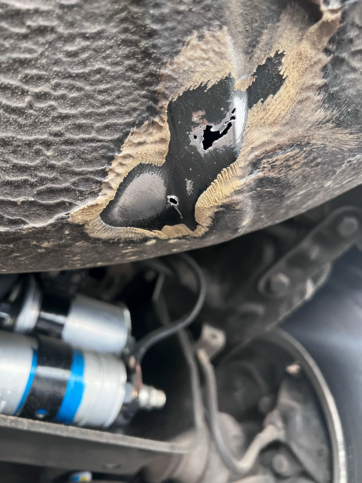

The plot thickens....

It looks like it started a long time ago and someone just poured a bunch of rust neutralizer on top of it. That no doubt preserved (or seriously slowed the rust) for years, so it's definitely not as bad as it could have been under there. The rust started finding its way out from under the neutralizer crud, so figure it's time to bite the bullet and replace with fresh metal. :)

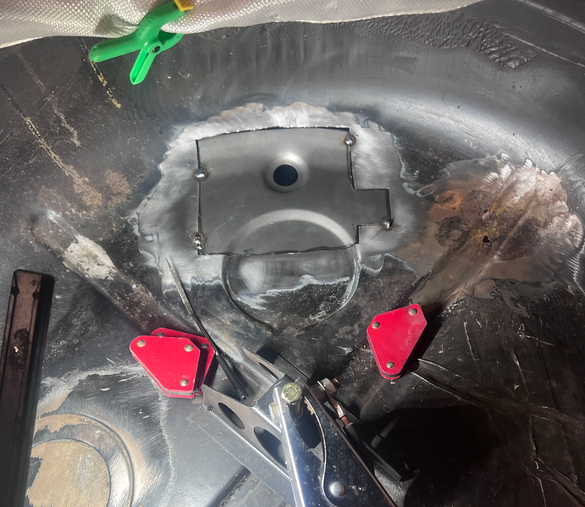

Inspired by some of the recent body work pictures here on Carpokes, I finally got around to making a patch for the trunk and tacking it in. :)
