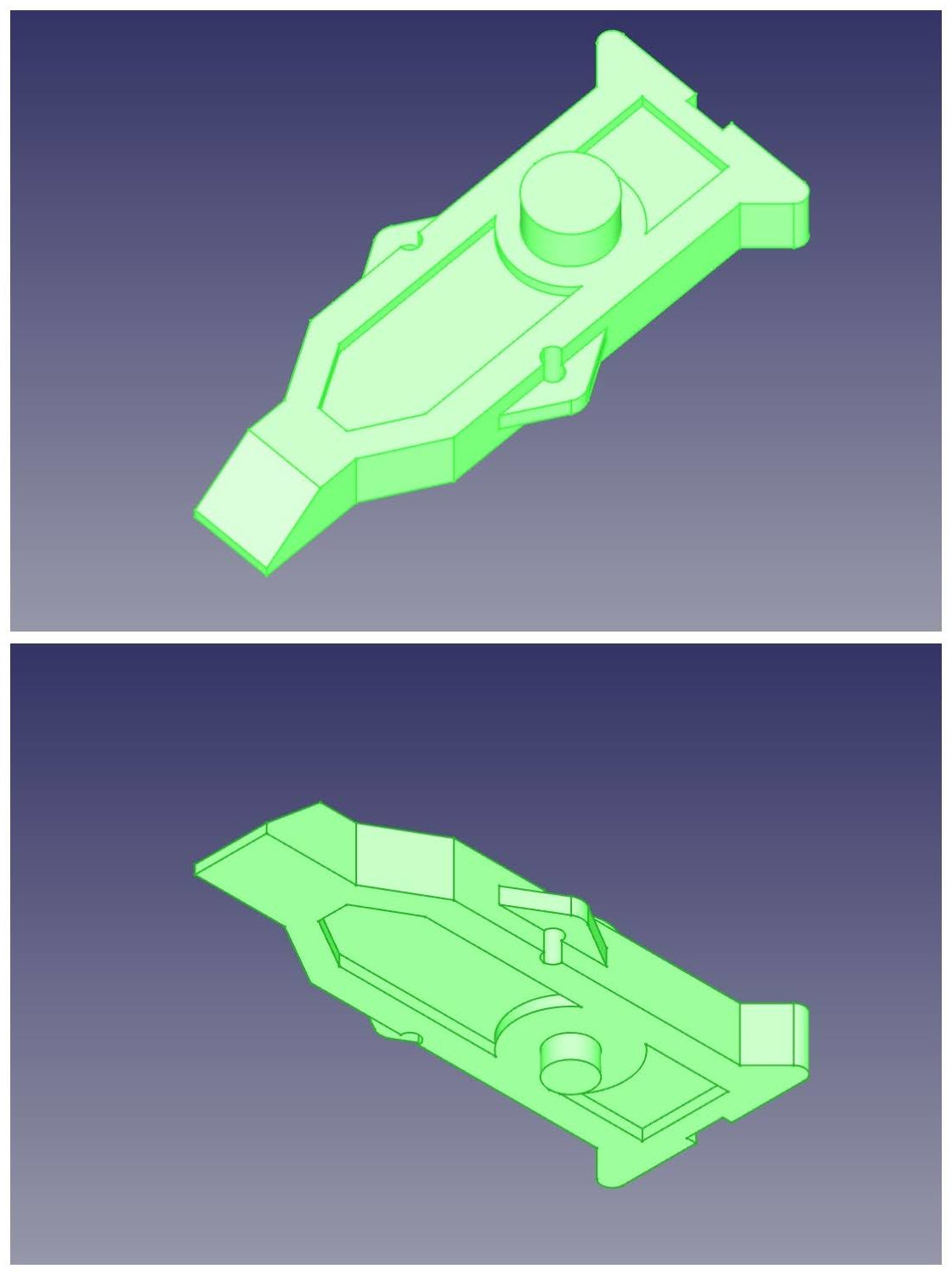

I also made a FreeCAD (v0.20.2) model of the cancellation tab. I didn't see one in the *.stl section of Carpokes. Just ask and I'll send the file.
Cancellation Tab

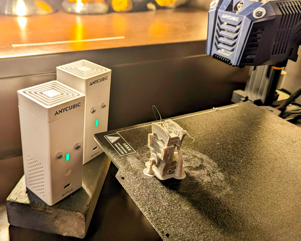

Just yesterday I made a few more tweaks and printed a few more prototypes. The CAD is done and the model works™, but it's tricky to print and have the tolerances come out right.
There are places in the model, like the six spring pockets, that come one extrusion-width from poking into the feature behind them.
I've identified those places and made changes to various pocket depths in the model to leave more material thickness and also not adversely effect functionality.
I've also tried to eliminate the need for support as much as possible. Got it down to only three critical areas.
It's a detailed print for a filament printer. I'm close to releasing the STL here on Carpokes. (Quite possibly the 3MF since it will contain usable print settings.)
The prototypes that work the best I've printed with a 0.4mm nozzle, 0.1mm layer height, and 0.3mm extrusion width for perimeters and places with solid infill.
