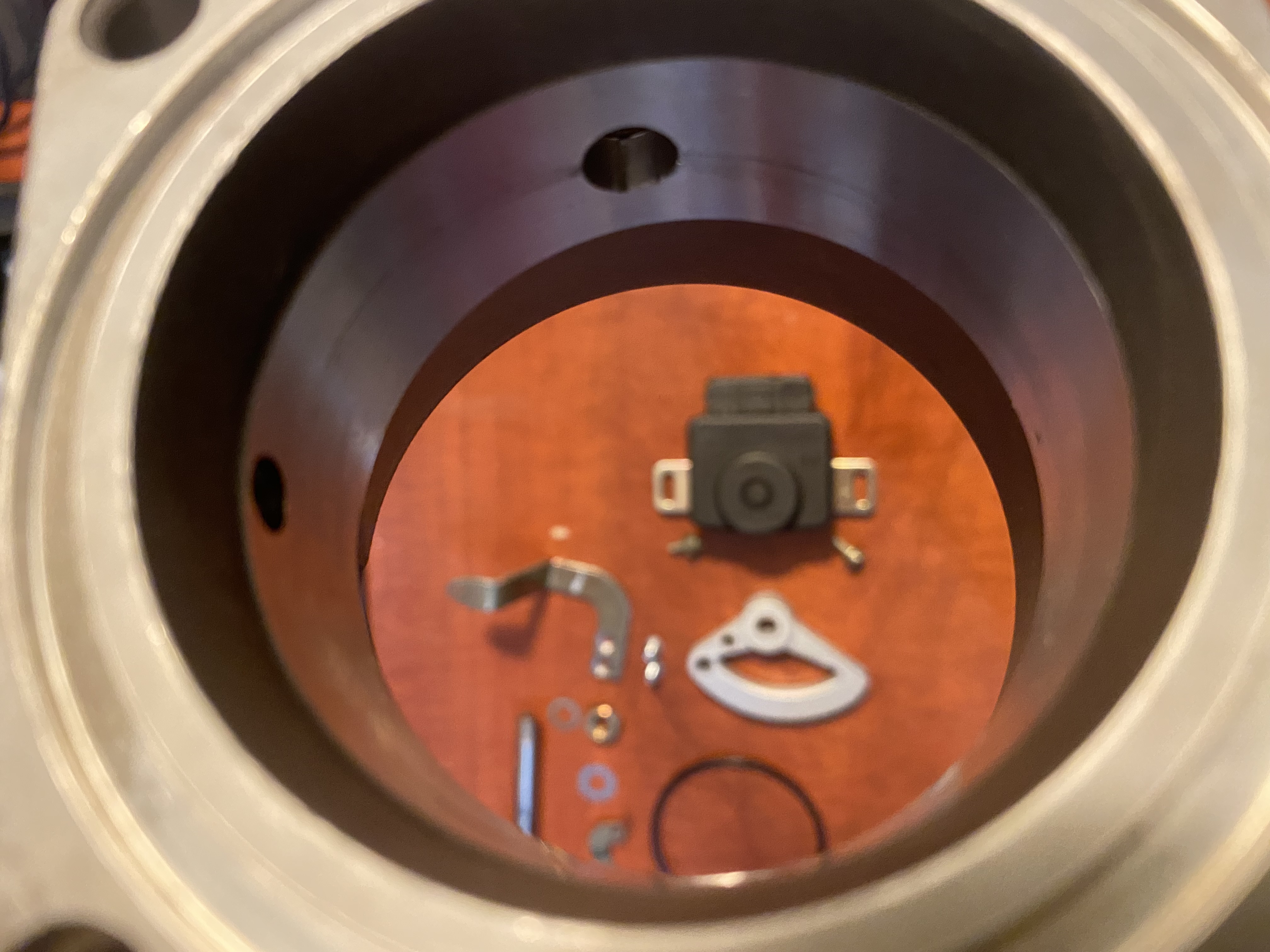

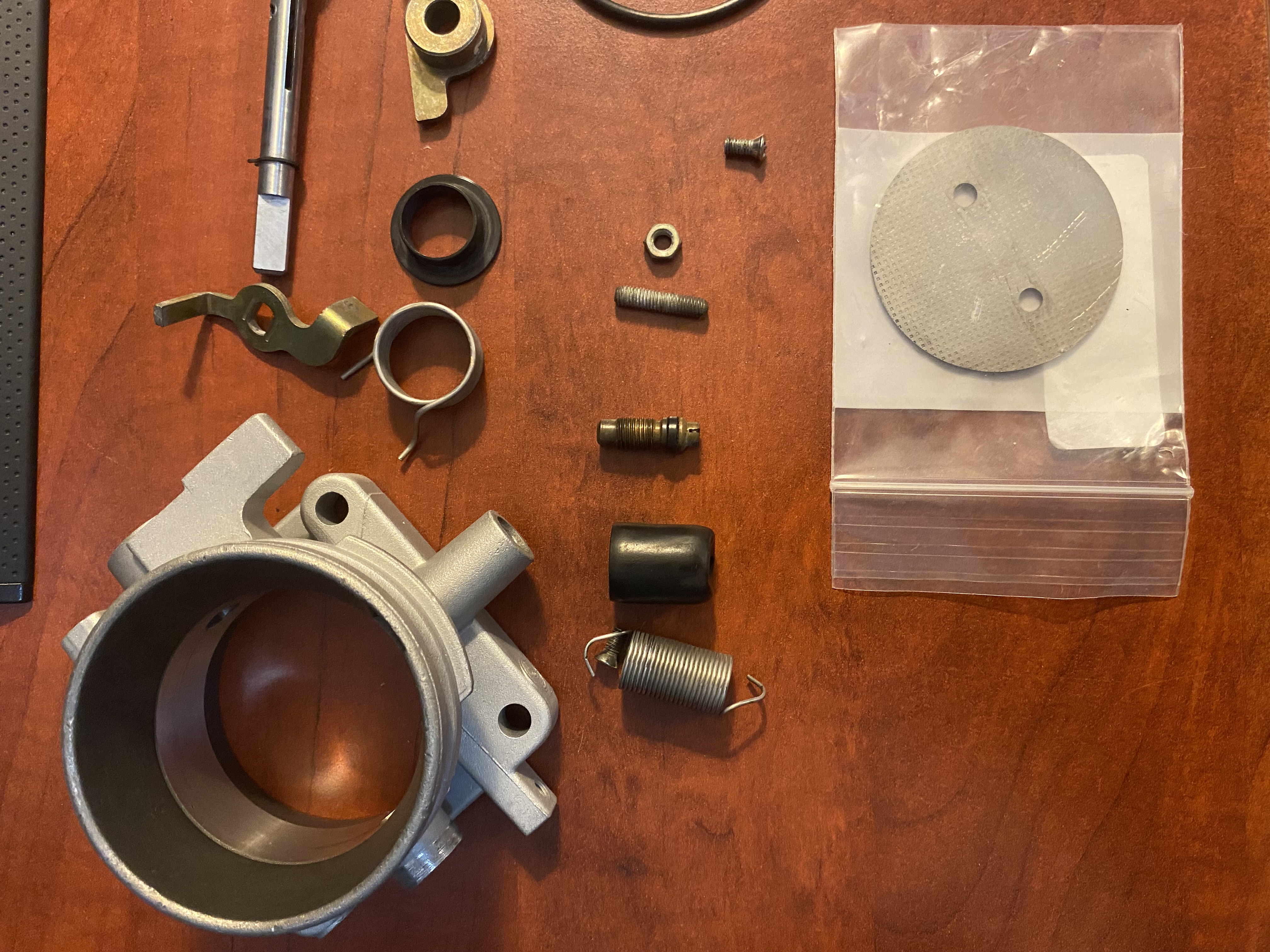

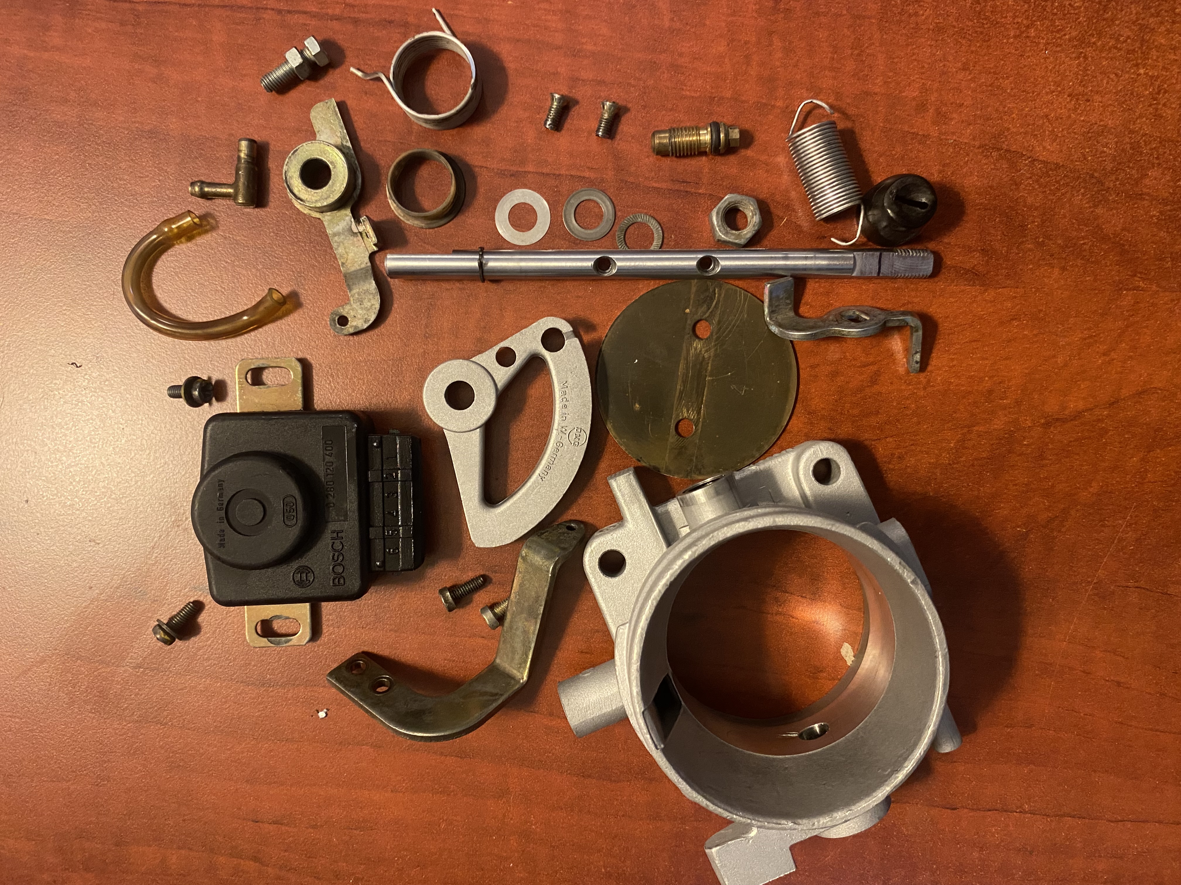

First round of pics of my 40000km car.
gruhsy
Posts: 540
Has thanked: 50 times
Been thanked: 84 times

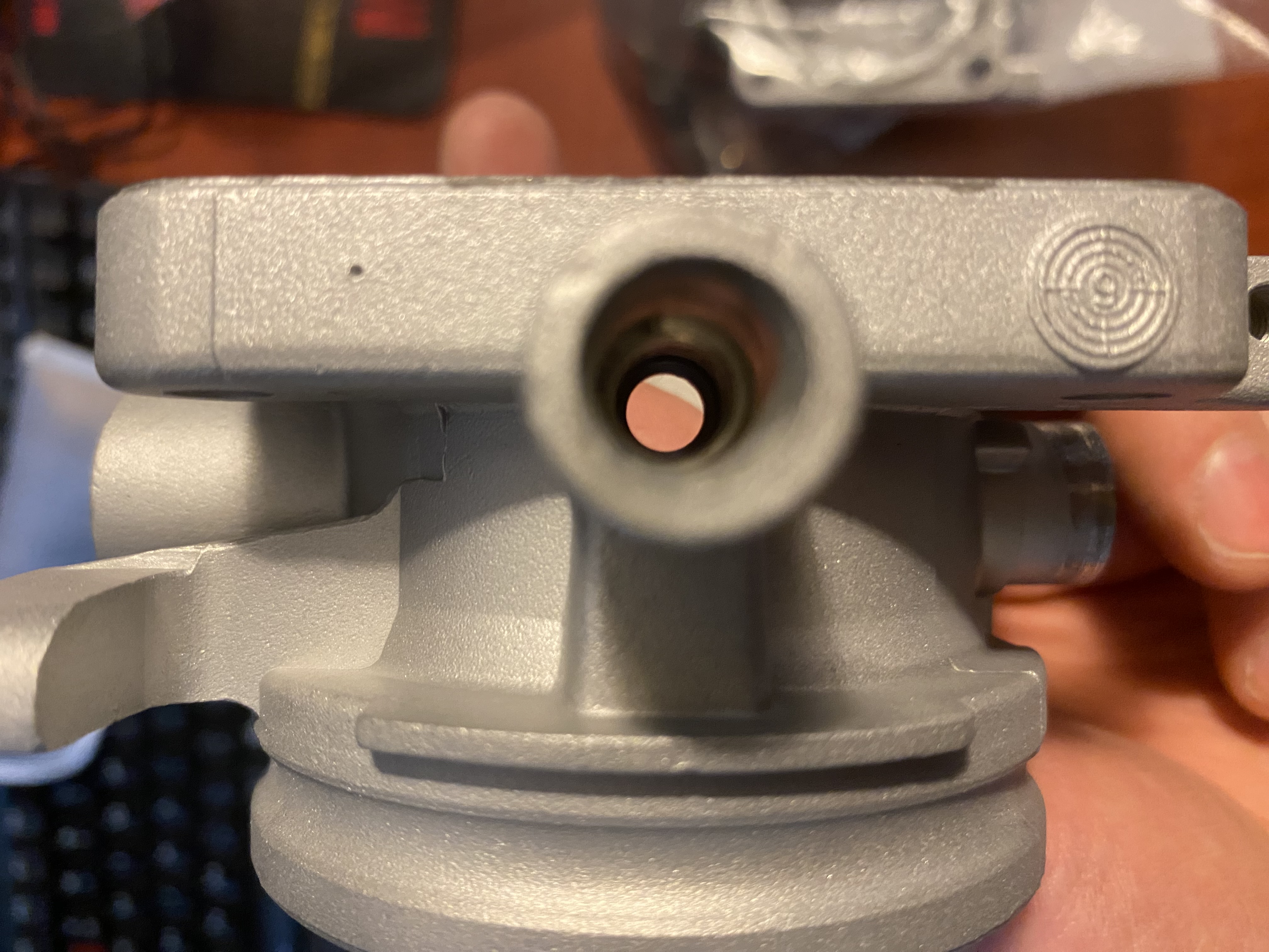

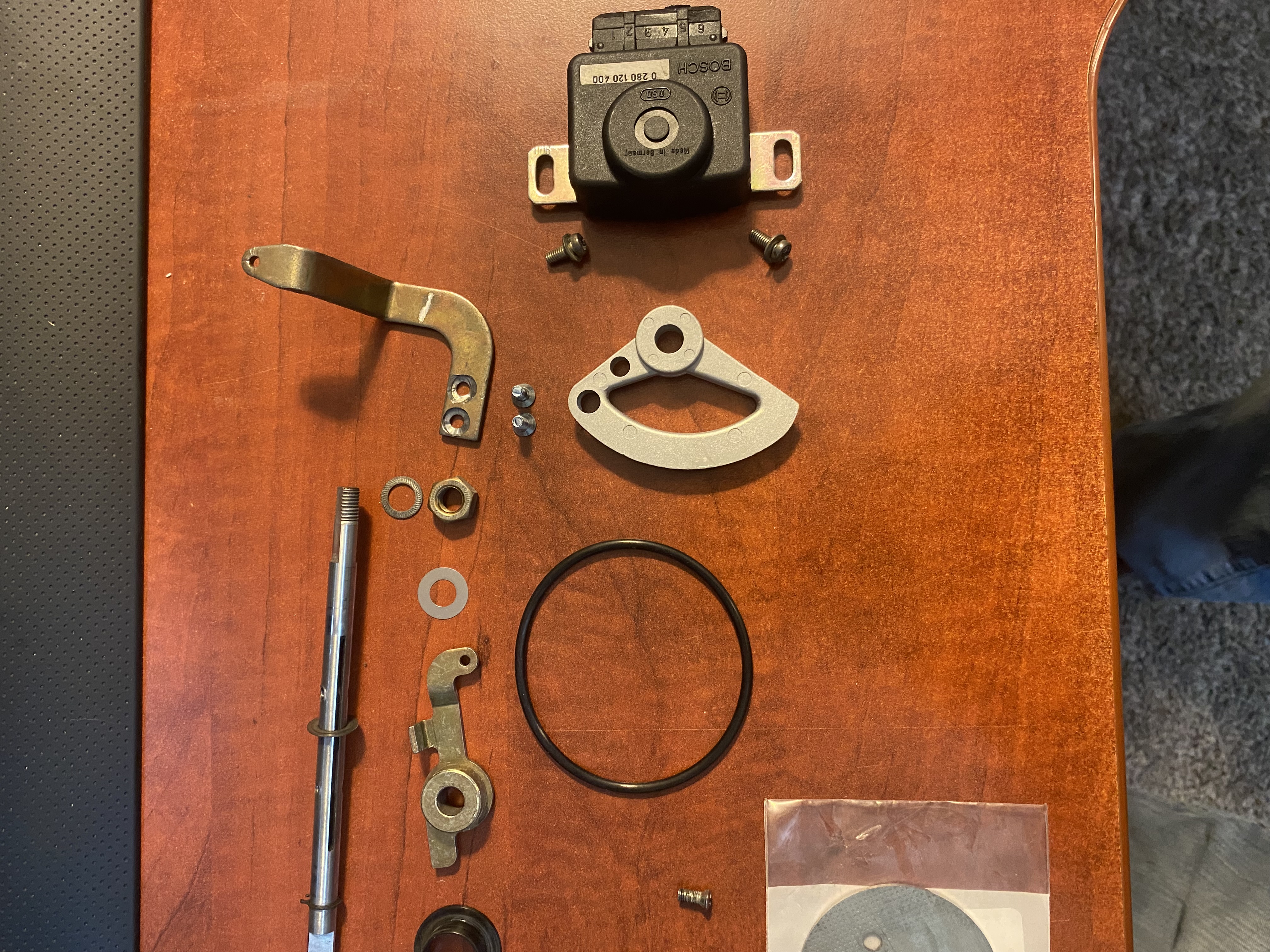

More pics
gruhsy
Posts: 540

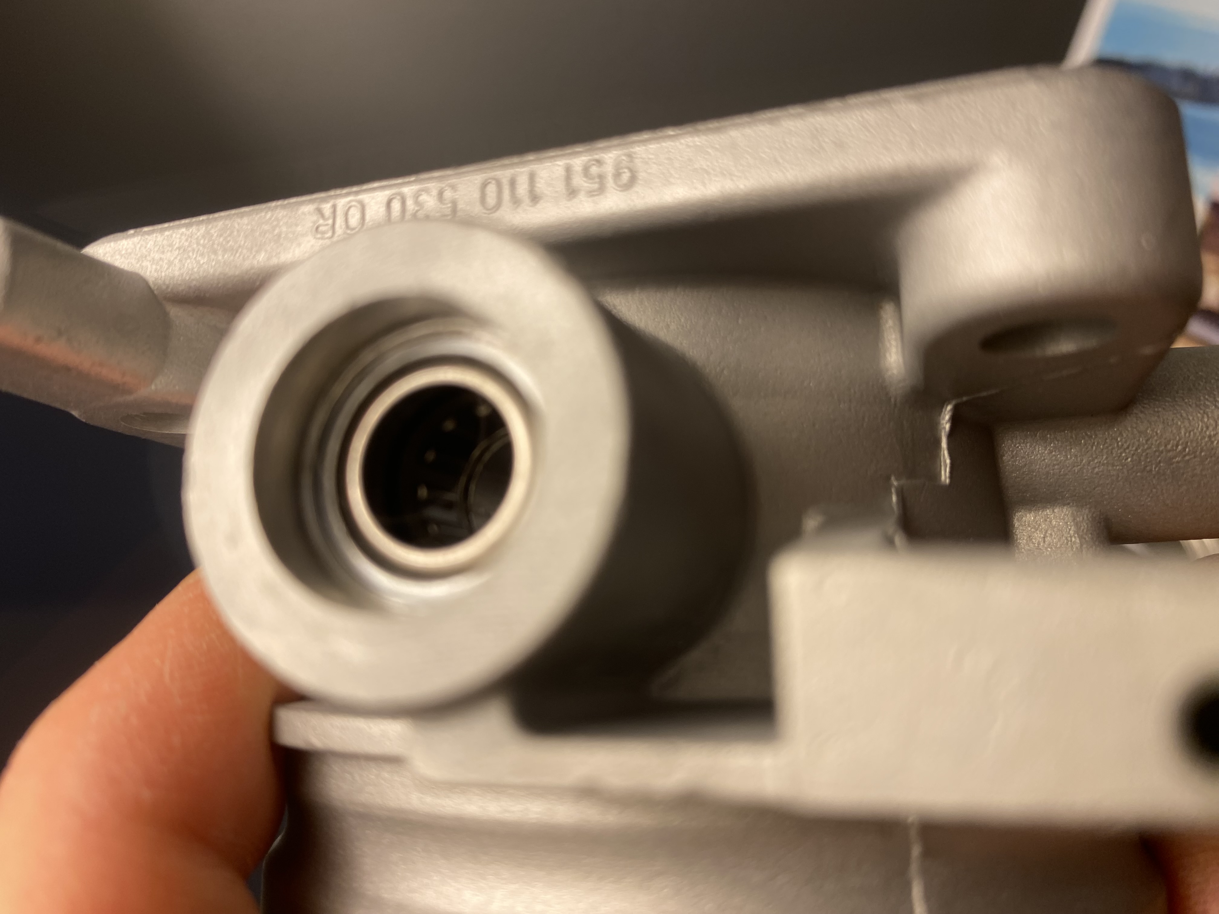

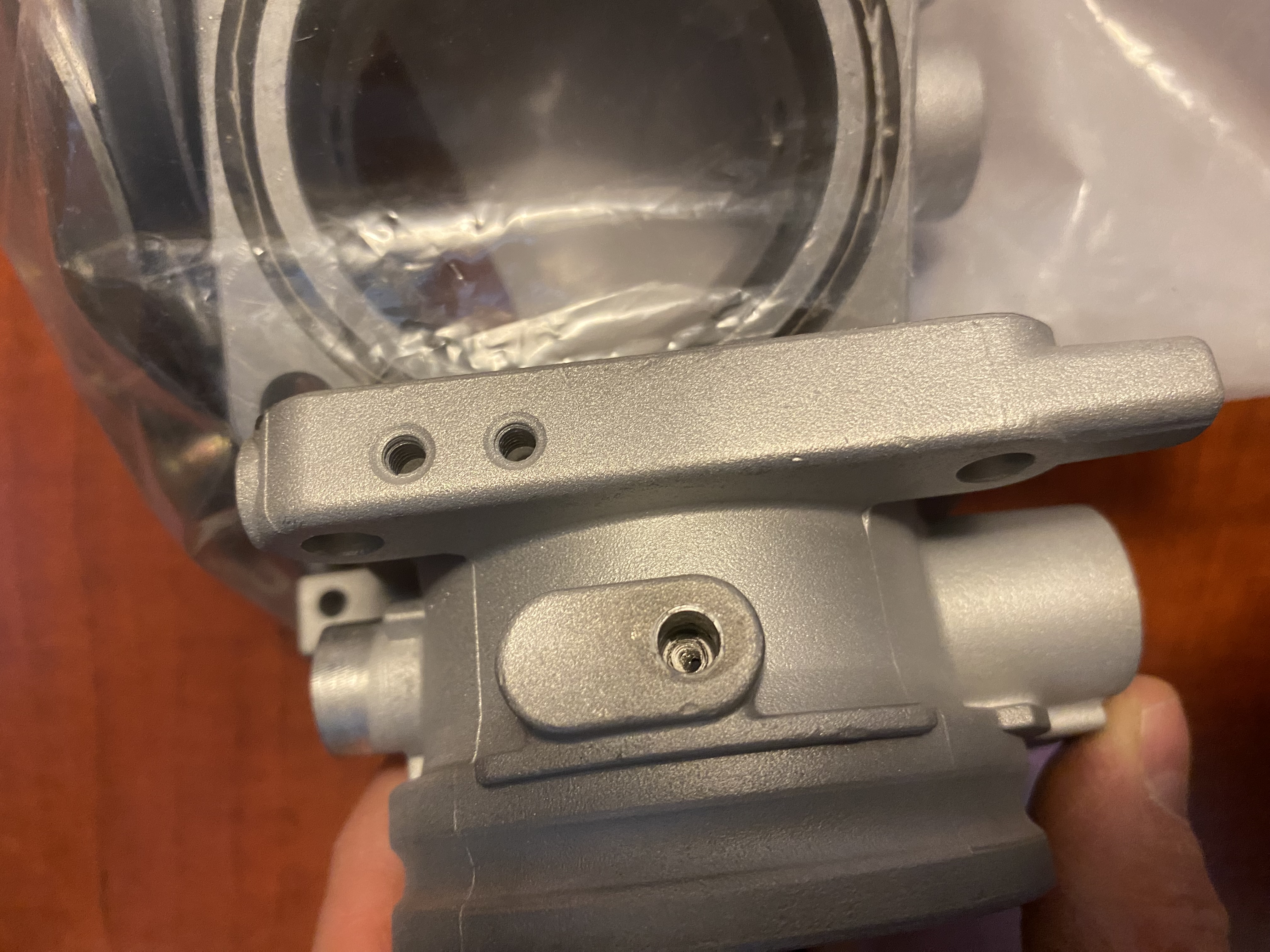

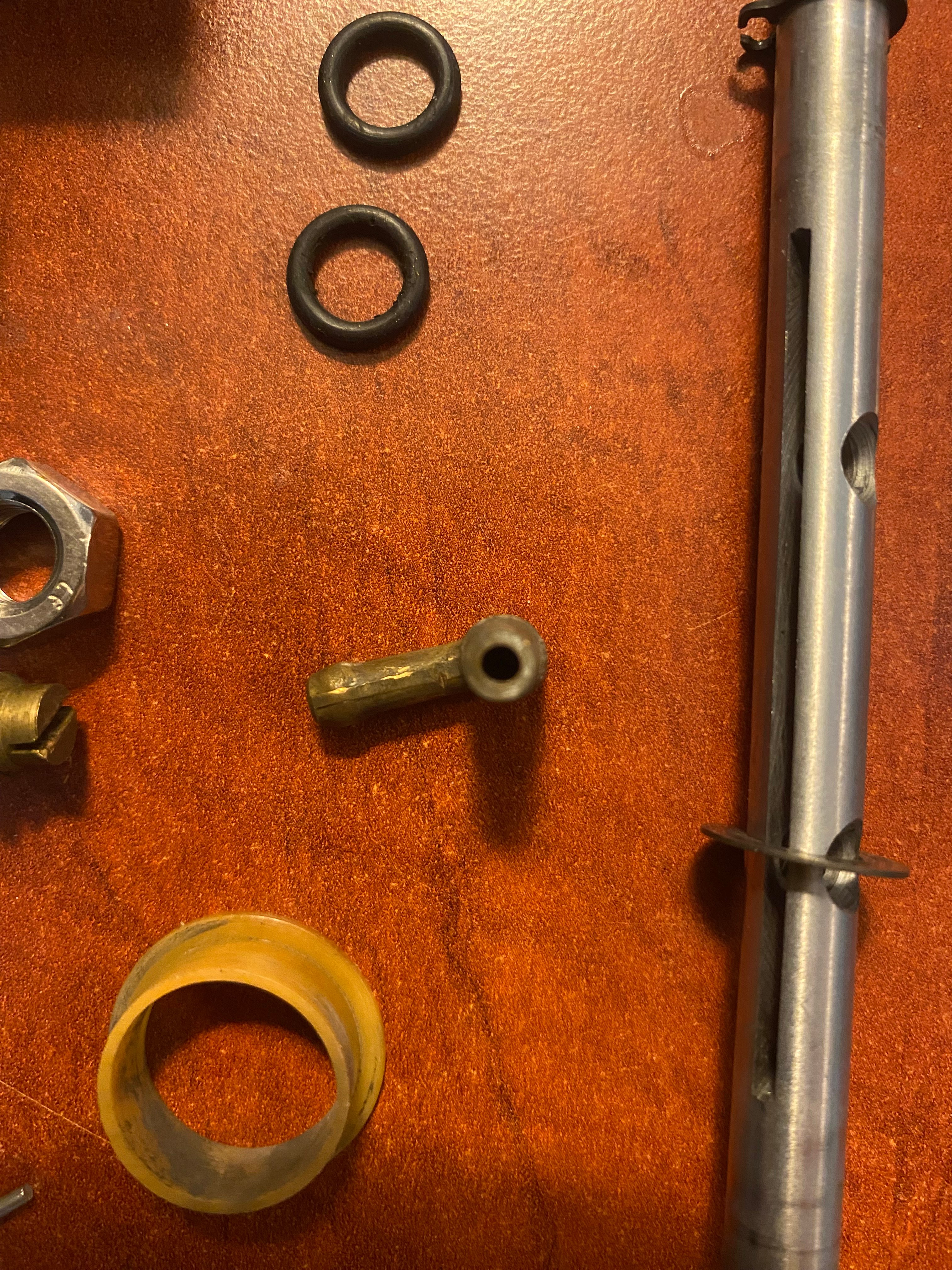

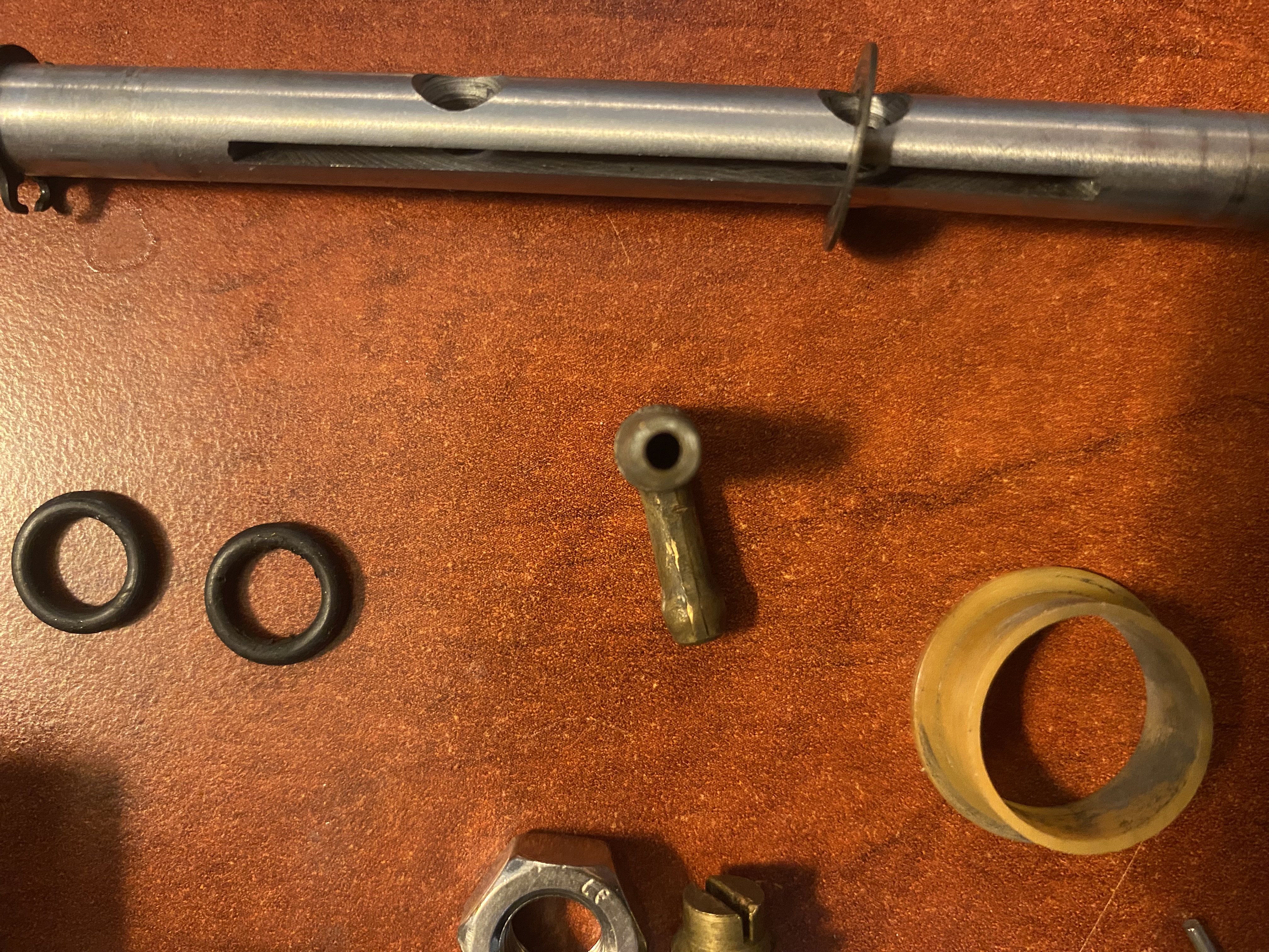

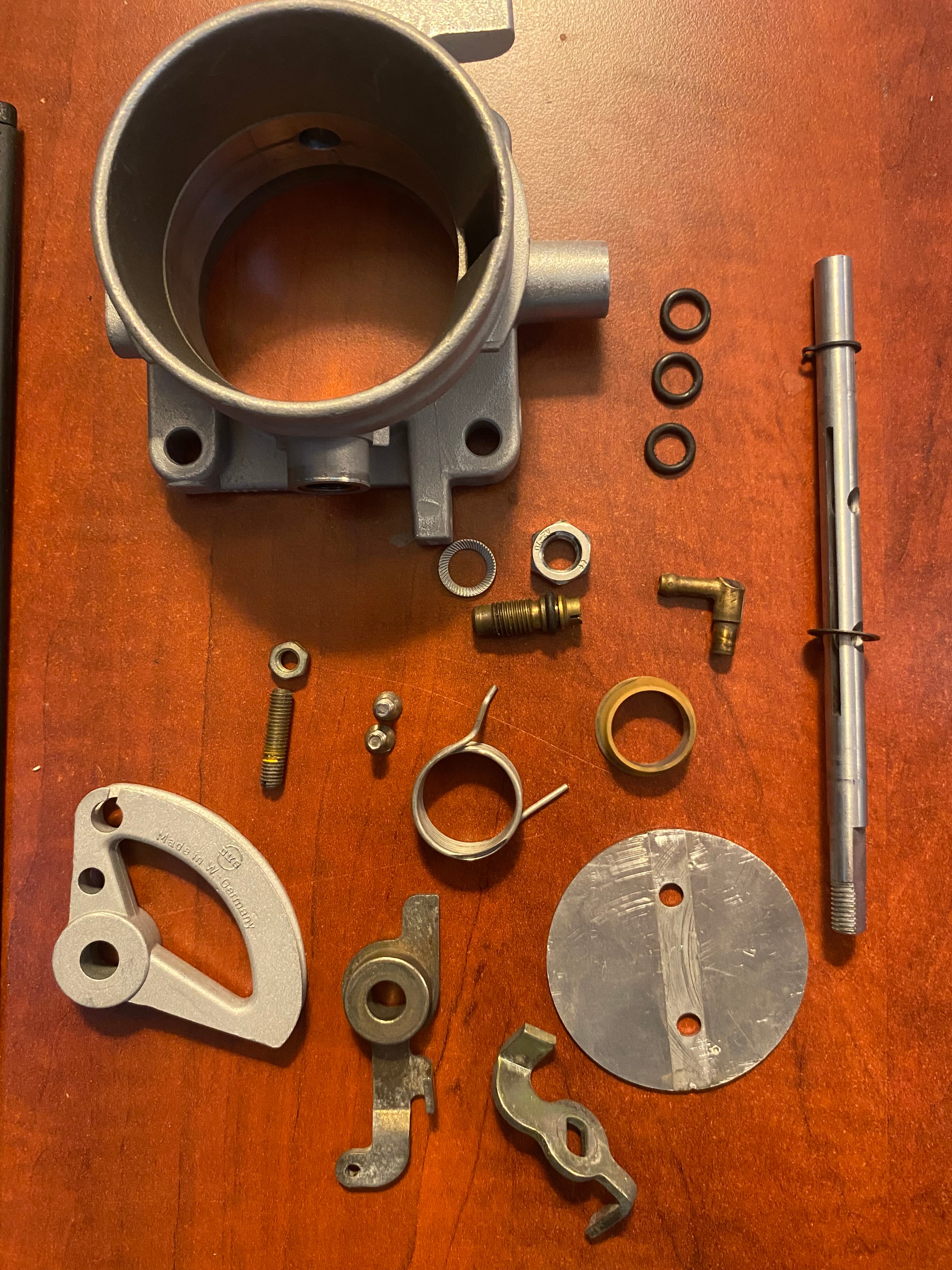

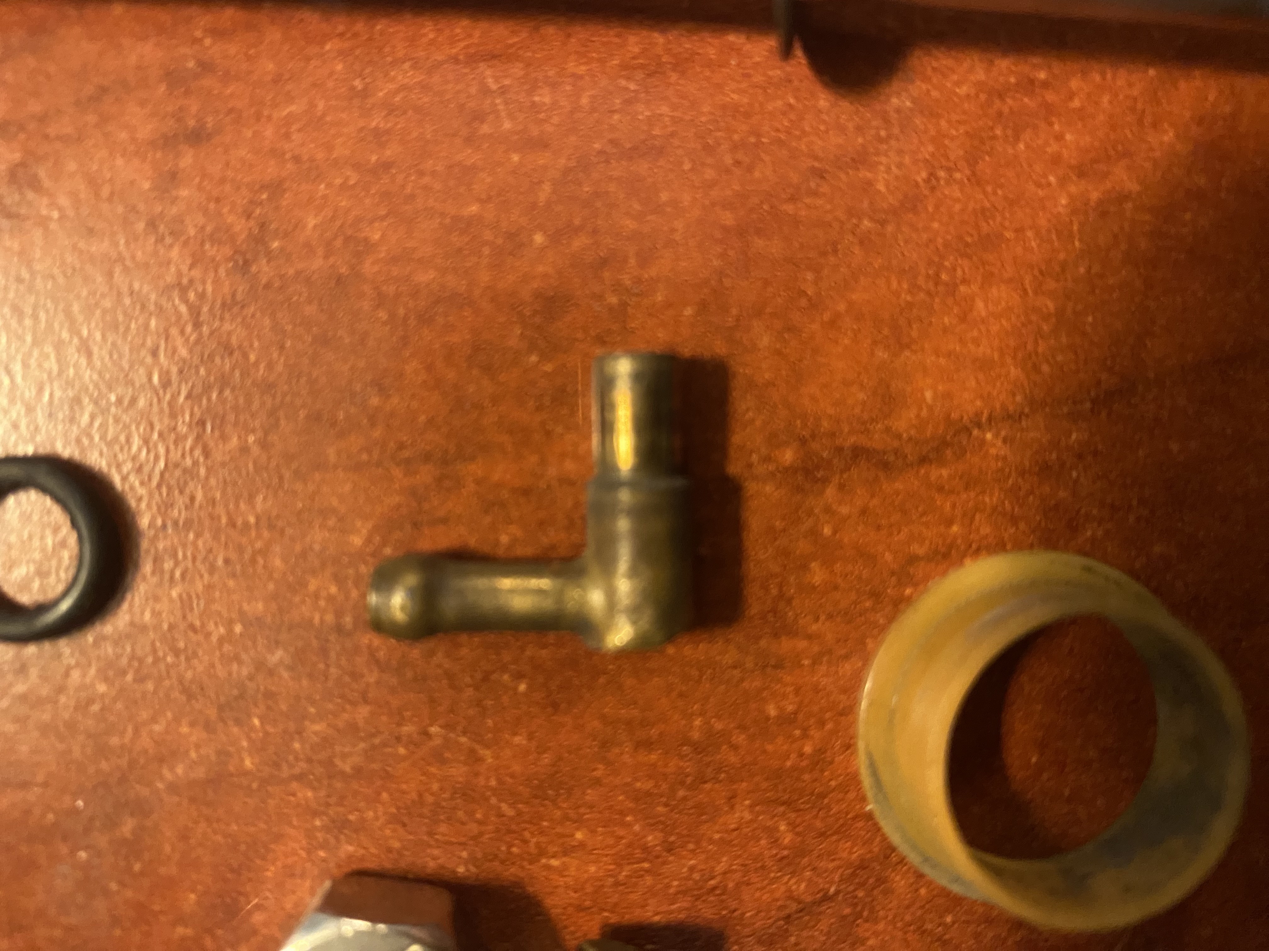

Rage car throttlebody
Note the 90 degree fitting was not shown on first throttlebody.
Orings are new. 2 on one side. Single on other.

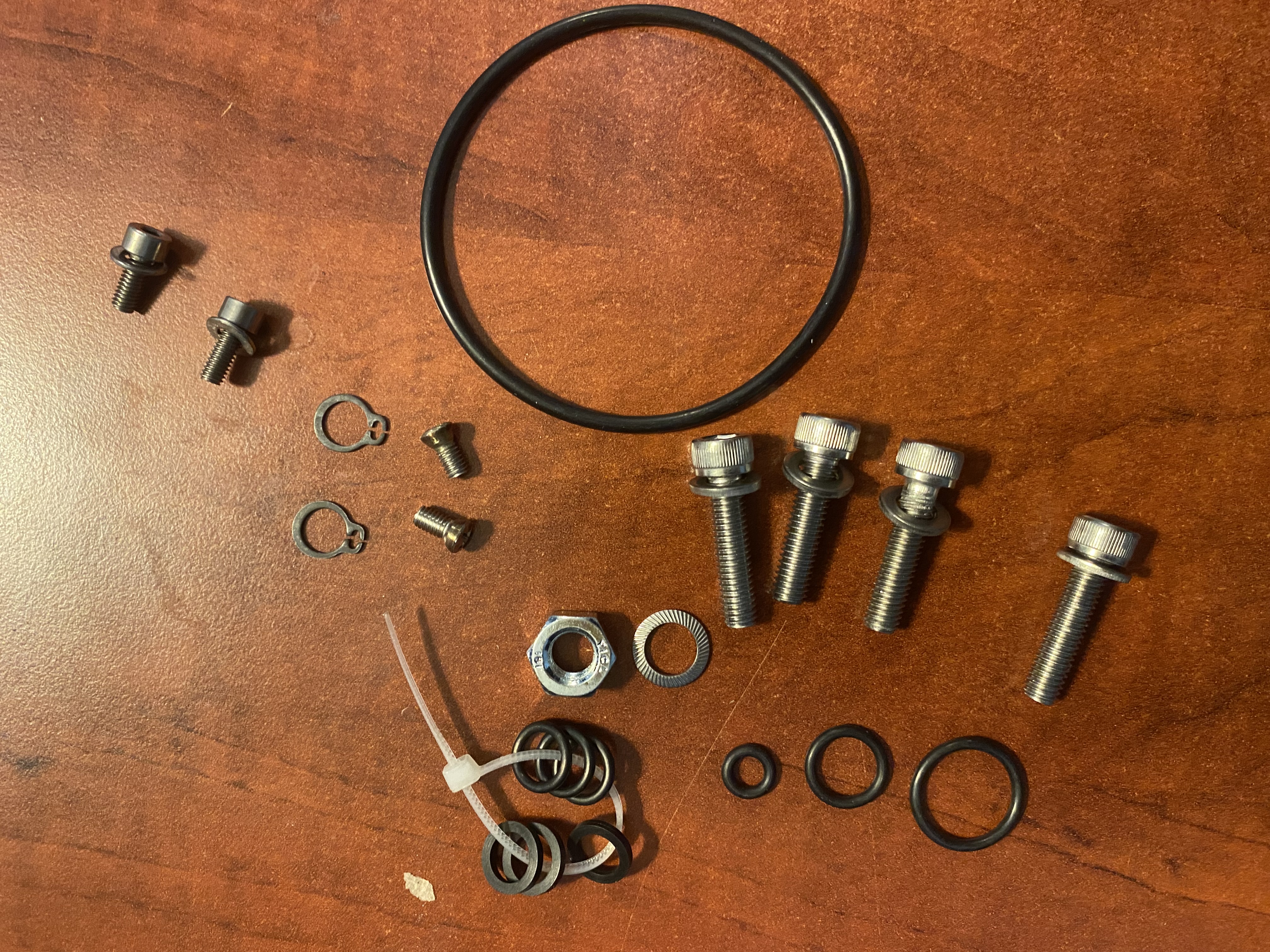

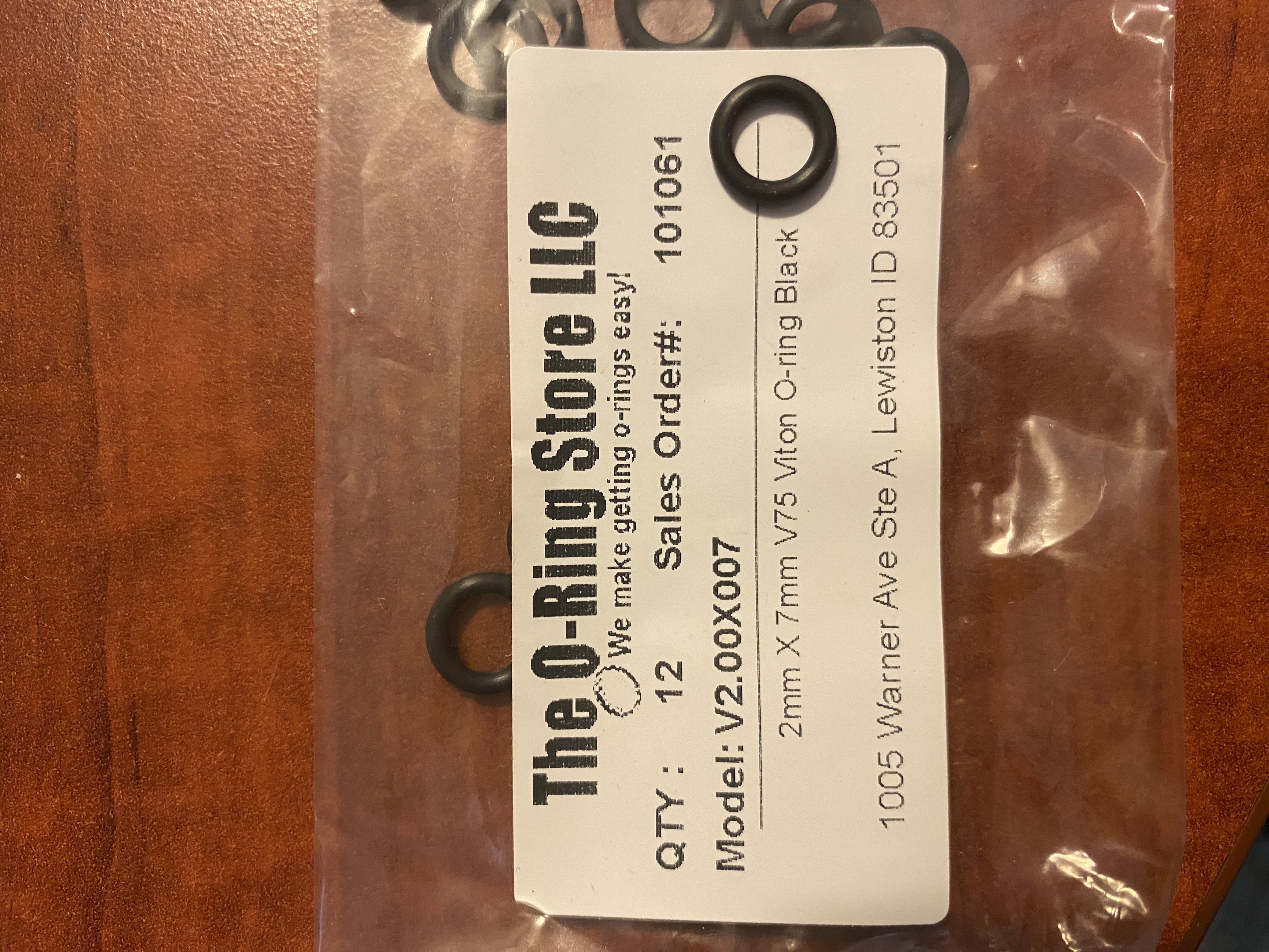

Oring store same size as Arnworx
Edit these are 8mm not 7mm
Pic was wrong bag.
They are 8mm x 2mm

Arnworx kit

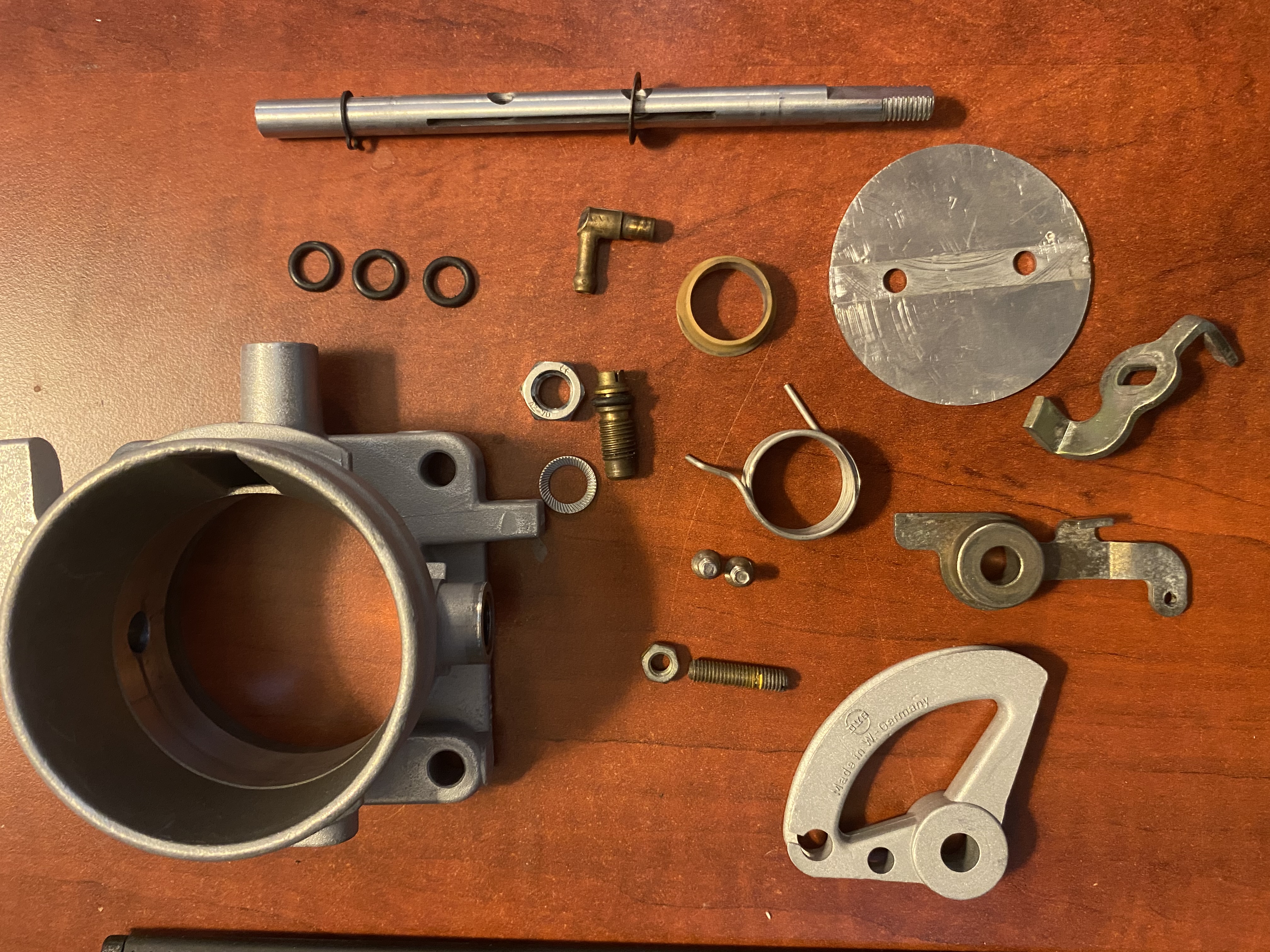

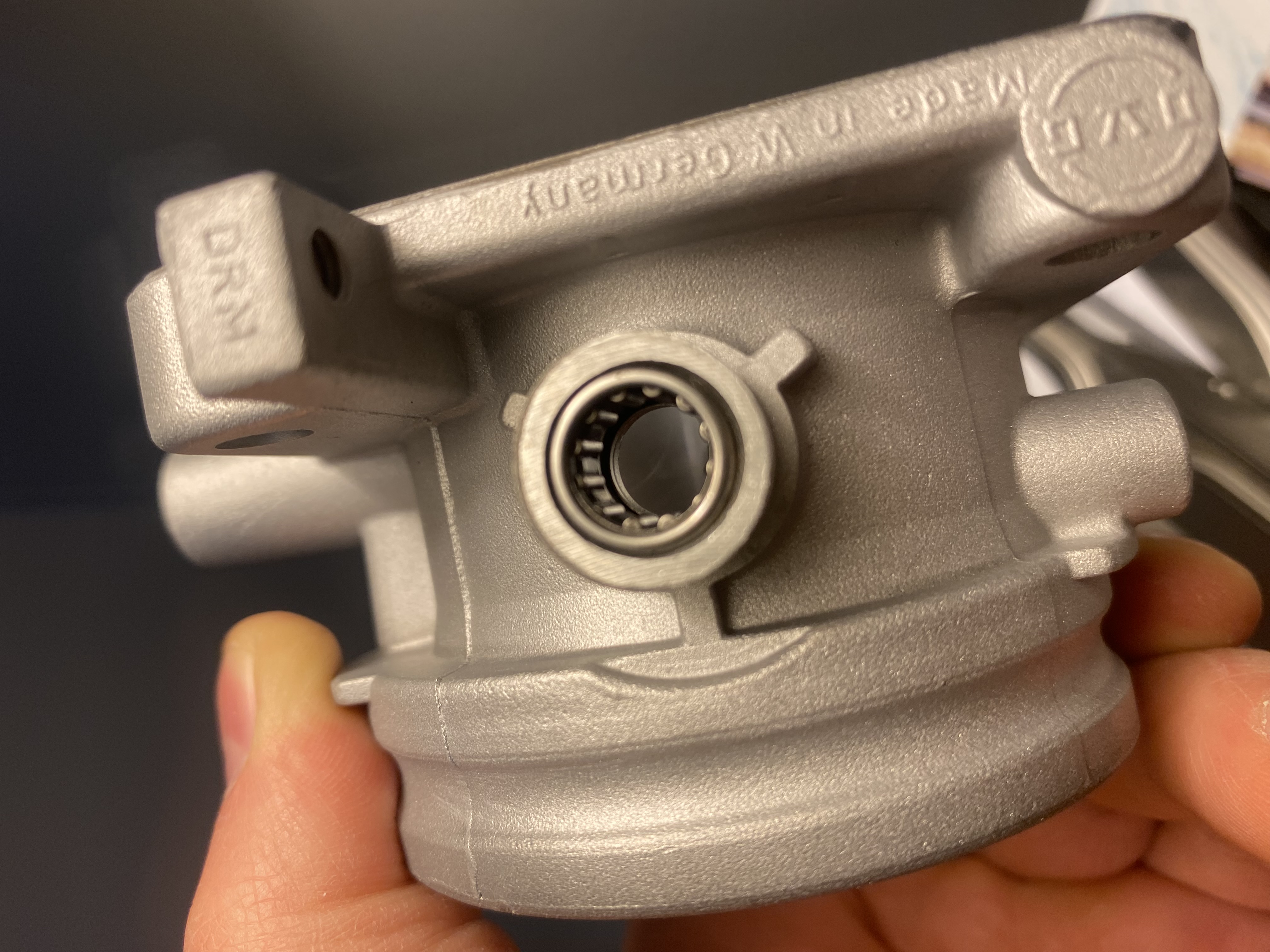

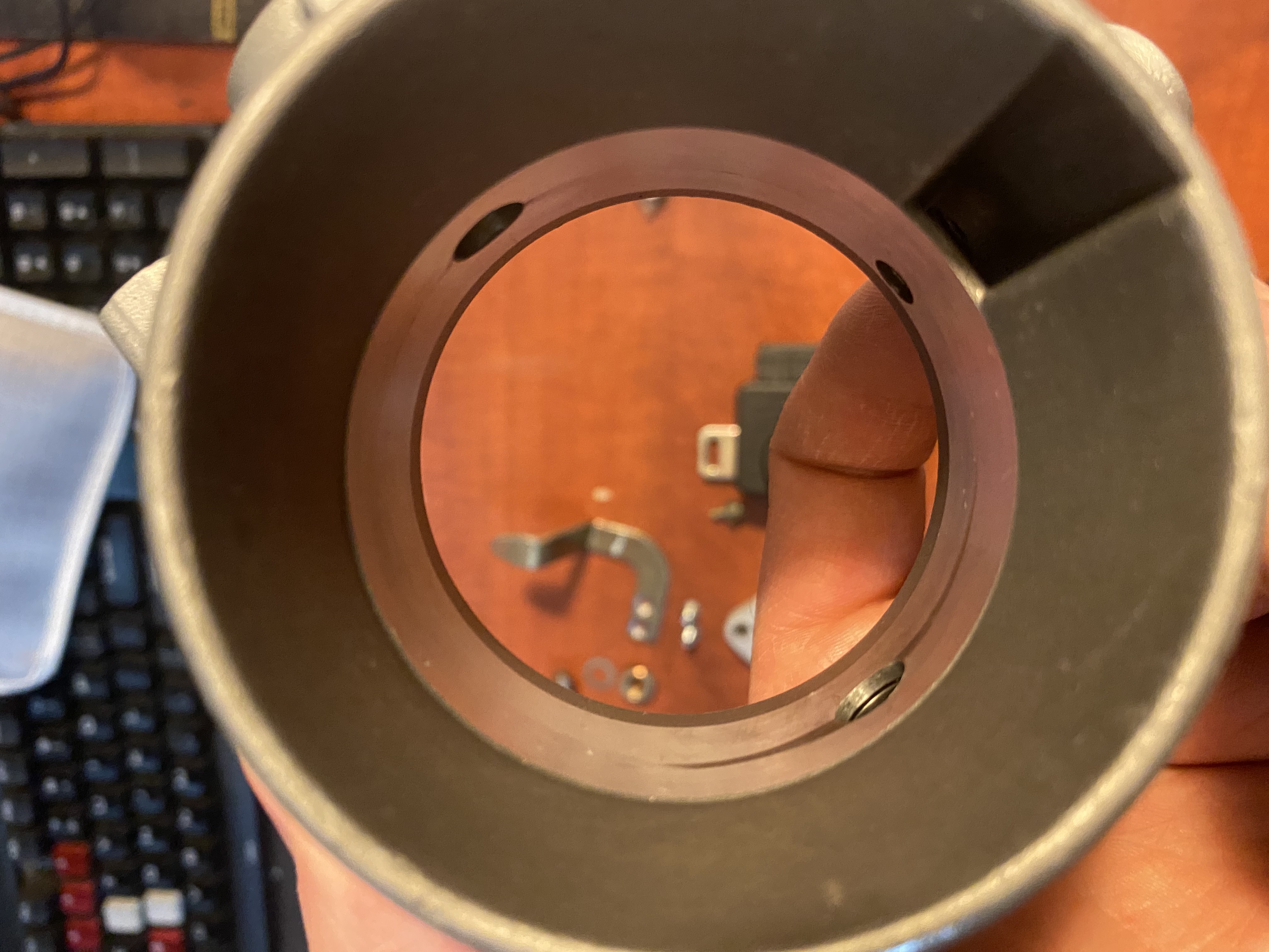

Last cleaned throttle body from my 86 red car.
I will be plating all steel parts that require zinc chromate.
All three housings are spotless inside and out. The bearings don’t really wear out. Unless you see obvious damage pack them lightly with O-ring lube/grease like Braycote. We seal O-rings at work with this.
