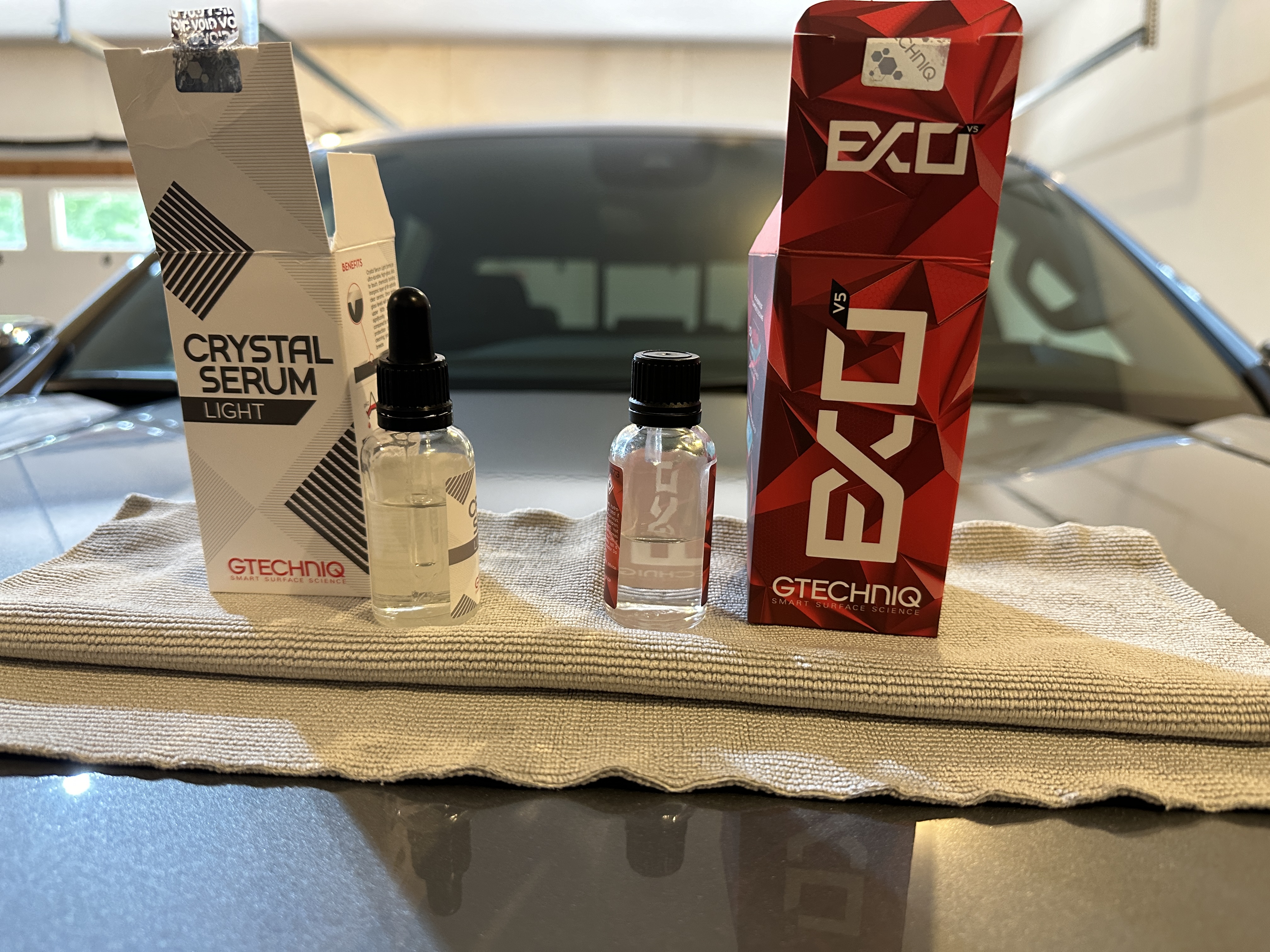

PPF is fairly soft, and “stuff” can stick in it more readily than paint / clear coat. Clay will remove this contamination, but is an abrasive process so should be done once or twice a year.
I say try ceramic coating. I just did my new rolling storage unit (half ton crew cab pickup). Decontamination wash, iron remover, polish a couple of spots and two coats of ceramic took me six hours on Saturday. A 911, being half the size will go quicker if you don’t have a lot of polishing to do.

GTechiq is good stuff, I used it before. I also used Carpro CQuartz, either one will do the job.
That was some work you did Norville, ceramic coating a truck!
I did one once, but it was a single cab...black, and it took me longer than six hours for sure. I also waited two days and did a second coat, and Collinite waxed it as a final step.
