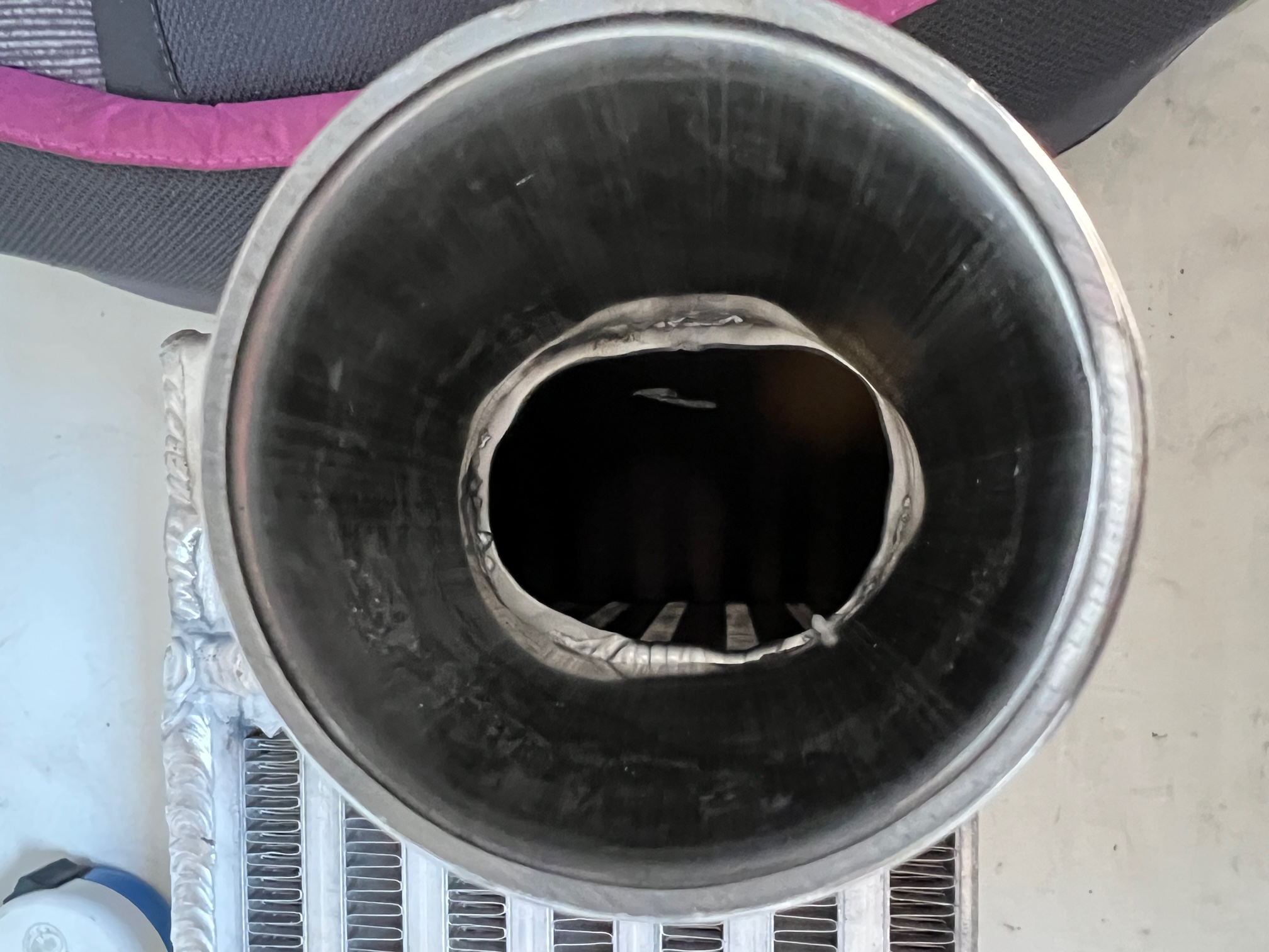

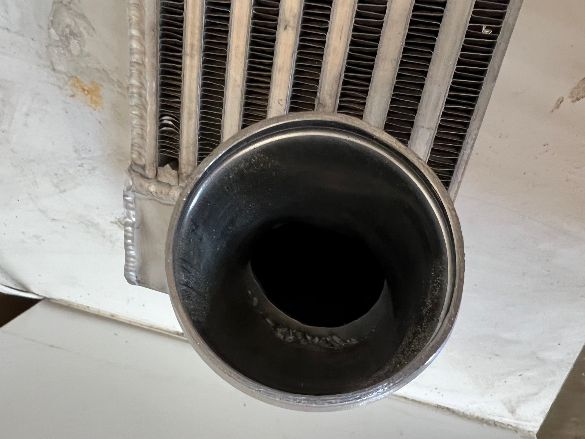

Tim, thanks for the help. Got it working. Here are the pictures of the SFR stage 1.5 IC.

Tom, I bought these about 4-5 months ago along with the 1.5" piping. Just haven't gotten around to installing them as I was hunting down various oil leaks. I still need to figure out a rich running condition under boost so I have a proper baseline before swapping IC and piping.
I also need to clean up the opening in end tanks where the pipes are welded on. Was a bit surprised to see that the openings didn't really match the pipe diameters.

Hmmm, interesting pictures. :shock: :shock: :shock: Careful not to get metal shavings in the intercooler/motor.... On my 3 liter car, I'm not sure the flow is much of a limit. I long time ago I data logged intercoolers and remember concluding the stock intercooler doesn't benefit much from more flow unless you are making more power than a typical 951. However, the stock intercooler heats up very fast and takes a while to shed the heat, so bigger intercoolers like this allow for lower air intake temps after the very first boost run. (Less heat = more power, less knock, more happiness.) I had posted my data on a now defunct forum (951forums for anyone who remembers that) but it was crazy how much hotter the income air was with the stock intercooler after one or two full boost bursts.
I recently did a set of intercooler pipes for another Carpokean, and ended up comparing them to my SFR pipes. I discovered in that process that the joints inside were unfinished, much like your pictures. In my case, there was still ragged metal scraps around the holes that were drilled for the blow off and other small pipes -- no deburring at all before welding. Not knocking Tim and SFR, as he's a great welder and makes things others won't/can't. But the lesson is to inspect every part closely no matter how much you trust your machine shop, welder, etc.

Agree I have to be very careful about metal shavings when cleaning up these ICs.
