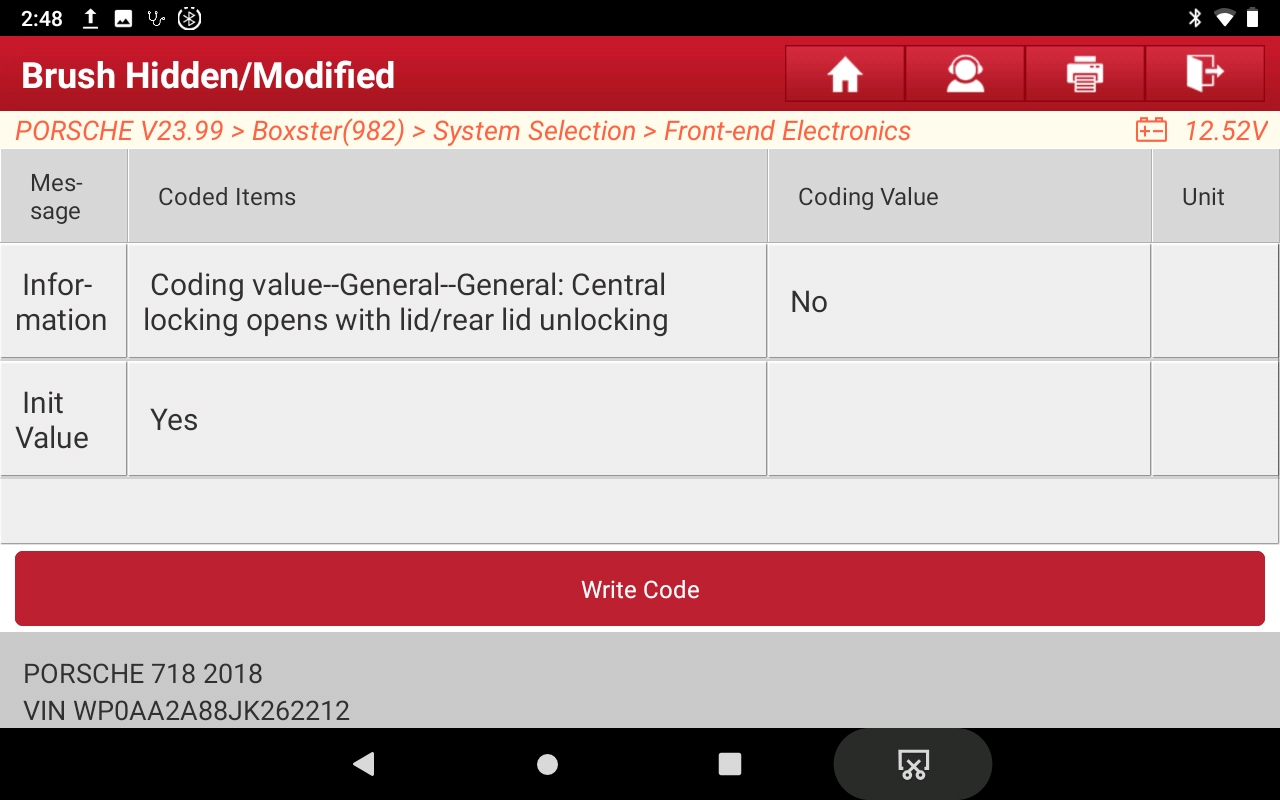

By default, opening either deck or trunk via fob or proximity sensors unlocks the doors as well. To me, that's silly. Say I'm at cars & coffee, and need something from the trunk. I open the trunk, grab the camera or whatever, and close the trunk. But now the doors are unlocked, so I have remember to lock the car again before I leave. Neither my Audi or Golf are/were this way. I can open the hatch on the Audi while locked, and none of the doors unlock. Close the hatch, the car chirps and is locked. Much more logical to me. The change here addresses this.
Don't unlock all doors when opening trunk/rear lid via fob or proximity sensors
  • Front-end Electronics > Coding value--General--General: Central locking opens with lid/rear lid unlocking = No
    {Default: Yes}

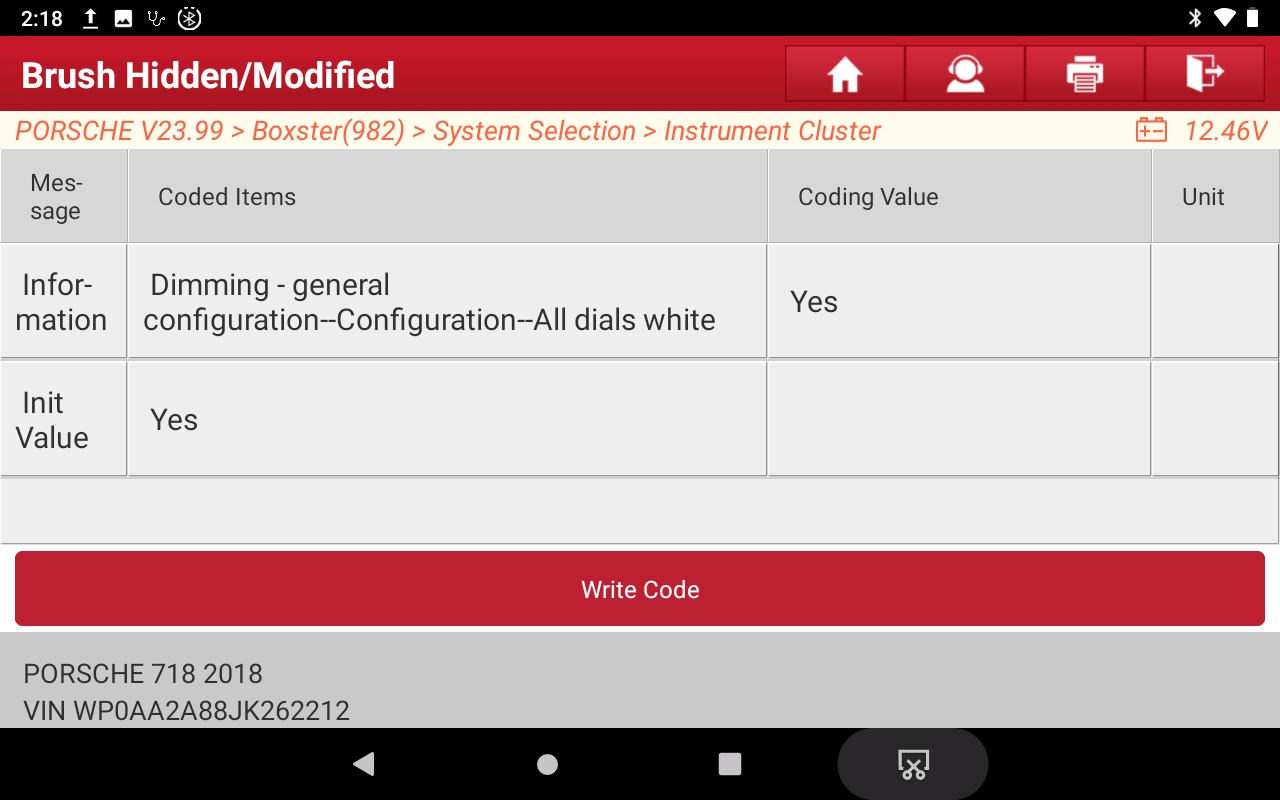

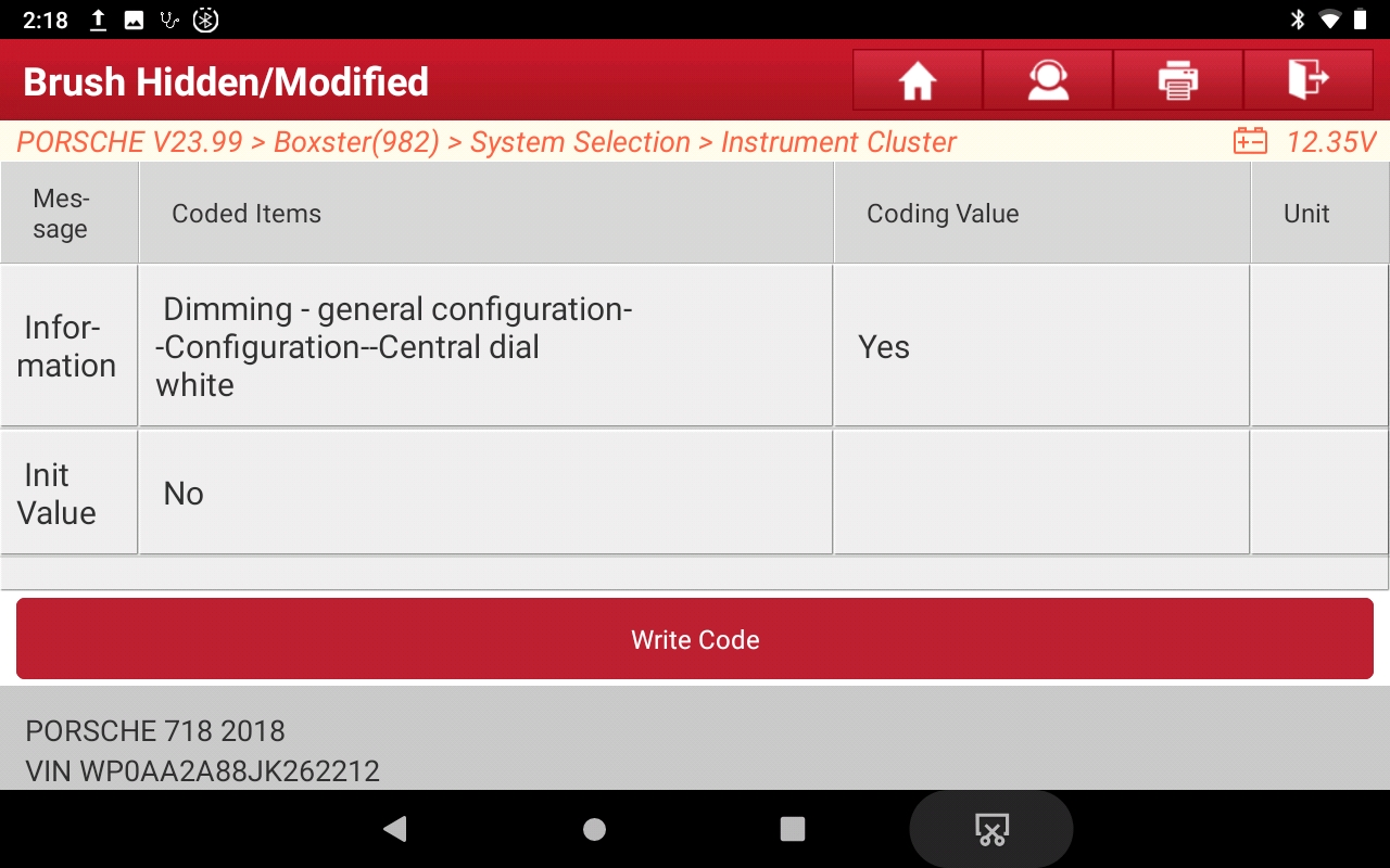

You can enable backlighting on the tach and speedo with headlights off. This makes all the numbers readable in daylight, but does not illuminate the gauge needles. You can turn on the central tach dial only, or both speedometer and tach.
Daylight gauge backlighting on
  • Instrument Cluster > Dimming-general configuration > Configuration-central dial white = YES
    {Default: No}

  • Instrument Cluster > Dimming-general configuration > Configuration-all dials white = YES
    {Default: No}

The white-gauge-face hack posted here to turn on the gauge backlighting at all times has one drawback—the gauge needles don't light up unless the lights are actually on.
There is an other way to light the gauges that lights the needles as well. That is done by adding the "marker lights" to the DRL settings. (This is known as "Scandinavian DRLs" in Audi and VW parlance.) The "marker lights" are the tail lights, license lights, front side markers (in the US and Canada) and the gauges including the needles. By default (at least on my 2018 CB), the front parking lights are NOT activated by this change. (There is a separate option to turn these on with DRLs.) But the gauges (incl. needles) do come on with the key, in any light. The drawback to this one is that while some people can tolerate running the tail lights at all times, having the front side markers always lit bothers them. To address that, check this next post.
