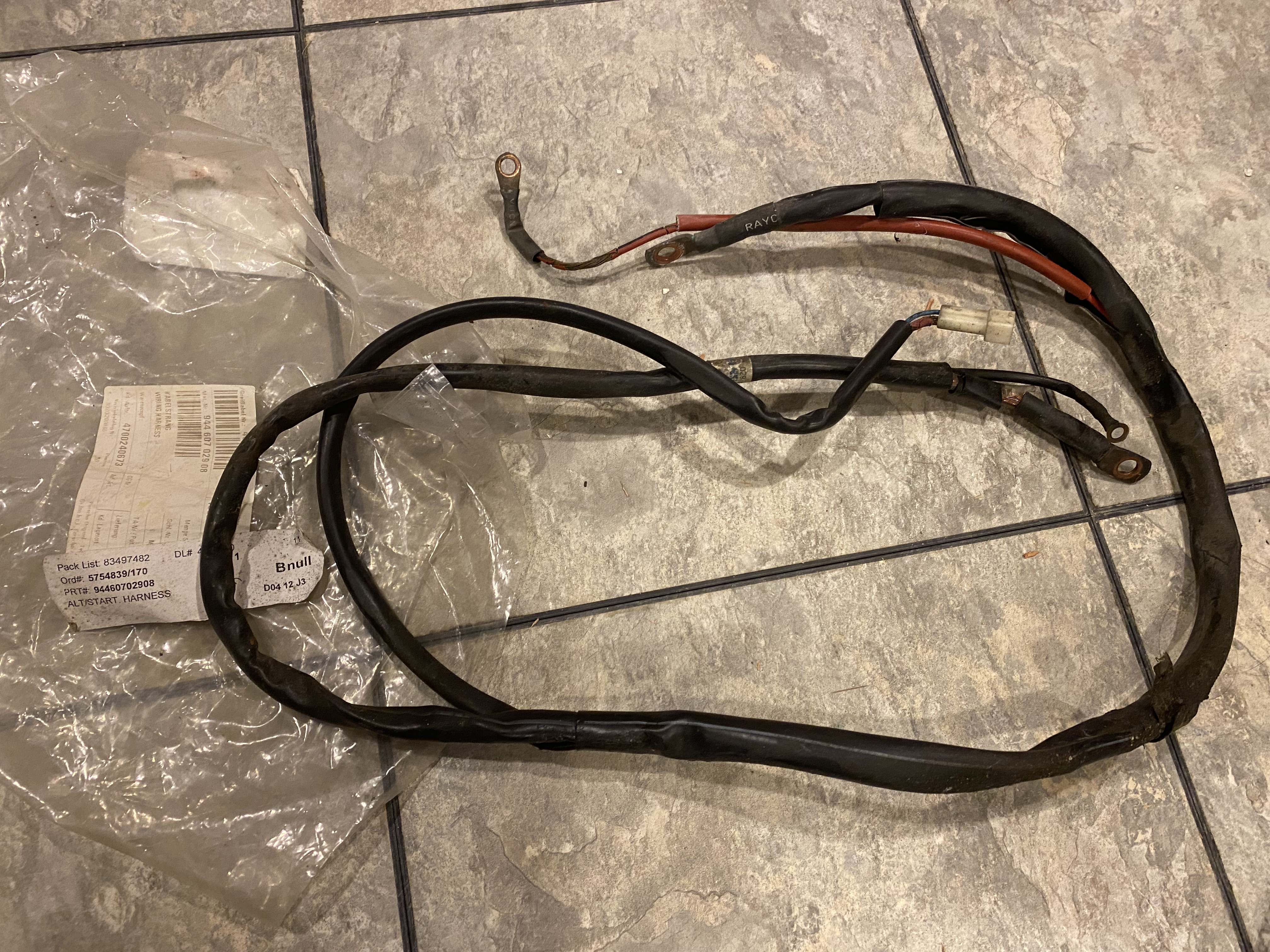

Sure thing - here's the alternator harness I just got and where it plugs into on the firewall side.
Looks painfully similar to a standard 2 pin molex, but just a bit different.
Probably easier to just cut it off and go to a 2 pin DTM connector.

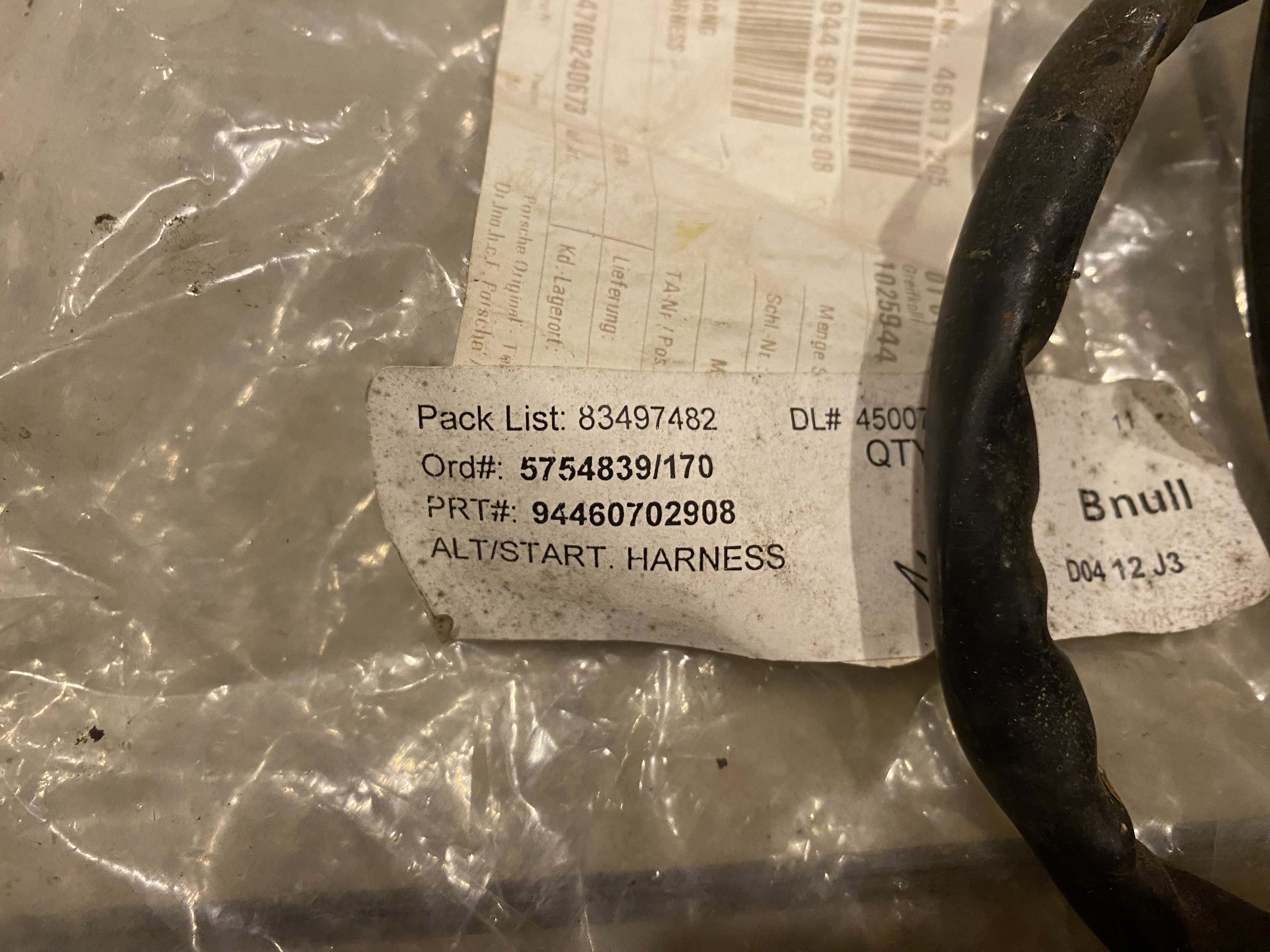

Here’s the alternator cable I replaced with a new one I bought from a dealership. It was a few years ago and is for the tiptronic 968, so it’s a little longer than the manual 968’s harness. Maybe this will work for the 944s as well.

I could swear someone posted what that connector was somewhere and I 'thought' it was a Mate n Lok by TE, but I'm having no luck finding it. Have you concluded it's not available, or just haven't been able to find it. If it's truly NLA, it would be easy enough to just replace both sides with different connector (WatherPack, Molex, etc.). I bet it could also be 3D printed, since it's relatively large.
