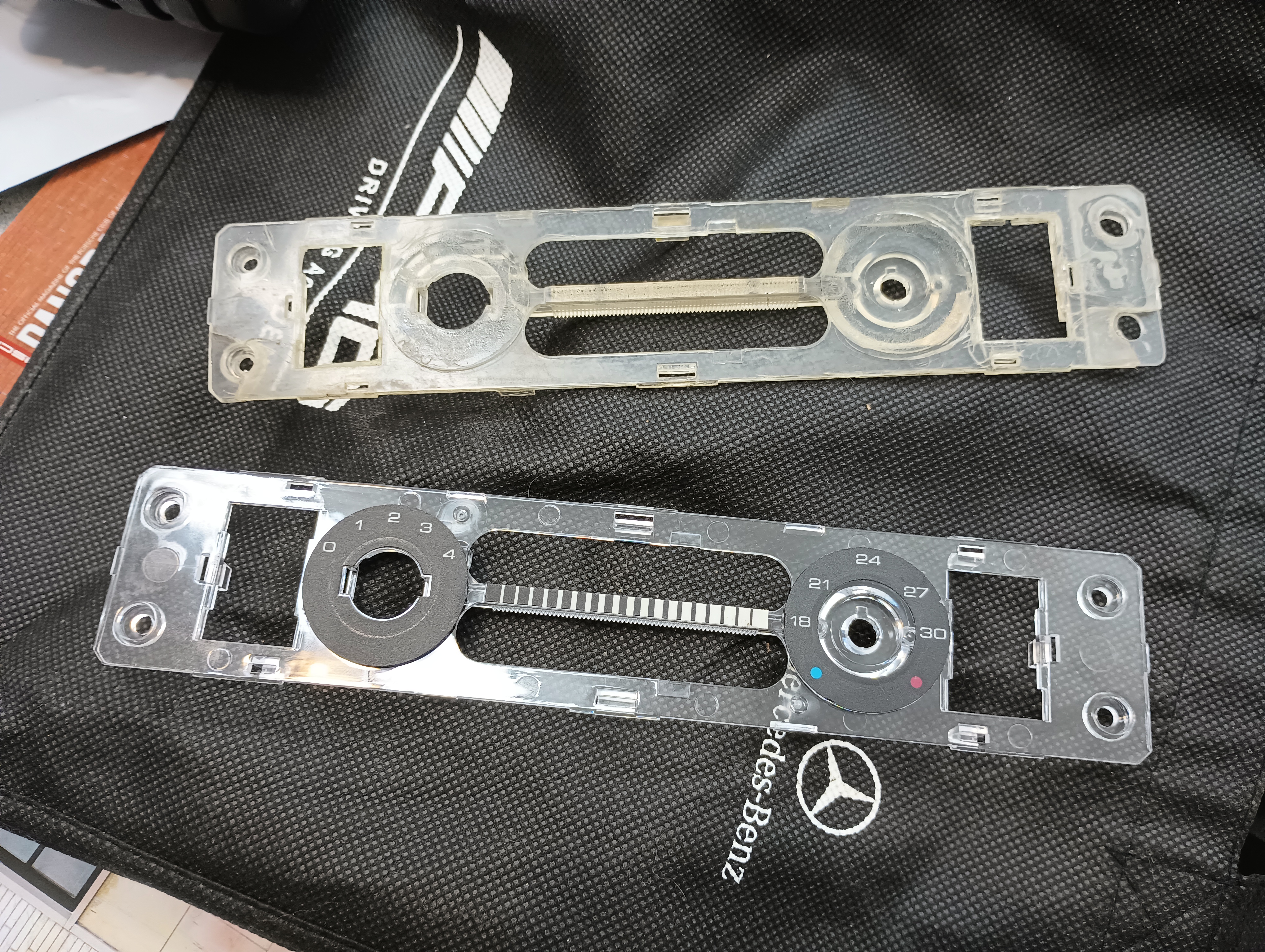

First I want to thank Travis, excellent product all over, and extra fast shipping.

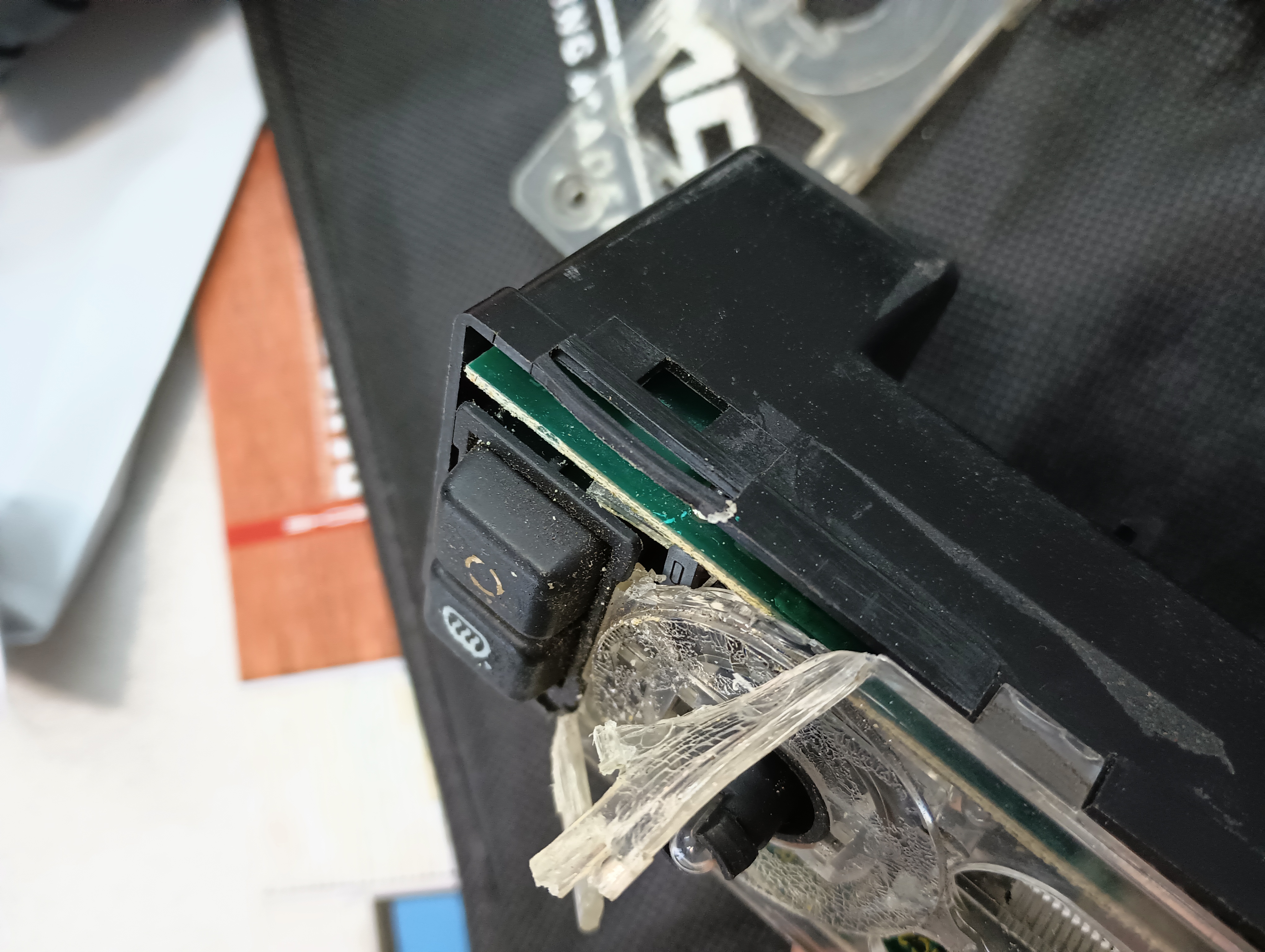

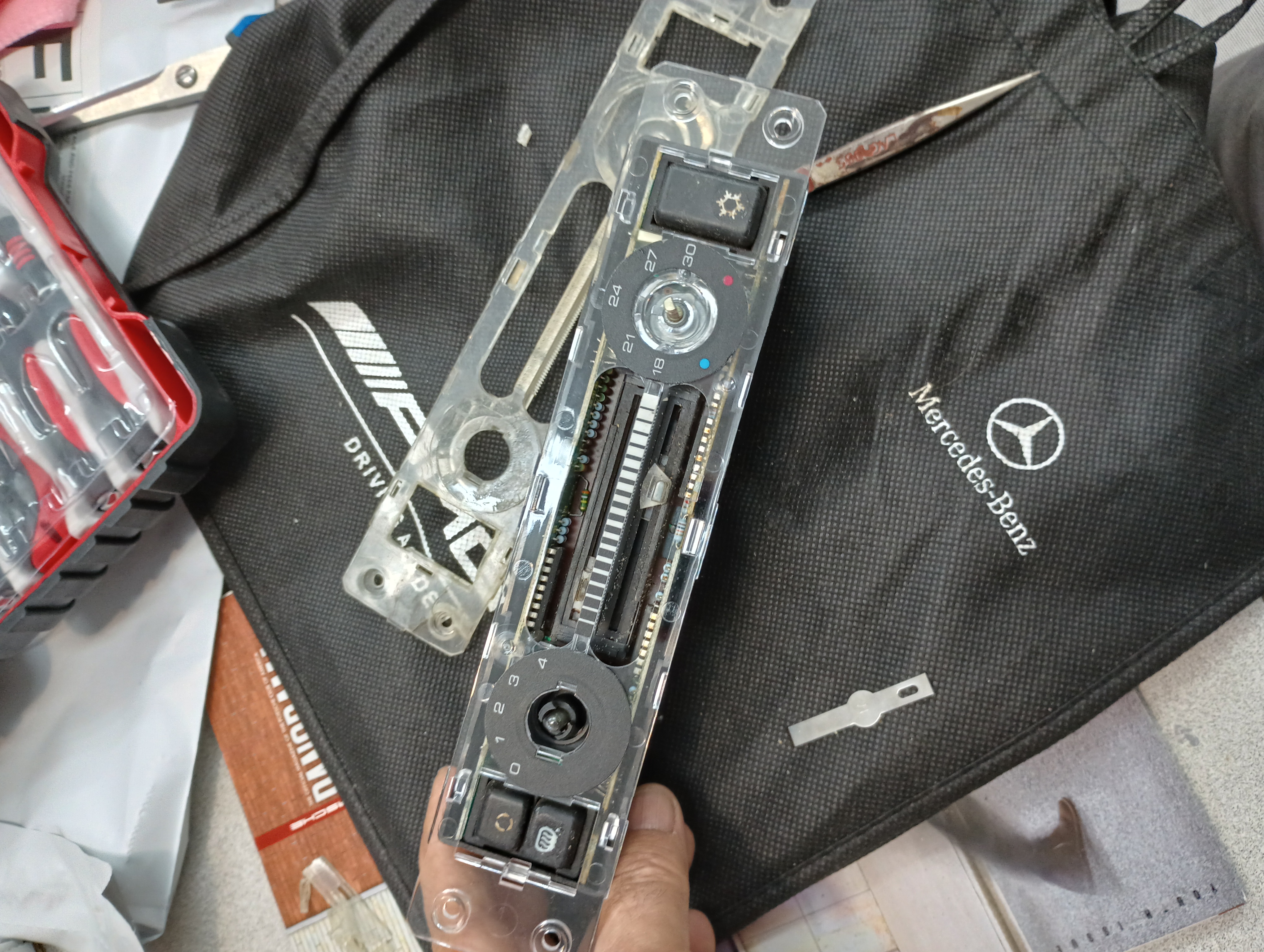

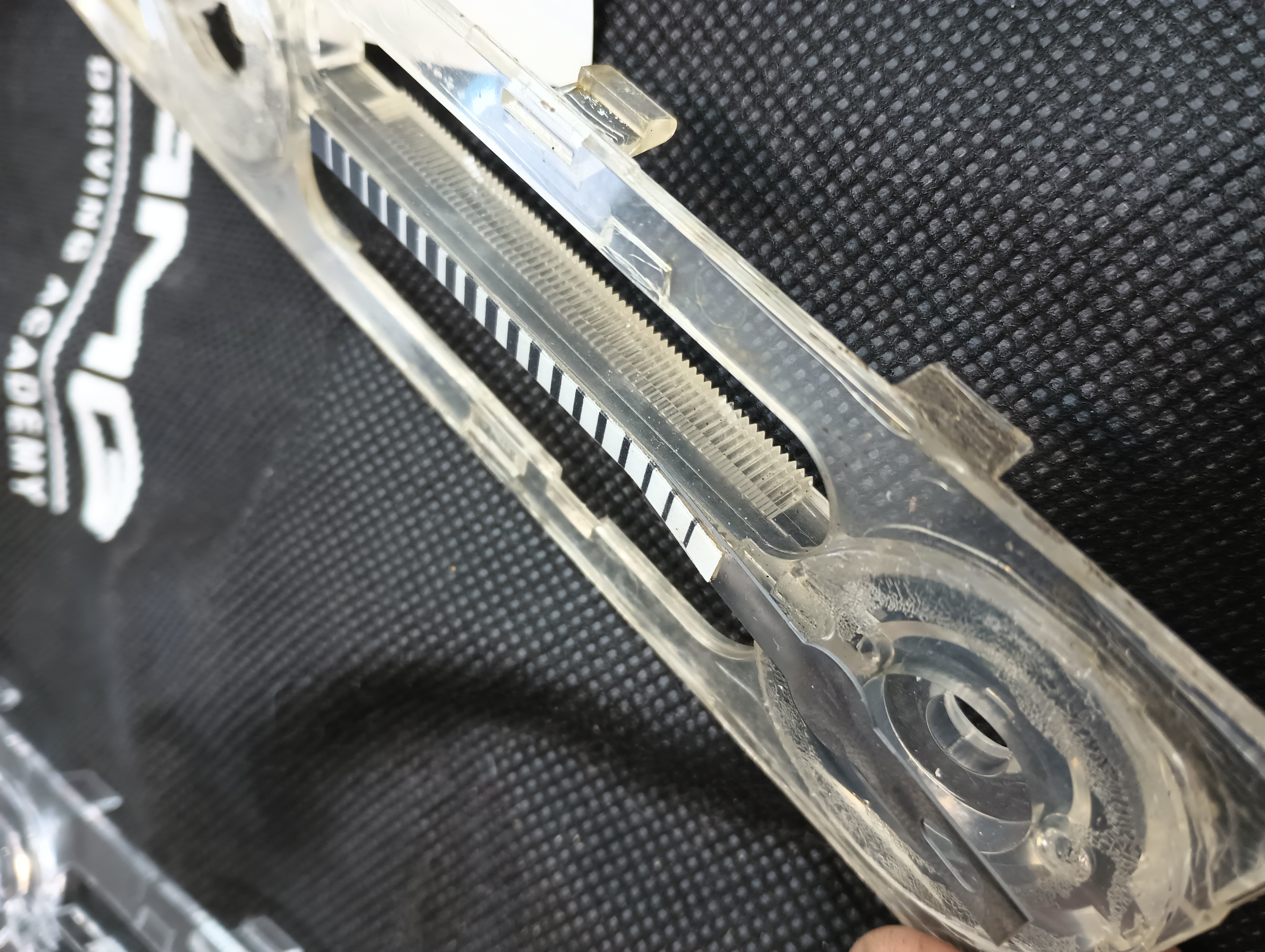

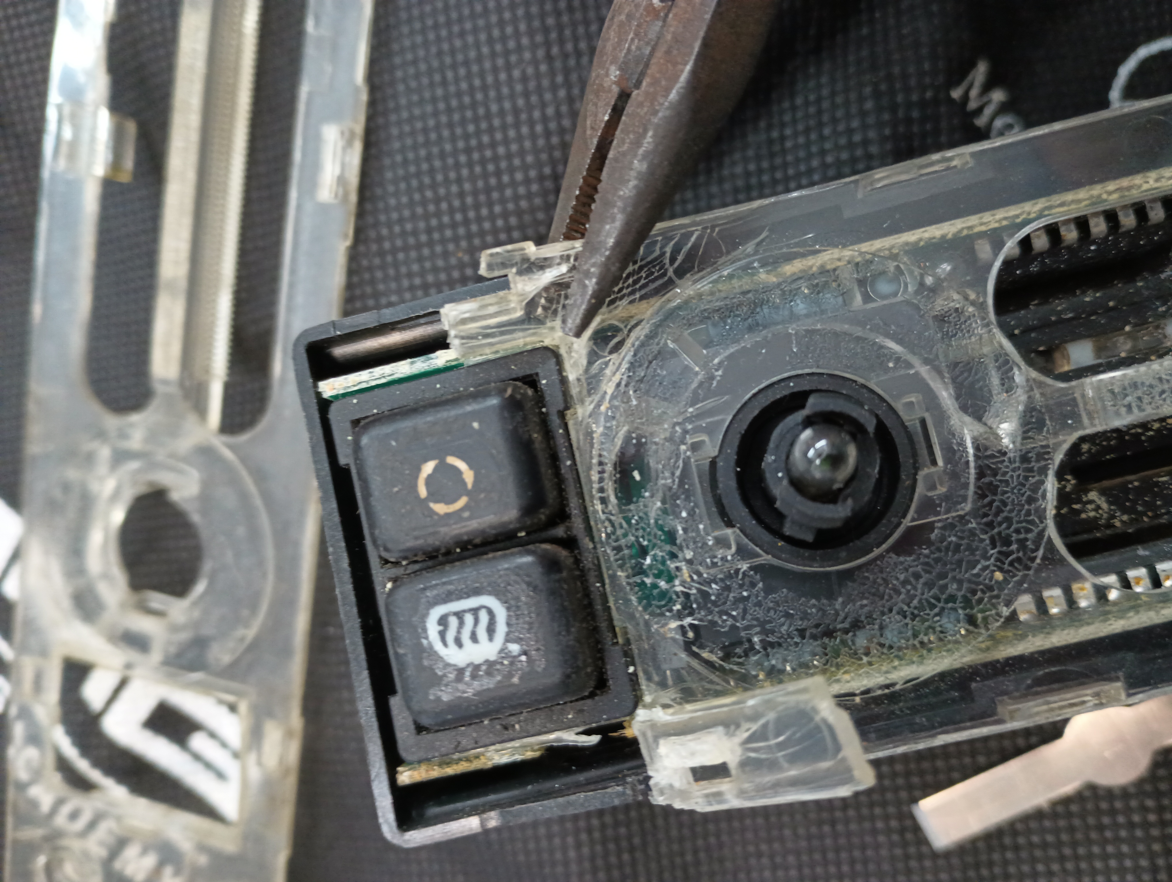

I started to do three units today, Transferring the stickers is pretty simple, I just used a small exact blade inserted between the plastic and the sticker, and gently go around.
Then use some spray glue (I like temporary from any hobby store), apply some and put the stickers on the new panel.

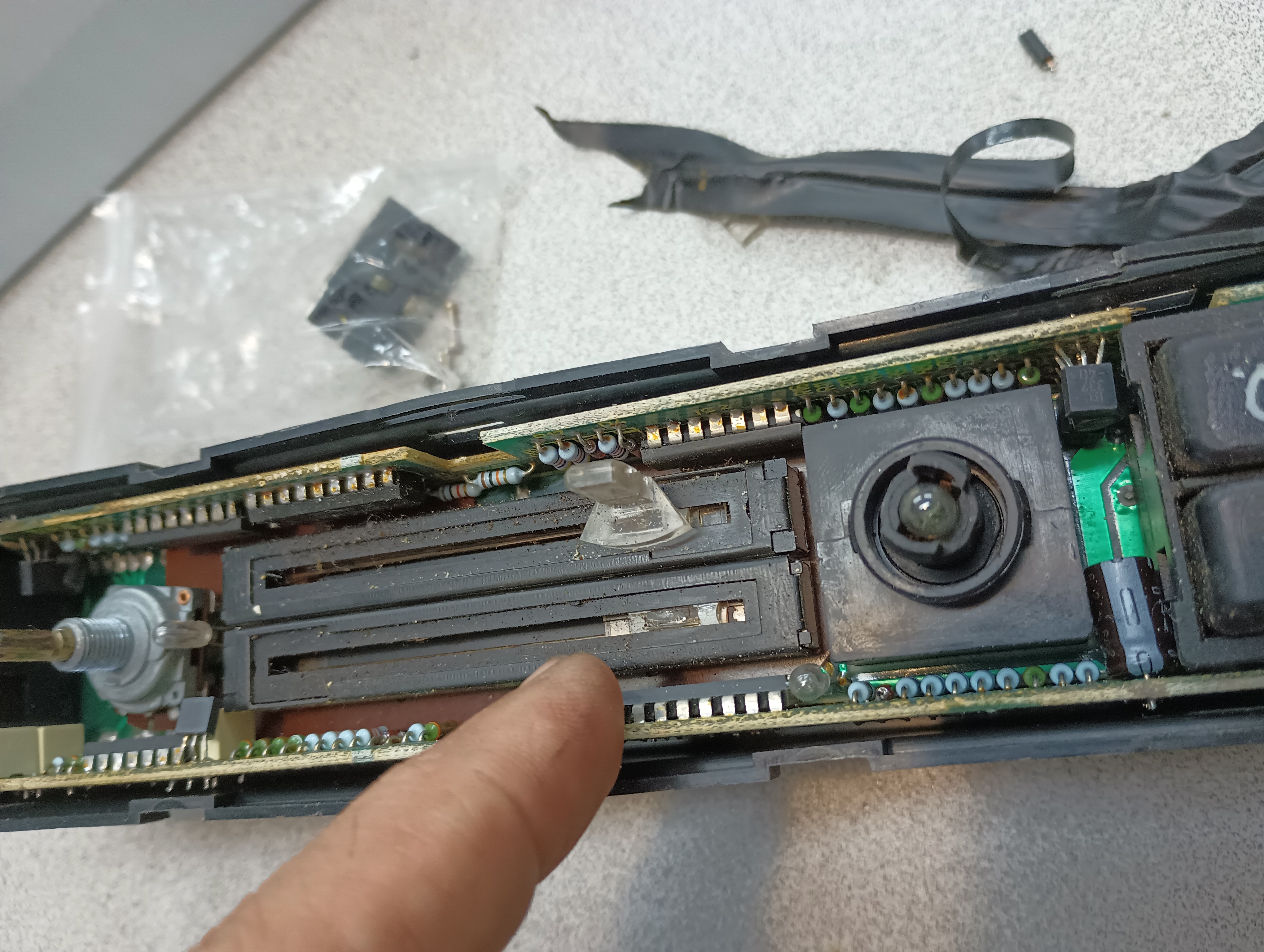

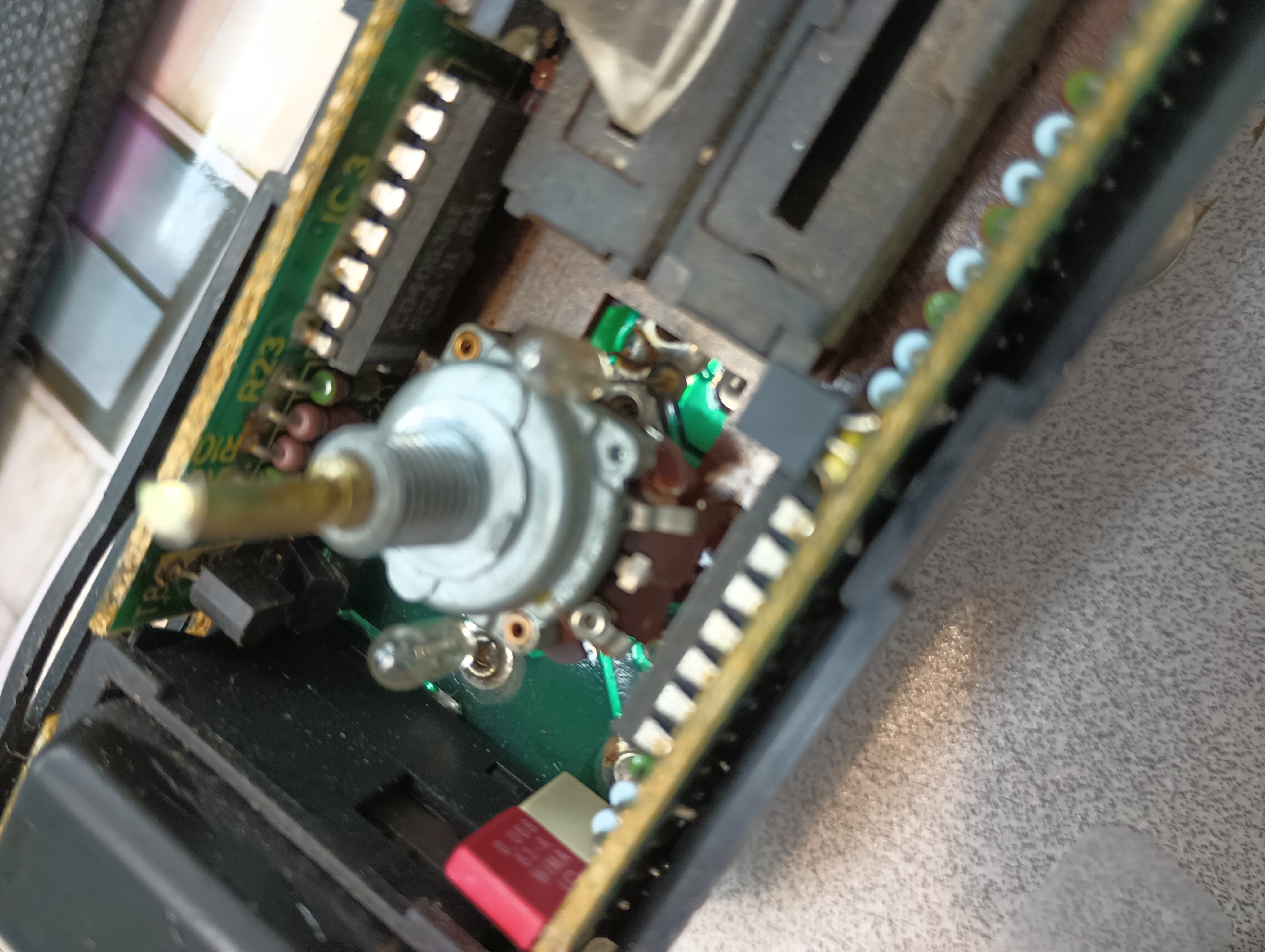

Then remember what was talked about here, the old panel is secured by the switches (under), so I suggest you DESTROY THE OLD PANEL, break off in small pieces, and keep going, until EVERYTHING IS LOOSE.
I made the mistake of being overly confident, and did not think that the old panel would be stuck to the rheostat, and when I pulled, I damaged the rheostat and one of the sliders, so I suggest you brake it, especially if it is not completely brittle. I have many units, so some had a "better" panel, those were the ones that were more difficult.
After you remove the old panel, (hopefully you will not damage anything), the new panel just snaps in and gets secured with the rheostat nut. Just make sure that the 2 bulbs on the side of the rheostat for blue and red, are correctly aligned and done.

Good write-up.
I too ordered this. Fast shipping and the installation was a breeze.
I had the typical cracked and yellowed original and the screw points on one side were broken.
It fit perfectly. Nice remanufacture on this.
