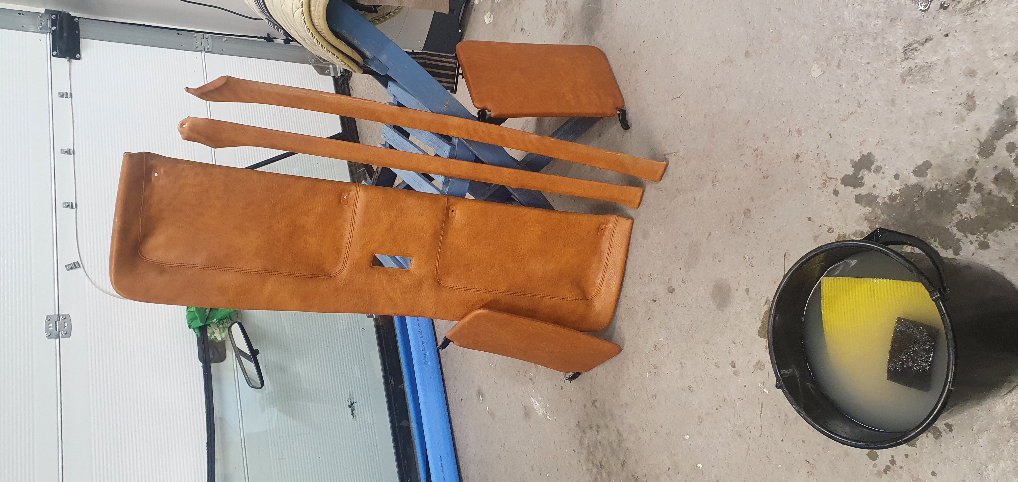

When the car is at the paintshop I take the opportunity to clean all the interior parts.

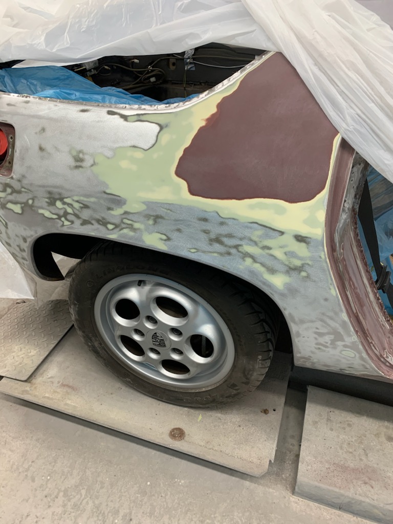

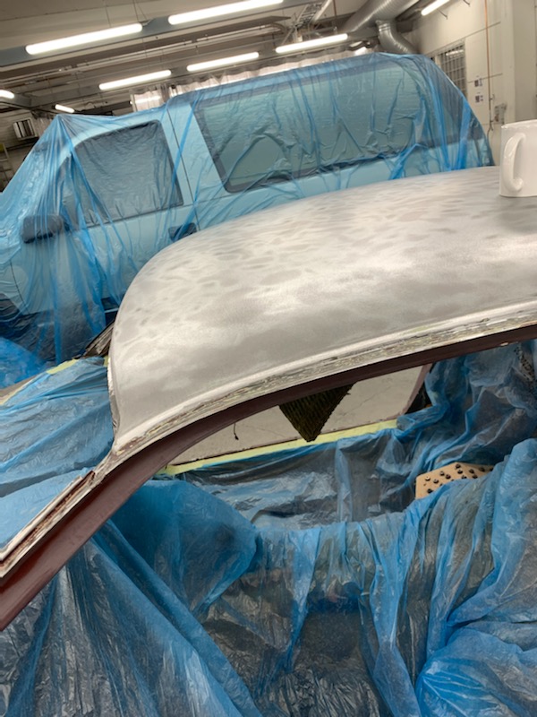

The painter is taking the body of the car back to bare metal before primer.
All is in great shape, no visable corrosion.

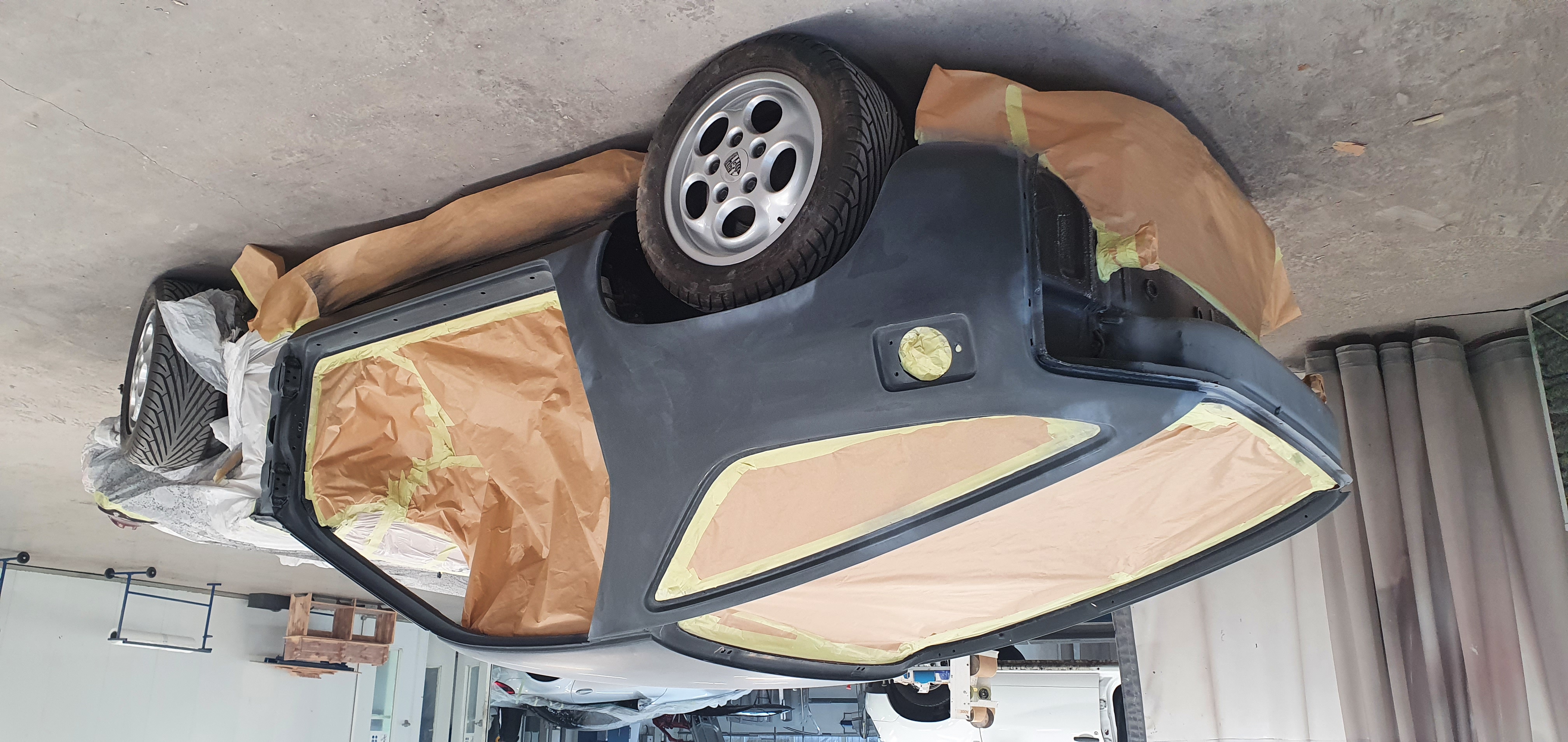

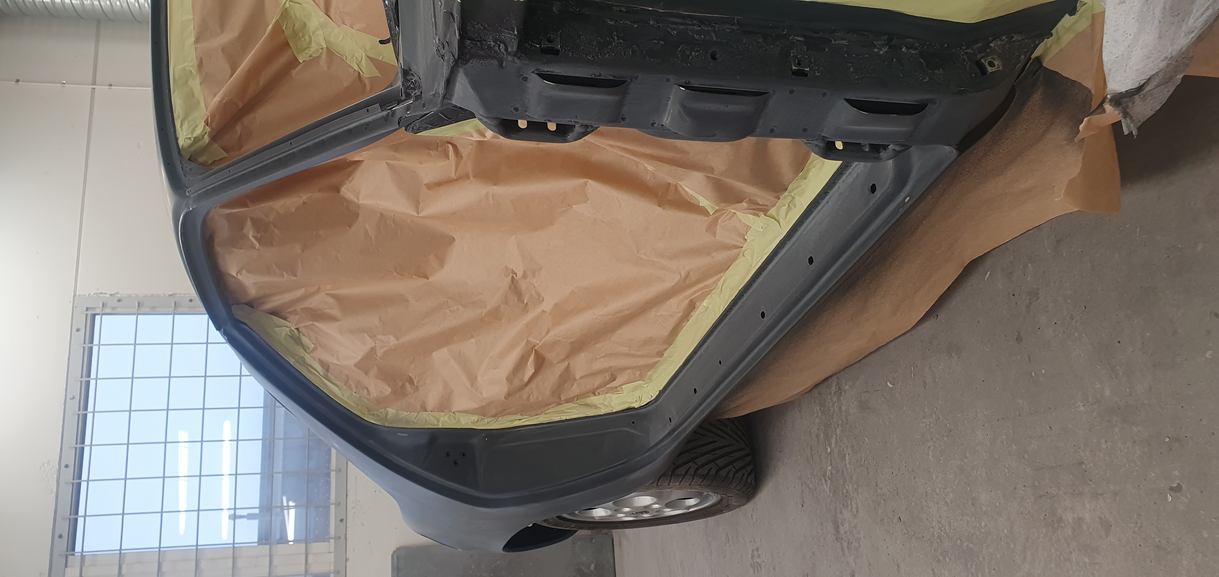

Ok so now the body has been prepped and now ready for paint🙂
#19
Posts: 9098
Been thanked: 4085 times
Looking great! Tons of effort showing there in terms of taking things off/apart to avoid the cheap 'respray' look. This should look awesome when done! Did they remove the gas filler pipe!?! :shock:
