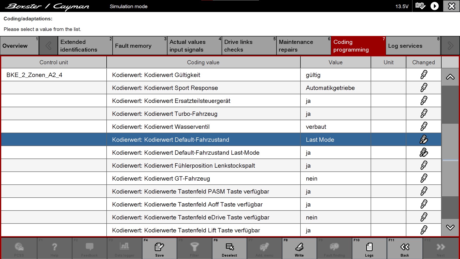

Auto Start Stop Remember Last Mode

718socal wrote: Wed Mar 01, 2023 9:14 am Auto Start Stop Remember Last Mode

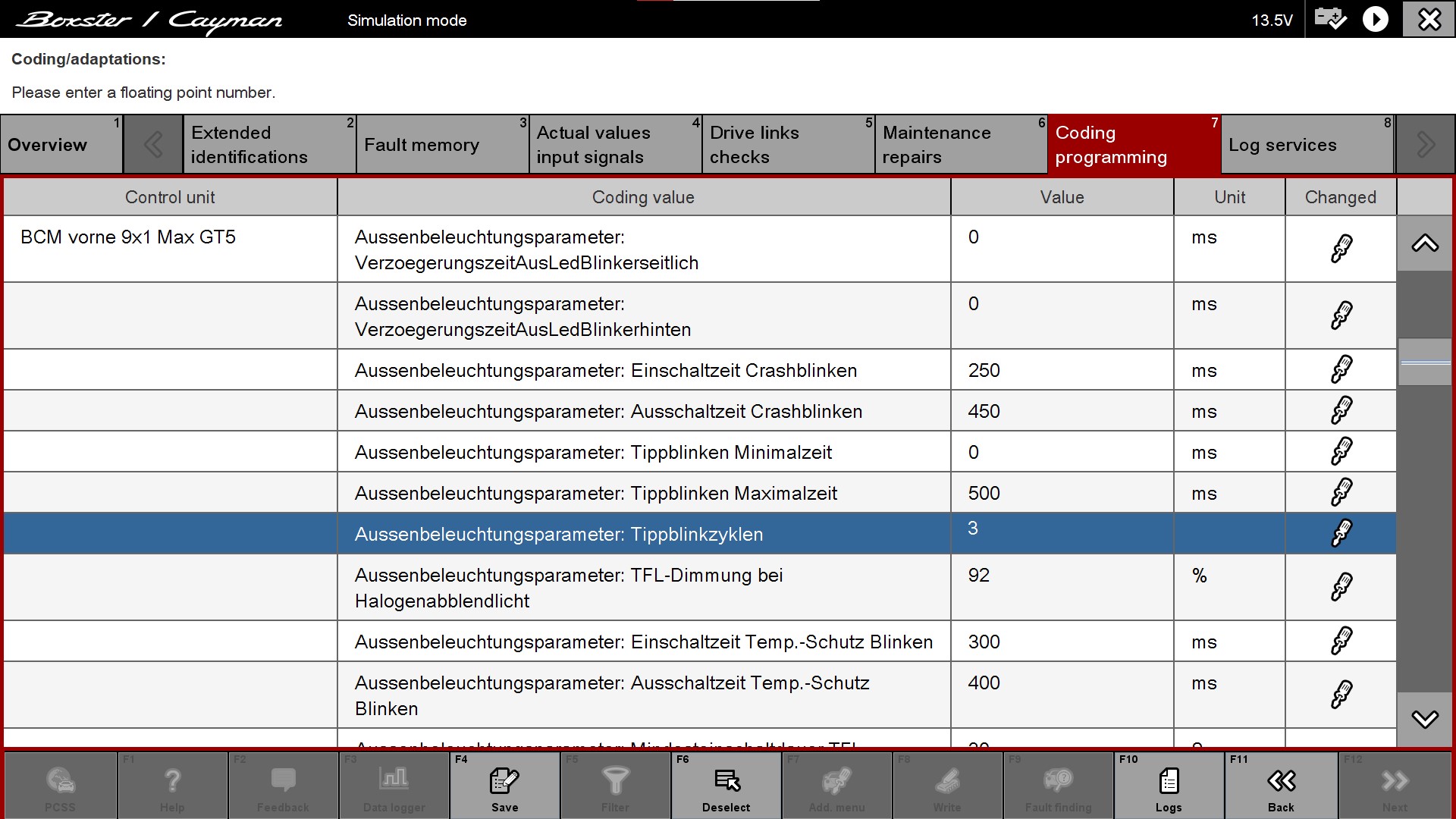

Change Turn Signal Blink from 3 to X

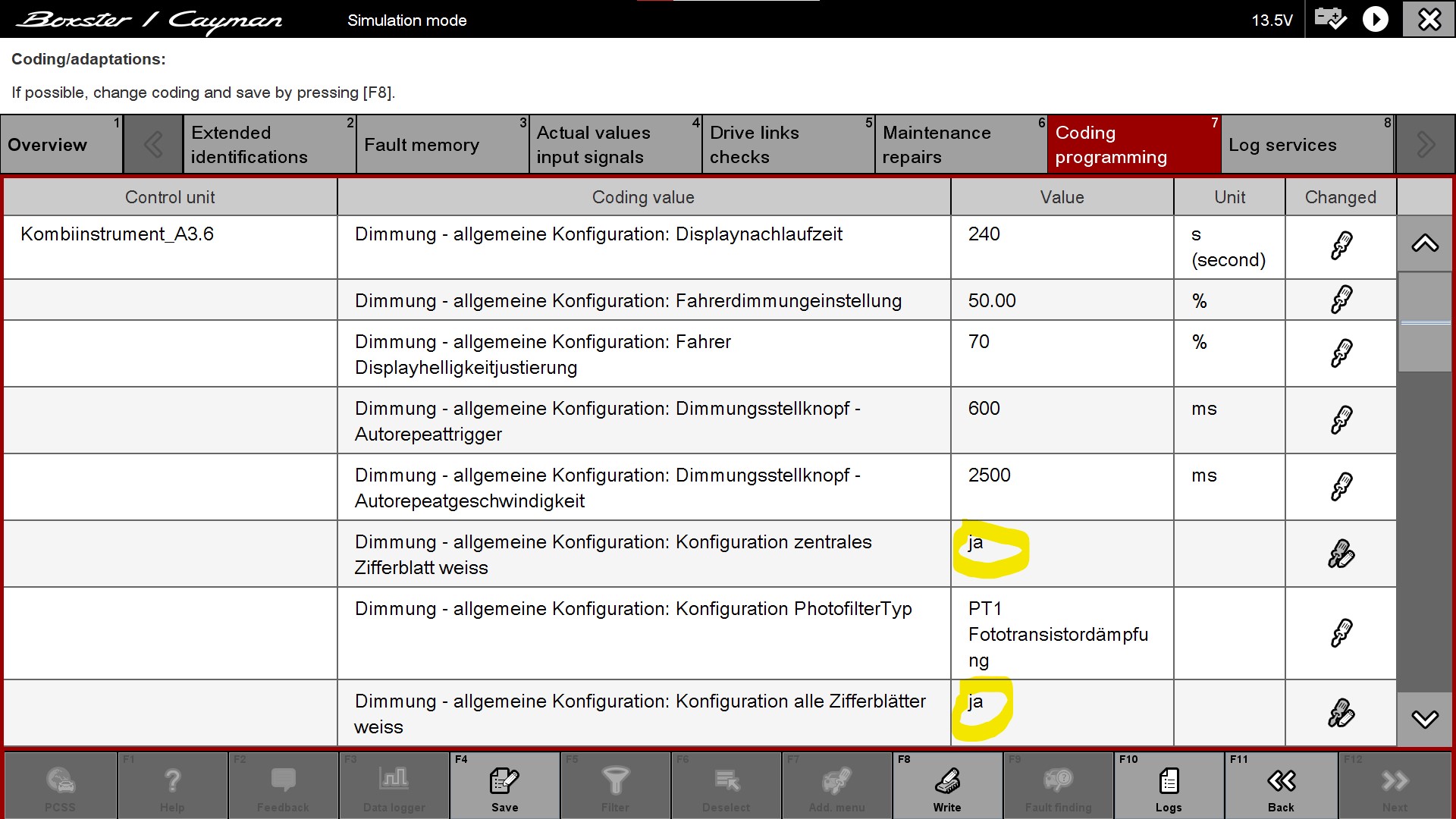

Turn On Instrument Cluster lights to Always ON
White Dial2.jpg (331.36 KiB) Viewed 6311 times

blueline wrote: Wed Mar 01, 2023 9:21 am
I know nothing of PIWIS except that it exists and what it accomplishes, but it appears to me to be similar (at least as far as intent goes) to Windows Registry.
PIWIS codes the modules to enable/disable features.
#17

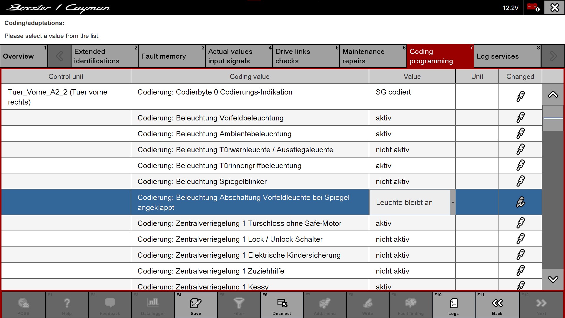

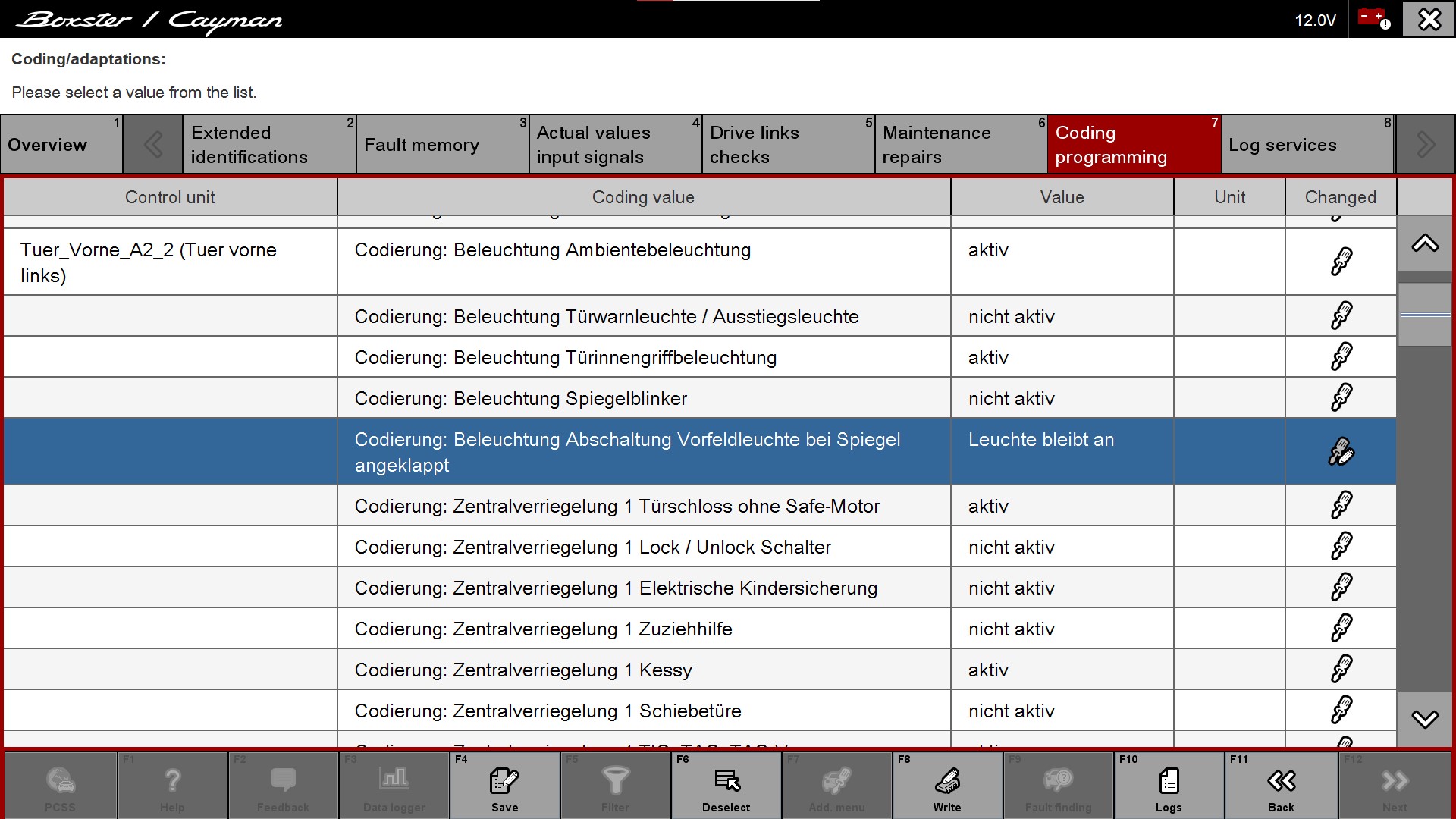

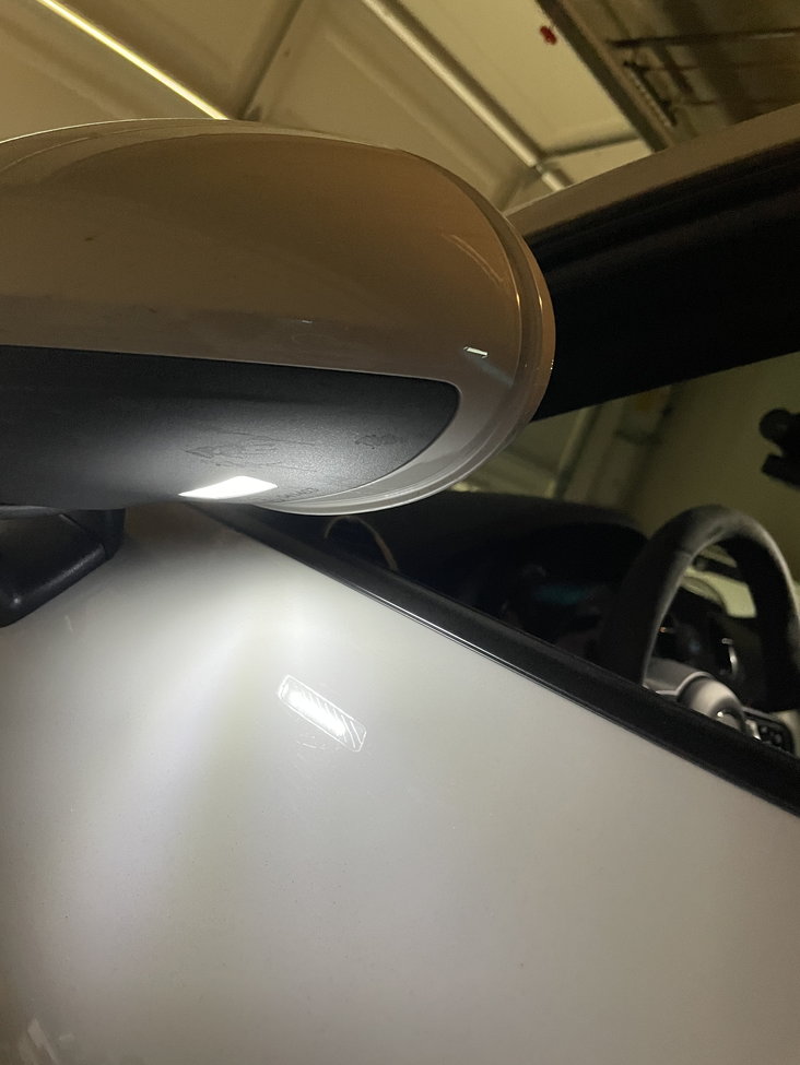

Enable Puddle lights when Mirrors folded
Puddle light3.jpeg (64.65 KiB) Viewed 6303 times
Puddle light1.jpg (347.1 KiB) Viewed 6303 times
Puddle light2.jpg (358.42 KiB) Viewed 6303 times
