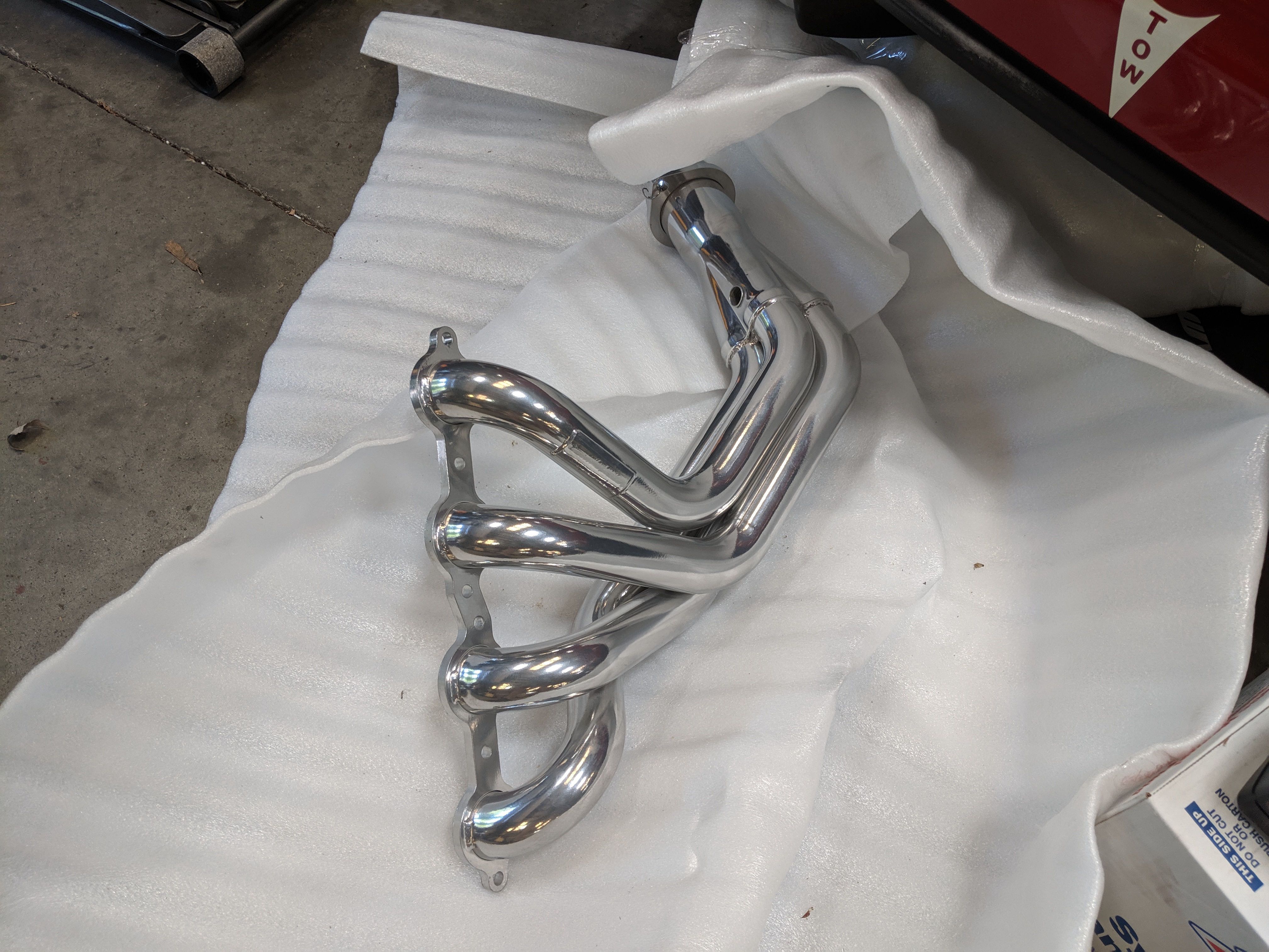

mwc951 wrote: Sun Dec 04, 2022 8:03 am I prefer Jet Hot coating.
Classic Polish is good to 1250 degrees and looks beautiful.
I did heat shields, coolant pipes, etc.
The turbo down pipe & WG pipes got Ultra good to 2500 degrees.

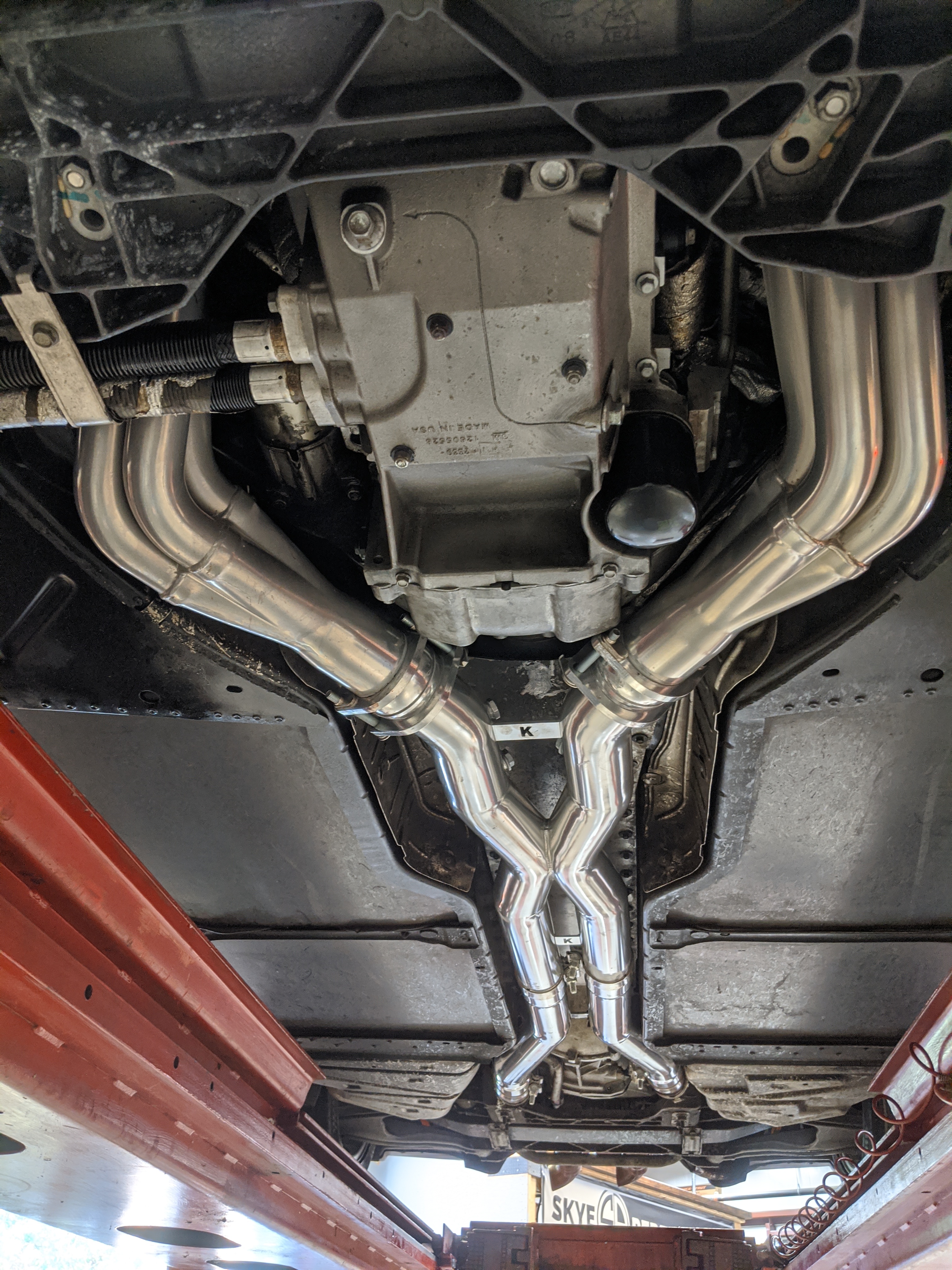

I had excellent results from Jet Hot.
Kooks SS headers/X-pipe/exh for a previous track-car-only '09 Z06 (sold in 2020) that were drop-shipped to Jet Hot for coating.
Summer 2019 when received:
8 months later they still looked good:
