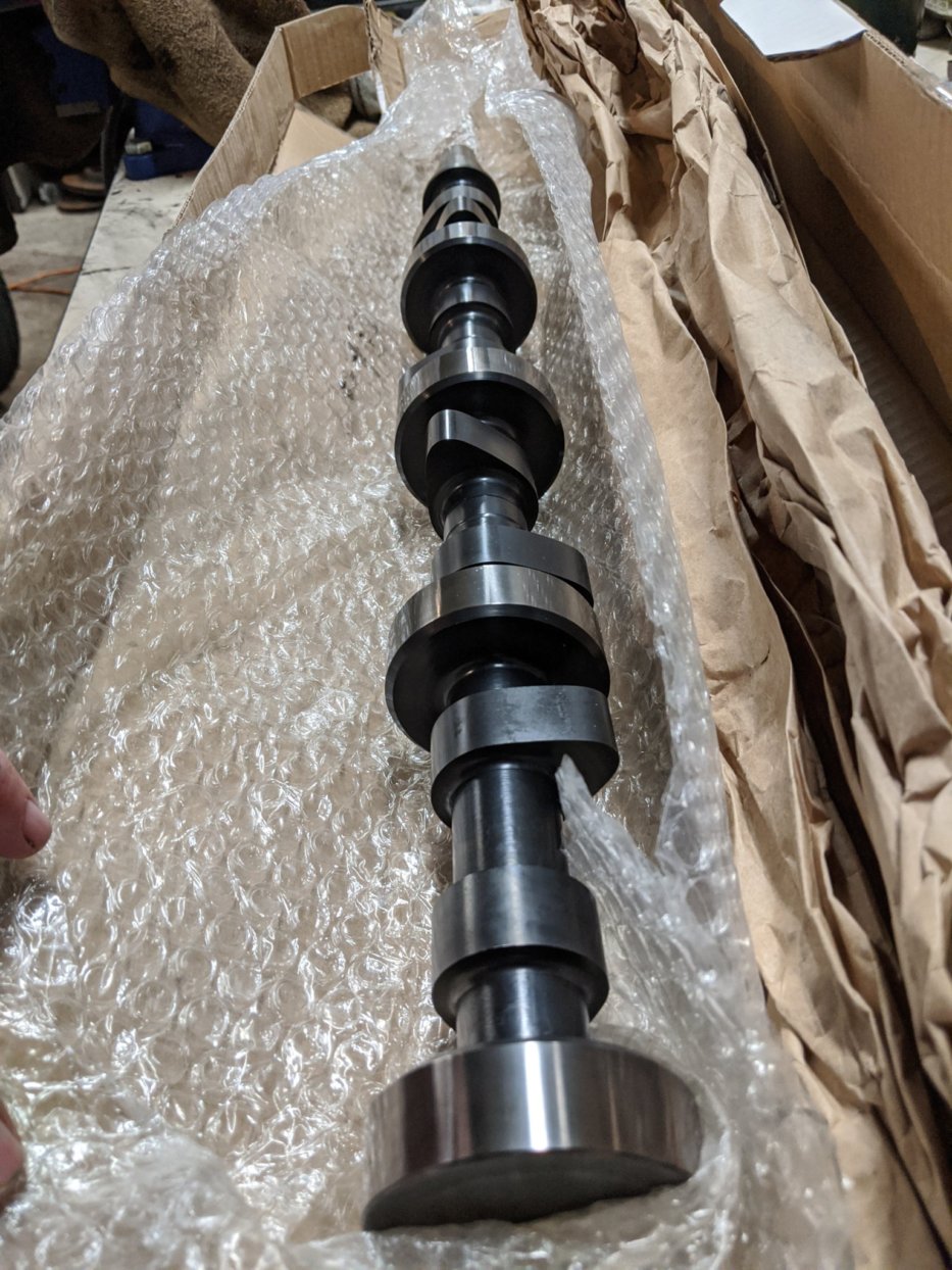

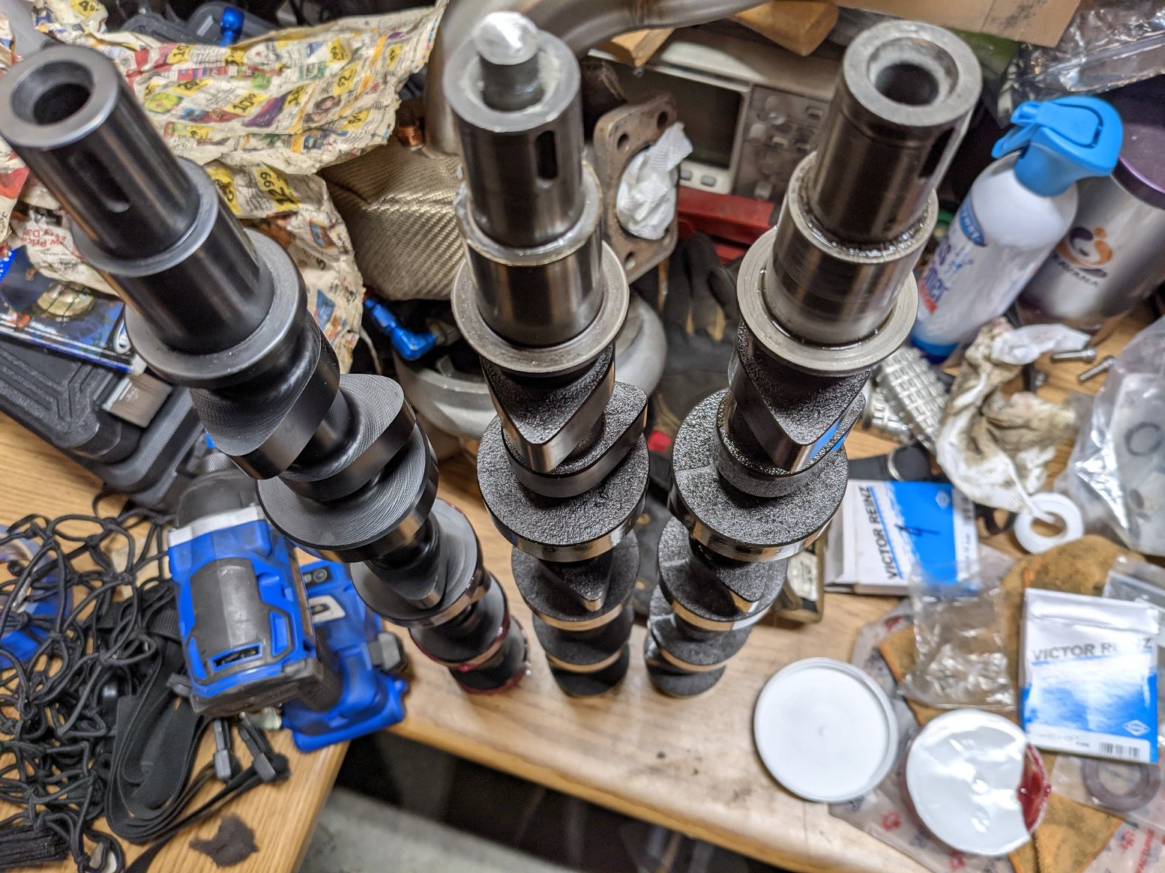

Then I heard RS Barn was closing up shop and selling off their inventory, so I grabbed a stage one cam:
Here's a comparison of the RS Barn cam (left) to a stock turbo (right) and an NA cam (middle) waay more duration than stock

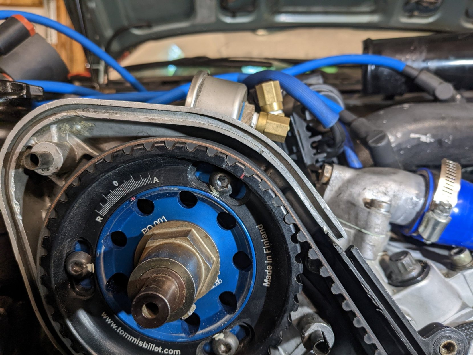

Then came the fun of degreeing in the cam. I got a great deal on this cam gear, but which one of these marks is supposed to be TDC? ¯\_(ツ)_/¯
I finally got it degreed in, but it took quite a bit of advance to get it right.

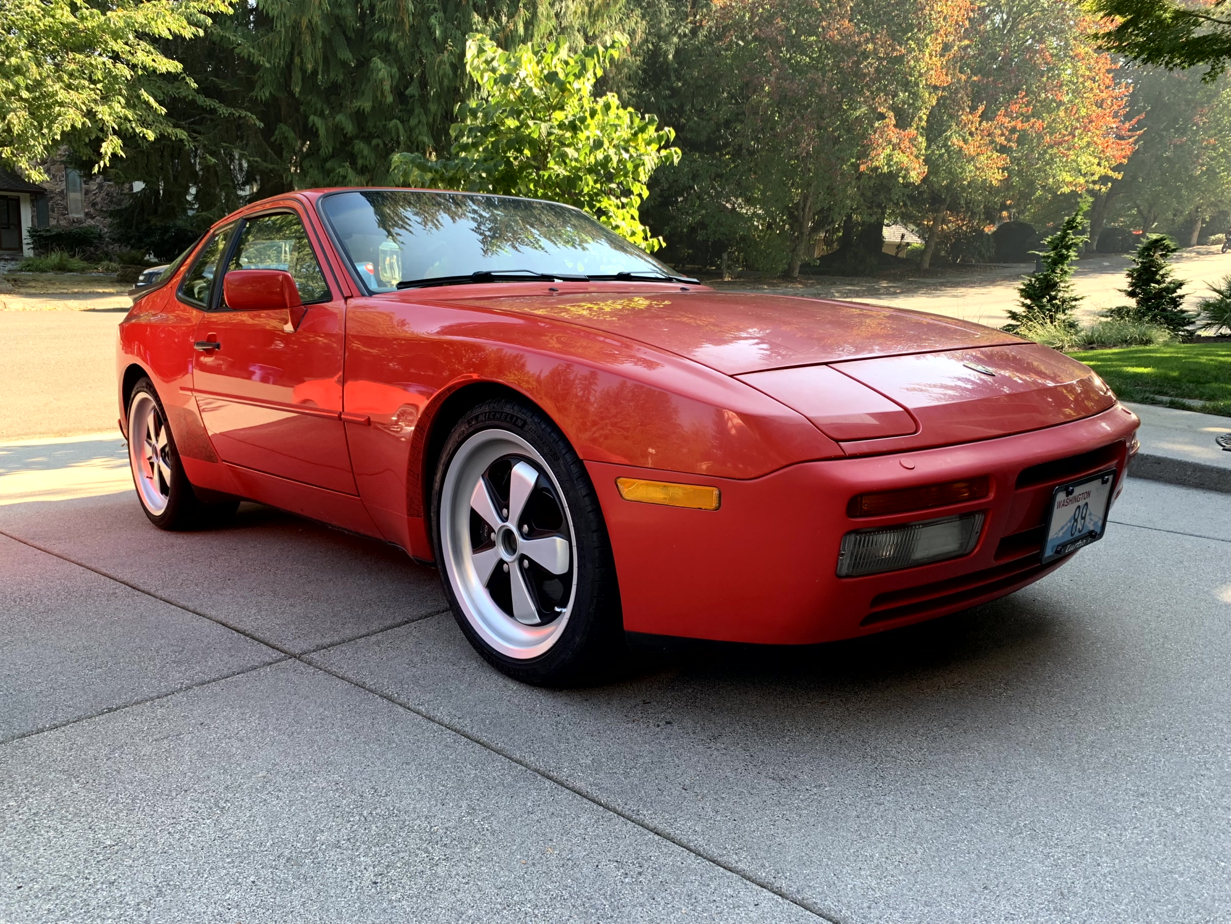

Change to 17 or 18" Fuchs if you like the design. I recently got a set of 18s for my 951; here's a quickie pic I took the day I got it back from the shop. Center caps will be 964 RS type, PCG-361-032-02, which are all metal with black Porsche crest. I decided on these as the silver paint is a better match to the Fuchs than the colored crest versions I also have.

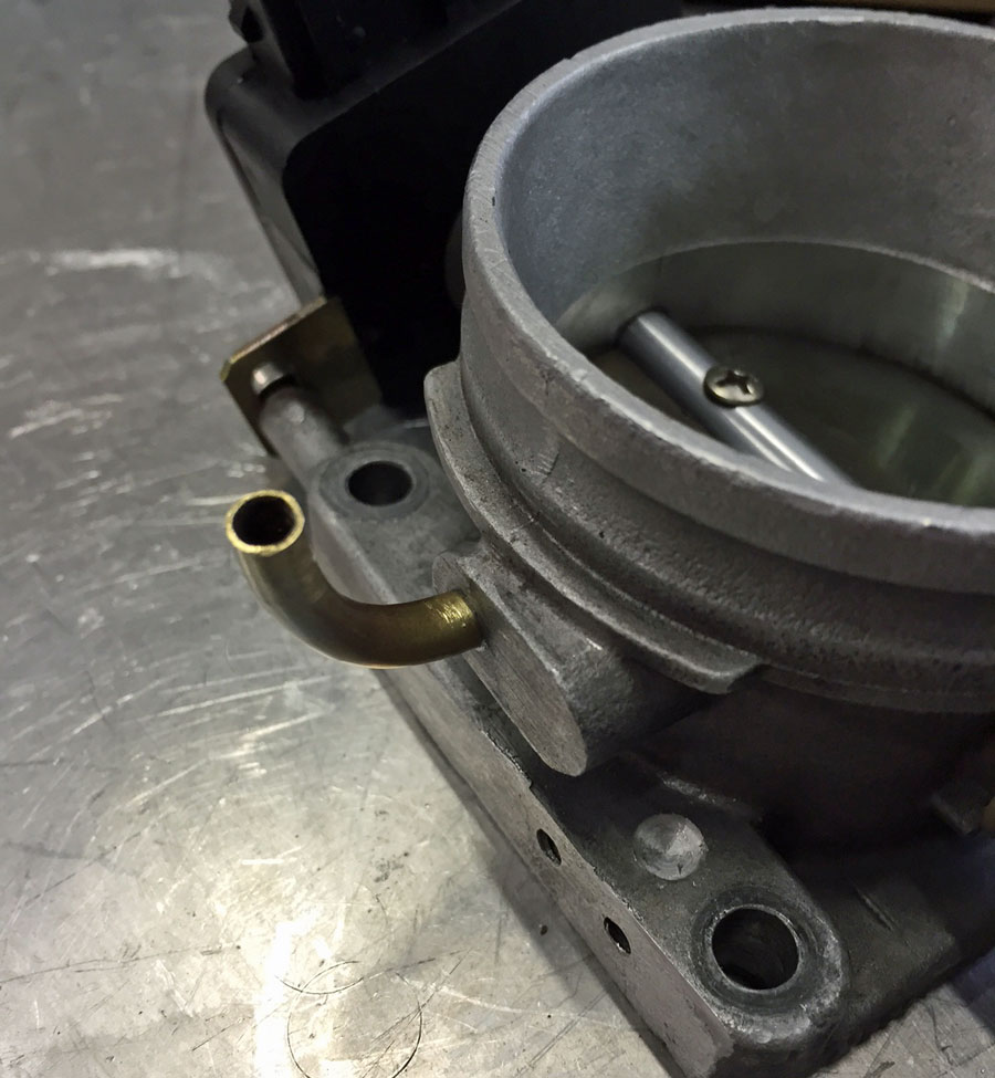

I discovered that 5mm brass tubing can be heated and bent to make that a low-profile evap fitting under the throttle body.

Tom wrote: Thu Nov 10, 2022 6:20 pm I discovered that 5mm brass tubing can be heated and bent to make that a low-profile evap fitting under the throttle body.
This is a great idea! In retrospect, I have actually deleted the evap system, so I should probably just tap the hole for a 5mm grub screw or something similar to plug the hole. Maybe I'll do that next time I have access to the underside..

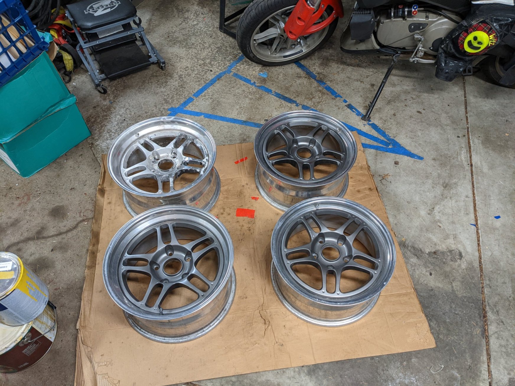

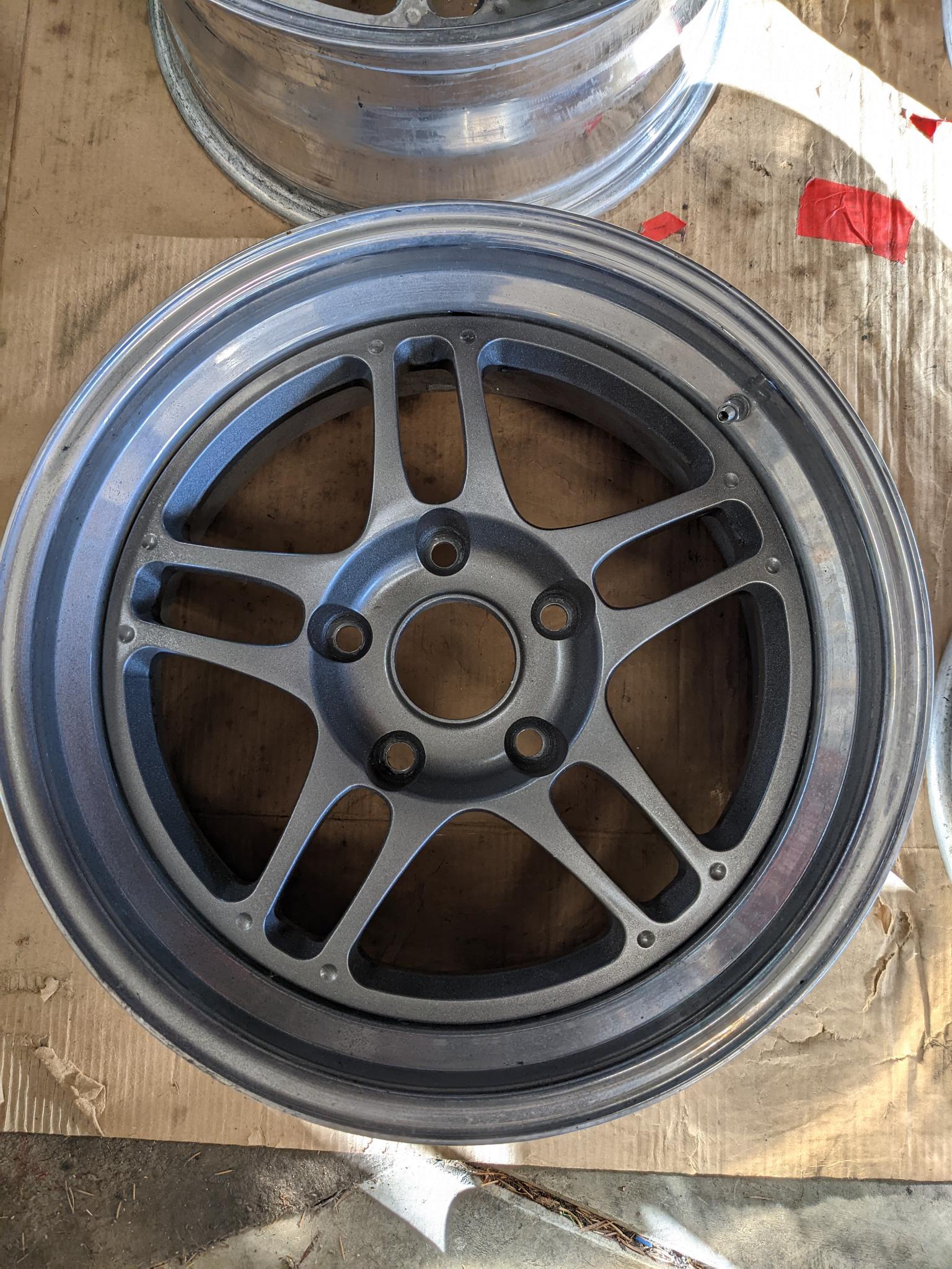

Picked up a new (to me) set of wheels over the weekend. They need to be refinished, (one is already mostly stripped) but that just means I can have any color I want :D
All color ideas welcome :)
