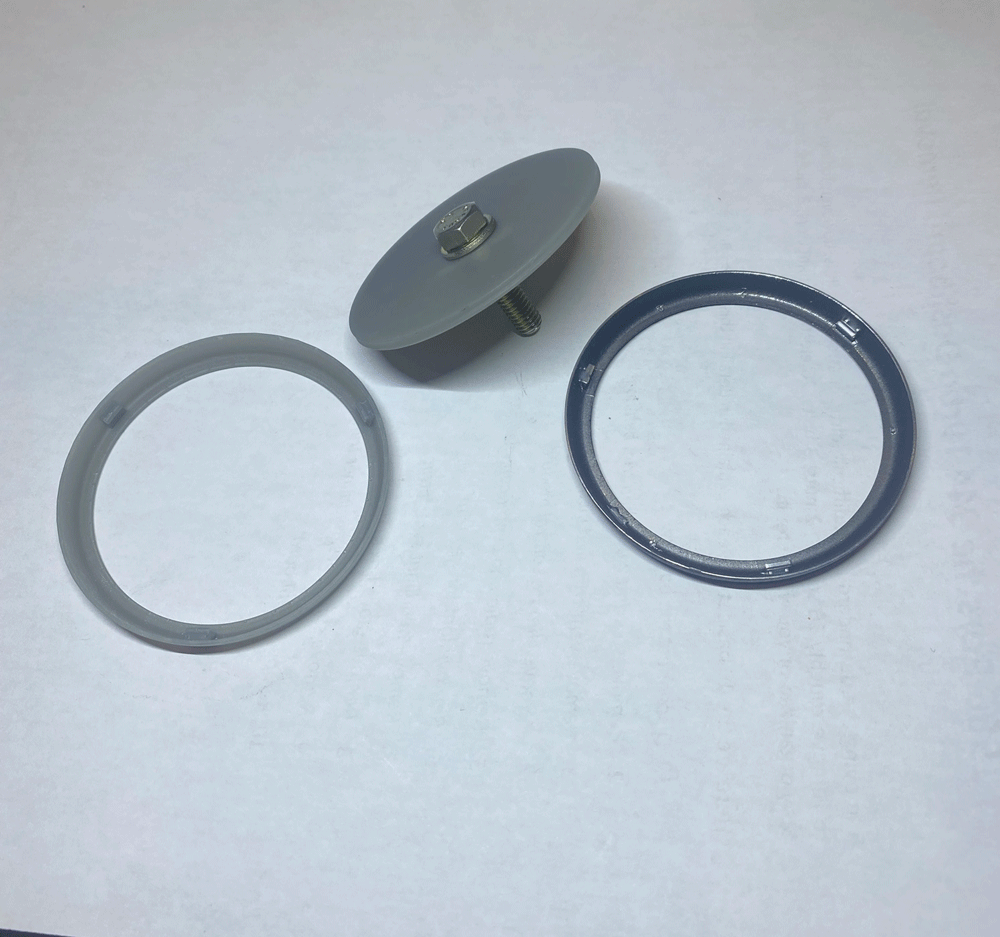

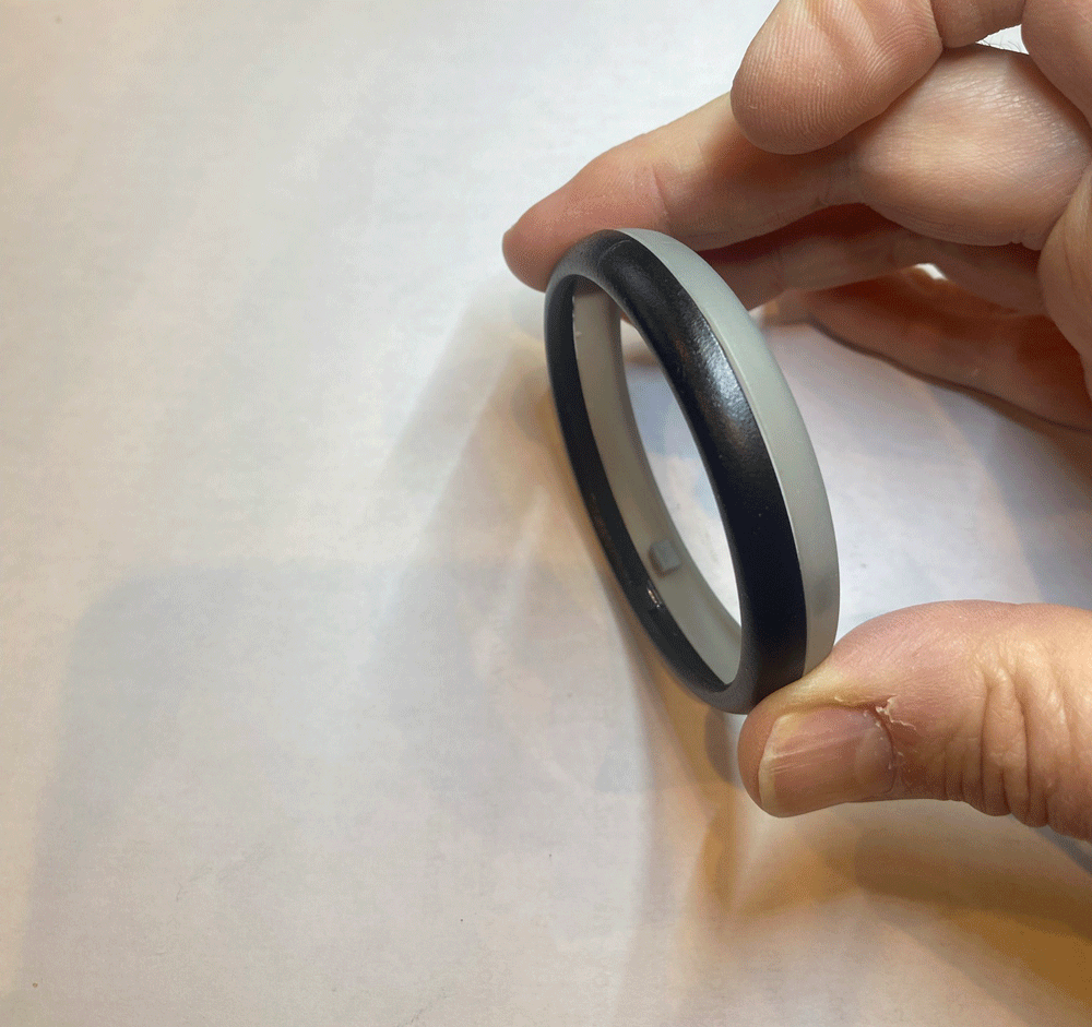

Hi Guys, a lot of good stuff got buried in those super long threads when we were developing all the bezels. But to respond to BrewKaiser's questions....
1. I believe Bob is correct about the bezel not being available separately. However, he might recall that we successfully replicated the stock bezel in plastic. I just never pushed the plastic replica because most people willing to remove the factory bezel are also willing to paint it. But for someone who wants to preserve the factory bezel as delivered and still have a painted bezel, the plastic version is a good solution. The plastic clips in the replica are weaker than the original pot metal version, so won't hold up if you repeatedly install and remove it, but if you just paint, install it, and forget it, it should look identical to a painted original. I just hope I can find the CAD (.stl) model. :shifty: See pictures below.

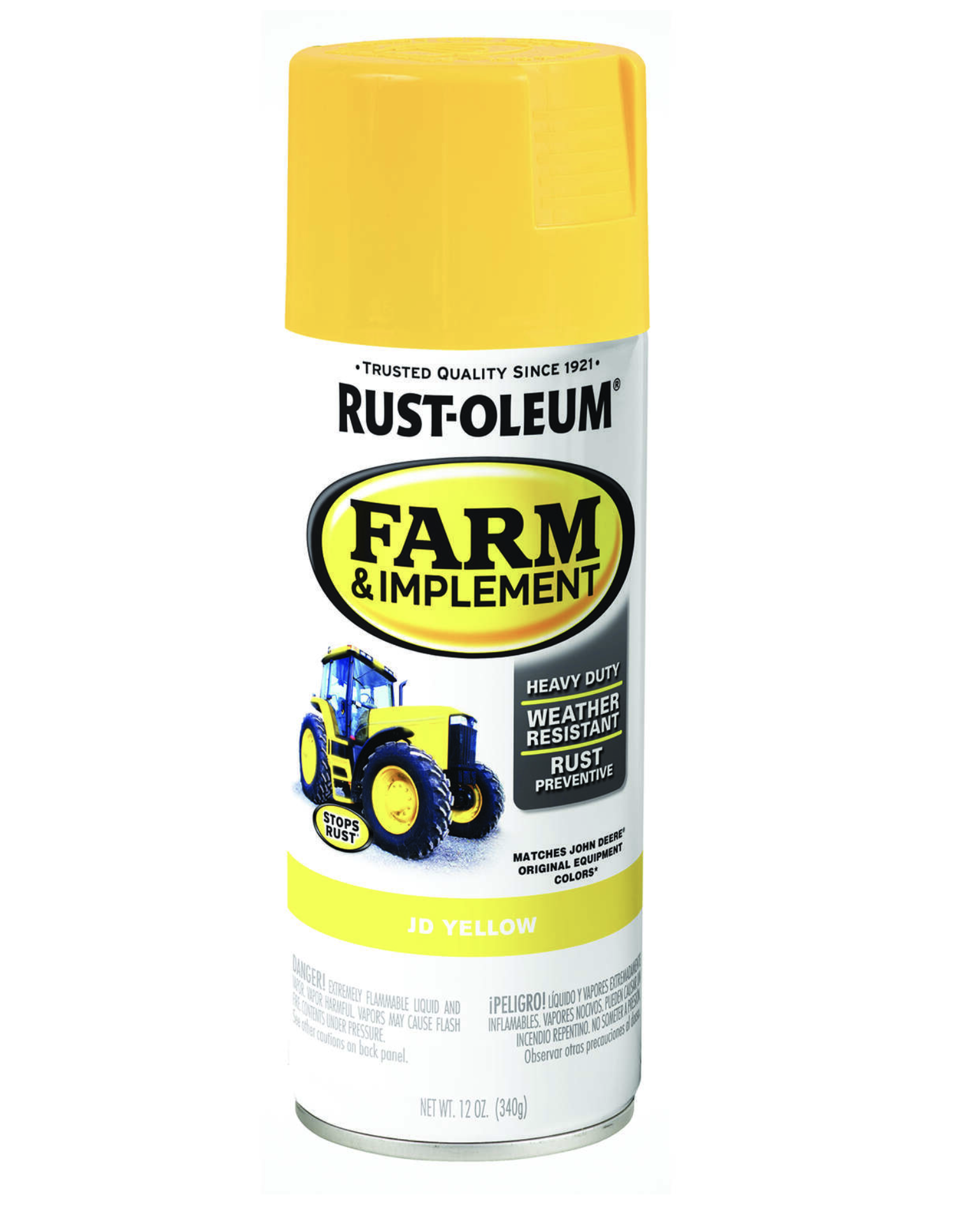

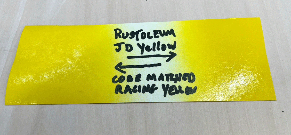

2. Rustoleum makes a "Farm and Implement" paint called JD Yellow, which is a virtual match for Racing Yellow. It's extremely close -- probably as close as custom paint you would get based on the code. It's harder to work with than Rustoleum's "Gloss Protective Enamel" series, so I tend to use that in "Sunburst Yellow" for yellow bezels. Sunburst Yellow is close enough for knobs and bezels in my opinion, but JD Yellow is virtually identical if that's what you are after. Color dial faces are not really a good match for the color they claim to be, so the bezels don't need to be either to look 'right'. The only exception in my opinion is where the car has the interior trim painted in the exterior color. If you have Racing Yellow dash trim, it is best to match it as closely as you can so the difference isn't noticeable....
