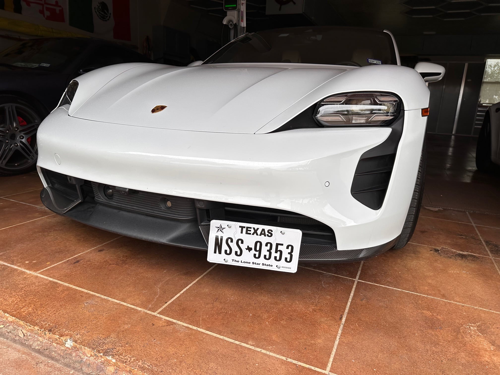

After getting pulled over and stopped, the Officer told me the reason was because I didn't have a front license plate. (Yes I know this is required in Texas, but who wants to ruin the looks of the front end?) The Officer even admitted putting the front plate on would diminish the look of the car.
I opted for the Stonsho bracket - it works great and the license plate is removable if necessary. No drilling involved - a great idea.

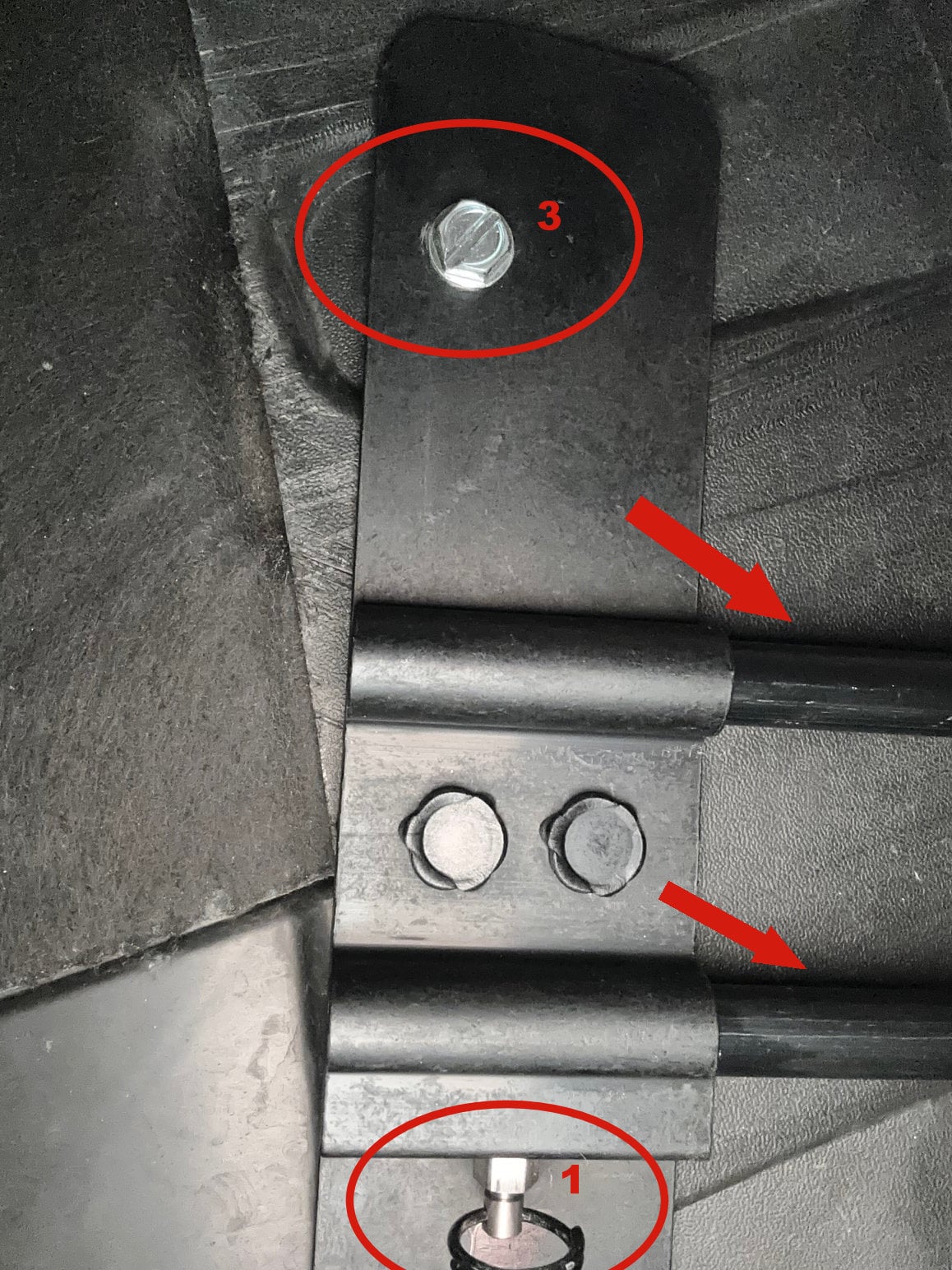

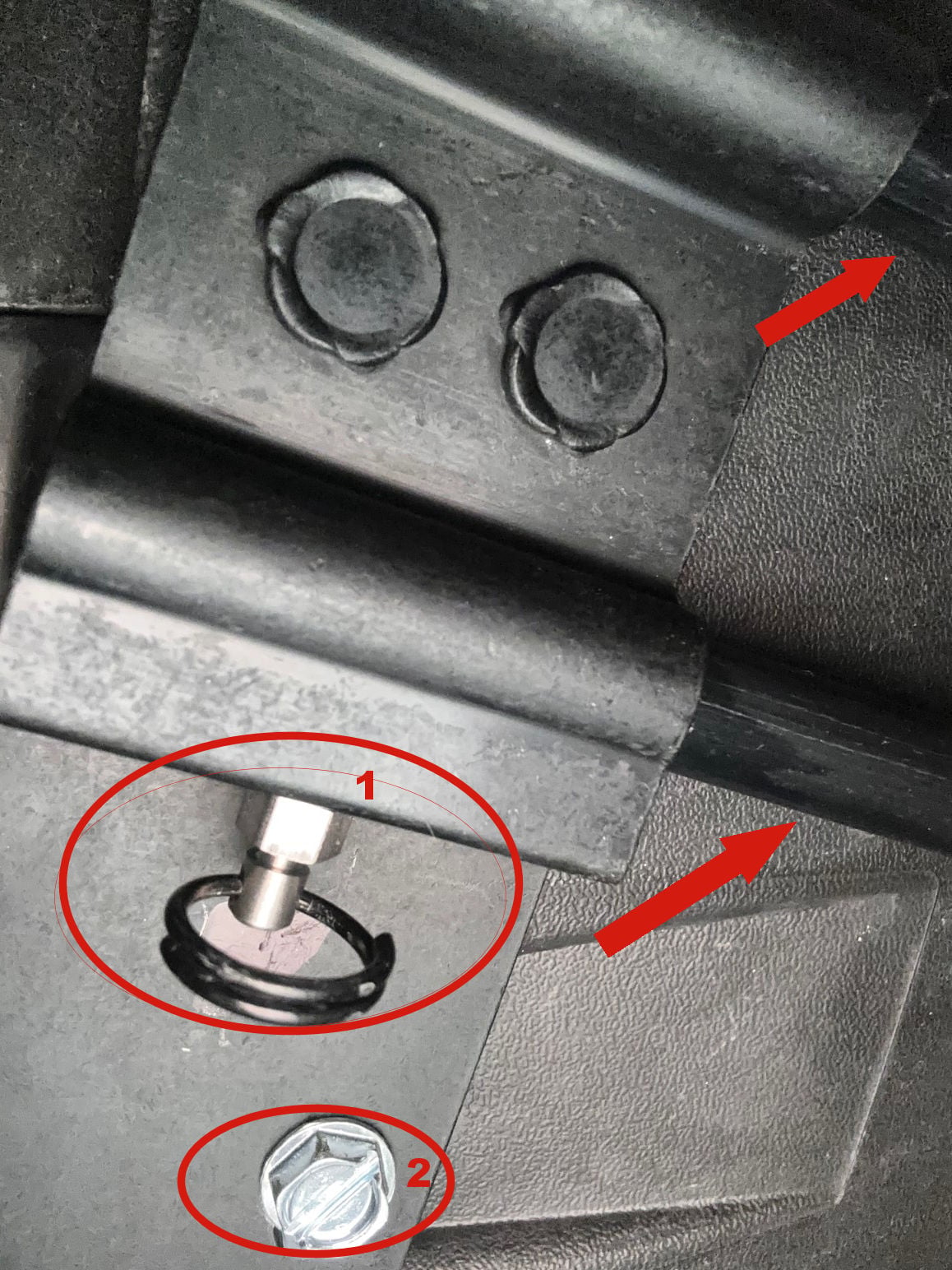

Here are two pictures from under the front spoiler.
The second picture shows items 1 and 2 noted. Item 1 is a spring loaded pin which can be used to disconnect (pull-out) the license plate bracket. Item 2 is one of the two bolts that holds the base plate to the car. The two bolts replaced two screws that were already there. The red arrows point to the horizontal legs of the license plate frame.
The first picture shows almost the entire base plate. Item 3 is the second bolt (replacing a pre-existing screw). Again the red arrows point to the horizontal legs of the license plate frame.
I hope this helps.
I hope this helps.

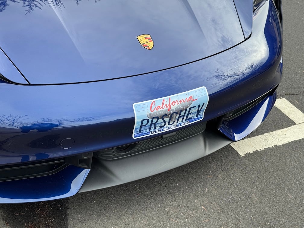

This concept looks interesting for my 2014 Cayman front. Is there any chance it's actually legal? Is it made of car-wrap stuff, maybe? Removable? Know of a supplier?

Hah! Found it ... maybe ...
From San Jose Mercury News --
Wrap plate
What it is: A flexible vinyl stick-on plate that doesn’t require mounting hardware. It’s available in eight of the plate designs offered by the Department of Motor Vehicles.
Who sells them: A Huntington Beach company called License Plate Wrap. Each costs $94, including tax and shipping. [Update: $131.60, as of June 2023.] The company coordinates with the DMV, and there’s a surcharge for registration.
Notes: They are intended for use as the front plate, so owners of cars without front plate holders don’t have to put holes in their bumpers.
