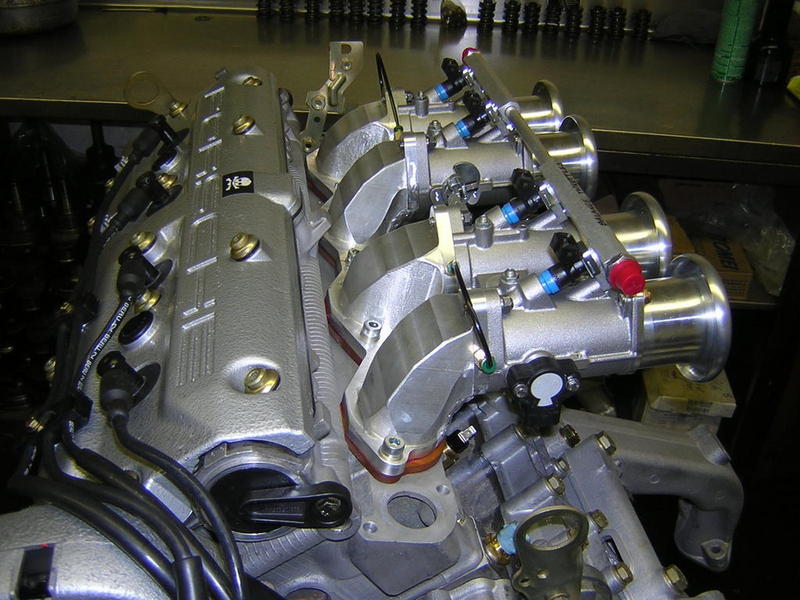

Here's an image of the finished piece from long ago. Not sure if I've posted this before.
Gasket is at the shop
Changes being made to drawing
Then 3d print updated version for verification
Pic is original scan
New printed piece will be like gasket
