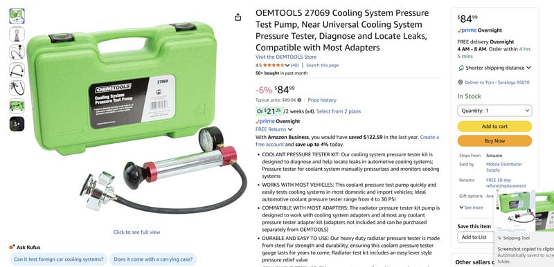

How do you recommend pressure testing the system, I've never had reason to do it. I don't have a compressor.
Posts: 9210
Has thanked: 962 times
Been thanked: 4161 times
blade7 wrote: Sun Jul 05, 2026 1:34 pm How do you recommend pressure testing the system, I've never had reason to do it. I don't have a compressor.
No compressor needed -- you pump it up using a cooling system pressure tester like the one shown below. I pump it to just under cap pressure and make sure it holds that pressure for at least 10 minutes, watching closely for any drips. If you do get drips, it's just a matter of tracking down exactly where they're coming from -- a task that is much easier with pressure on the system to ensure it just keeps dripping until you find it....

Thanks, I'll have a search for one locally :thumbup: .
