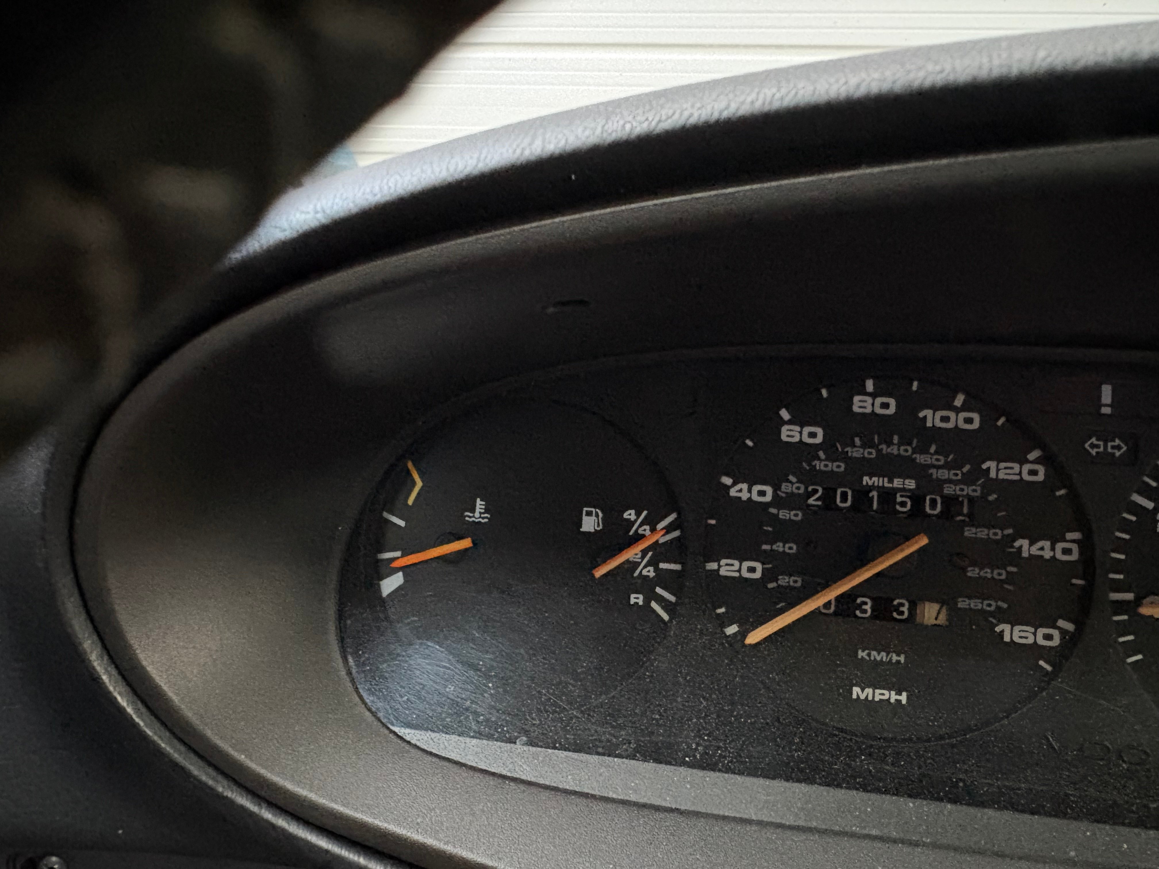

I guess I could try the grease fitting/clear tube method of bleeding the system but I’m just not convinced that will do anything. @Tom I know you mentioned to pull the thermostat and run it but shouldn’t having a lower rated thermostat that I know fully opens before 79c be a good test? Attached is a pic of where my gauge sits now which looks great but the fans just run and run and run! I’m very stumped. Wondering if the thermostat is actually too low? I thought the 85C thermofan switch would be a better fit but apparently not.

I have been following. Not sure this will be helpful but a data point regarding fan operation and temp gauge performance. Here is a picture of my gauge after 15 minutes of doing 2nd and 3rd gear WOT runs. The fans operate normally. Standard thermostat, new Porsche water pump.
