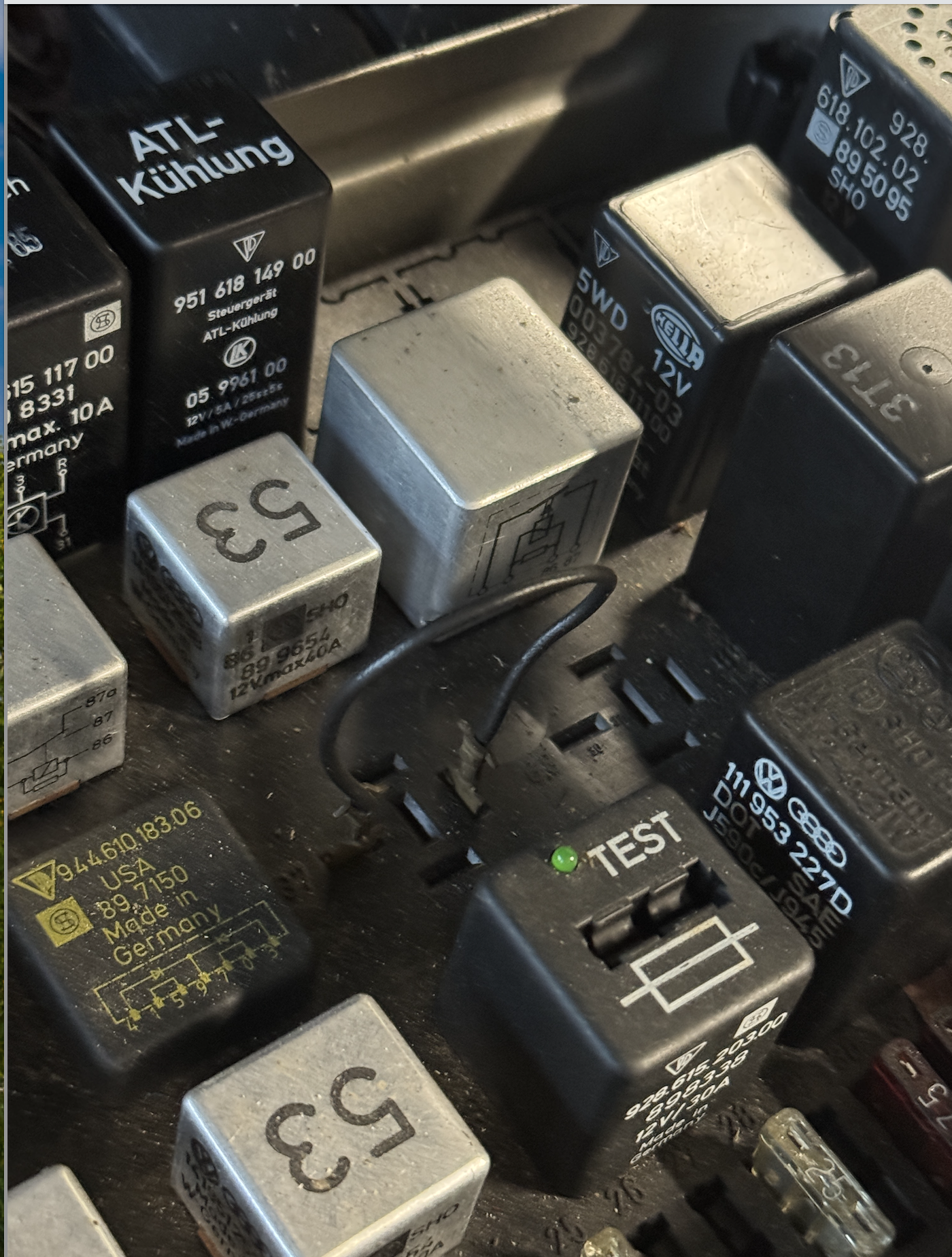

Well mystery solved.... Is there anything special about the power window relay or is it just a standard relay?
Screenshot 2026-06-24 at 11.51.32 AM.png (4.16 MiB) Viewed 6 times

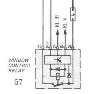

Richey ,
When a relay has the transistor symbol in it, it means that there is some control logic built into it. So no its not just a general purpose relay.
window control relay.jpg (24.2 KiB) Viewed 1 time
