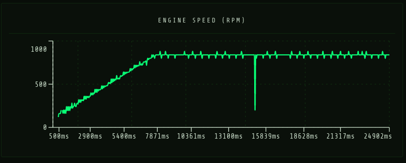

My simulations don't show any extra tach pulses at idle.
I do see some idle variations with engine warm for cases where tps has failed, coolant temp fail, air temp fail, afm open circuit, high altitude enabled.
They all kind of look like the 2nd picture.
The 1st pciture is a case where o2 is stuck lean and the simulation shows rpm going to 0 at about 13 seconds after start (see 2nd pic)
Does this happen at cold or warmed or all the time? How long is it between the idle slowing?
o2 stuck lean
o2 stuck lean
Screenshot 2026-06-22 at 10.13.55 PM.png (25.04 KiB) Viewed 1 time
tps, coolant, air failures + afm opn, hihg altitude
Screenshot 2026-06-22 at 10.12.41 PM.png (22.25 KiB) Viewed 1 time
