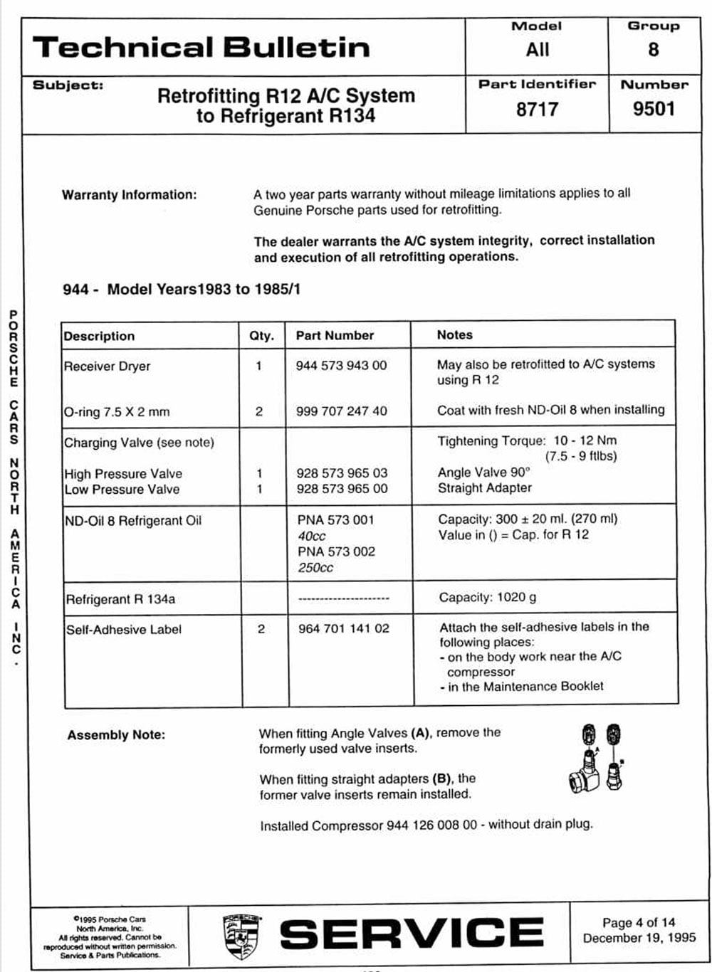

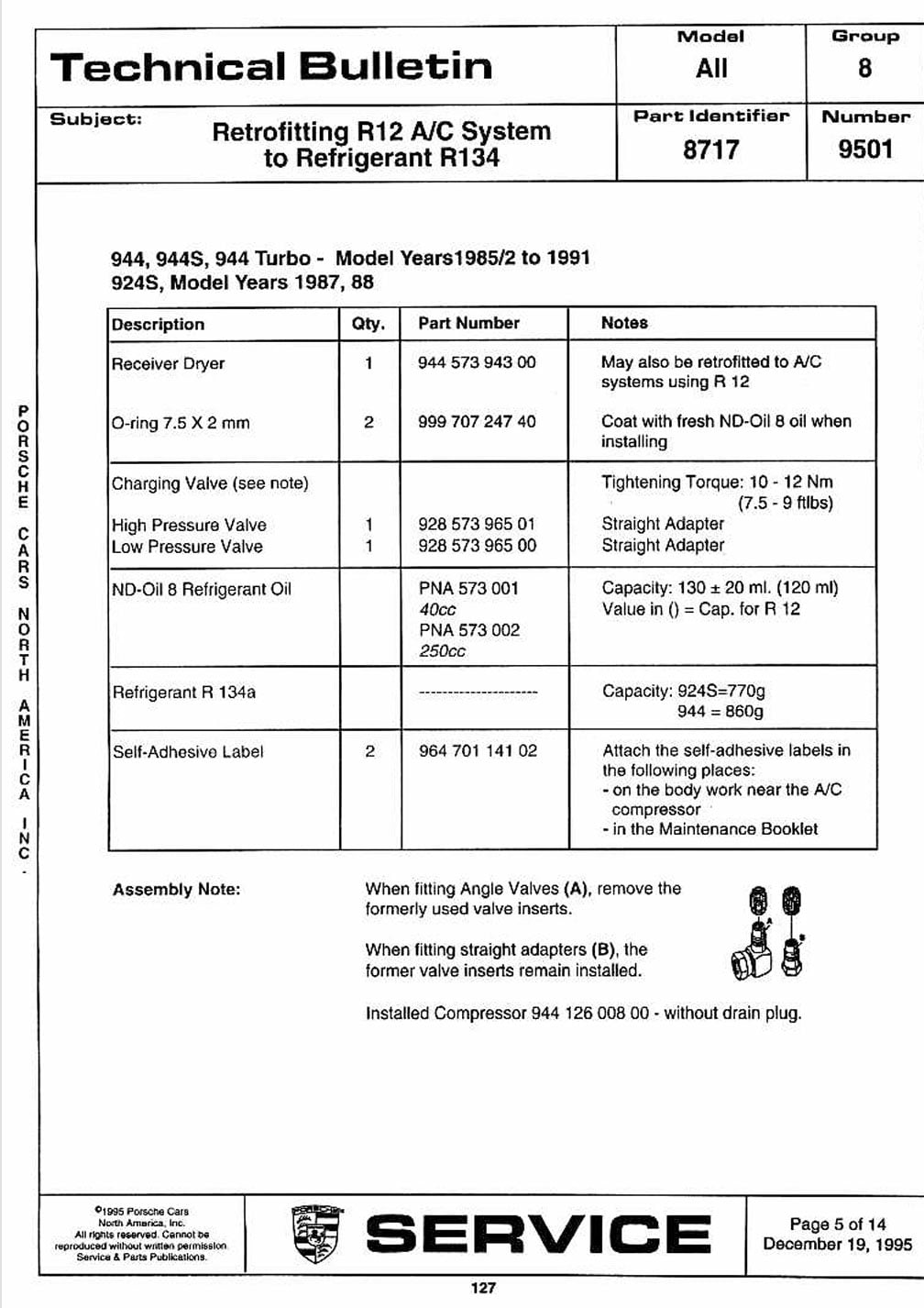

Griffiths told me that, when starting dry and converting to R134a, he uses about 5 to 6 oz. of ester oil total in the 85.5+ cars. The factory literature seems to suggest more like 4 to 5 oz. (PAG) when converting to R134a, but I went with Griffiths’ suggestion as the voice of real-world experience and haven’t had any problems — with vent temps in the 30s to boot. The early 944s apparently take more oil, according to the Porsche TSB excerpts below.
