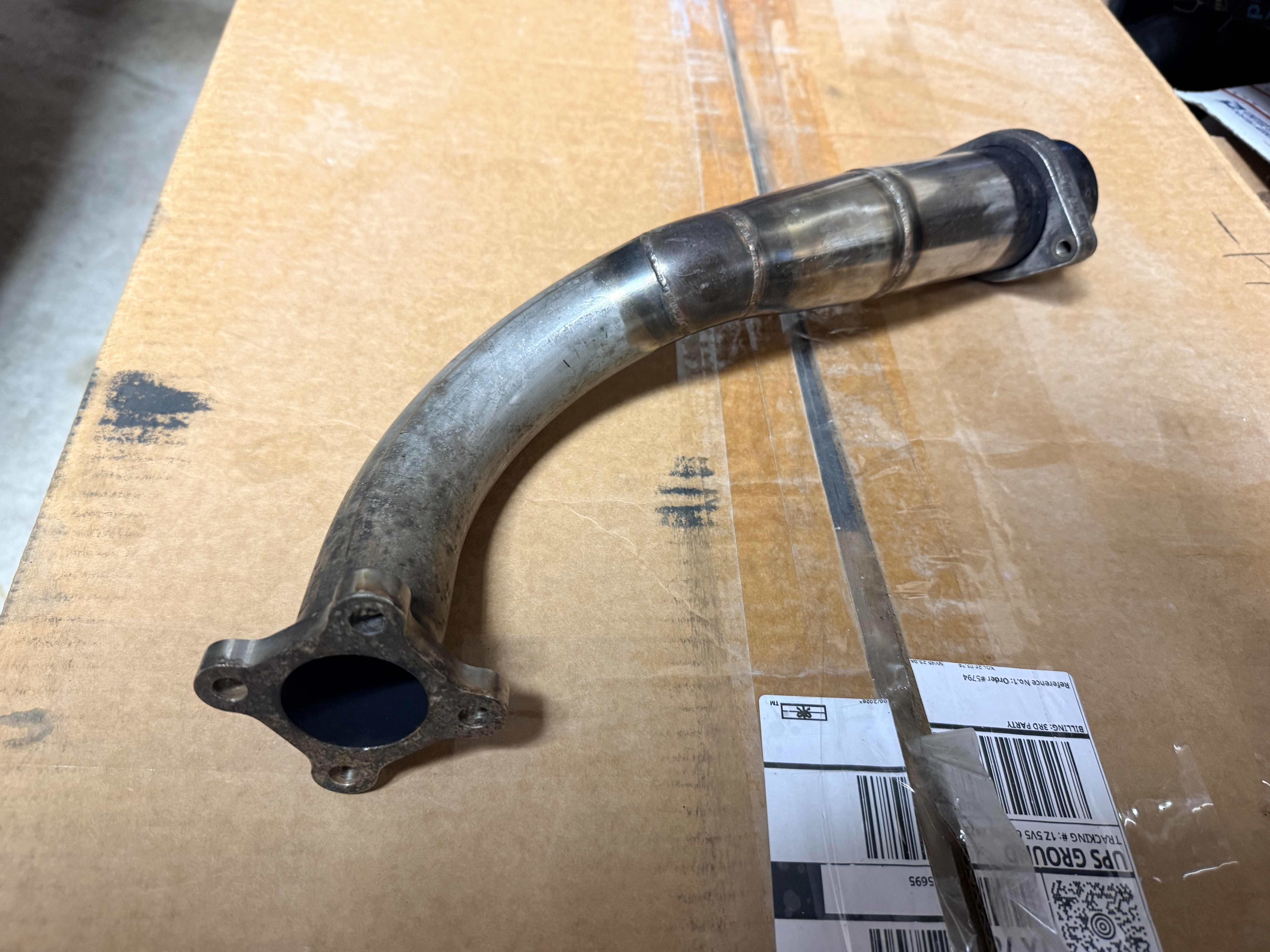

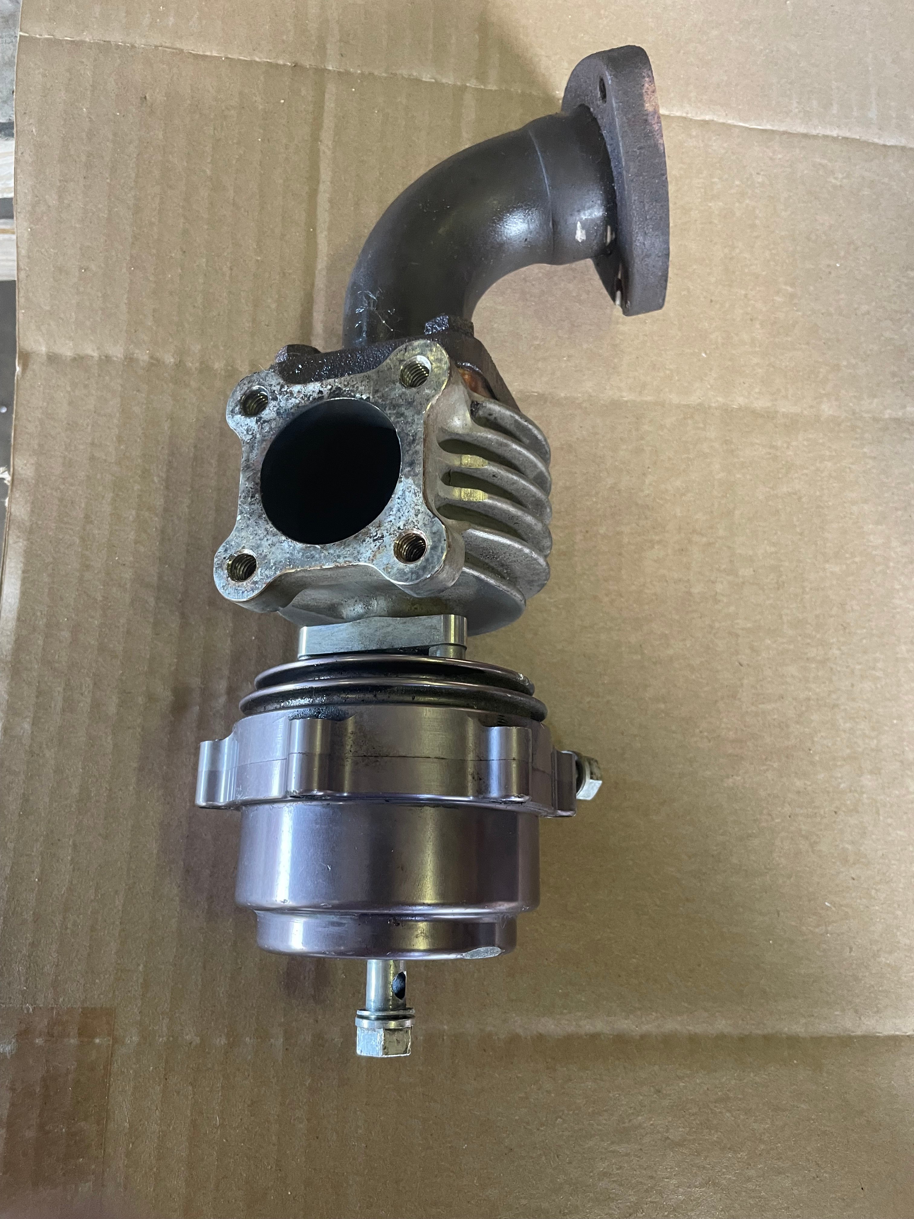

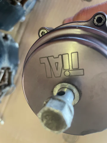

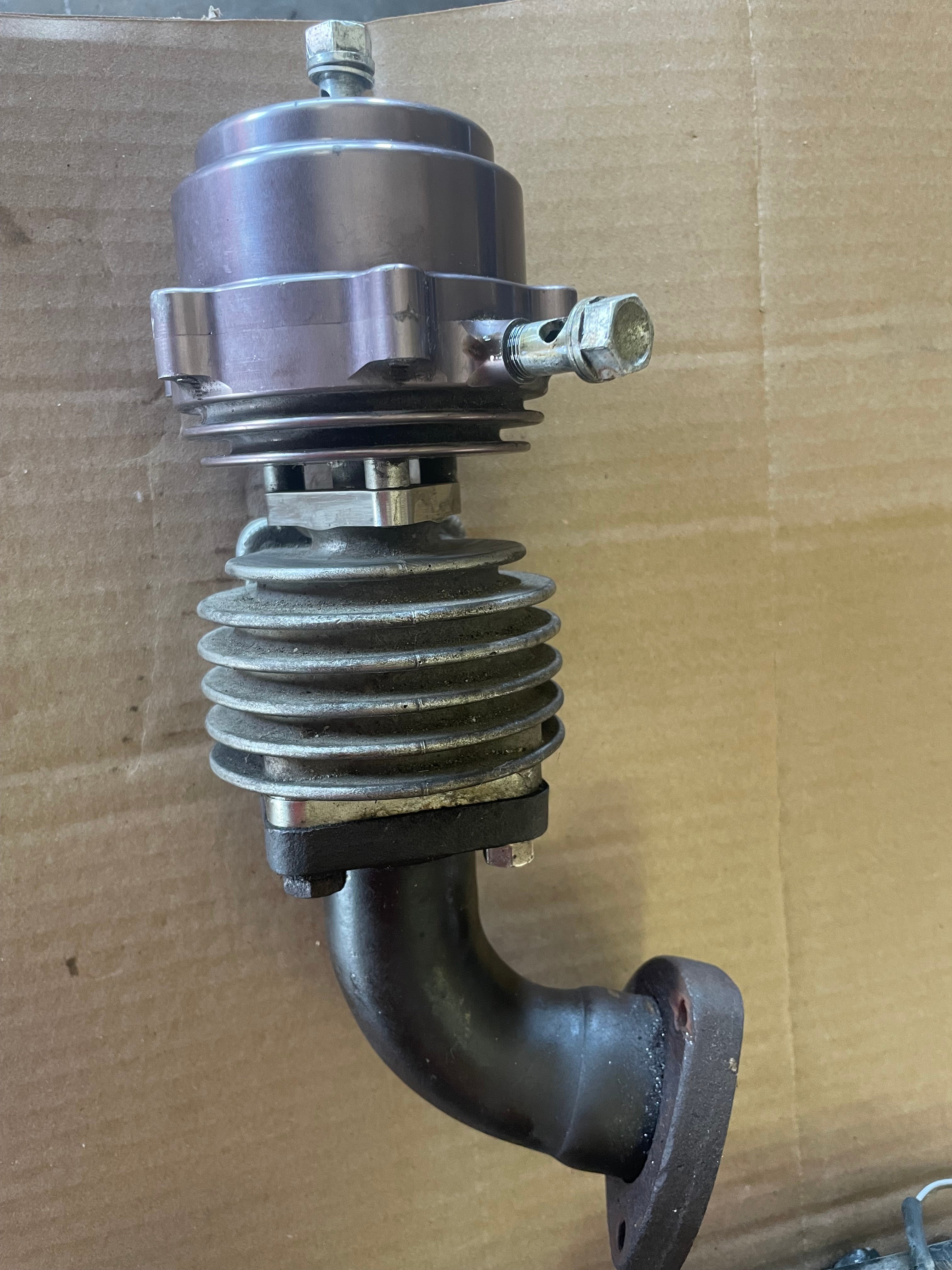

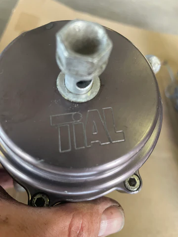

Just an update. I found a great deal on a Billy Boat full exhaust with cat delete and an older TiAl F46 dual port Wastegate. I haven’t installed yet. They were all installed together in the car that they were pulled from- an 88 Turbo. I should be able to bolt right on because it came with a custom TiAl flange to Wastegate dump. Attached some pics.
Quick question about the Wastegate and fitment. Wondering if anyone else runs a F46 and any install recommendations. From what I’ve read and can see, it looks like it is installed backwards from the OEM Wastegate so it will point in a different orientation. Wondering if there will be any clearance issues when installing. There seems to be maybe a heat shield or bracket attached to the torque tube and not sure if there is enough clearance. Seems like a very long item to insert into this space. I have found a couple of pics from old forums but nothing super clear. But it does seem like other have installed these fine so I assuming it will squeeze in.
Just a note. As you will see in the pics, this is a one of the older TiAl’s that does not have a serial number and the “made in USA” stamp. I sent the pics to TiAL and they verified its authenticit. I know that the F46 is a bit of overkill from what I have read but couldn’t pass up the deal..
Anyways, if anyone’s has any first hand accounts of fitment for a f46 for 86 Turbo, pics, pointers etc, I would appreciate it!
