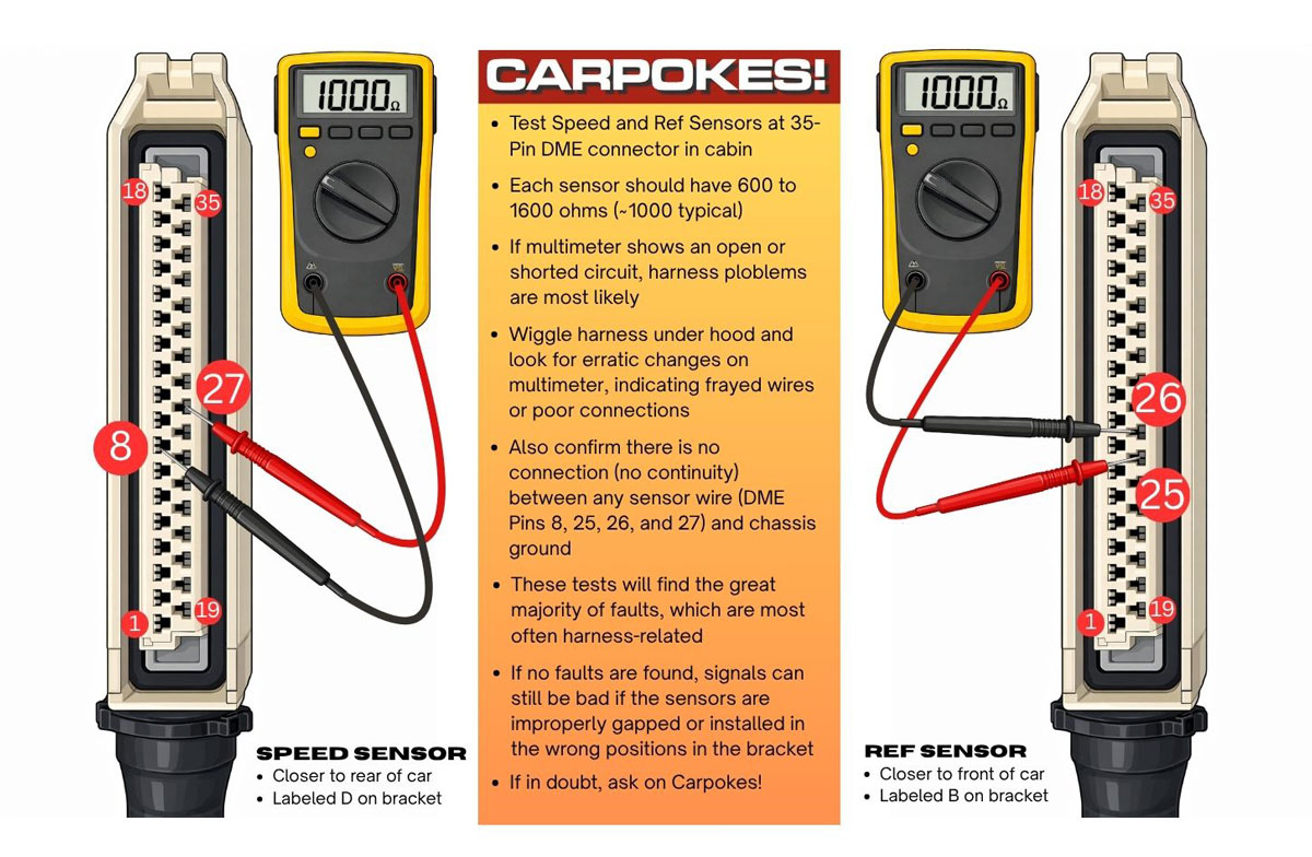

We have a 944 Handbook page on that here:
https://www.carpokes.com/app.php/944-sp ... or-testing
The sensor that connects to pins 25 and 26 in the 35-pin DME connector is the ref sensor -- closer to the front of the car in the B position. Speed sensor is toward the rear in the D position and connects to pins 8 and 27.

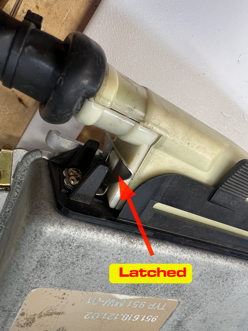

Is it difficult to pull the connector off, or best to remove the DME from under the dash? I was looking at it (as best as I could) and didn’t see if there’s a tab to pull it off, or if you just grab and pull.

There is a metal latch that you pull back to unclip it. See picture from my Kroon Harness install below...

The early DME boxes might look a little different, but pretty sure that latch is essentially the same...

Your tab for removal worked great and my multi meter got my sensors all sorted. Thanks again.
