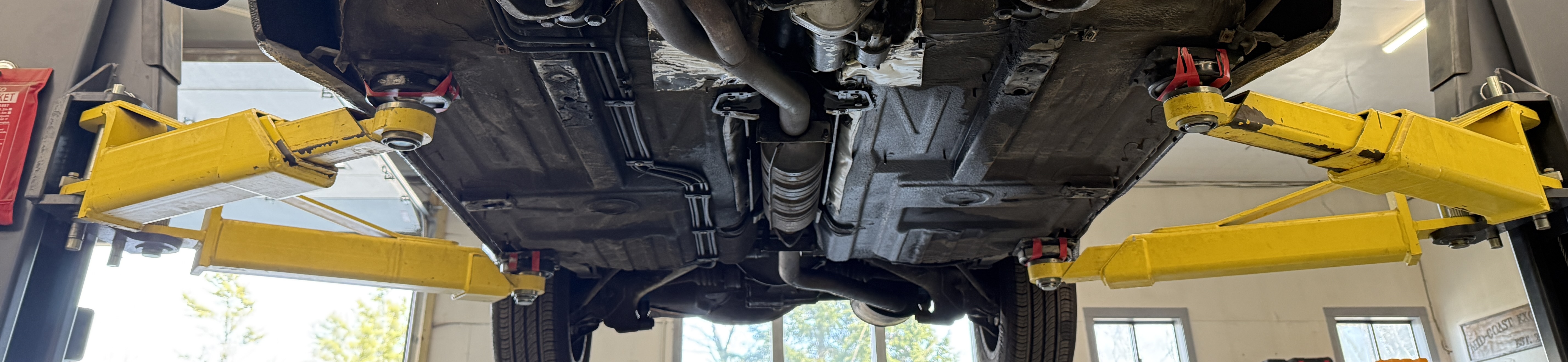

I'll probably get blasted for this one, when using my parents lift, I use the front nubs... Our lift has big rubber pads and it has not damaged the car. I have even left it this way for 24 hours, seems fine.

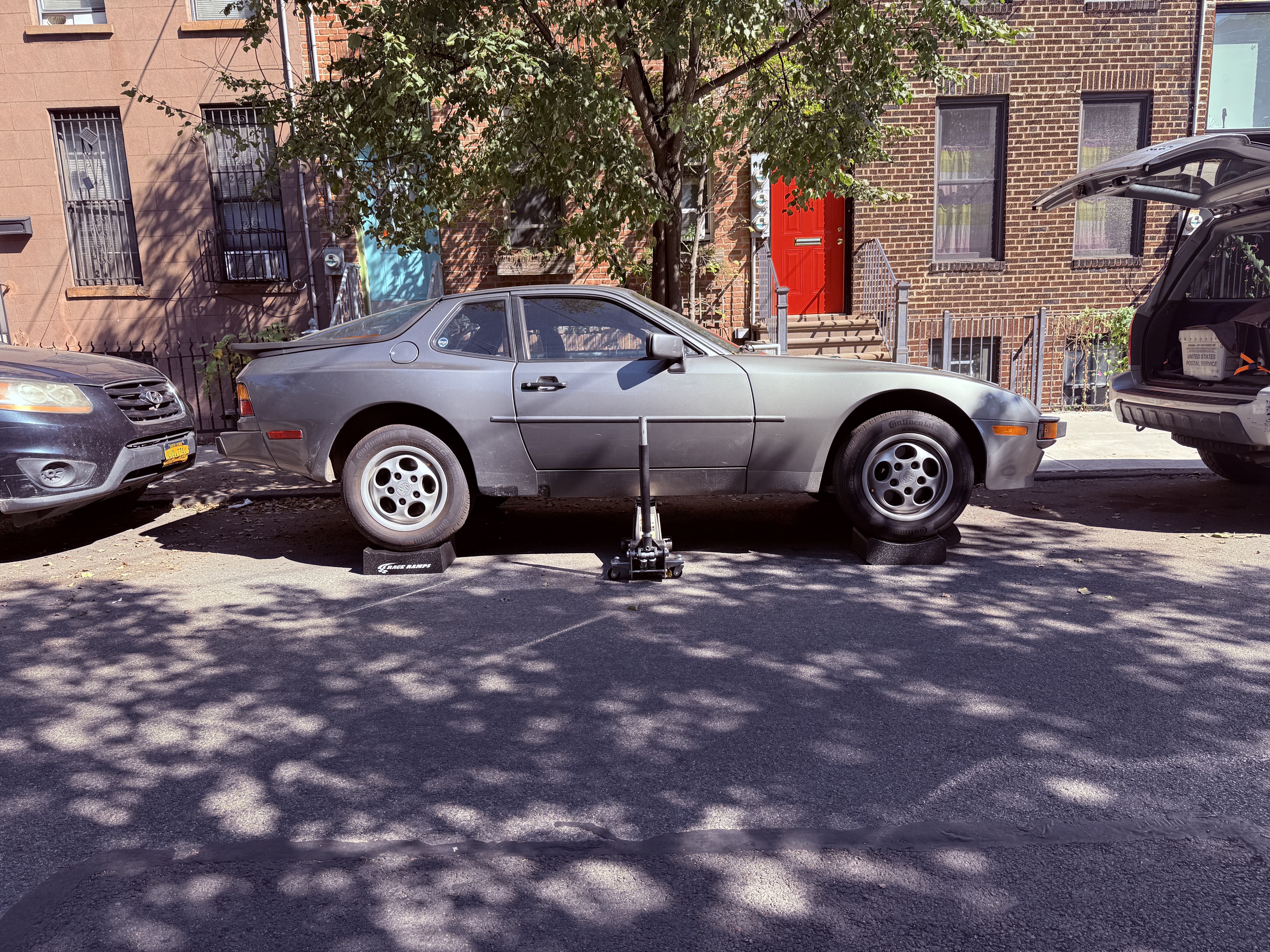

When I do work on the street, I either use my 4" race ramp wheel blocks, or if I need to remove a tire, I'll use jack stands under the frame rail. Race ramps are a little pricy, but I love them for when I dont need to pull a tire.

Not blasting you at all! That's not our vibe here even if we did disagree -- but I genuinely think you're doing it just right. Lifting the car flat and even on your parent's lift (!! who can say that !!) should be just fine. If not, no commercial shop on the planet could work on a 944. :angel:

This is exactly what the shop manuals recommend. The 4 lifting points around the perimeter when using a lift and the single jack point mid span of the rocker panel when using a floor jack. If you use a floor jack at one of the perimeter lifting points, you risk wrinkling/distorting the rocker panel skin.
