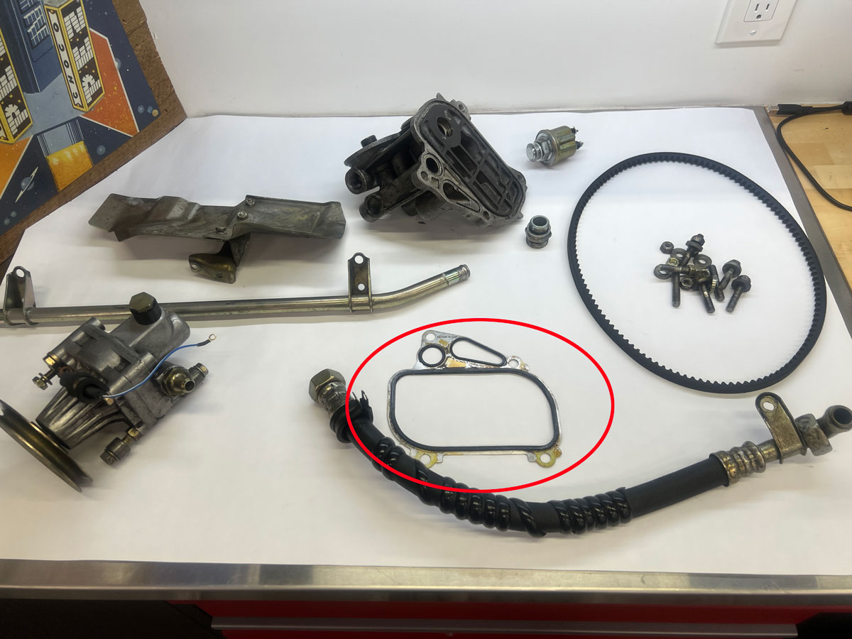

Paper thin plastic o-rings? Not sure what you are referring to? In the early days, the oil filter console used a series of individual seals, but those were long since replaced with one integrated seal like the one circled in red below. If you are using anything other than the one circled in red, ditch it! I just went through this exact same thing -- with an external coolant leak between the console and block. Turned out the grove where the seal goes was quite pitted in my oil console, so I used Curil T (now T2) on the gasket (and oil cooler hose fittings) and it worked like a champ. If yours is leaking externally, I wouldn't hesitate to use Curil T on it. Sure beats doing the job twice...
See more from my recent work here: viewtopic.php?t=4665
And see our Oil Seal replacement instructions in the 944 Handbook -- paying particular attention to the little aluminum tube with o-ring grooves. That part was updated to help prevent mixing.

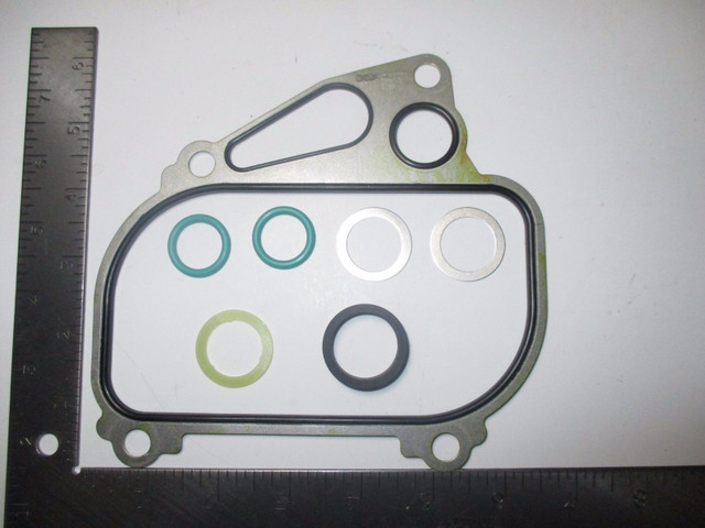

Hi, I'm not talking about the main gasket, it's the 2 metal washers and the plastic 1 in this picture. I want to know how they are fitted when I refit the OPRV? Thanks

blade7 wrote: Sat Mar 21, 2026 5:56 pm gasket.jpg Hi, I'm not talking about the main gasket, it's the 2 metal washers and the plastic 1 in this picture. I want to know how they are fitted when I refit the OPRV? Thanks
Those kits include parts for multiple cars. The plastic spacer and shim is for the N/A cooler housings, so not used on the turbo. Here's an excerpt from our oil seal R&R document, with the list of actual part numbers for the job. Some have been superseded, but they will point you to what you need....
1. Console Housing Gasket: 944 107 147 03
2. Oil Connector Pipe O-rings (2 needed): 999 707 043 40
Note: Seal kit 944 107 165 98 includes items 1 and 2 above, plus unneeded
parts used on other 944 motors.
3. Oil Pressure Relief Valve O-ring:
For original 3-piece valve: no O-ring needed
For retrofit one-piece in a 1986 motor: 944 107 935 11 or 999 707 145 40
For 1987 and later motors: 944 107 935 01 or 999 707 144 40
4. Oil Pressure Relief Valve Seal Washer (all): N 043 815 3
5. Oil Pressure Relief Valve Installation Tool:
For 1986 motors: 9215
For 1987 and later motors: 9262/1
6. Oil Connector Pipe (updated): 951 107 152 03
7. Oil Pressure Relief Valve (if needed):
For 1986 motors: 944 107 035 11
For 1987 and later motors: 944 107 035 01
8. Oil Cooler Hoses: 951 207 113 03 and 951 207 111 03
9. Seal washers for oil line fittings (2 needed): 900 123 011 30
