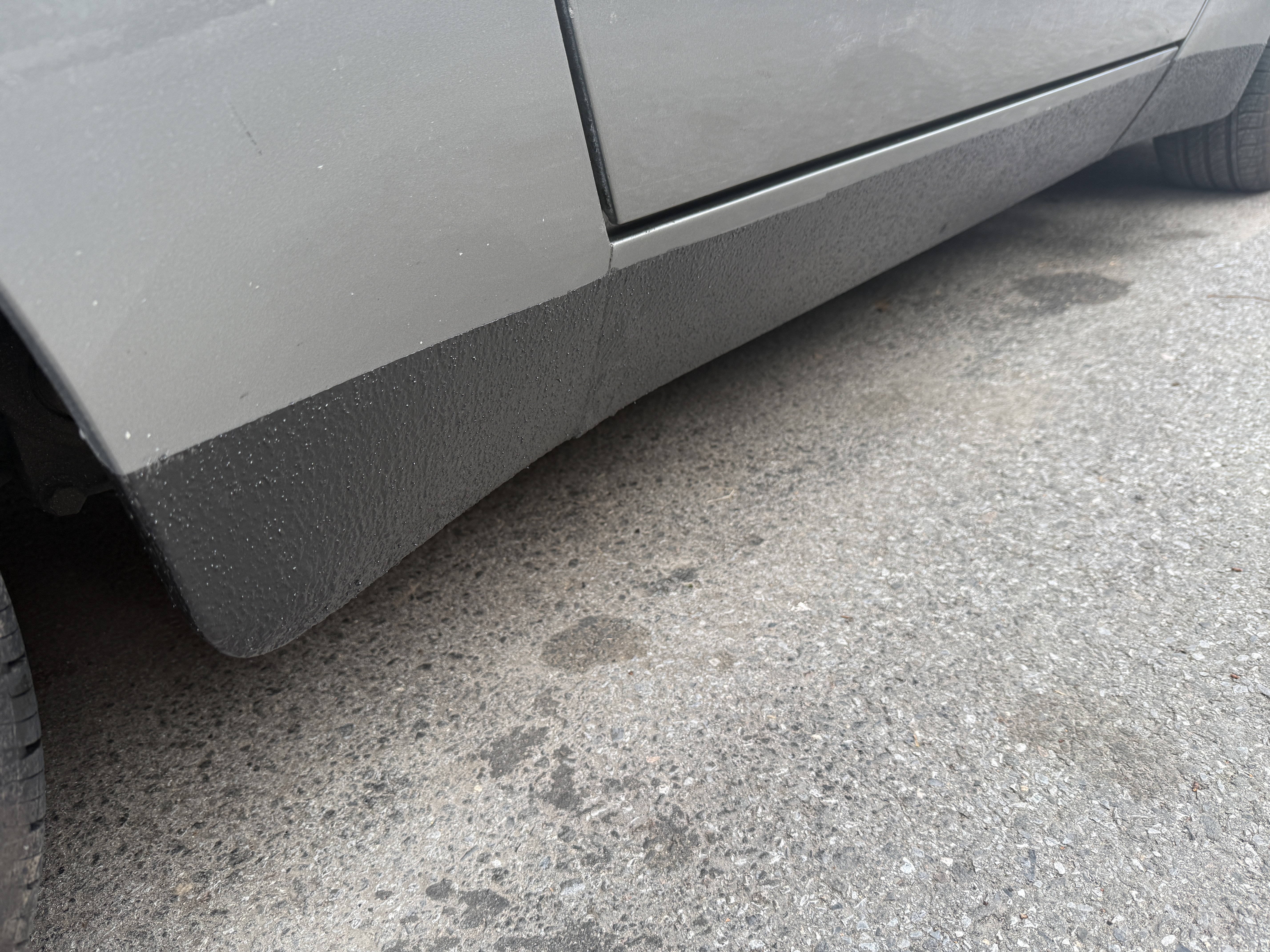

I had some time and warm weather this week, so I rolled bed liner on my rockers and behind the rear wheels. Should help withstand our evil winters and track debris.
