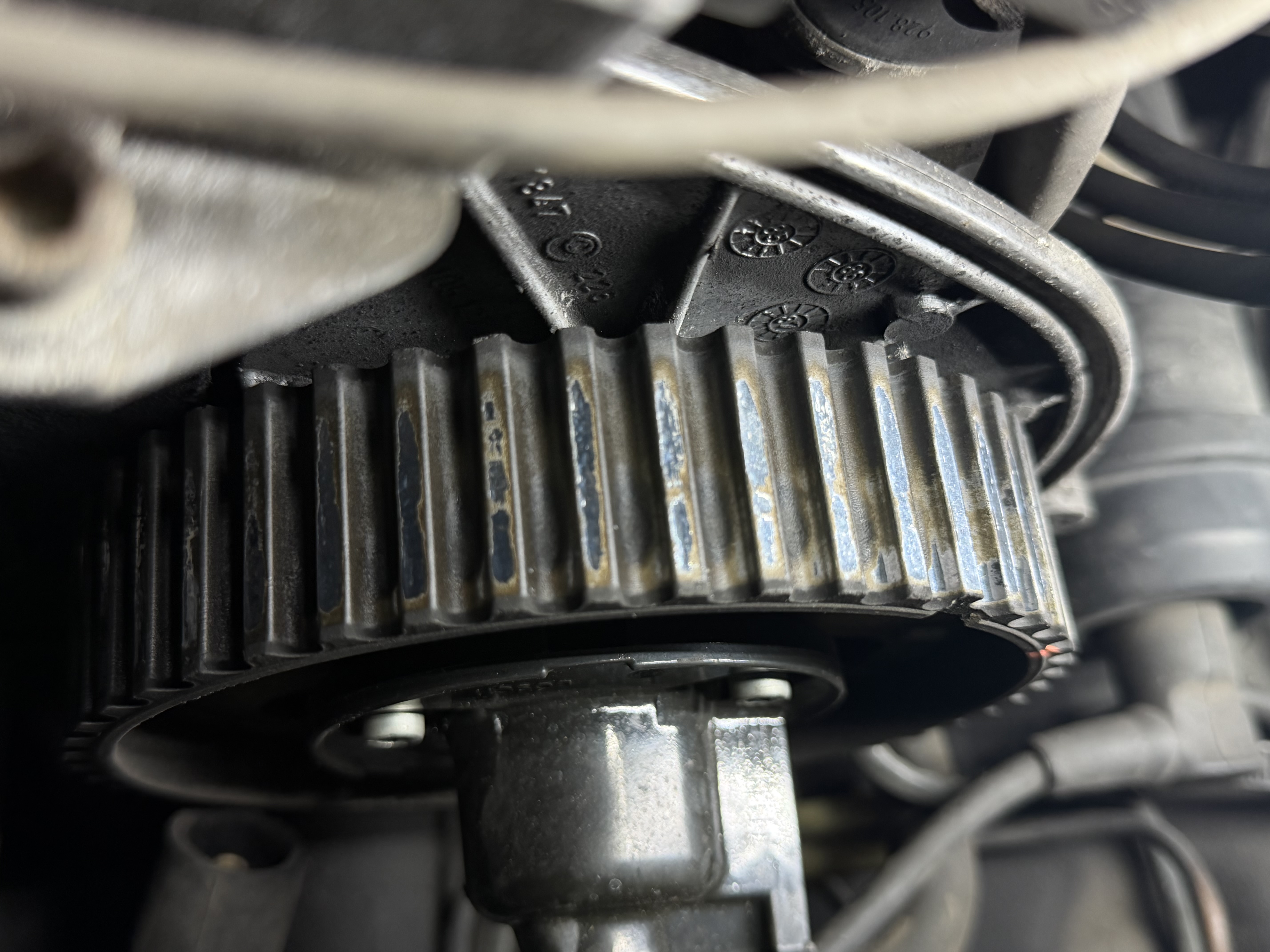

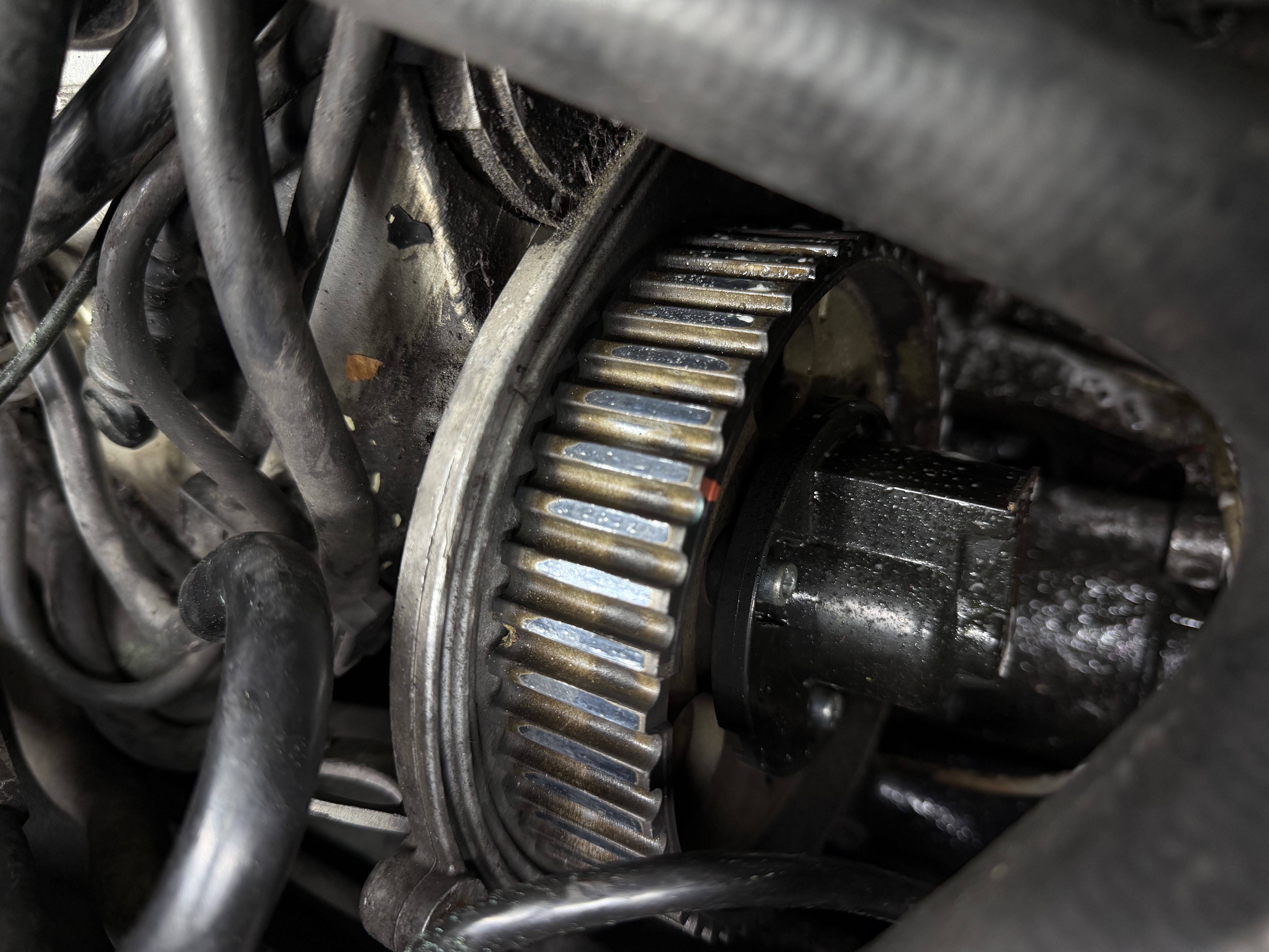

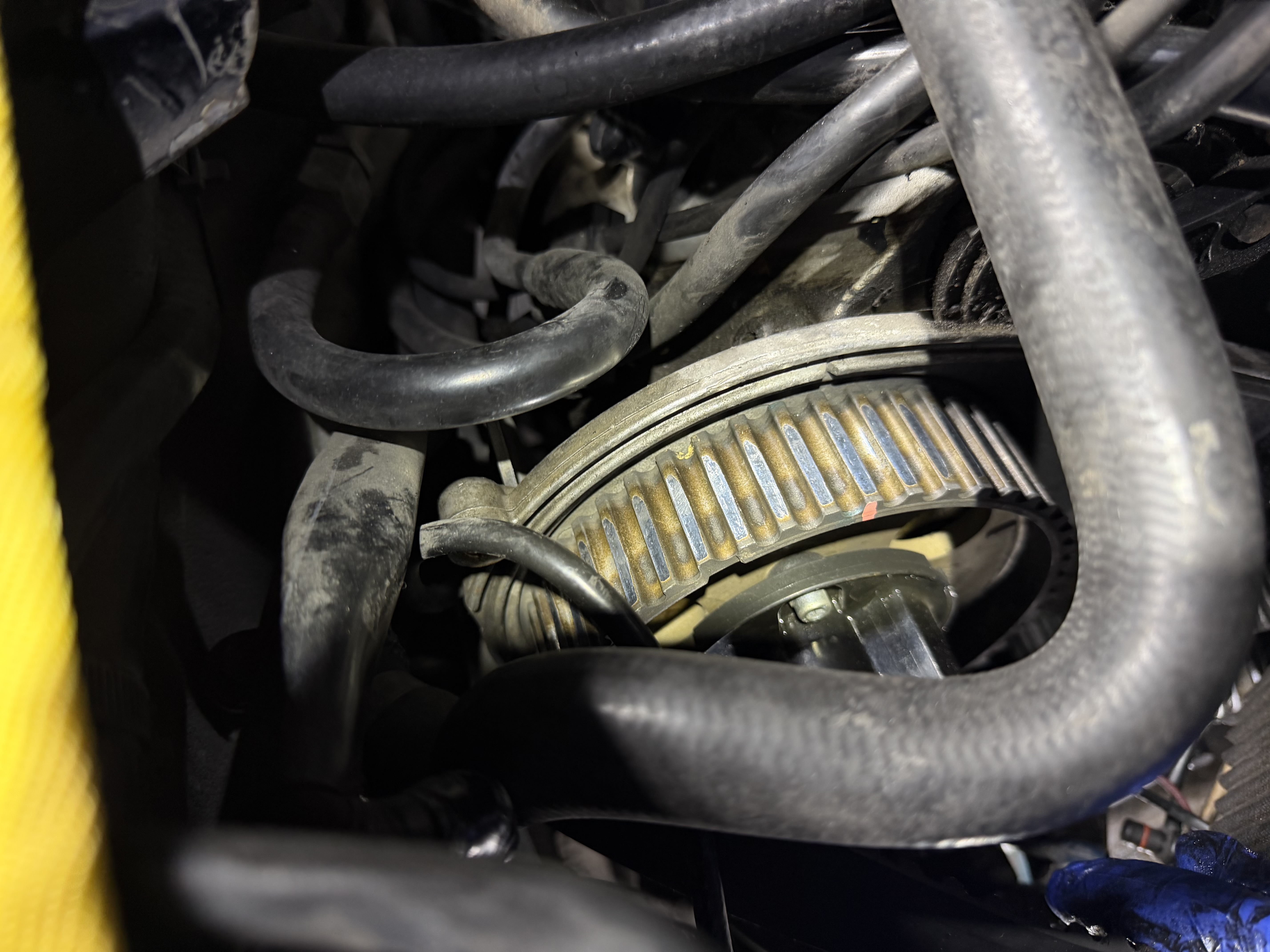

So I’m on to the Timing belt procedure ( changing to a PK tensioner ) when I have run into this…. I researched the old info online about possible resurfacing but I suspect replacements will be my future. I just wanted to get a few opinions before I commit the $1k.
I saw in the forums lots of talk about resurfacing etc… but seems like there were a few years when gears were NLA.
Thanks for any help/input.
Cam Gears Replace ?

Is that an S2? I'm not fully up to speed on S2 issues per se, so I might not be following your concern. If that were in my turbo, I wouldn't think much of it -- maybe just have the zinc plating redone with yellow dichromate. When you say resurfacing, is that what you mean? (I think of that word to mean machining the face flat, like on brake rotors and flywheels). Looks like a new one is under $300 if that wear bugs you though...

I heard that wearing down can be unhealthy for the belt … I’m super new to 928’s so bear with me.

I found a set of replacement gears from Roger at 928srus.com Better material and a much tougher bit of anodizing on them. I was looking at one of the refinishing options, as mine were still good with finish on the teeth intact. I ended up with his much better parts, and dropped the originals into the good used spares bin.
There's a very handy tool for indexing the cams, something you can order with the gears. Much Much Easier and Faster than going through the whole factory procedure with the covers off and dial indicator. The distributor caps and top belt covers come off to use the tool, and you can do the whole thing there. It gives you precision options for making cam timing adjustments, like a little more bottom end for my automatic car. At the expense of a little top end power of course. Point is you can play with the cam timing to better suit your own preferences. If you happen to be near central Oregon you are welcome to come use mine.

I guess the right thing to do is new Cams … I’ll have to bite the bullet on this one.

Meanwhile, the gears you show have suffered from a too-tight timing belt for a long time. Since you are going to the Porken tensioner, many of those issues will be gone.
