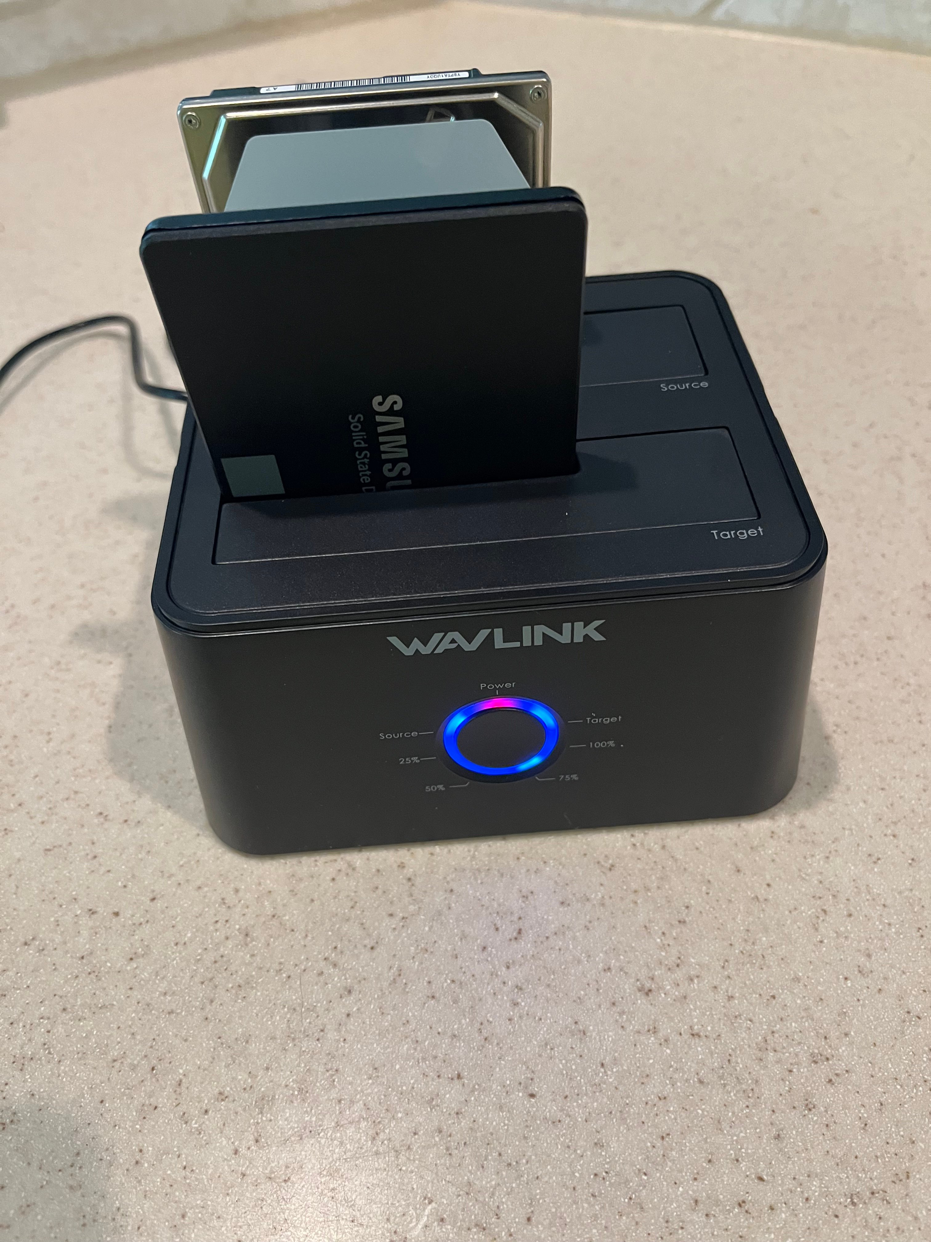

First, the SSD. After reading about drive failures, I decided to replace the HDD before installing the GTA unit. My old drive works fine so it was easy to copy using the WavLink. I put the old drive in a cabinet with the car’s other records and will probably never touch it again. Once the unit is out of the car, it is very easy to remove the drive and install the new one—there is a great thread on P9, so I am not going to elaborate any further. If you do remove the ribbon connector from the PCM, it is a bit fiddly to reinstall—you do this four more times with the GTA kit, so practice is helpful. I did put the unit back in the car to make sure it works with the new SSD before installing the GTA kit. All good.

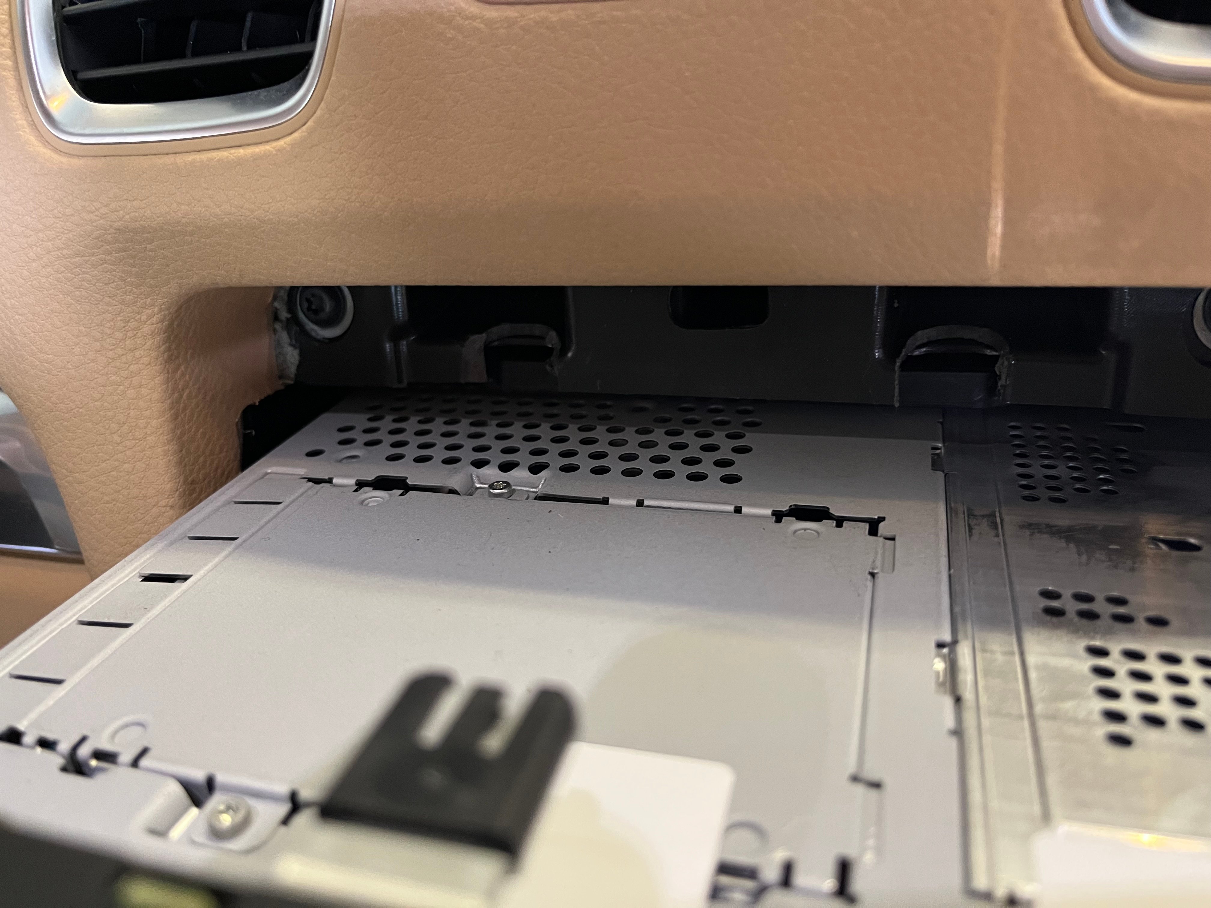

GTA has a youtube video for installing the kit. It is 95% accurate. Their newest kit has a single antenna for BT and WiFi, not two and honestly the hardest part was separating the CD drive from the main PCM unit. It has stickers which must be cut and the old steel pieces do not slide well. Patience and persistence paid off here.

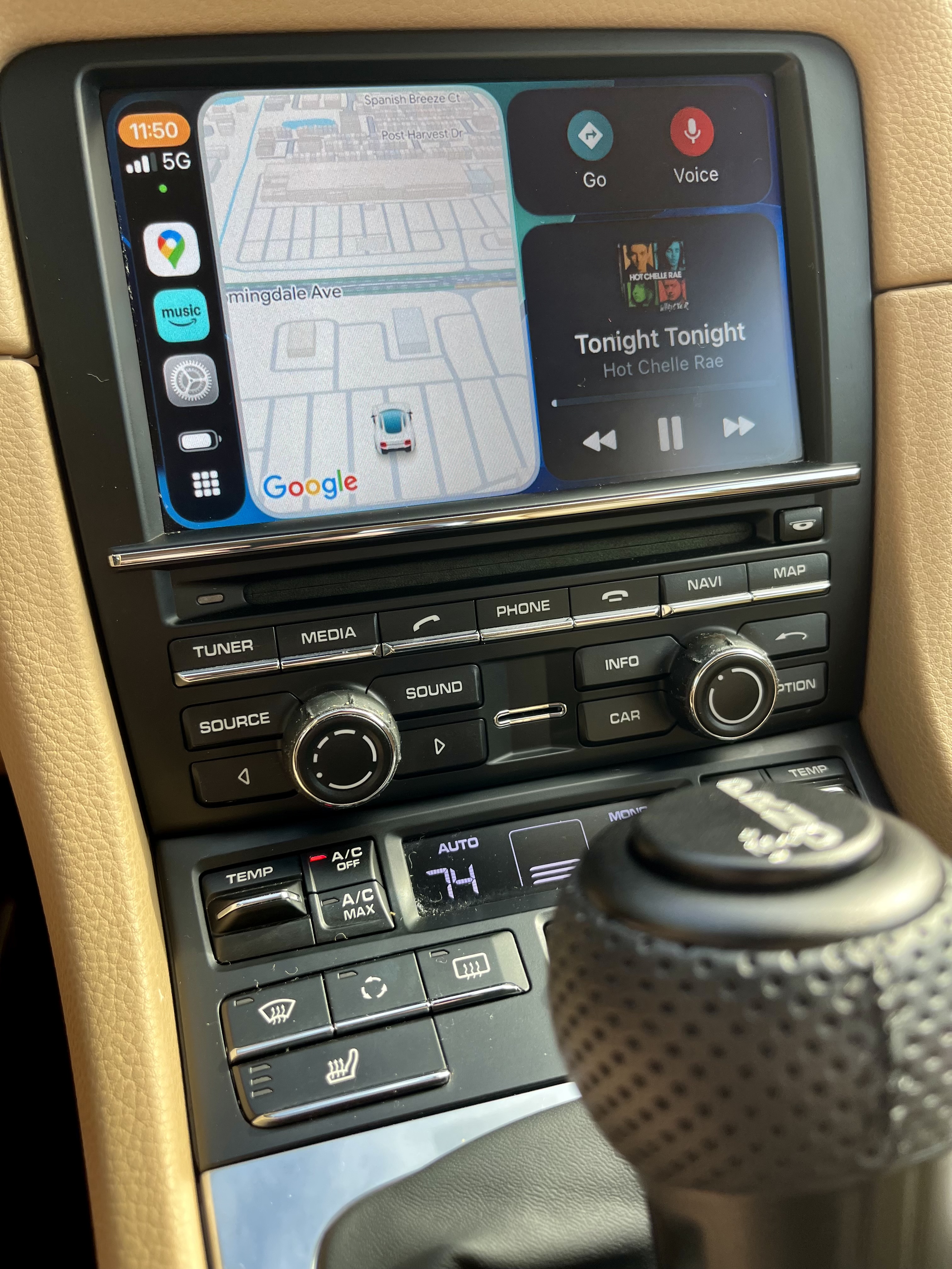

The unit itself performs very well. It connects very quickly in both wireless and wired CarPlay modes (I do not use an Android phone). The initial setup is fast and intuitive. If you have ever used CarPlay on another car, you can do it without any drama. I use wireless most of the time. Another person warned me that the GTA kit uses the cars factory AUX/BT. Not a big deal for me, but you do have to select that option every time you get in the car and connect your phone or you do not get any sound. Maybe the other kits on the market offer a different option, but this is a reasonable compromise to add new tech to an old system. I did notice that when using Siri to read text messages, the volume is very low. At which point you turn up the volume to hear it. When you are done and it switches back to music or a podcast, the volume is very loud unless you turn it down first. I cured this by telling Siri to speak louder, that fixed it and I admit I emailed GTA for some advice. All good now. Also, I do not have a back up camera and did not add one with this project, but I can tell you the GTA unit has all of the hardwires in place if you want a camera. I noticed the unit would switch out of CarPlay when I used reverse—the screen would go black. I also emailed GTA on this and they offered a new setting which stopped this from happening. I will say that GTA’s tech support was amazingly fast and helpful. As I noted above, buy the unit from them and they will help you with any issues. A+ on support.

Cloning the old hard drive to a new solid state drive.

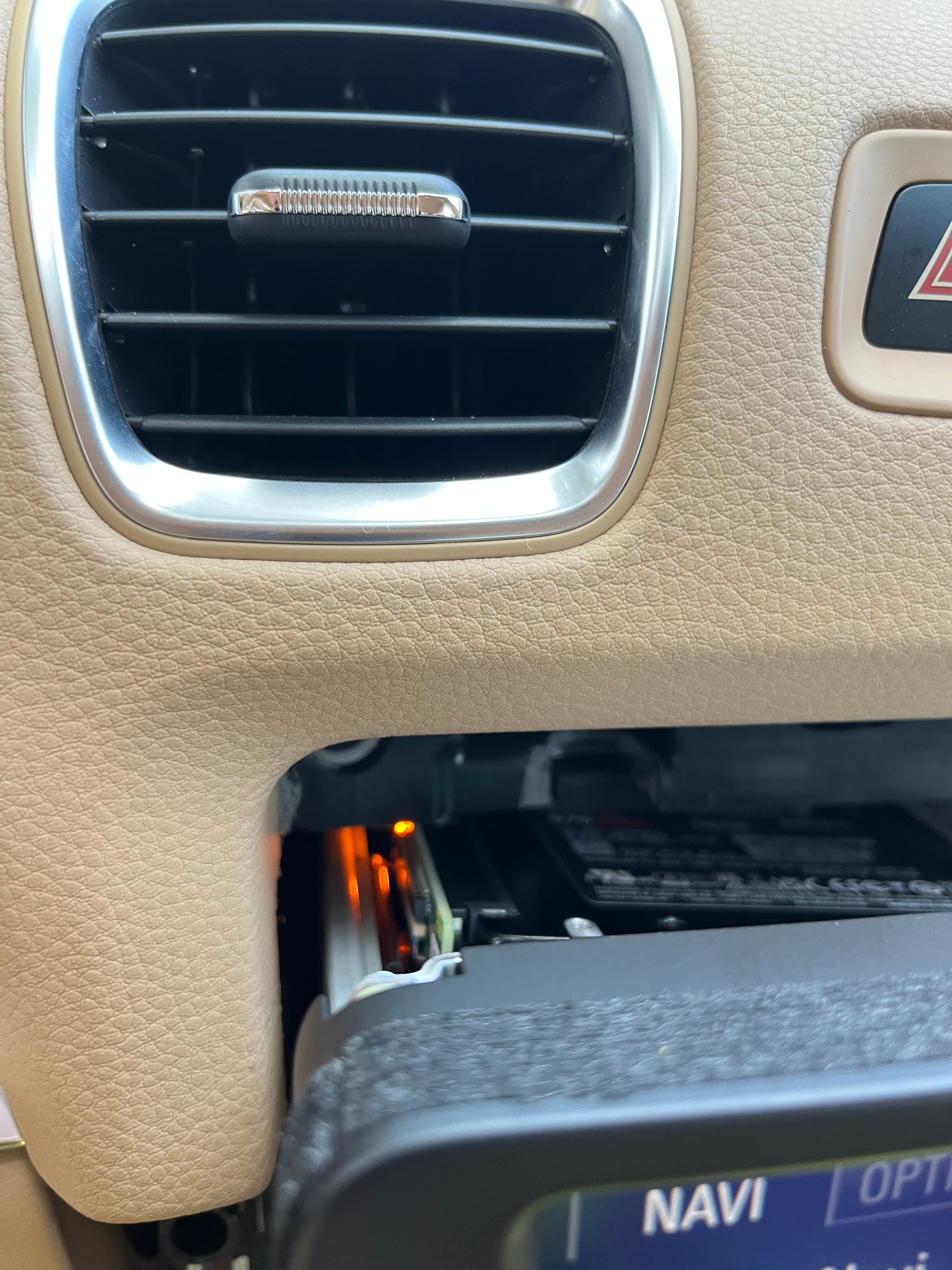

Removing the PCM unit--those wholes are supposed to be there, that is not damage.

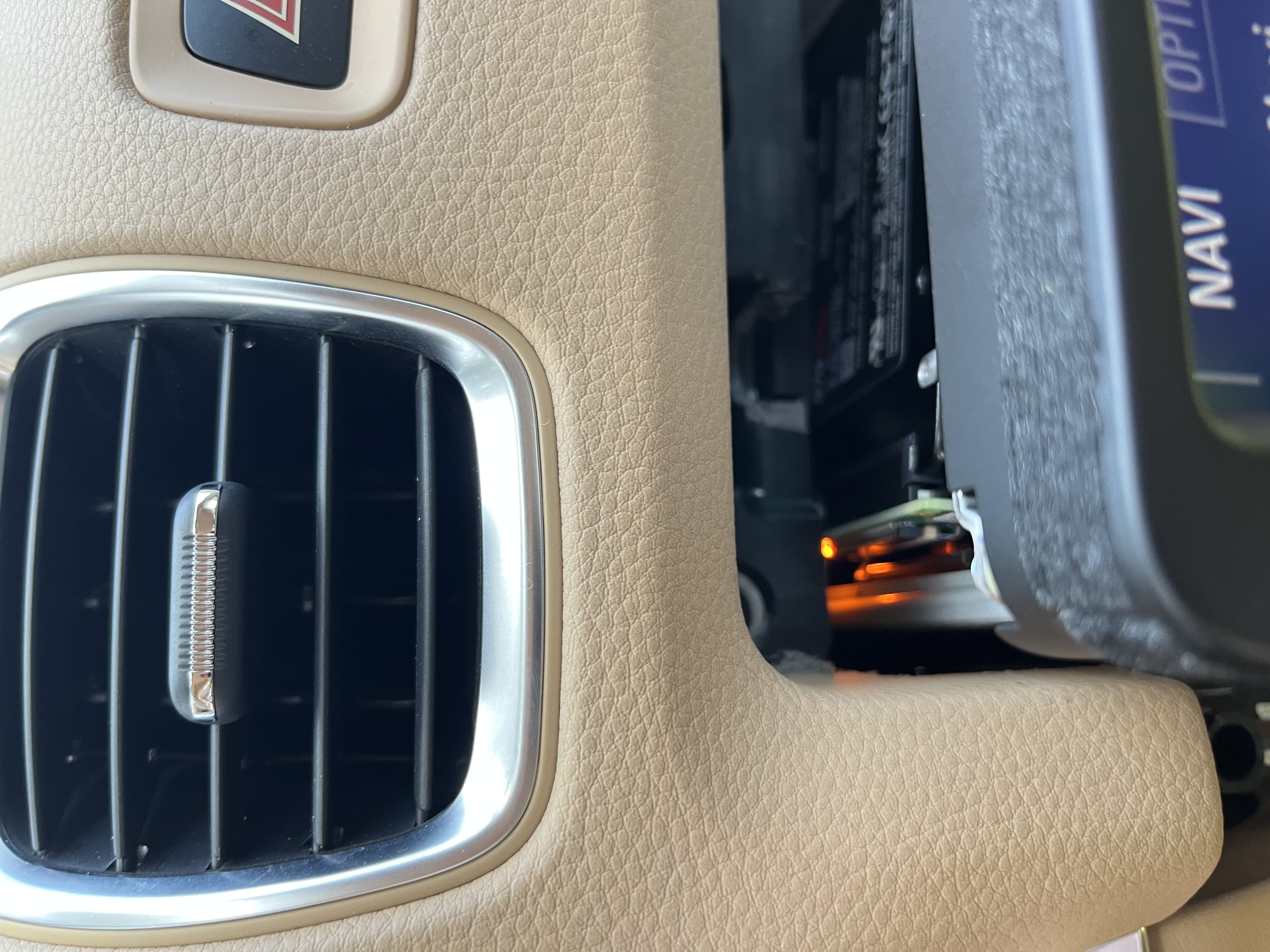

Testing new solid state drive. The amber LED notes that the drive is powered.
If you see this for 4-5 minutes and the unit resets, something is not plugged in correctly. The ribbon cables can be difficult. I suggest enlisting a teenager to install them.
Success!!
