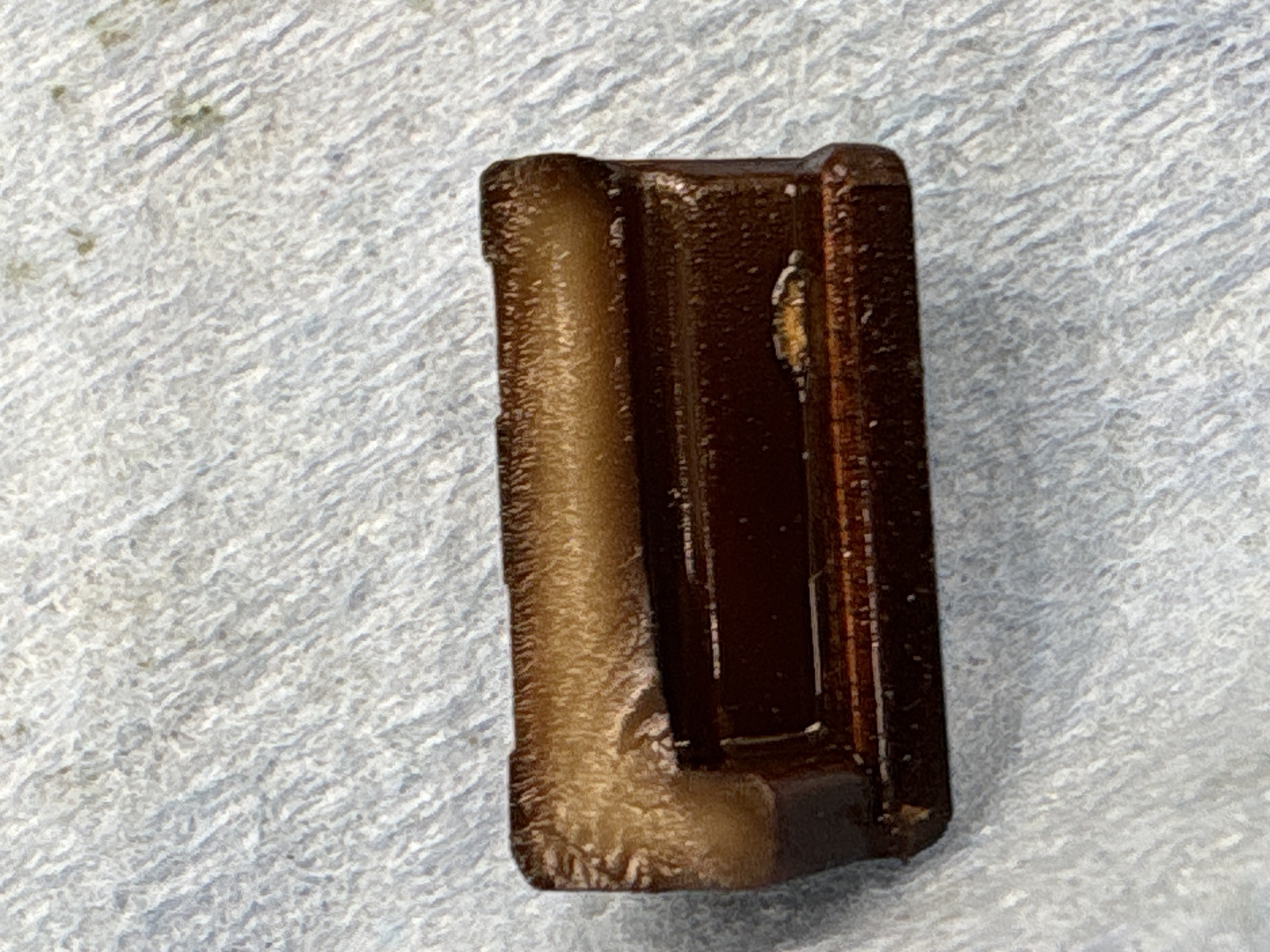

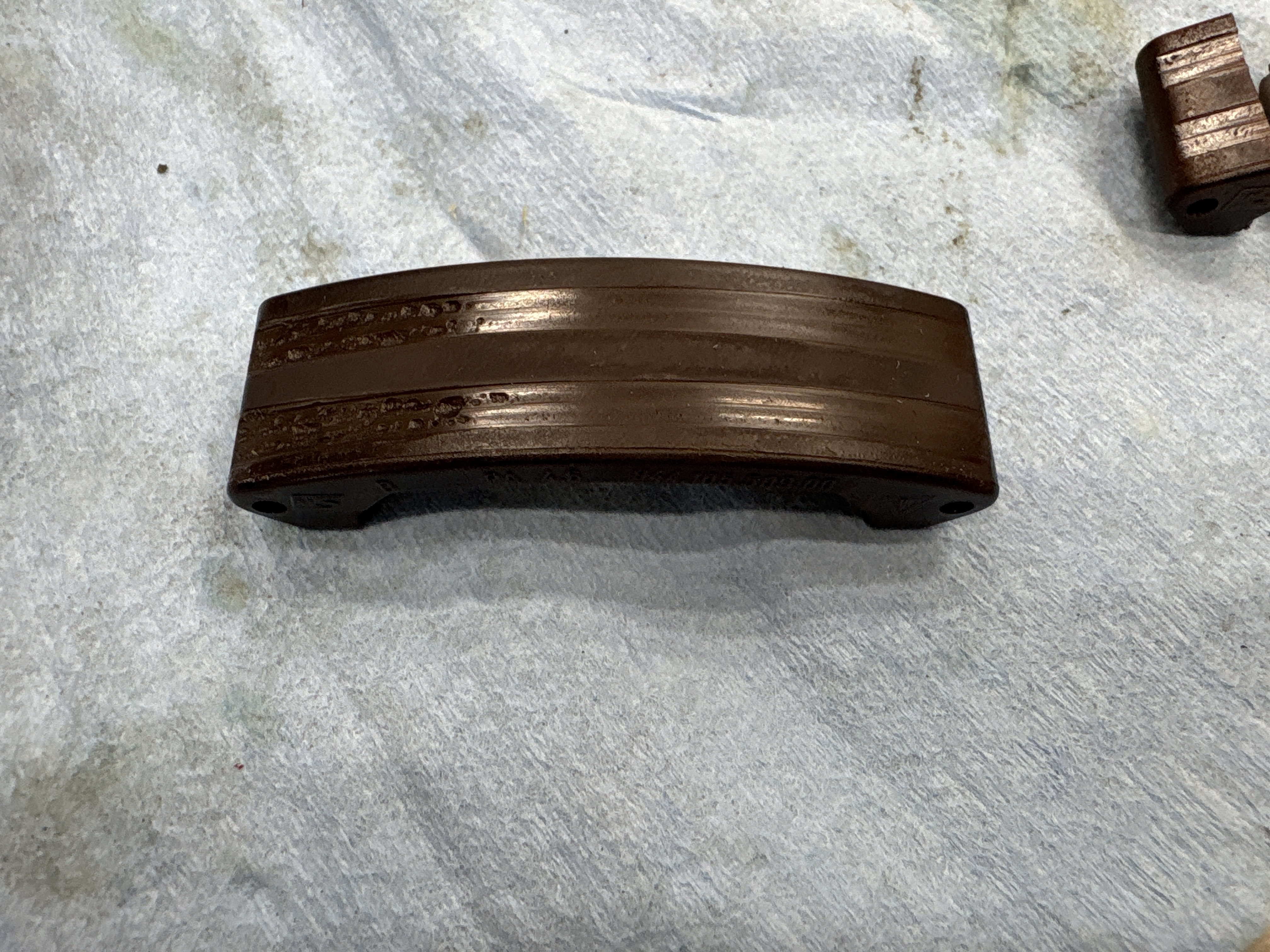

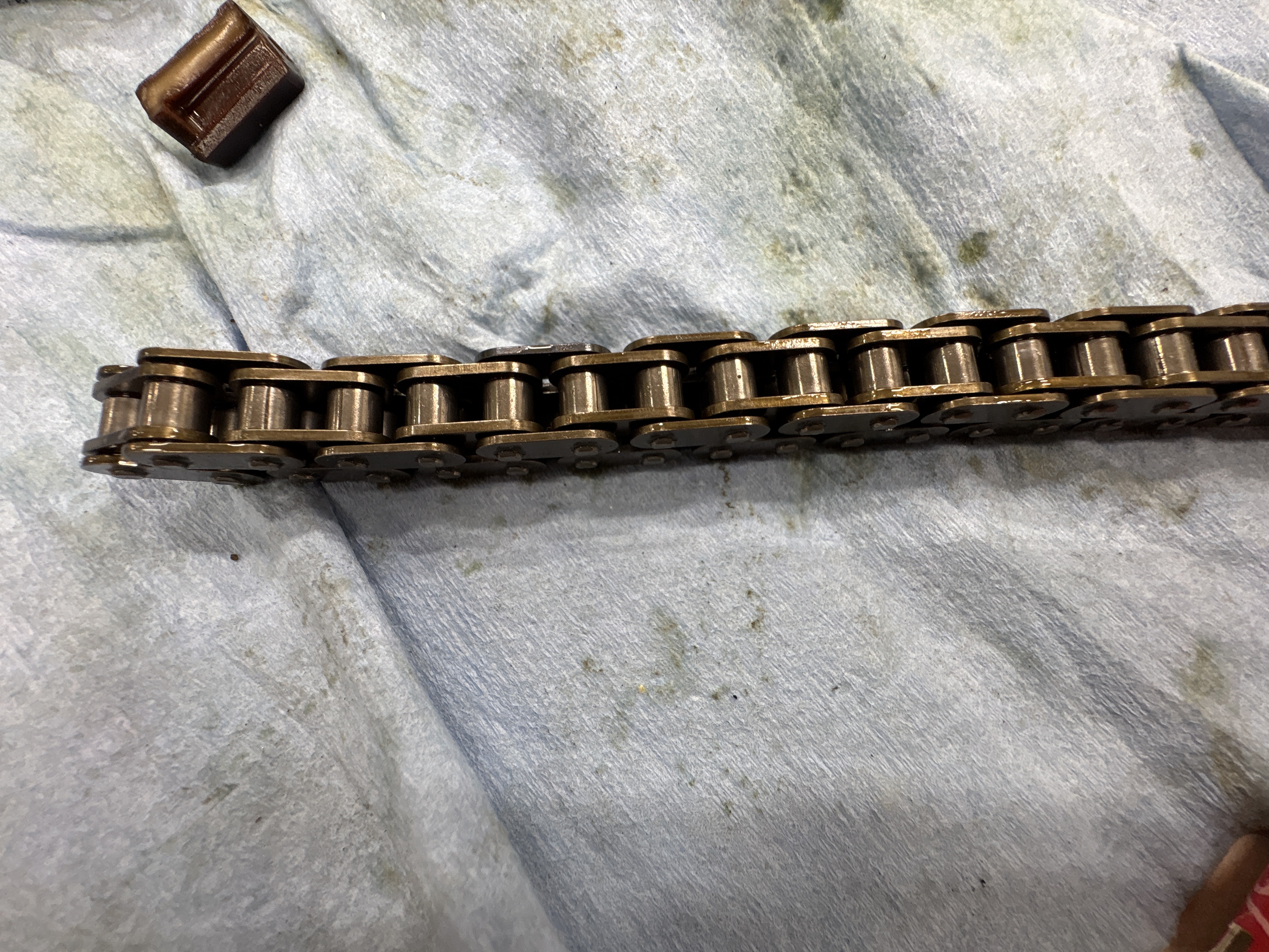

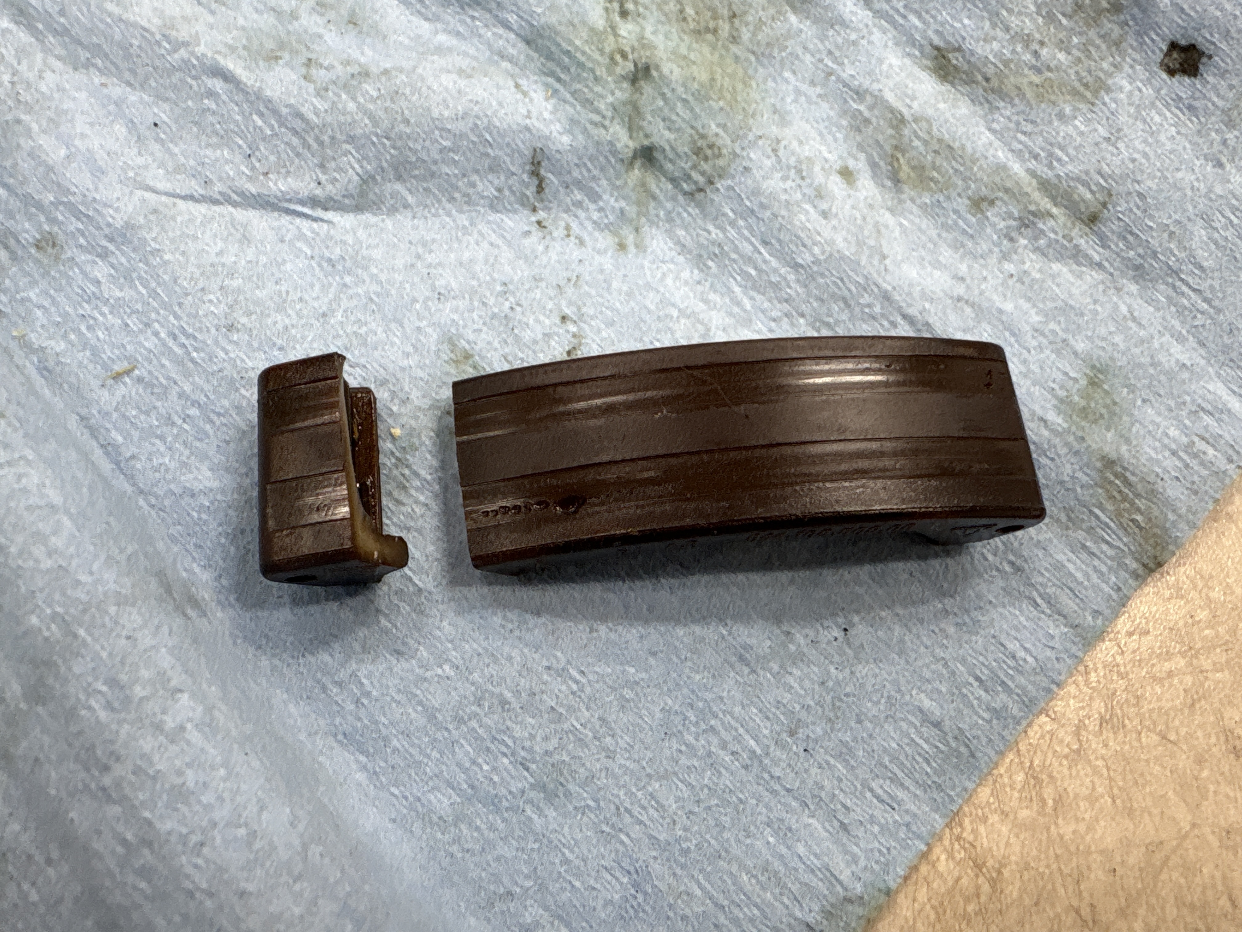

Over the past couple weeks I replaced the cam chain and tensioner pads as a PpPreventative maintenance item. My car is a 94 Cabriolet that has 79,350 miles and no records of the chain/pads having been replaced. The maintenance records I received were not comprehensive and dated back for 10 years.
Overall, the pads showed slight wear/grooves, mostly on the top pad. There was no visible cam tooth damage/wear and no cracking in the pads. They are brittle, though because the lower pad broke when I was removing it. The chain looked really good, as well but I replaced it, too.
I hope this info and pictures helps a member.

- Can chain
- image.jpg (3.42 MiB) Viewed 1249 times
- Pad cross section-note oil penetration
- image.jpg (1.67 MiB) Viewed 1249 times
- Lower pad
- image.jpg (2.79 MiB) Viewed 1249 times
- Top pad
- image.jpg (2.74 MiB) Viewed 1249 times
