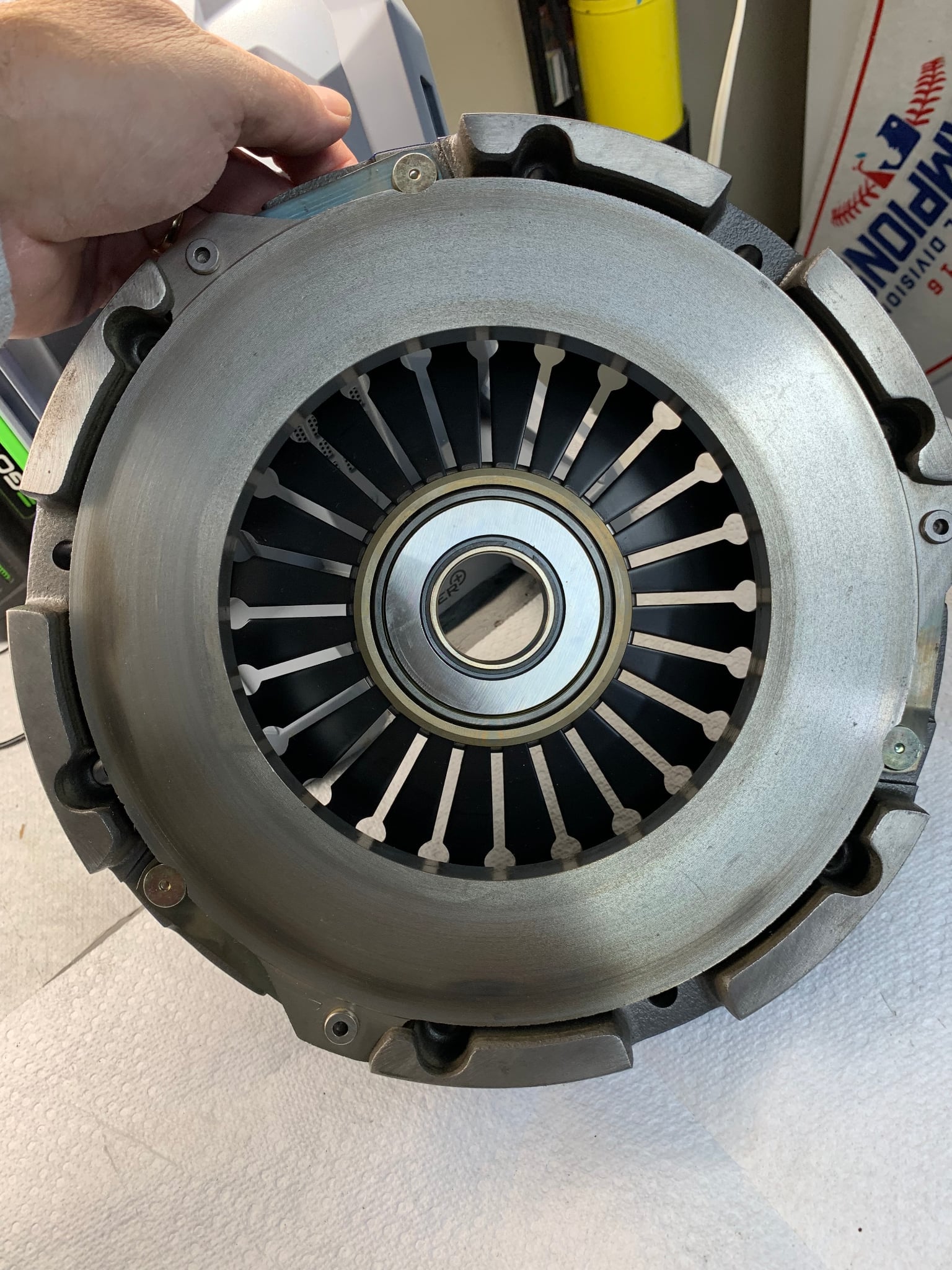

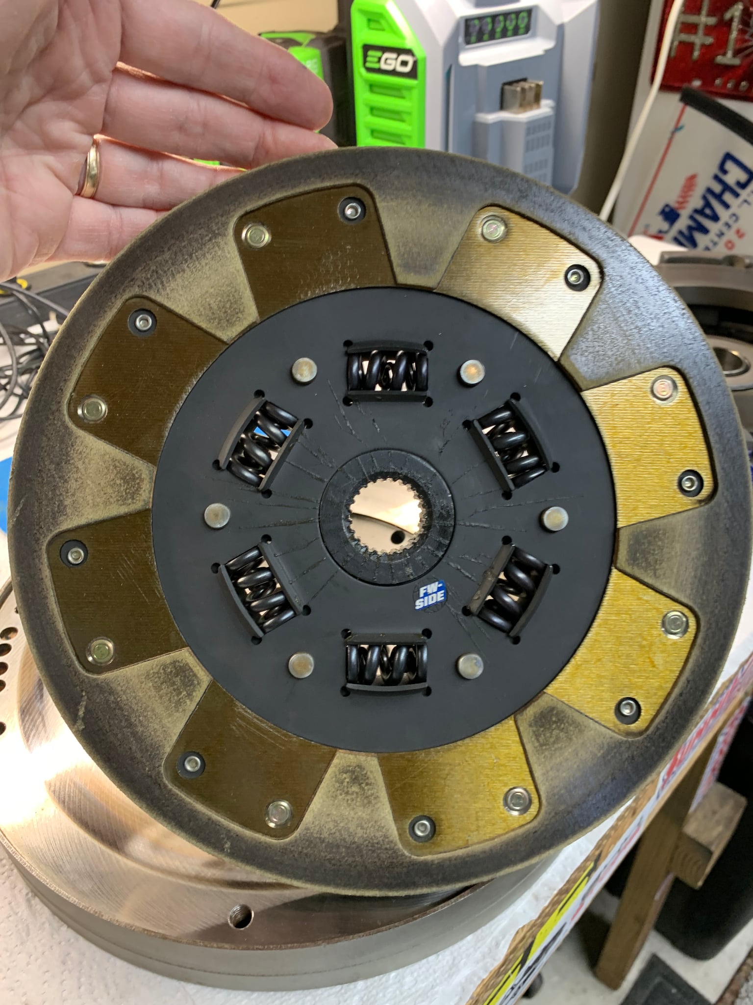

Just looking for a little advice. Last year I put this Spec stage 2 clutch kevlar package on my 944T. The first 500 miles of break-in went just fine. Clutch was silky smooth. At 800 miles I started getting shudder which only got worse with more miles and drove me nuts. I pulled the clutch last weekend and I do see some issues. (See pics). Flywheel might have been out of spec. I do see some grease on the clutch center. I might have overdone it lubing the Tork tube shaft and it migrated to the kevlar. I was wondering if the minor pressure plate discoloration should be a worry since I'd like to re-use it and go with a Turbo Cup Disc and new flywheel. About 1,200 miles on the whole setup. Thanks.
